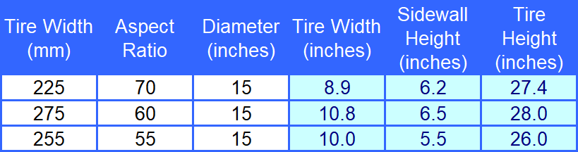

A 70 aspect tire on a 15” wheel should give you about 27” of tire height, the stock size for a 1976. Changing this height would cause your speedometer to read differently.
The main reason the wheels would look small in the wheel well is because of how high the car sits. Lowering the car 2-3 inches makes them look much bigger.
I’ve seen people put Cragars on C3s before, but I’ve heard of a lot of fitment issues due to the C3s disc brakes.
If you want the chrome 5 spoke look torque thrust 2 wheels are a popular choice. They can be had in 17” or 18” as well, which gives you a lot more tire choices.
You’ll be looking at a 55 aspect tire with 17”s or 45 with 18”s to keep your 27” tire height.

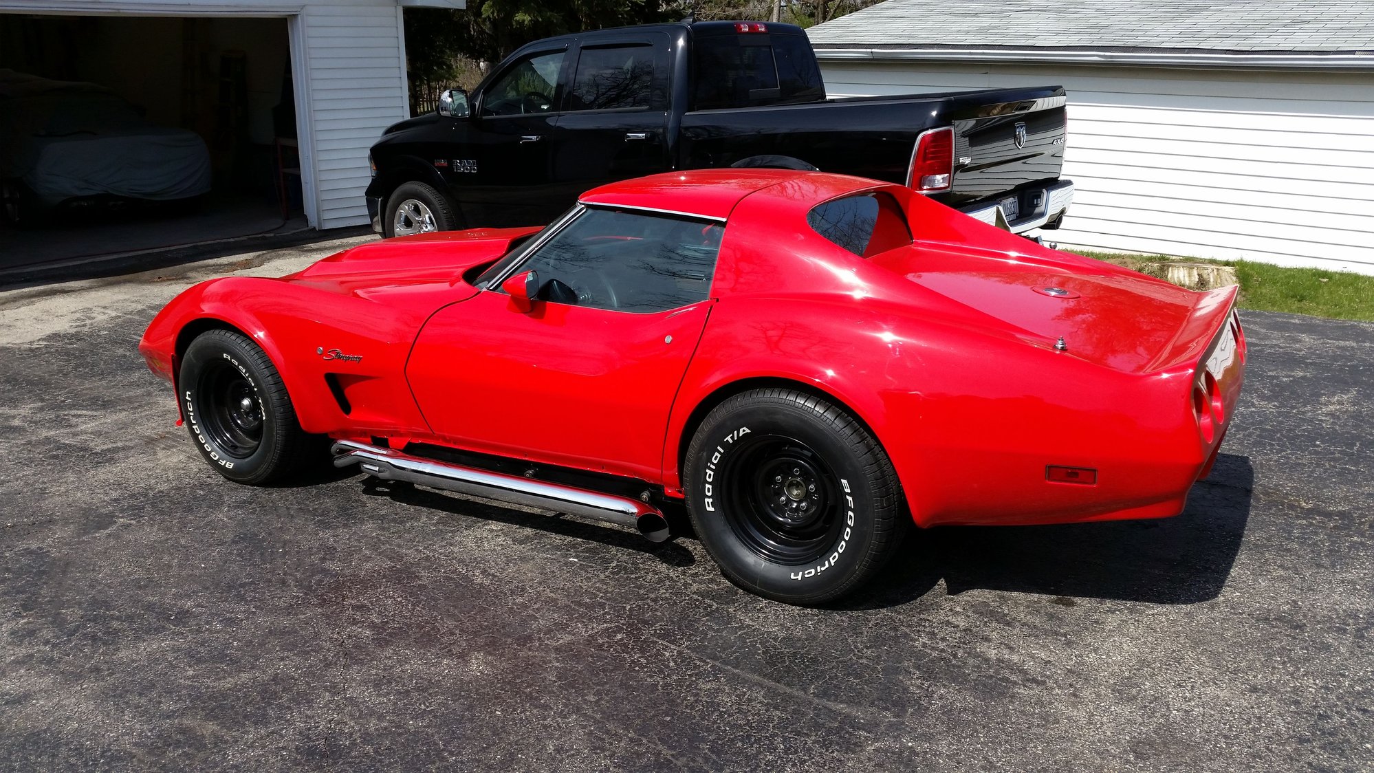

Originally Posted by C3_DH
@redroket What size rims/tires? Those fill up the wells nicely...
275/60/15 On rear and 255/55/15 0n front. 15X8 inch rally wheels
