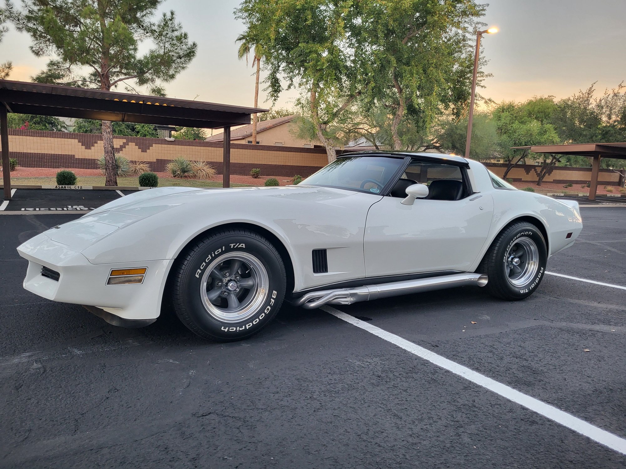

About $1500 from Summit Doug's ceramic headers and pipes set up with free shipping, had about $1700 into these with inserts... simple install in a day
This is THE COOLEST looking 80 I've ever seen and I'm usually not a fan of aftermarket wheels on C3's and not a fan of white Vette's even though I have one mysely. I'd drive that 80 'till the wheels fell off!
thank you, I removed the pipes and wheels, brought back to original and just sold last week, it was a great car.

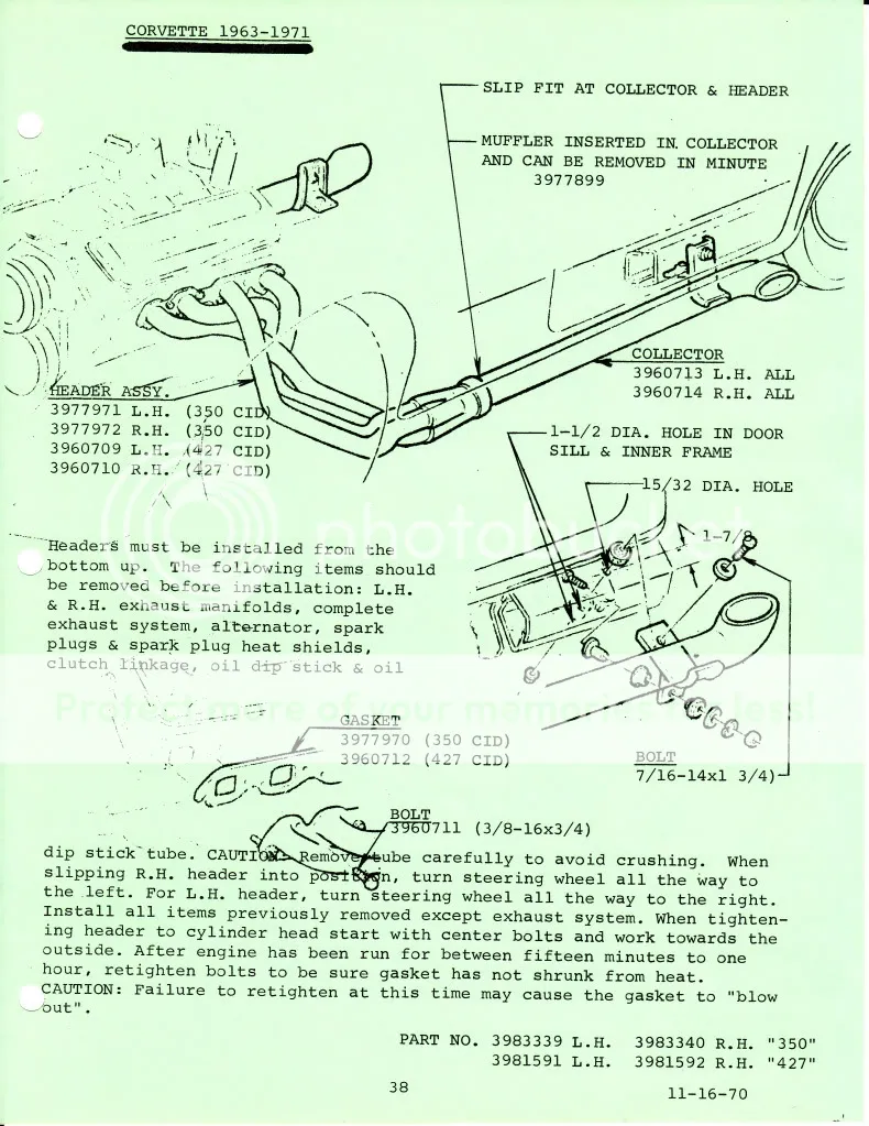

Originally posted to the CF Forum by MASHINTER, this is the GM header/sidepipe assembly manual with part numbers. For those interested in detail...
