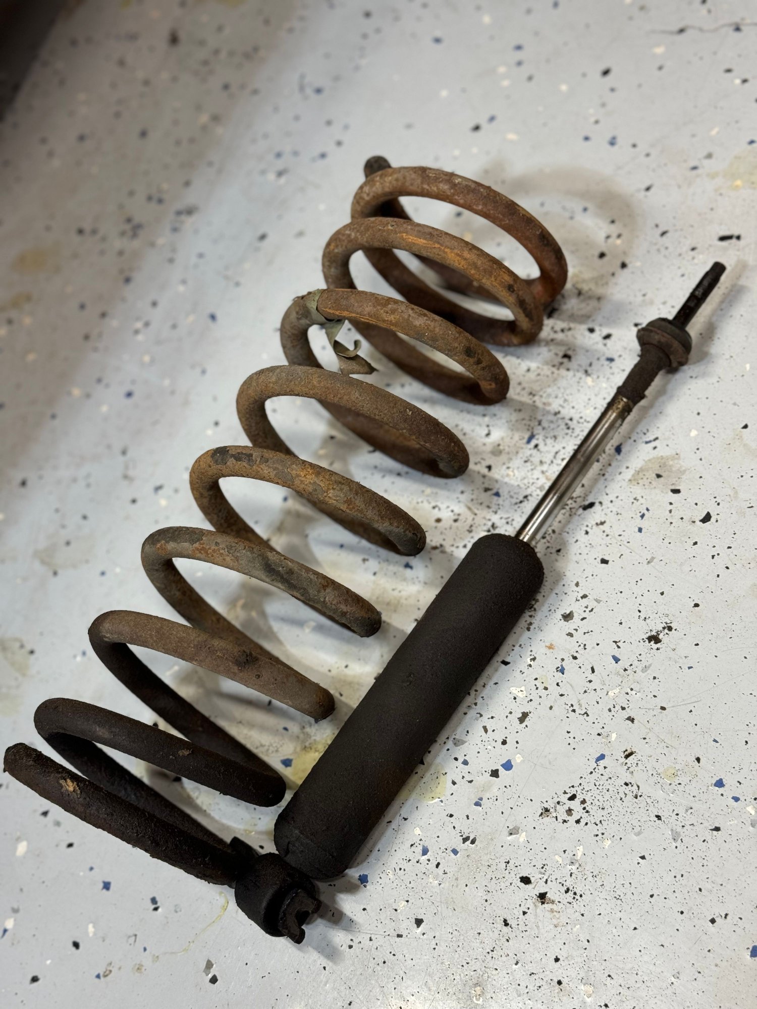

All the front rebuild and rear shocks showed up today, just missing the spring compressor. Pulled and installed rears in about 30 minutes, easy work. The front however has been a different beast.
Wire wheeled off 40+ years of dirt, oil and grim to be able to see what I'm working with. Which honestly, didn’t look as bad after some cleanup, but all of these bushings are still shot and not helping with the quality of the drive i was feeling.

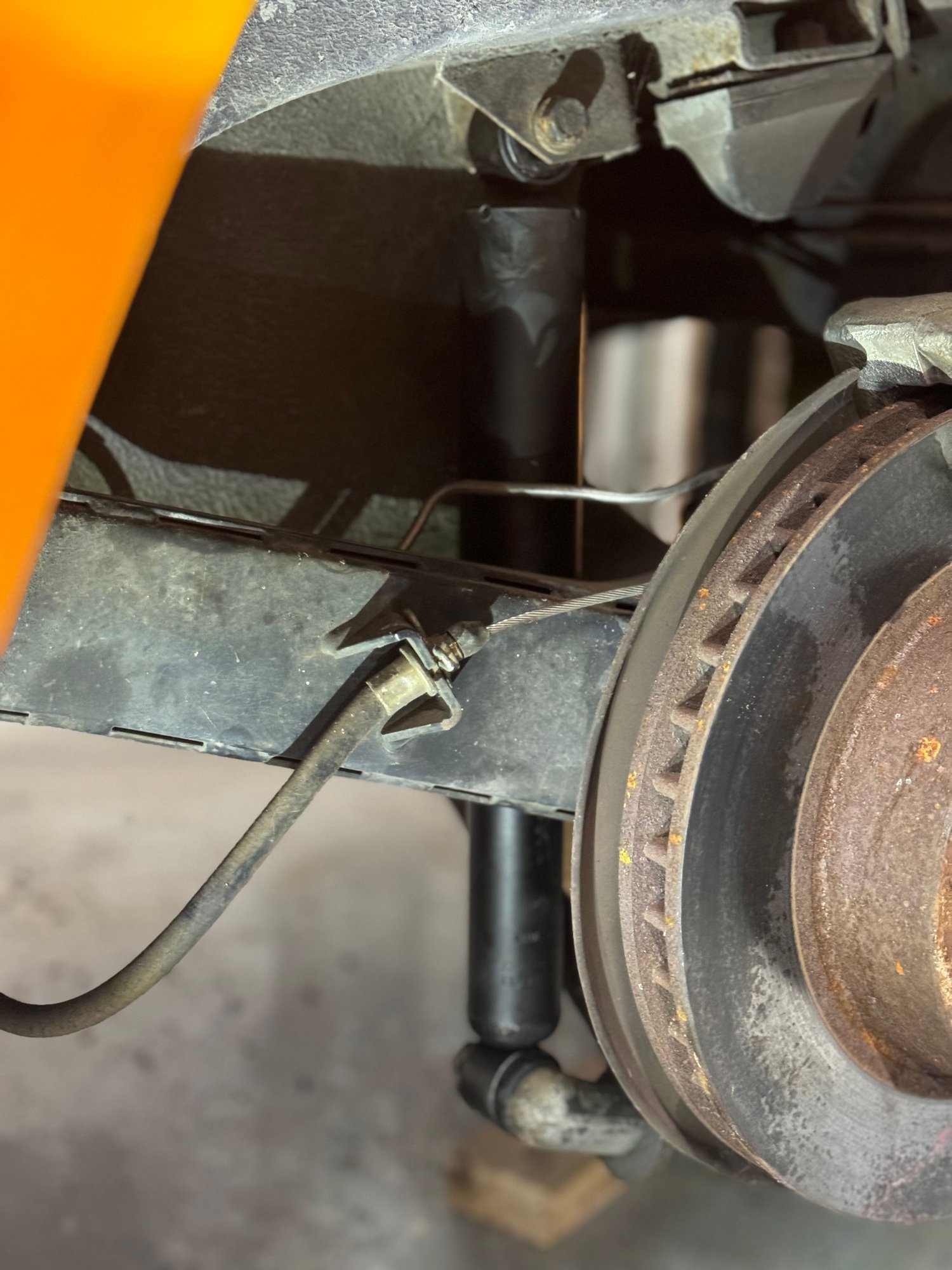

After pulling off the rear I saw a brake line that looked concerning, and the possible cause of my squishy pedal. Couple pumps and that thing was flowing. Fortunately, that was the only one leaking and after pulling and plugging it none of the other lines leaked (small victory). New brake line for that side will be ordered
Continuing on to the front, pulled as much off as i could. Waiting on the pb blaster to work its magic overnight so i can pull the spindle and move on to the horrifying limb threatening task of dropping and putting in new springs.

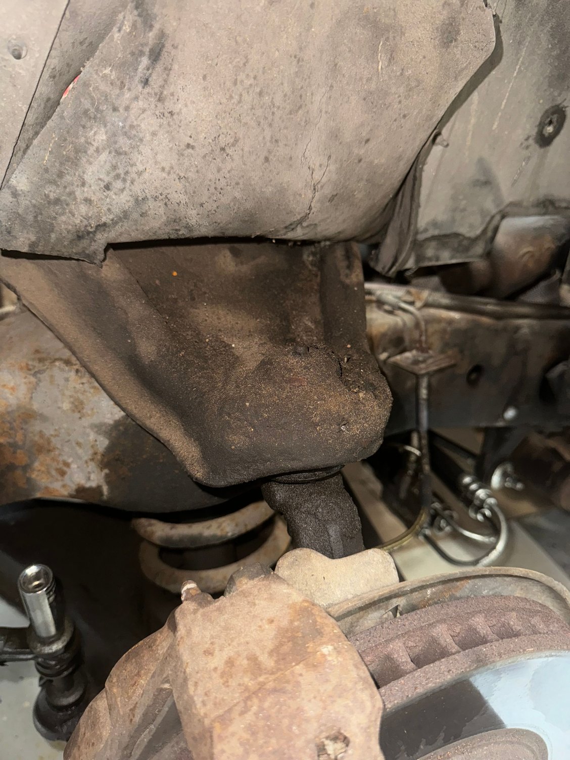

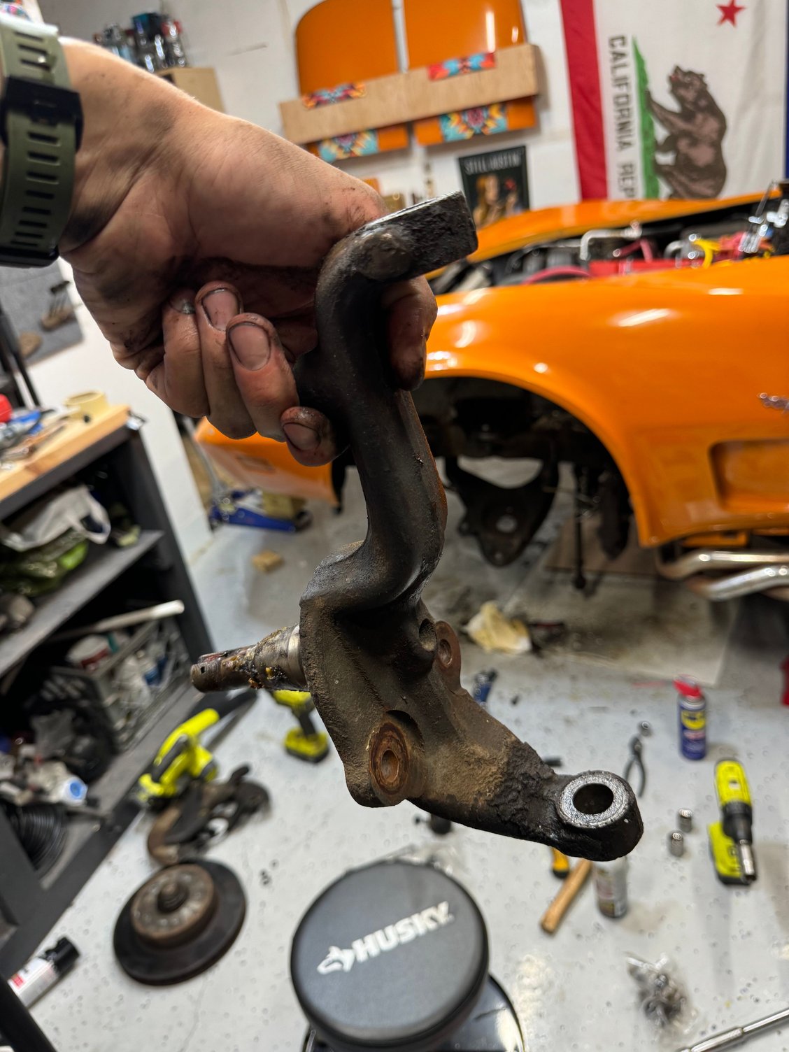

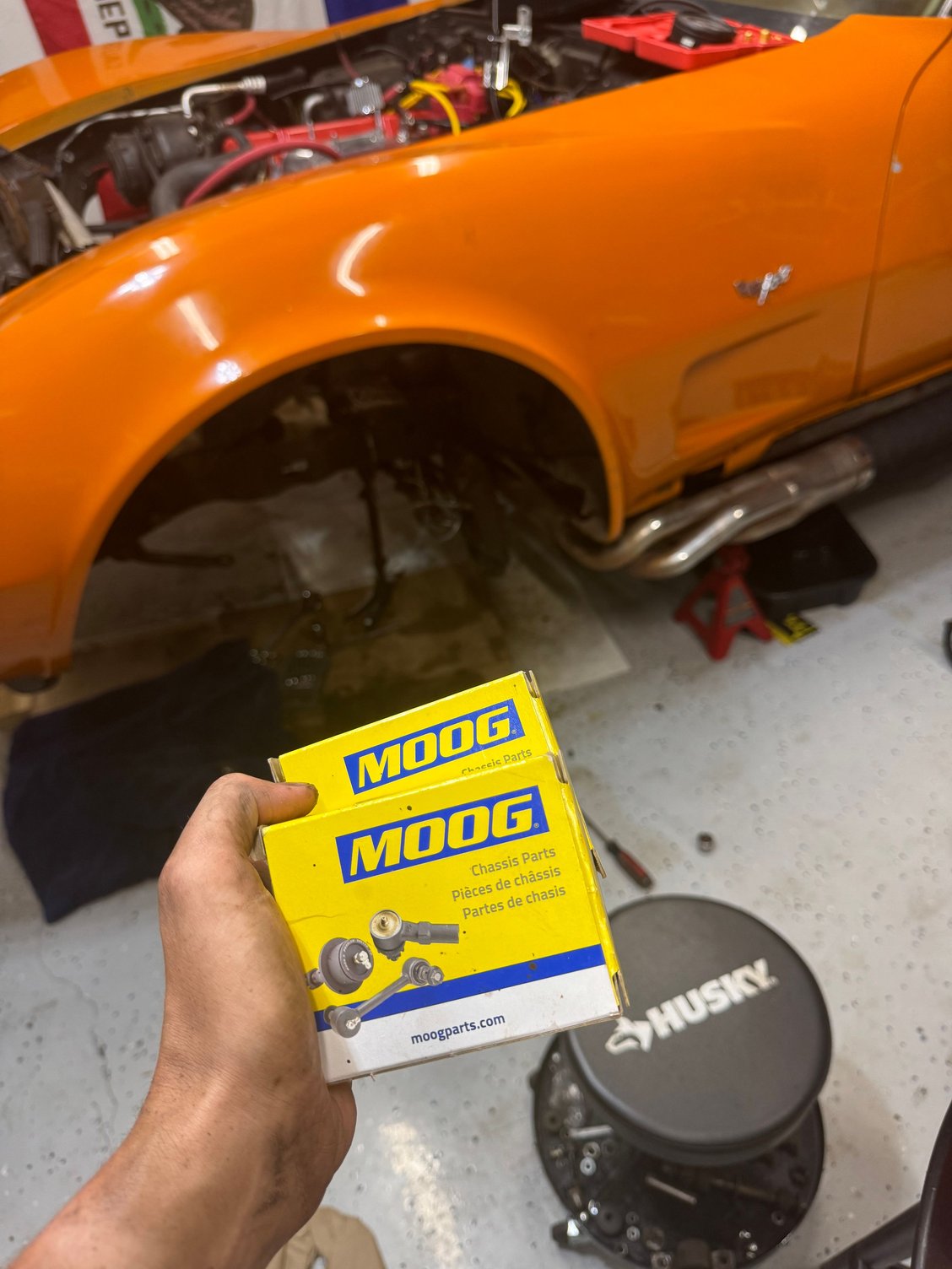

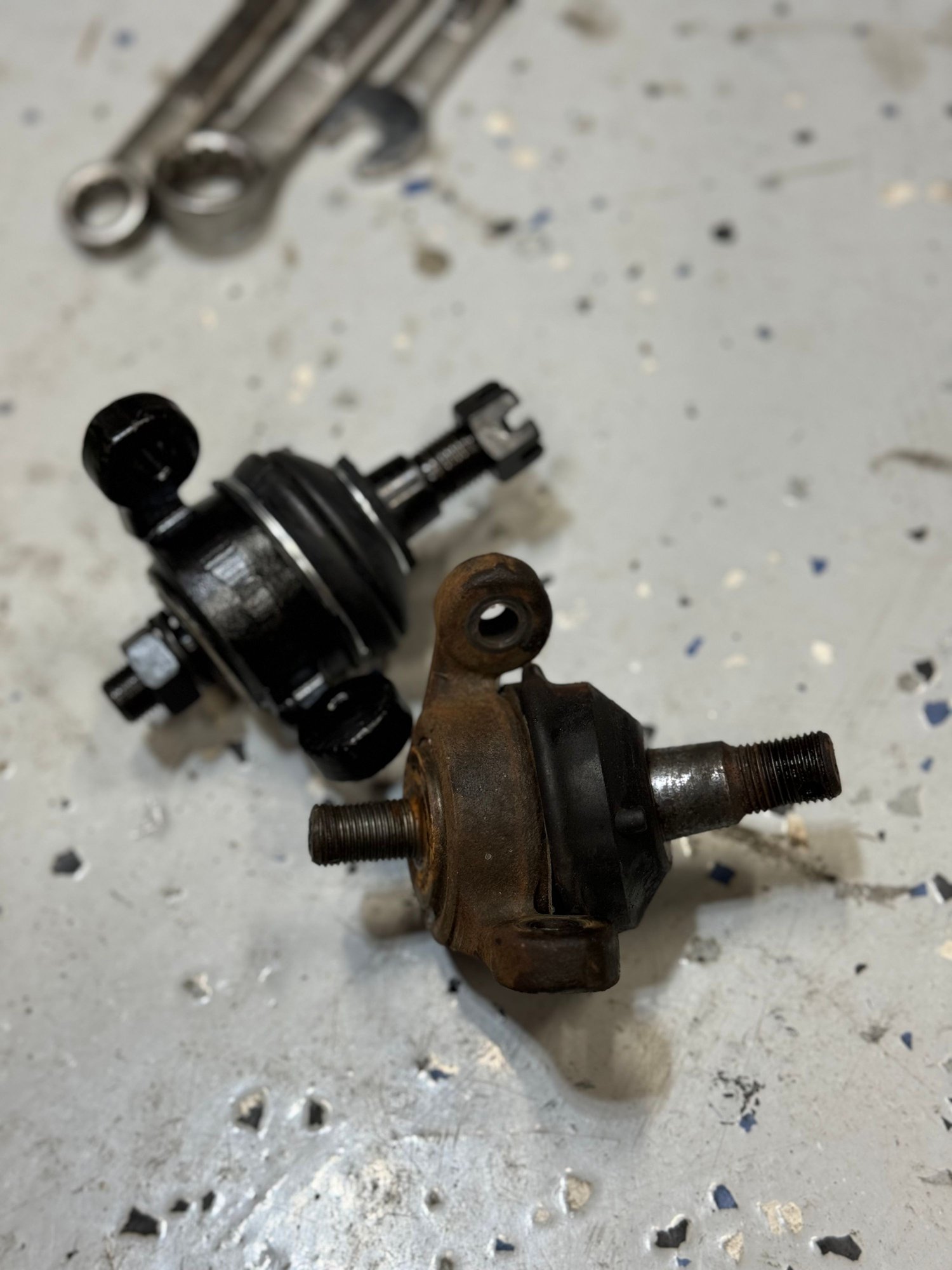

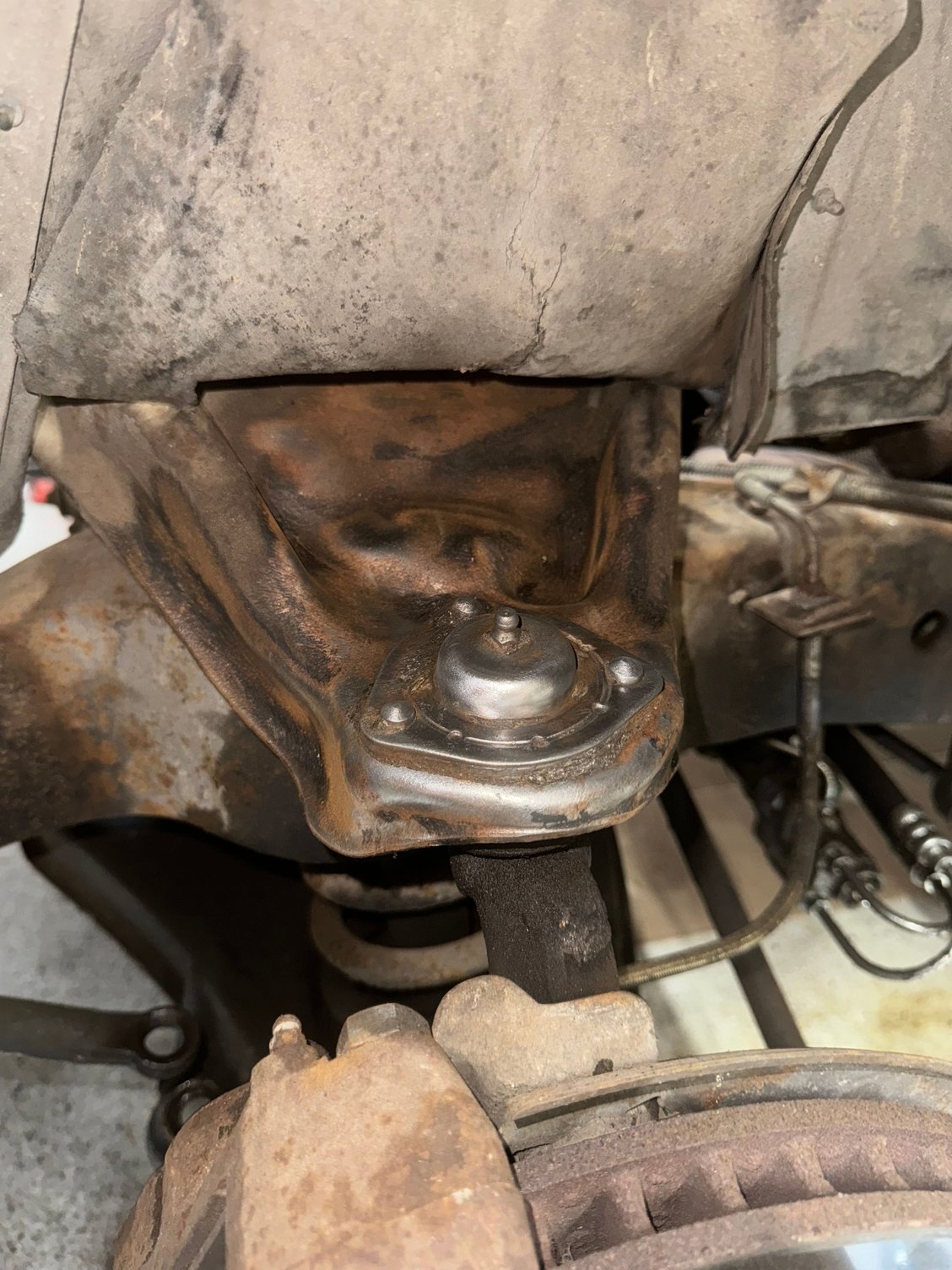

Dove a bit deeper into the front end rebuild. Pulled the spindle and remaining brake components and bushing for the lower control arm.
Was surprised to see the bushing was still relatively intact, however that cannot be said for the upper, sway bar end link or tie rod.
Dropped the shocks to finally find what was making the clunks on the first drive, no more bushing for the lower shock mount….
Yanked the upper control arm, going to prep and paint it after grinding/drilling the old rivets and ball joint out
Any tips for removing the tie rod would be appreciated, that guy might as well be welded on there currently

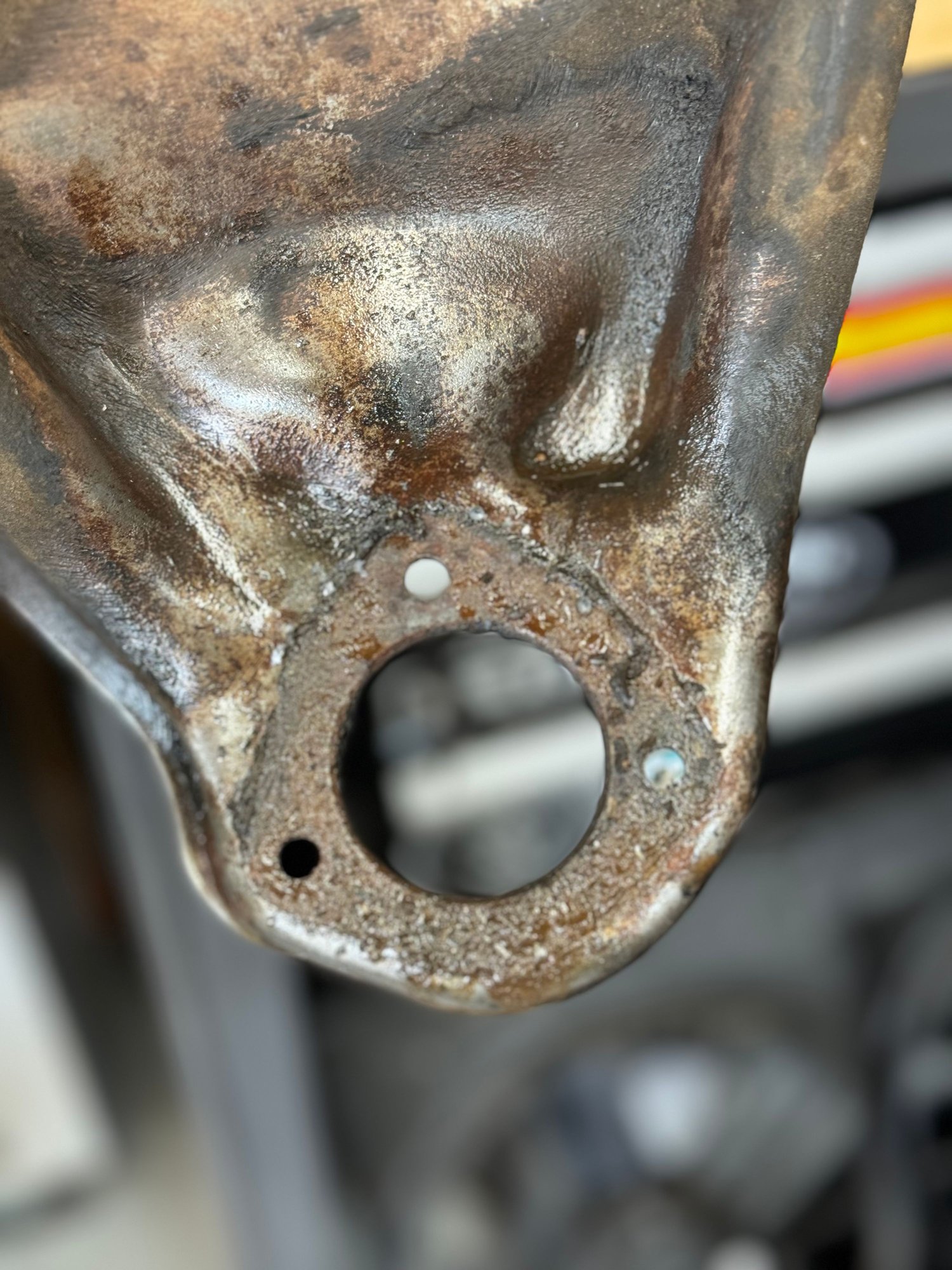

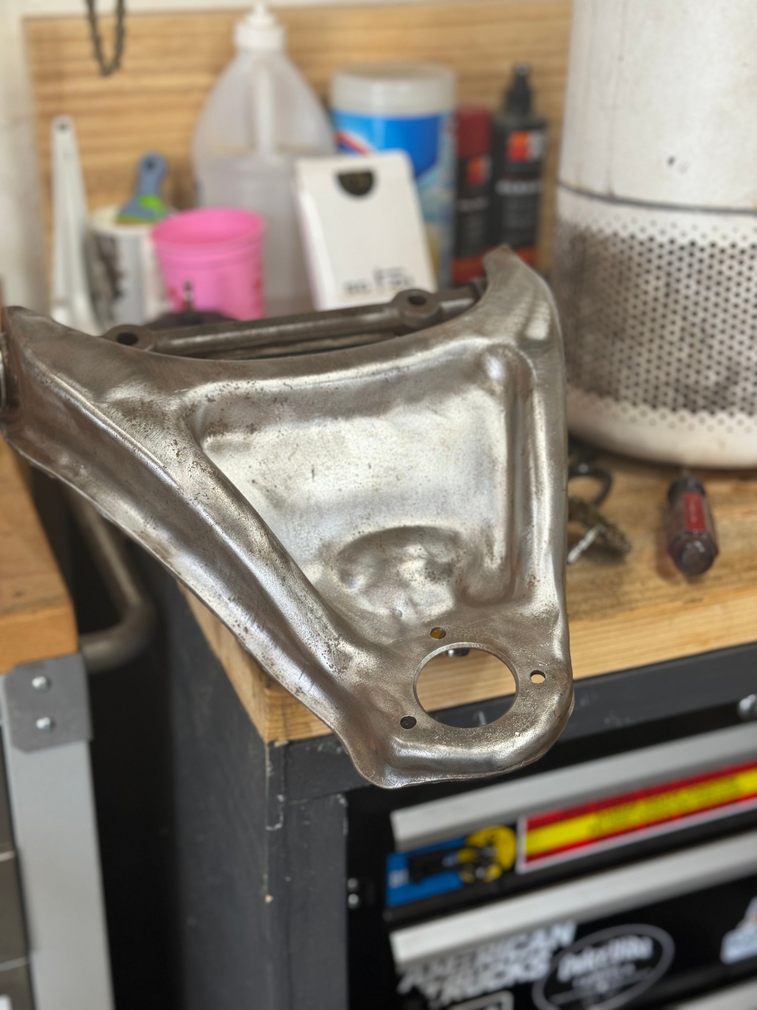

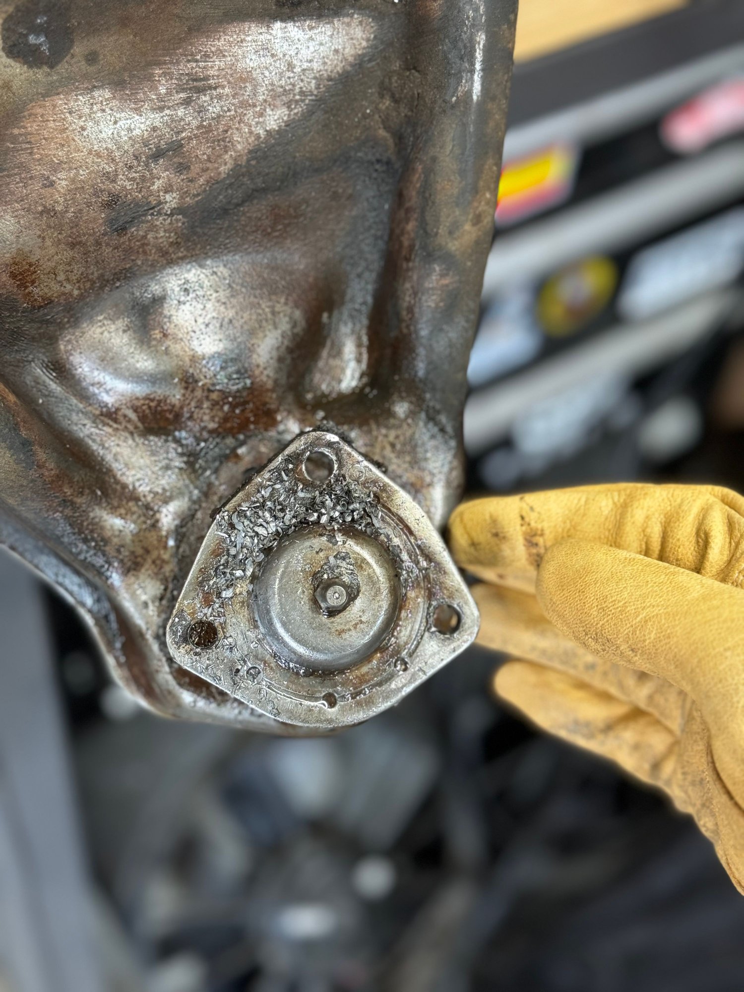

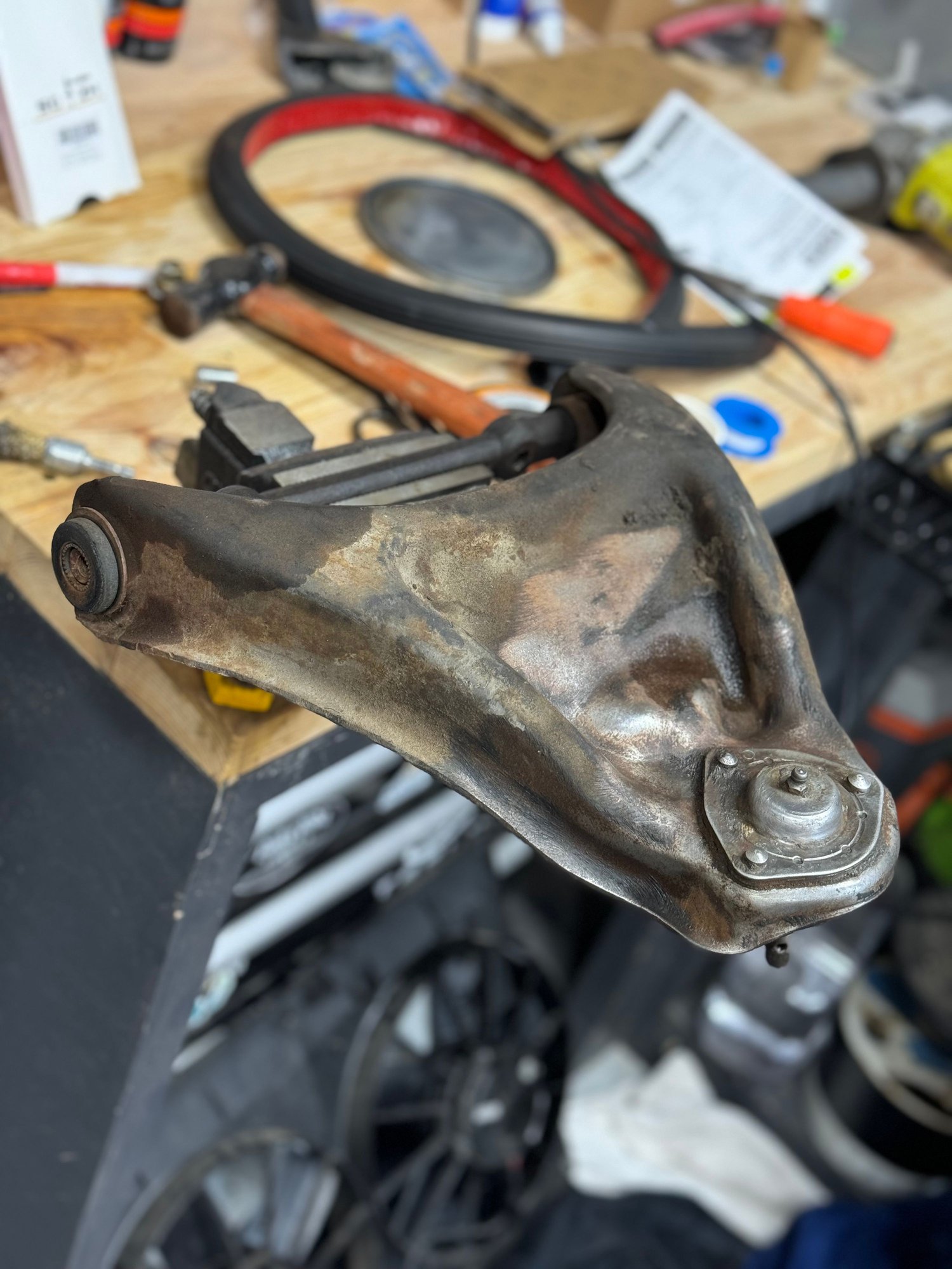

Drilled out the rivets for the upper ball joint and wire wheeled my heart out for a bit. Still waiting on a bushing press before repainting and prepping for the passenger side.

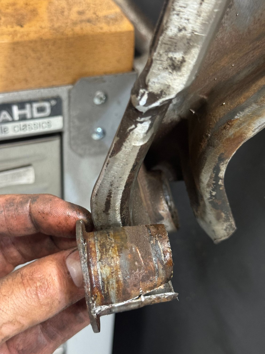

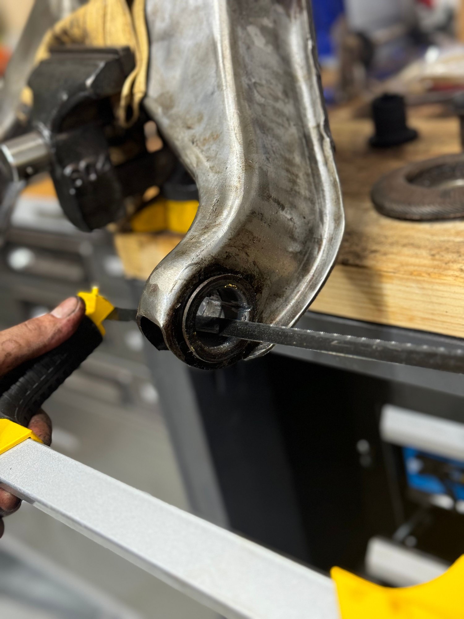

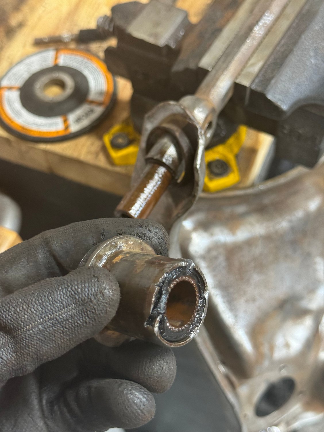

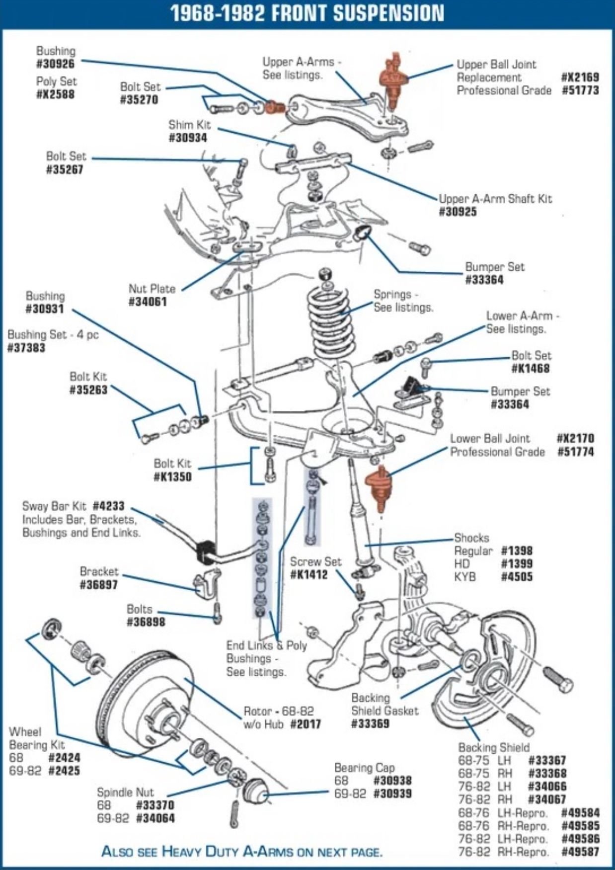

Bushing press finally got in, so i spent some time hacking away on those. Worked like a champ on the upper a-arm but the sleeve for the bearing to sit in being on the inside of the lower turned out to be a pain. Took a little coaxing with the trusty hacksaw method.
Can tell these bushings lived a full life.
Paints on and new bushings are waiting for install. Also found what will most likely be a very useful diagram for reassembling the whole system.
