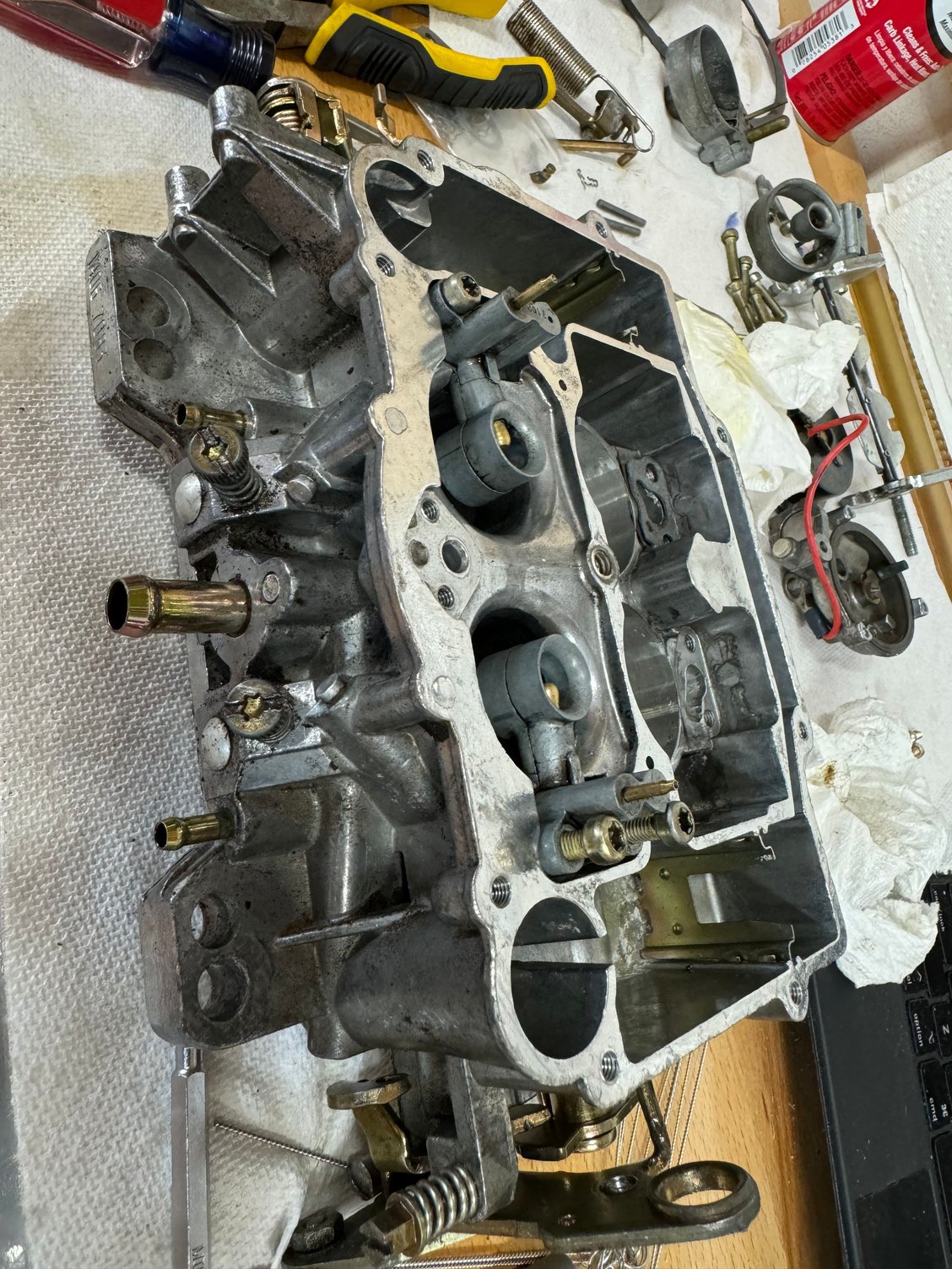

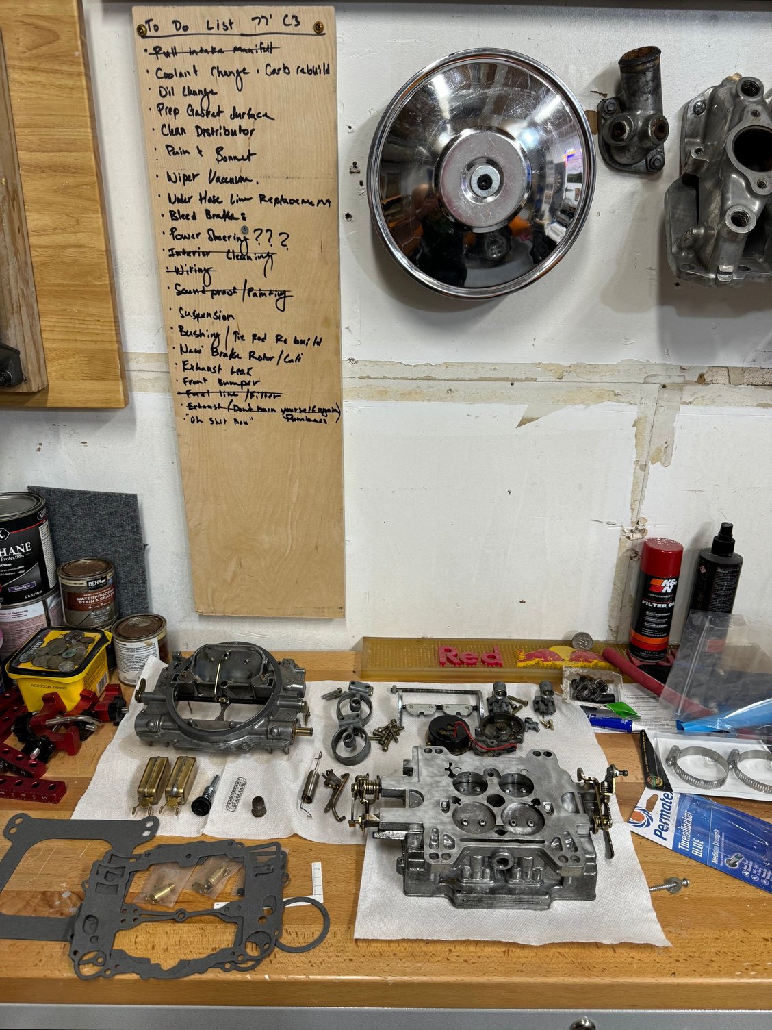

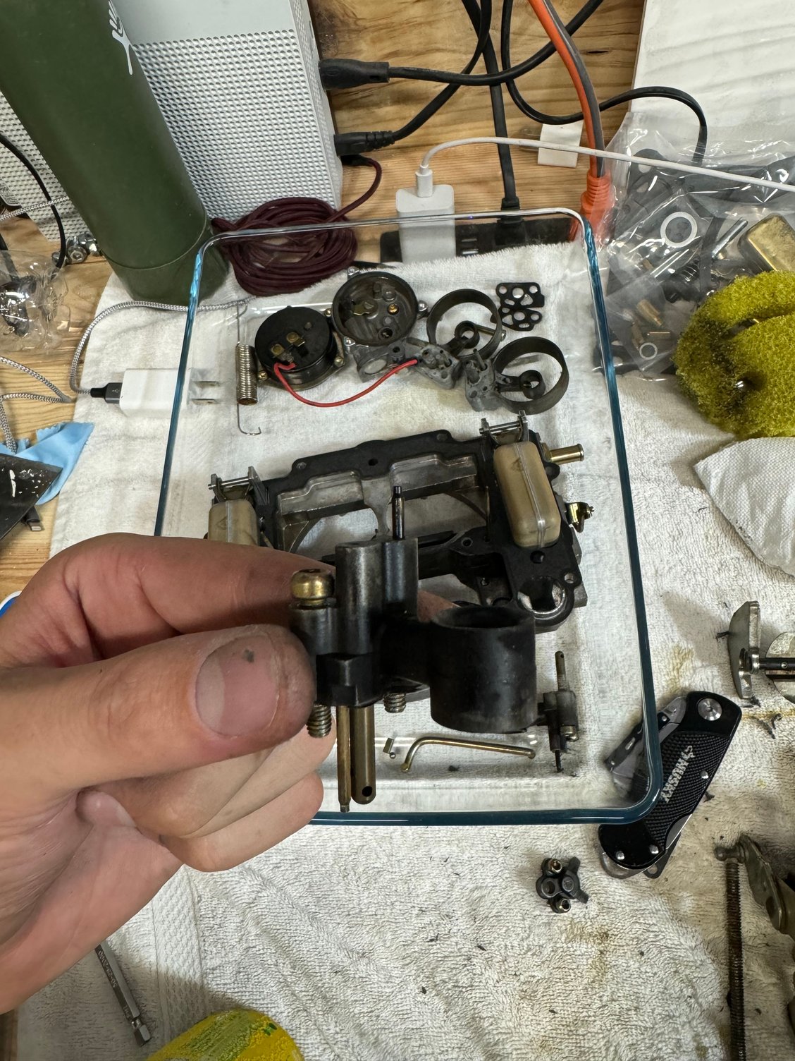

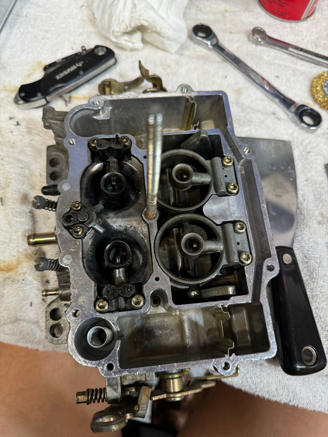

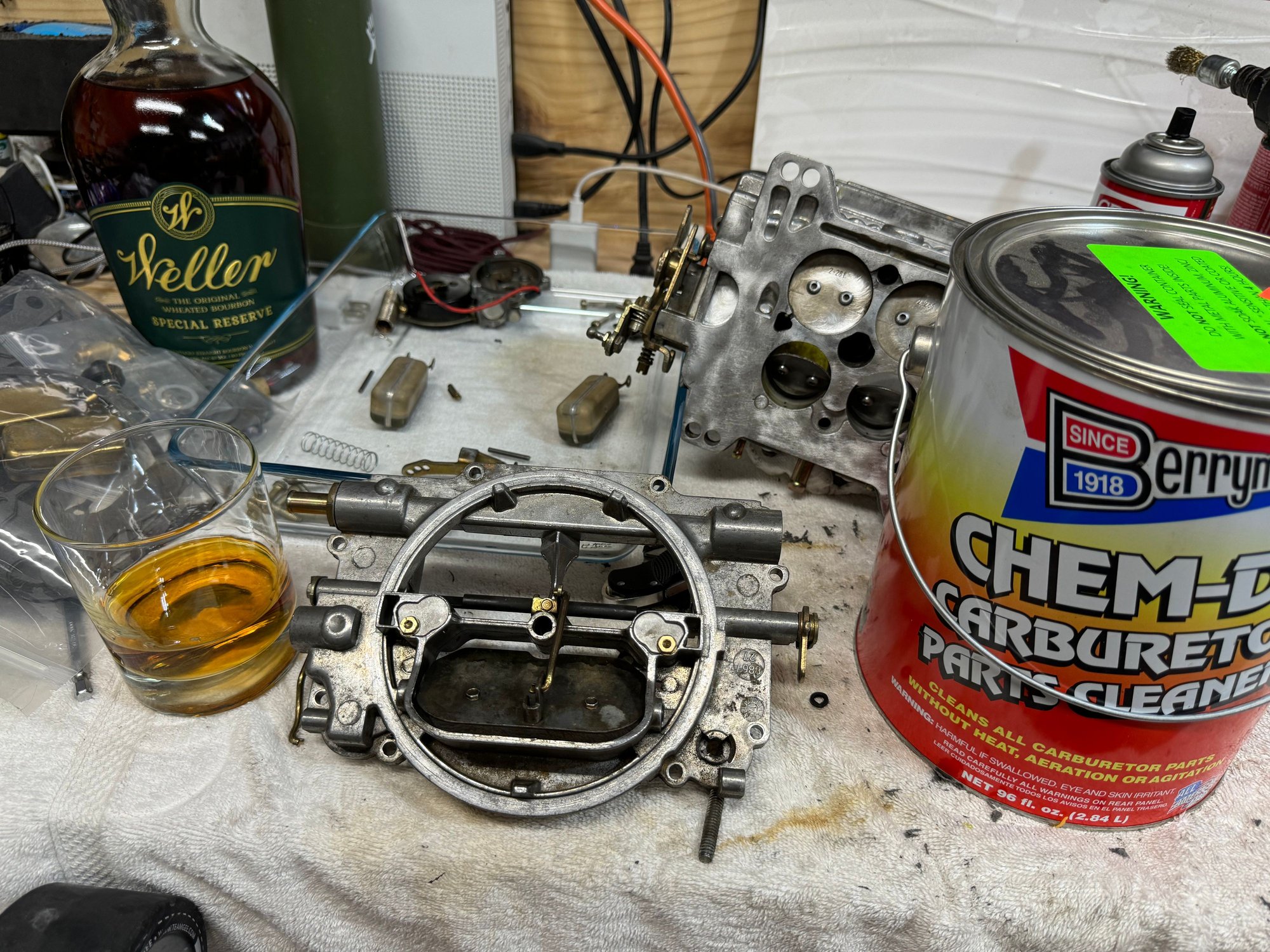

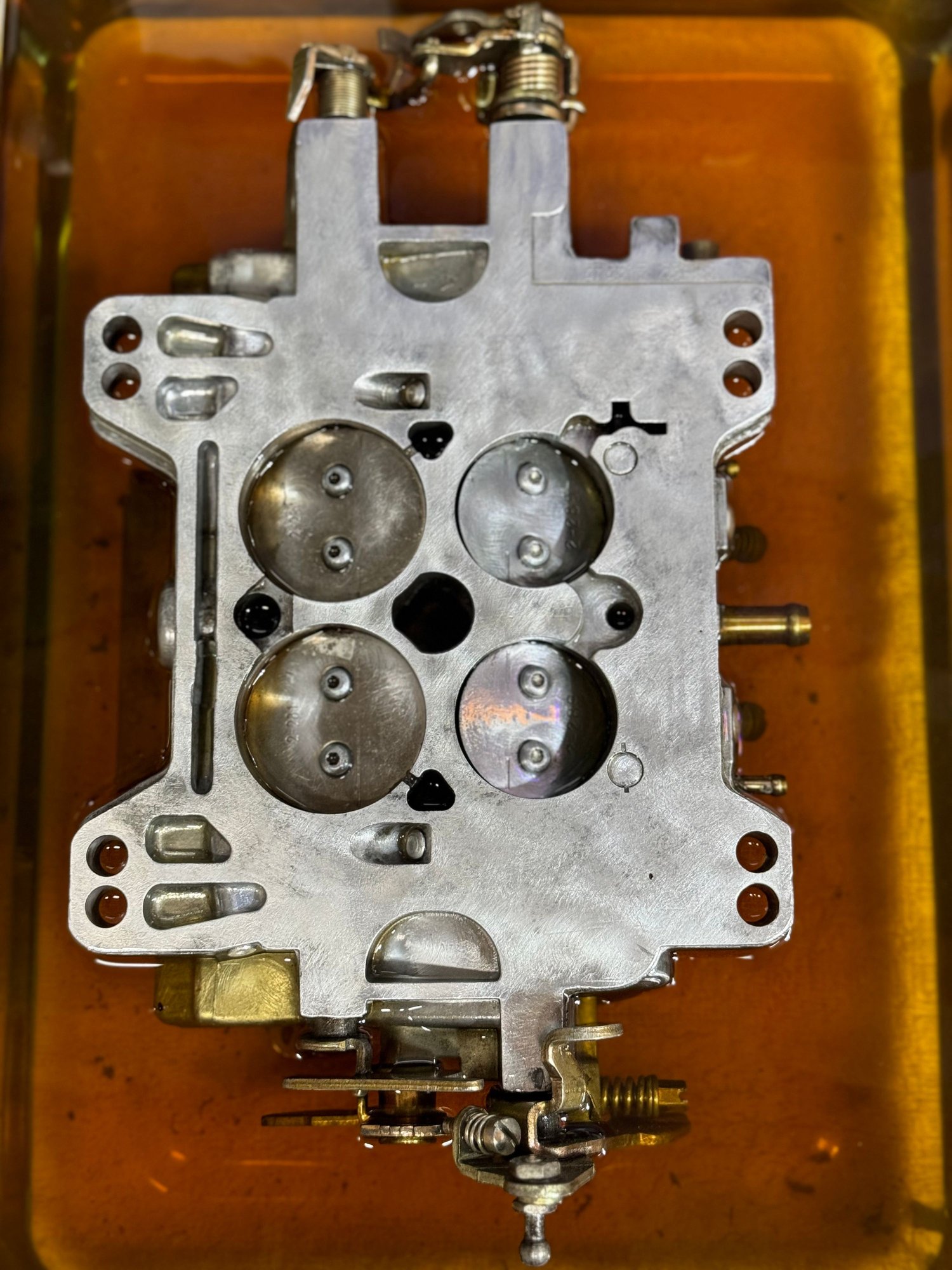

A few hours and a few glasses of whiskey got quite a bit of build up removed. Tomorrow will be the trial of putting everything back together. Fingers crossed i took enough pictures of everything to get this back in one piece on the first try.
Slowly making my way through my to do list, that will surely grow as i continue to work on the vehicle.
Parts List:
1.75L Weller Special Reserve
1 Gallon Carb Cleaner
Carb Rebuild Kit (1406 Edelbrock)

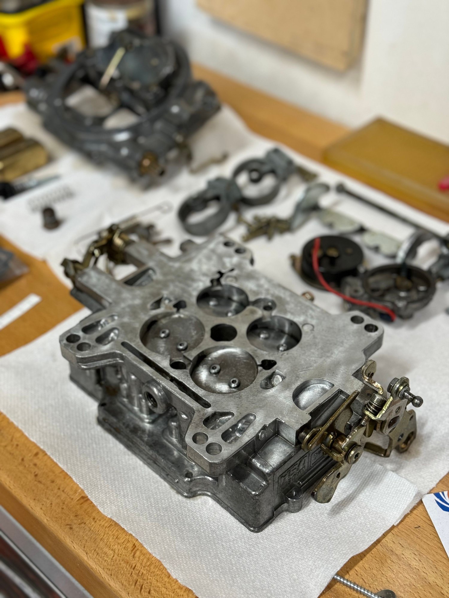

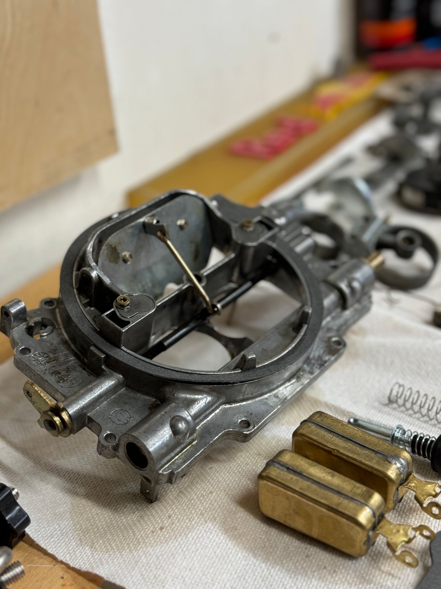

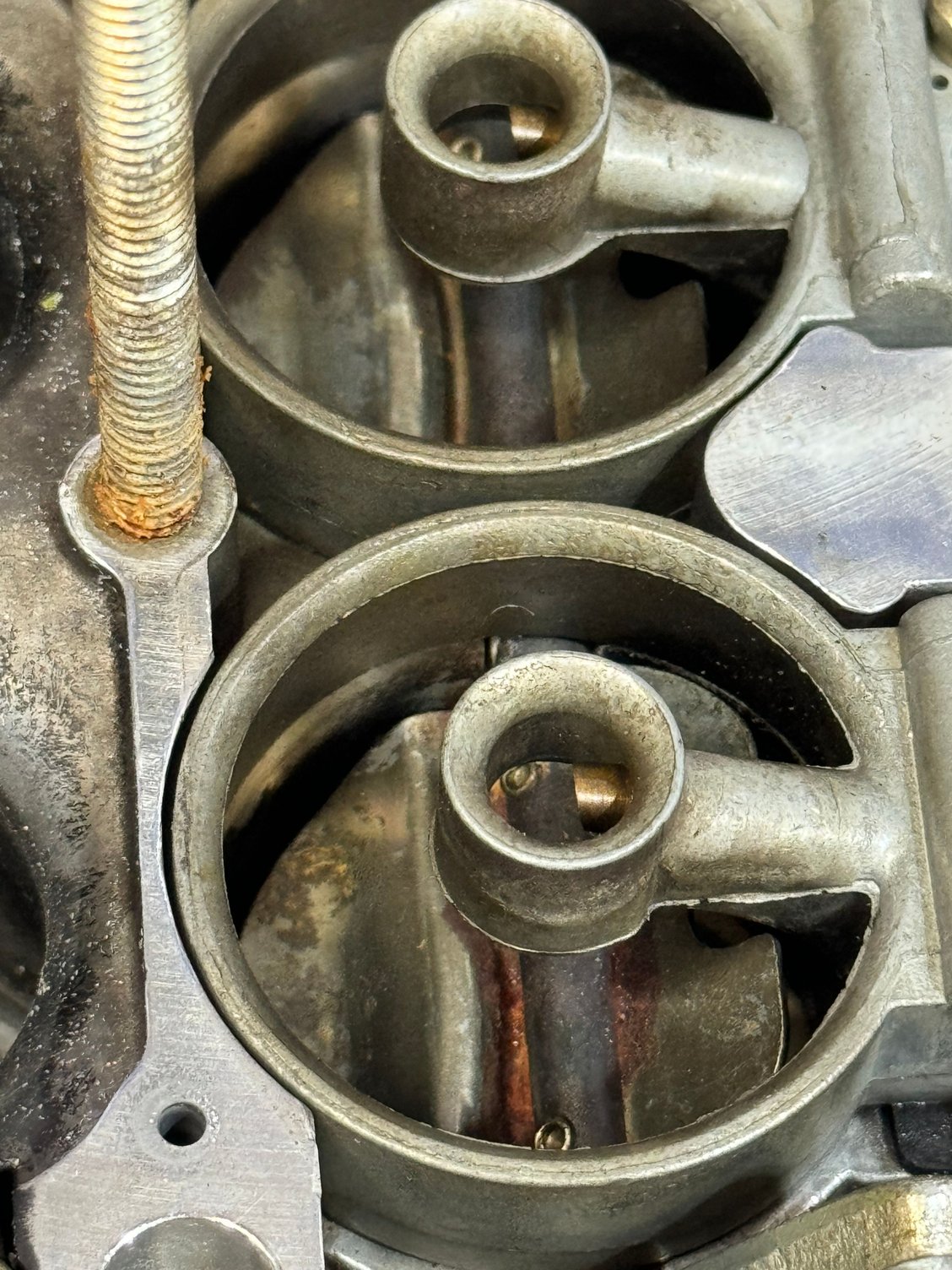

First carburetor I’ve ever rebuilt actually went a bit smoother than anticipated. Lots of second guessing myself and a half dozen Edelbrock Rebuild videos later and voila!
The difference in how clean everything was is great, also found that the secondary weighted flapper was actually rusted and not freely moving which definitely didn’t help my idling issue.

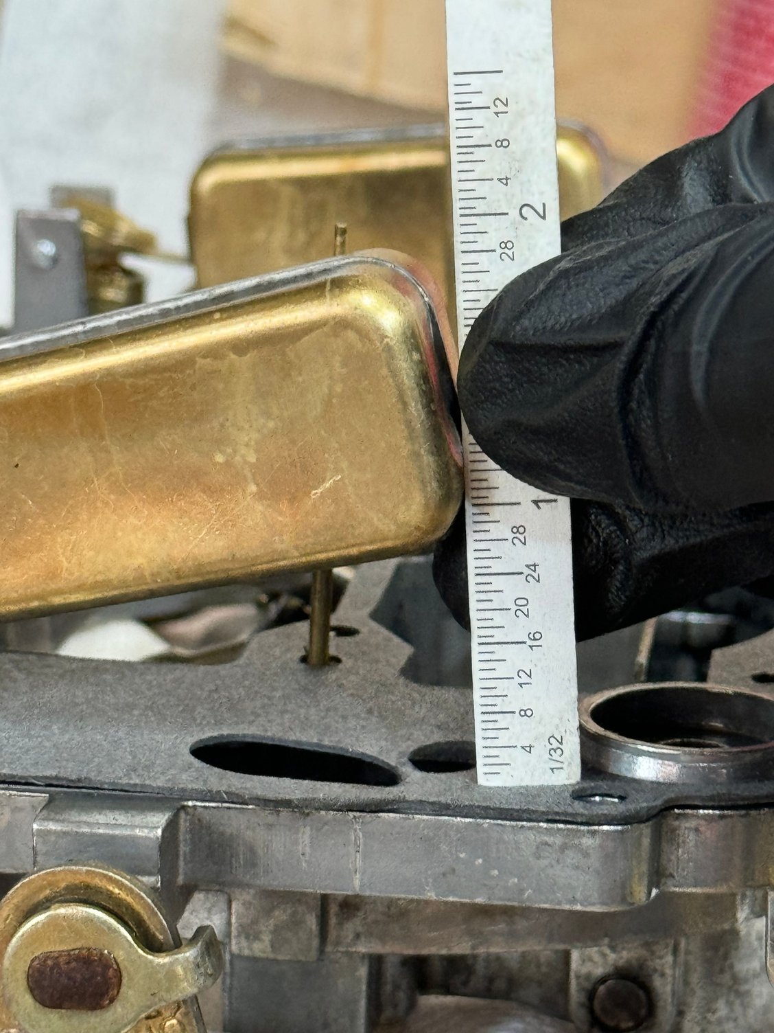

Resetting the floats to correct heights of 14/32nd at bottom and 30/32nd drop. Will say that the gaskets on this kit did not install as seamless as I’d hoped. Ended up grabbing an exacto knife and the sharpest pair of scissors I could find to trim out small pieces and make sure all the holes aligned properly. Guess thats just what you get from a $19 rebuild kit.

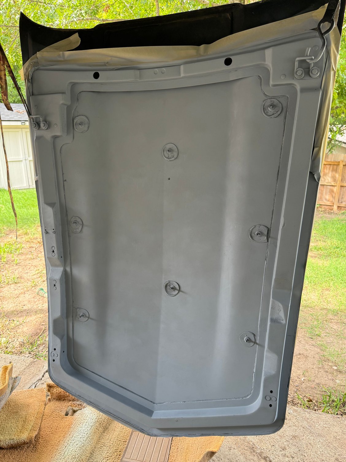

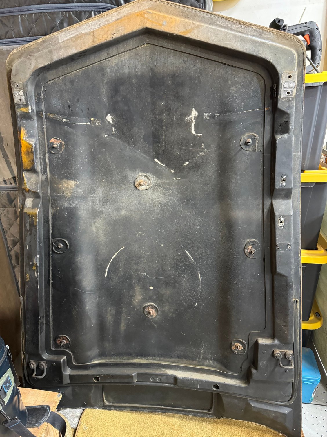

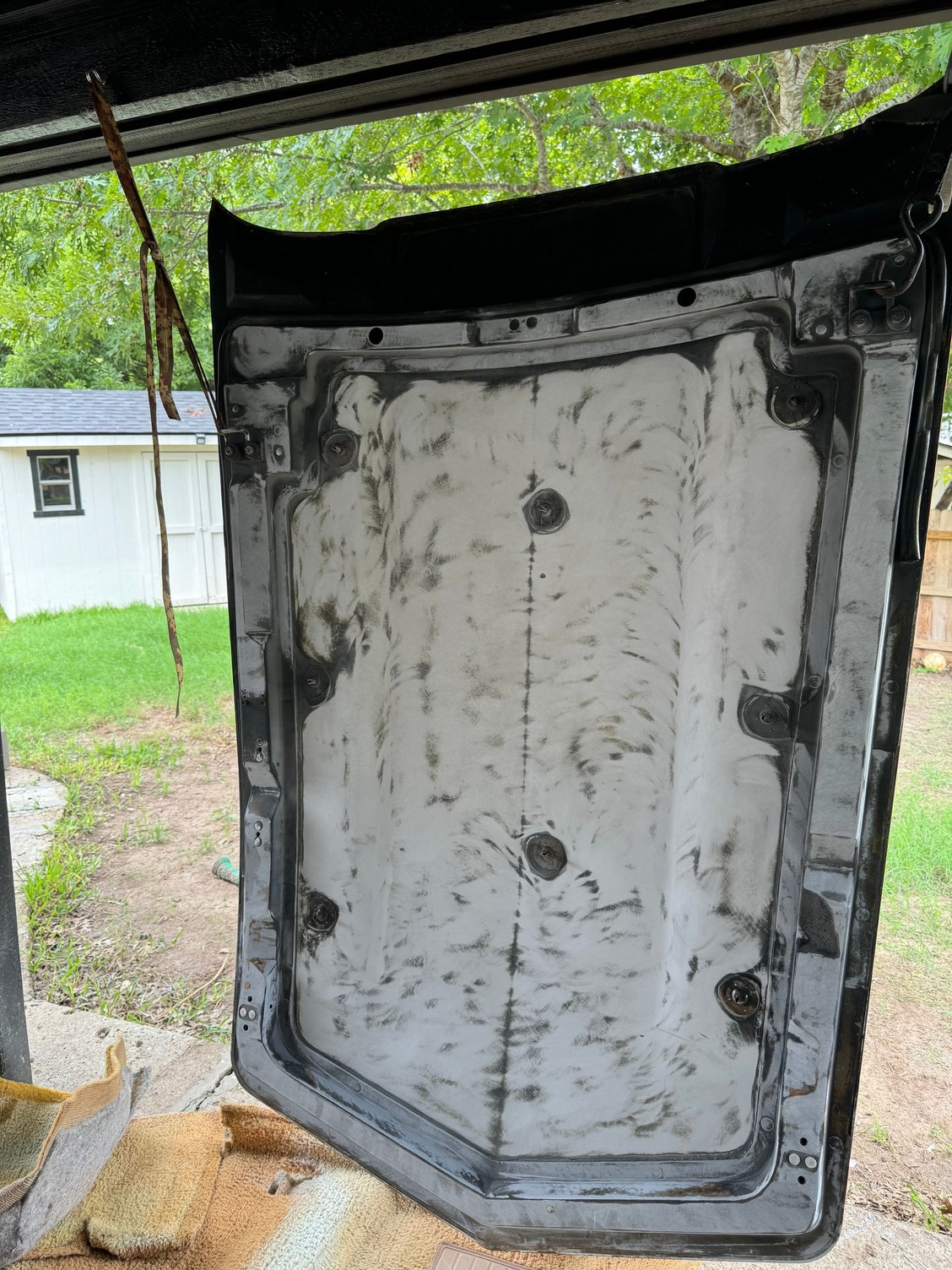

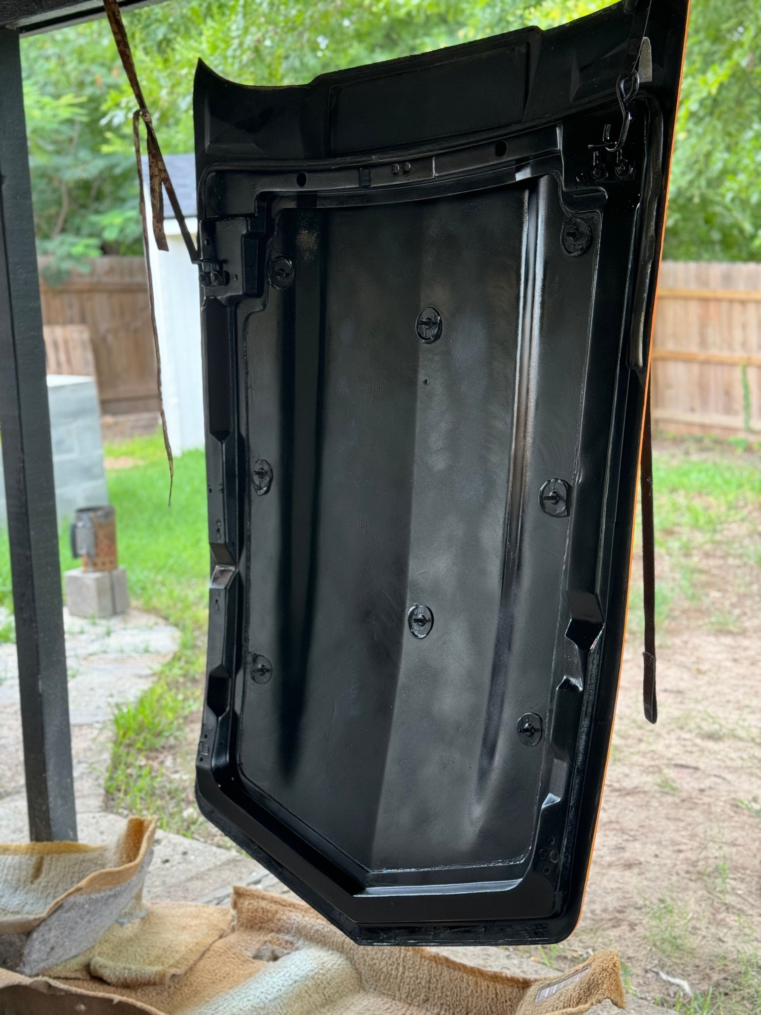

Now it’s a waiting game for the rest of the parts. So I started another side project, repainting the underside of the hood while i have it pulled off. Base coats of high heat primer put on, just need to grab some high heat matte black for the final coats
Parts List:
High Heat Primer

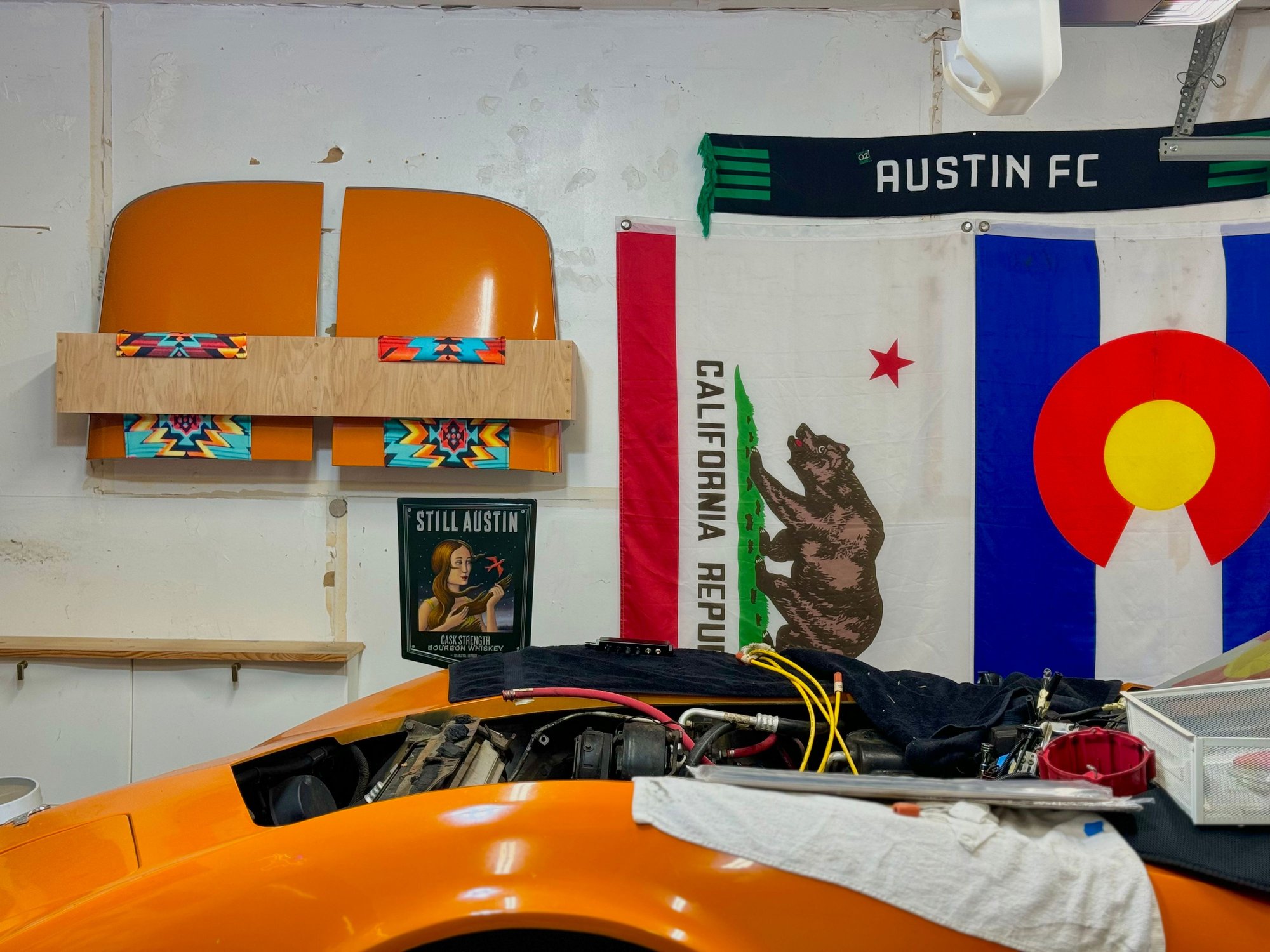

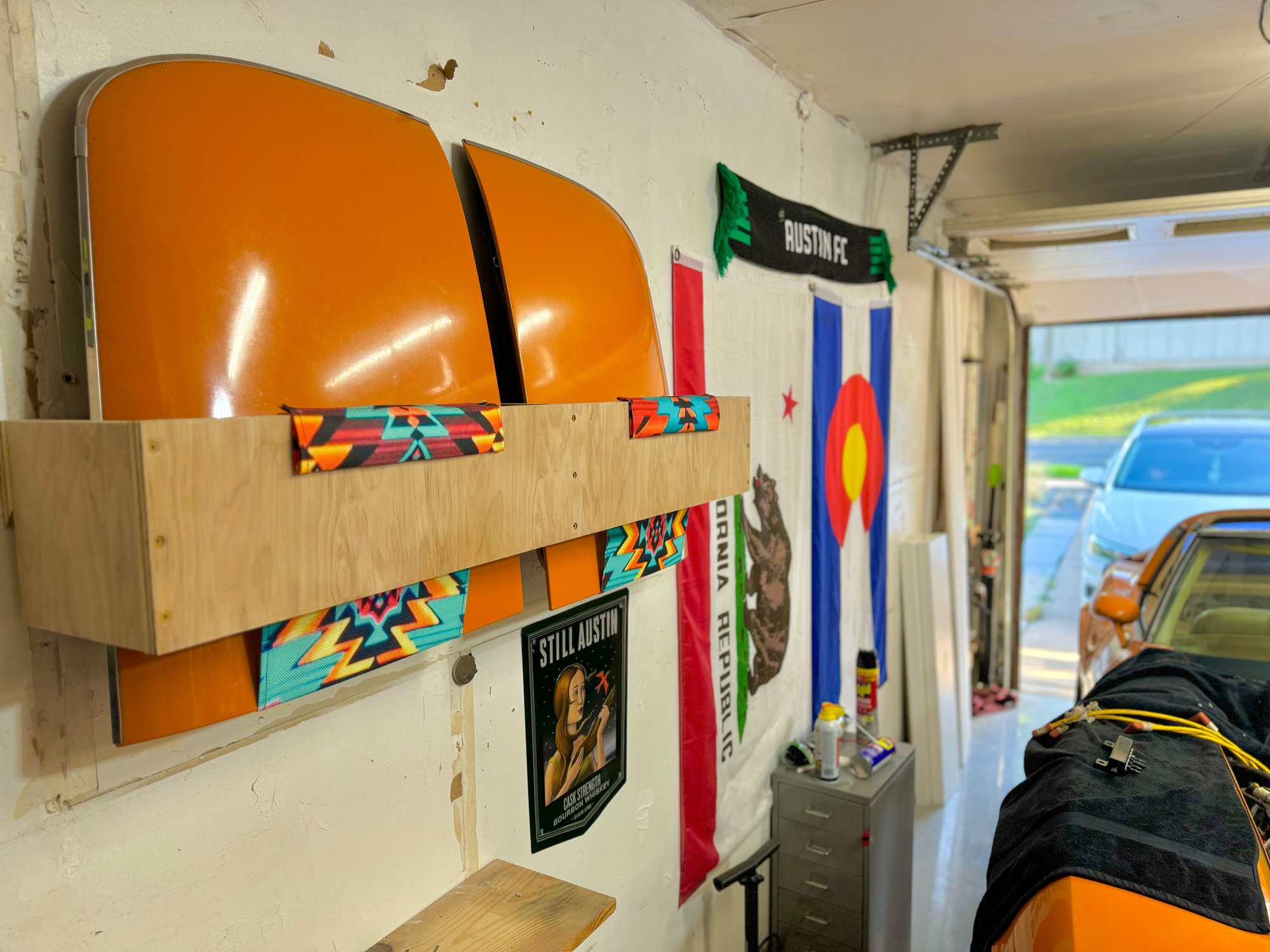

Stole an idea from another member for T-Top storage, but put my own twist on it. They had made essentially a 2x4 sawhorse to store the tops in vertically like this. I decided to dust off some wood work skills and some spare 3/4” ply from a cabinetry project and I’m honestly very happy with the results. Looks clean and adds a bit more decor to the garage.
Also finished up the underside of the hood with some high temp gloss enamel.
I wrote out the measurements for the T-Top holder. If anyone wants them send me a message, it’s a very quick build and I used some French cleats for easy removal of the whole unit from the wall.
(Please be kind about the current status on the drywall. It’s about 40 years old and is going to be replaced eventually)

Like the custom wall unit ............ can't see from the photos, but what exactly is holding your tops in place & don't reply "BRA" .................!!!
Old Jul 28, 2024 | 11:25 AM
  #35
BurntOrange_C3's Avatar
BurntOrange_C3
Joined: Jul 2024
Posts: 70
Likes: 61
From: Austin, Texas
Just bought a runner for a dining table and stapled/glued it down!

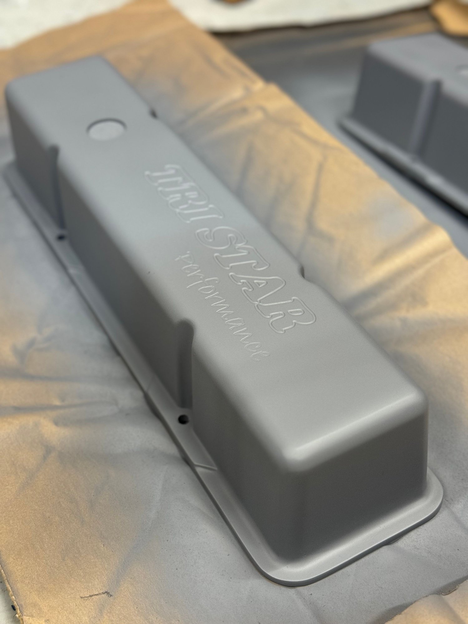

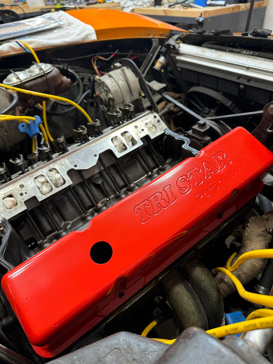

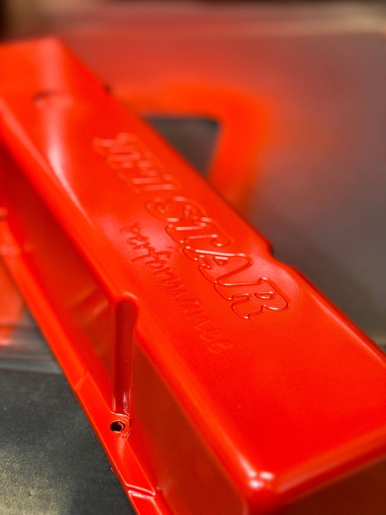

While I had the valve covers off, decided to give the tarnished aluminum some love. Prepped with some 400 and 800 grit sandpaper, a couple of liberal coats of 2000 degree primer and fresh red engine enamel. Ready for a the polished aluminum intake manifold to really dress everything up!
