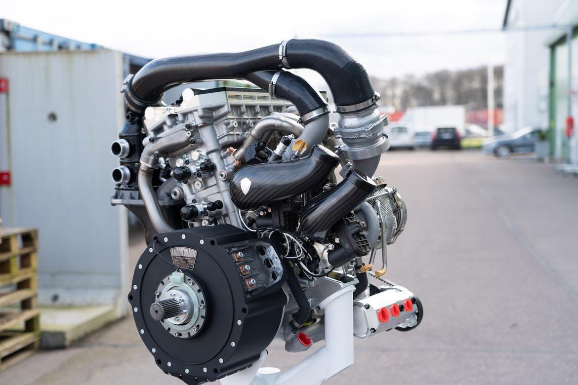

One of those Koenigsegg freevalve engines. It uses pneumatic actuators instead of a camshaft to move the valves. It allows for infinitely different combinations of lift, duration, and overlap to maximize power and efficiency at every RPM. Because it’s all controlled electronically there’s no need for a camshaft, timing chain, wastegate, or throttle!
The 2 liter, 3 cylinder version makes 600hp

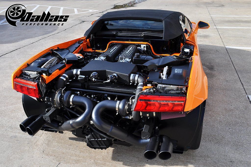

You lost me at automatic transmission, but here's a twin turbo that actually got installed and completed.
https://www.corvetteforum.com/forums...car-build.html

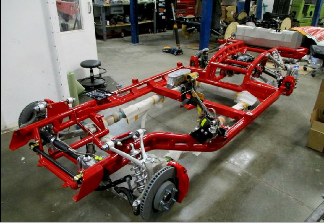

C3s are very narrow compared to C7s. But with a Modern frame and C7 suspension, and L88 flares, you could put really wide tires on it, like 335s, and get "most" of that 1000 HP to the ground!
No way I would stick with a stock C3 geometry suspension and weak 400HP IRS parts with your concept!
SRIII is pretty much the cream of the crop in the chassis department, with a C7 suspension and tube frame, and it could be bolted in at home!
https://www.sriiimotorsports.com/
There are other chassis options as well:
https://www.detroitspeed.com/product...n_and_chassis/
https://artmorrison.com/
https://www.streetshopinc.com/chassis-packages.html
https://roadstershop.com/product/196...-mount-options

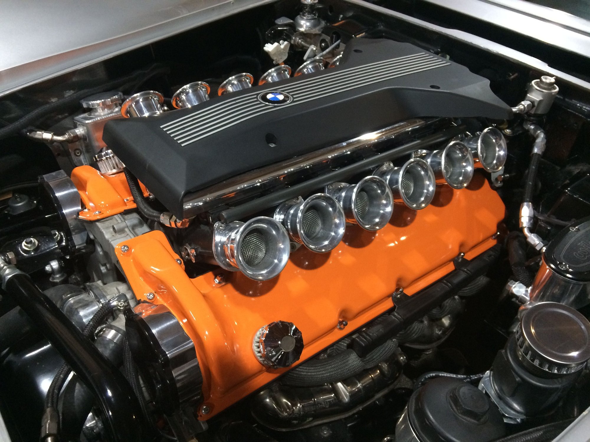

The orange C3 with the flares - started out as a 76. FWIW Dynamic Corvette copied another companies flares...Just sayin
Don't know how capable you are in of making parts- I did just about everything myself
$20K was gone in a blink of an eye.
You will need an engine management system- add the cost of wiring and tuning. ECU for about $1500 to handle the 12 cylinders-wiring/tuning $$$$$
Will also need more than likely a custom bellhousing- I also had to cut/pin/ thread a BMW flywheel as well...then there is the clutch.
Another thing you will run into is oil pan fitment- I went with 3 Stage Dry sump system for clearance- that an easy $5K
I used a BMW all aluminum V12-which I got relatively inexpensive as I bought a wrecked car.
Did custom ITBs.- fuel injection system-custom fuel rails- pumps- fuel line/tank- easily over $10k
Motor mounts- alternator mounts- Oil filter mounts- serp pulley system...that's just a start!
With the V12s- they have a very large front footprint- you will need to work around that as the crossmenber/a-arms- as take up a bunch of space in the engine compartment.
Oh- the exhaust- I was lucky as the my engine also found it's way into RHD cars (Japan) and was able to work out the exhaust manifolds by swapping sides.
I have a buddy who is an incredible welder- welded the system up- many lunches and c-notesfor the stainless steel down pipes and side exhaust....
