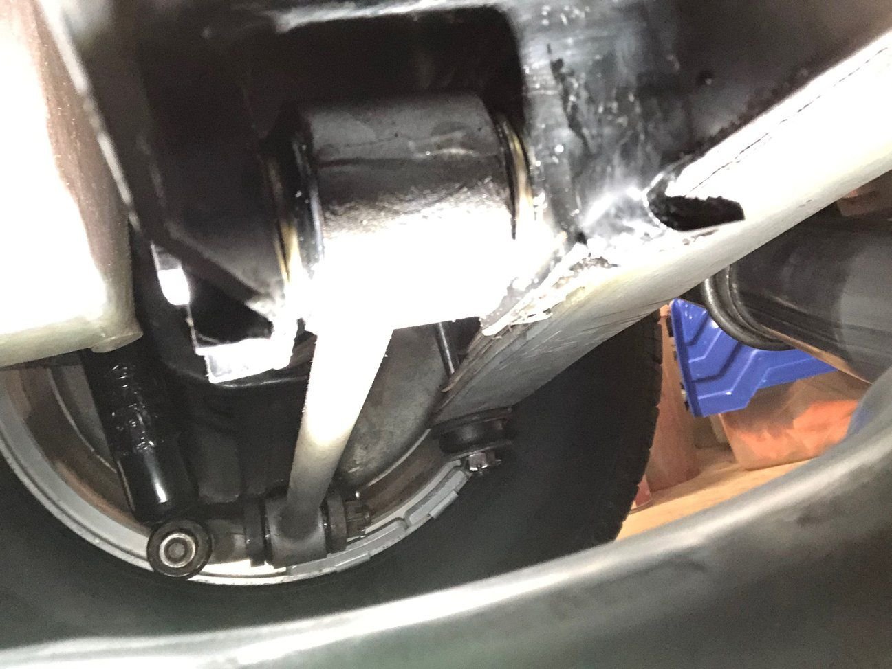

Question for y’all about the rear strut rods. The bushing are shot.
can I just remove the strut rod, knock out/replace bushings and put em back without completing ruining the alignment?
Im not opposed to replacing the strut rods entirely, seems to be not too much more($90 for rods, $27 for just bushings)
is it recommended to replace the strut rods?

It is recommended to replace the stock strut rods with heim-jointed strut rods. Be careful removing the shock bolts, though. That lead to a complete rear-end rebuild in my car.
You need a way to measure your camber and toe-in no matter what you do. @cagotzmann has some DIY threads on that. Use the money you save doing your own alignment for tools and better components!

this is my replacement and advice i got ,..went poly no issues, easier to put in. or as mentioned.. adjustable
https://www.corvetteforum.com/forums...-advice-2.html

Bikespace, interpon, thanks for the threads and great info.
should be getting the struts off and crossmember down tomorrow. I’ll def be careful with the shock mounts.
Diff is going out for 3.73 gears instead of 3.08
