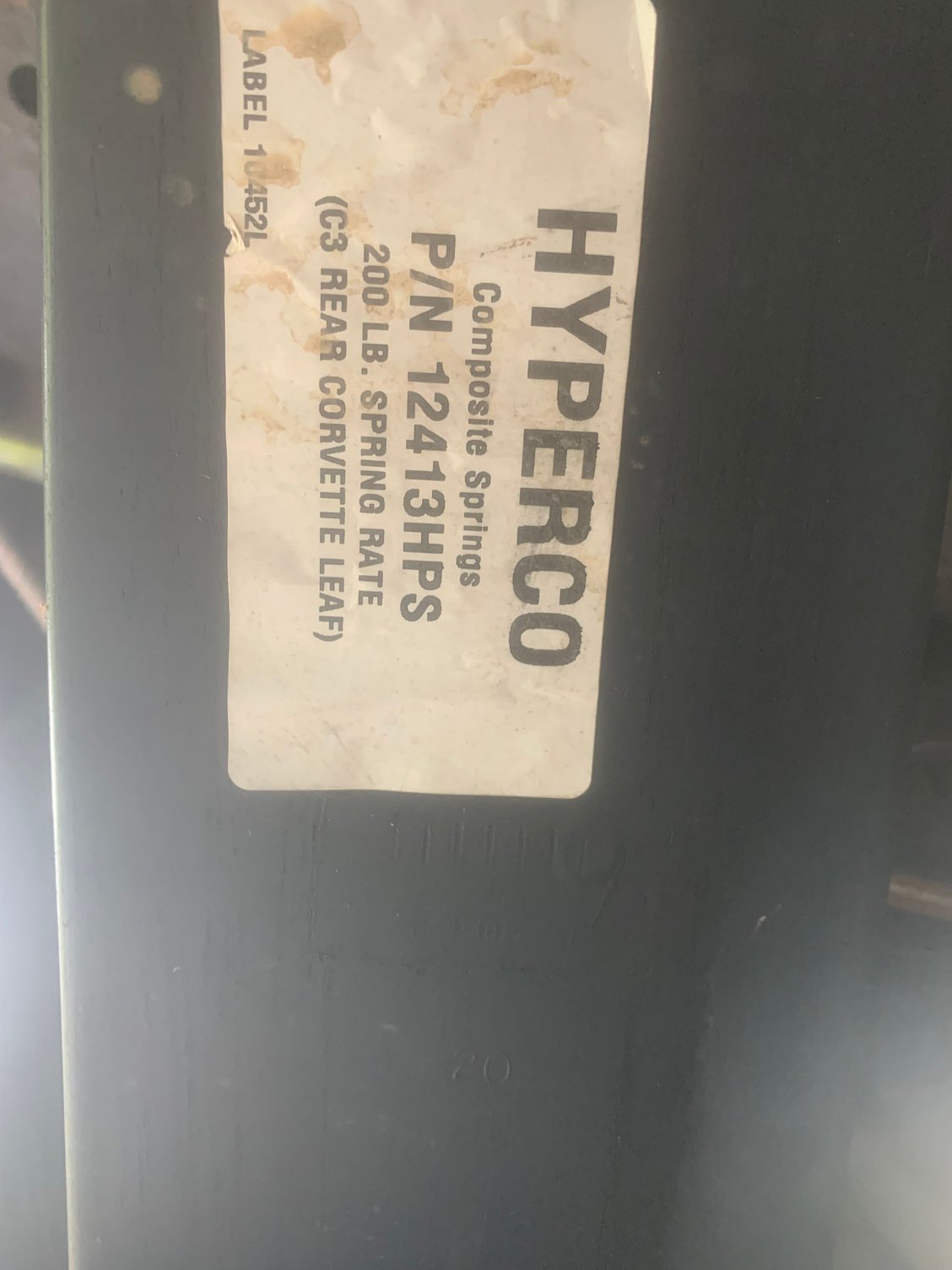

My 75 Vert has a new Hyperco composite. Reference photo of label and the ride height.
It rides very comfortably.

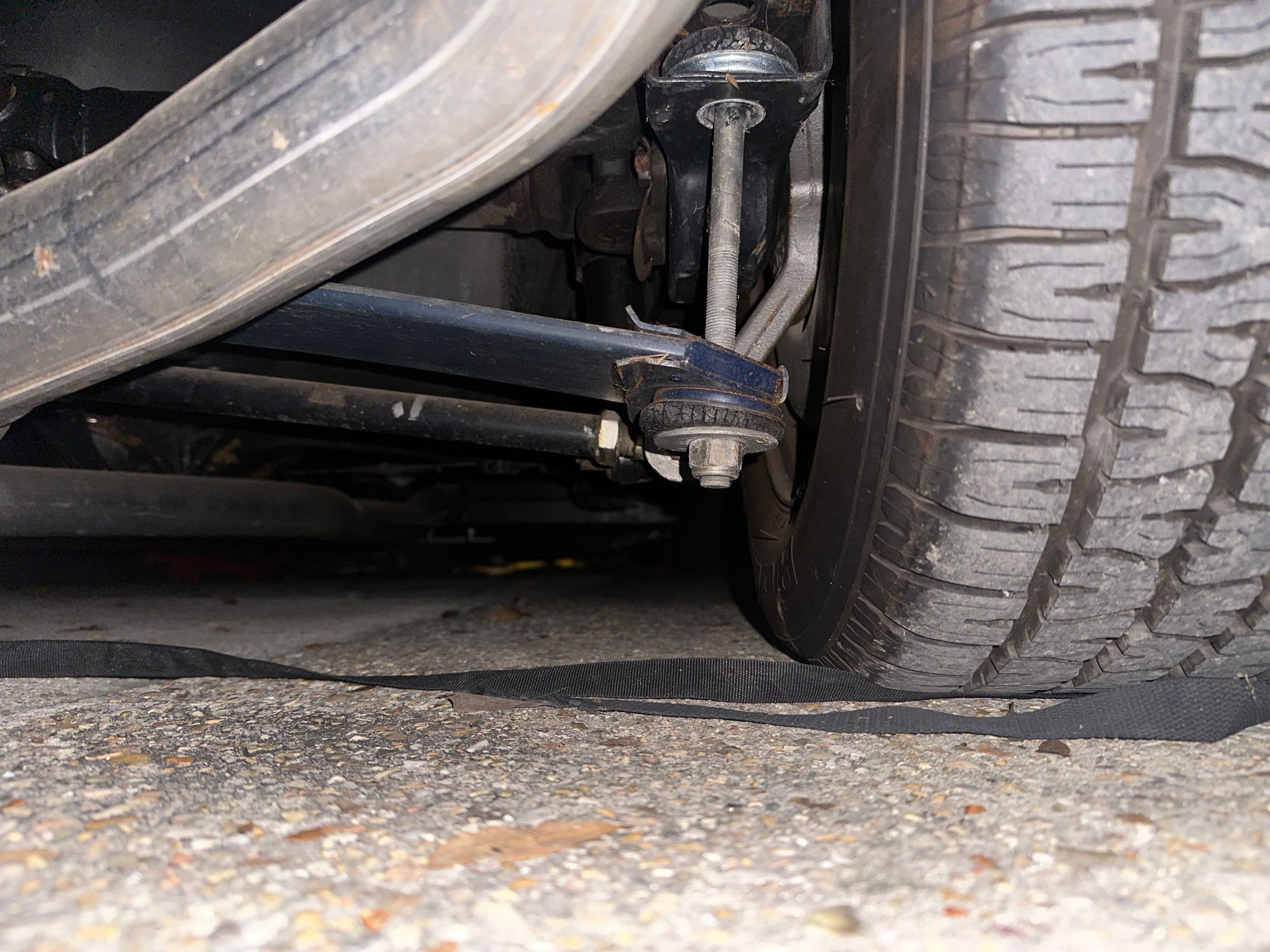

Add on to my post - I acquired my car with the Hyperco spring already installed. My half-shafts are perfectly flat. I have 8 inch bolts using Nylock nuts. I can fit my hand between the tire and end of the spring. I don’t know anything about Hyperco springs, but apparently they have been around for a long time.
My concern is it is only a 200 lb spring. When I eventually get a hard top for my Vert, it may be too much weight. How are you choosing your weight rating?
Until Inget a hardtop, it rides great.
See additional picture (yes I can use a new bushing). The angle of the pic makes it look closer than it actually is.

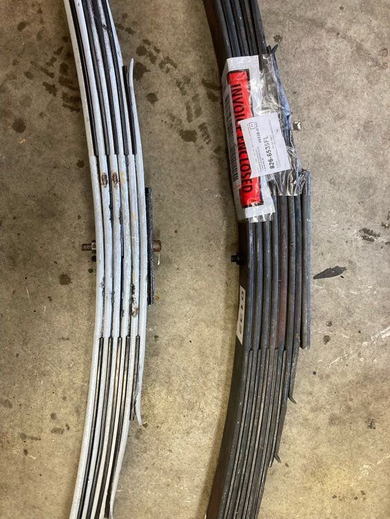

Old Oct 19, 2024 | 01:59 PM
randallsteel's Avatar
randallsteel
Posts: 1,043
Likes: 414
Appreciate everyone’s input.
I went with the Eaton HD 7 spring. The van steel mono spring was a close second.
got the old spring out today. The shocks are pretty blown too. All the bushings are trash. Should be a good refreshment opportunity. Also going to change out the diff fluid.
