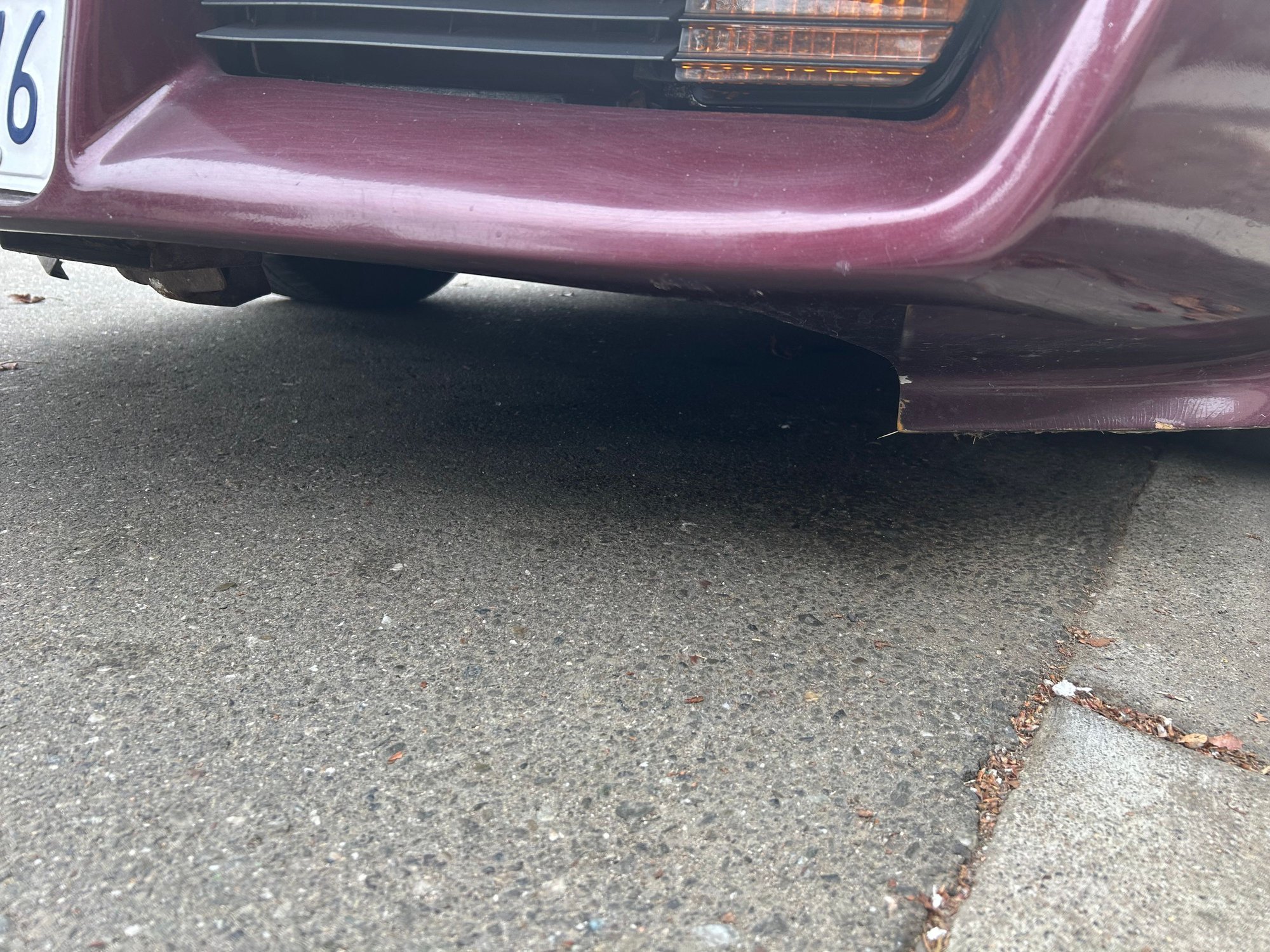

What’s is this missing part?
Old Oct 14, 2024 | 02:20 PM
mclovin69's Avatar
mclovin69
Joined: Oct 2024
Posts: 30
Default What’s is this missing part?
Old Oct 14, 2024 | 02:24 PM
Tampa Jerry's Avatar
Tampa Jerry
Joined: Aug 2005
Posts: 6,528
Likes: 1,961
From: Temple Terrace Florida
Could it be the spoiler?
Old Oct 14, 2024 | 02:27 PM
MelWff's Avatar
MelWff
Posts: 18,699
Likes: 2,572
Look at the exploded diagram of the front
https://www.corvettecentral.com/c3-6...on-pair-333155
Old Oct 19, 2024 | 12:35 AM
7T1vette's Avatar
7T1vette
Posts: 37,637
Likes: 3,116
From: Crossville TN
That is the front air dam. It is important for the C3, as the radiator is angled 'oddly' and requires "help" to get adequate cooling air going through it. The air dam does just that. It is not really a 'spoiler' for aerodynamic purposes, but many folks call it that.
