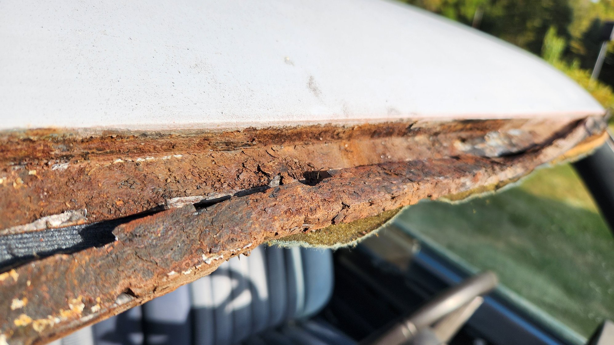

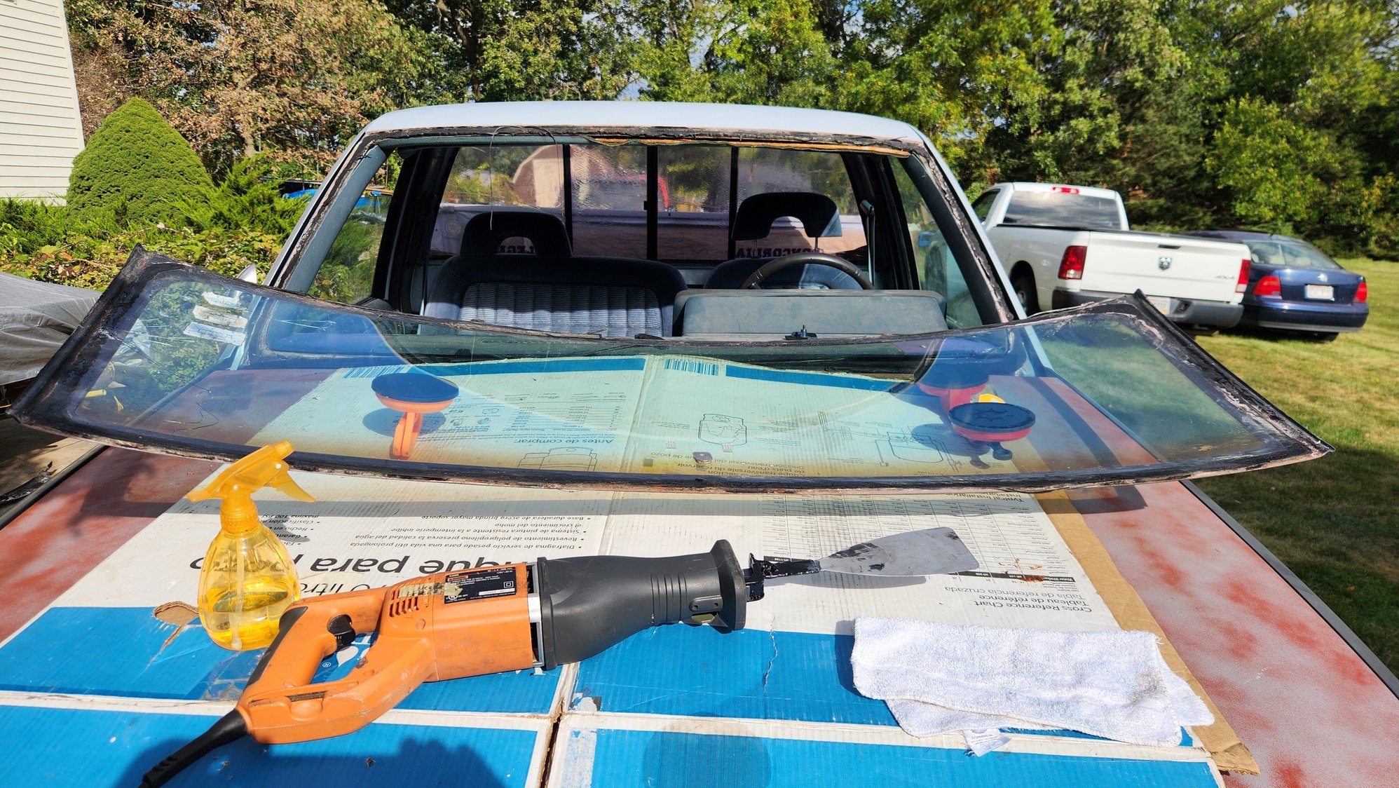

Below shows my home-brew sawzall Torpedo tool adapter. It took a lot longer to make than I planned ...the tolerances have to be tighter than I had figured. I like making tools as needed, but this one was a waste of time..lol. Looking back I wish I would have spent the $110 for the Milwaukee Hackzall and $12 for the mount/adapter ....esp since I already have M18 batteries. Plus a sawzall is longer than a Hackzall, which isn't desireable inside a vehicle. But overall it works great now that I have it. Actually works fantastic. I've used it on a couple windshields and other projects. Those OBS Chevy tk windwhields are known for being rather difficult to remove. No problem with the tool. Another windshield I thought I would see how easy it was with the wire first. After 10 or 15 minutes of sweating and sawing and not making much progress....I put the Torpedo tool to it and it was out in like 5 easy minutes. If I would have had a strong helper, the wire would have worked ok on the other vehicle. Note: You can see how to lay the glass out, and then just tilt the new glass up into place during install. A 4x4 pickup is a lot bigger/harder longer reach than a C3. One person can do it, but a competent helper would be handy.
The 2nd pic shows rust on the pinch weld (same vehicle). I sandblasted it clean. Hope you don't run into THAT!! I can't believe it didn't leak water! Um...don't worry...the 'Birdcage' is fine on it ...LOL. It was just the pinchweld area.

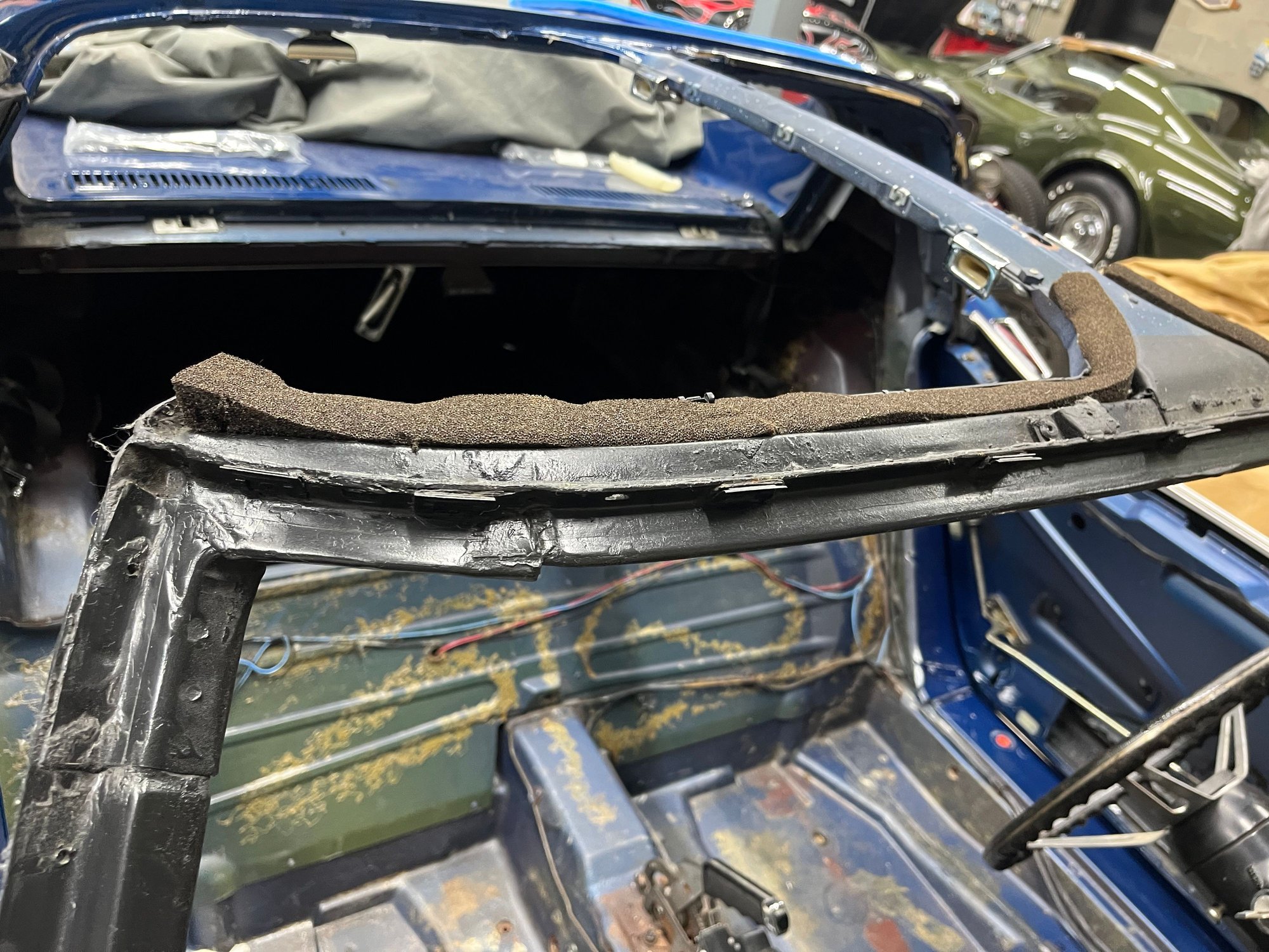

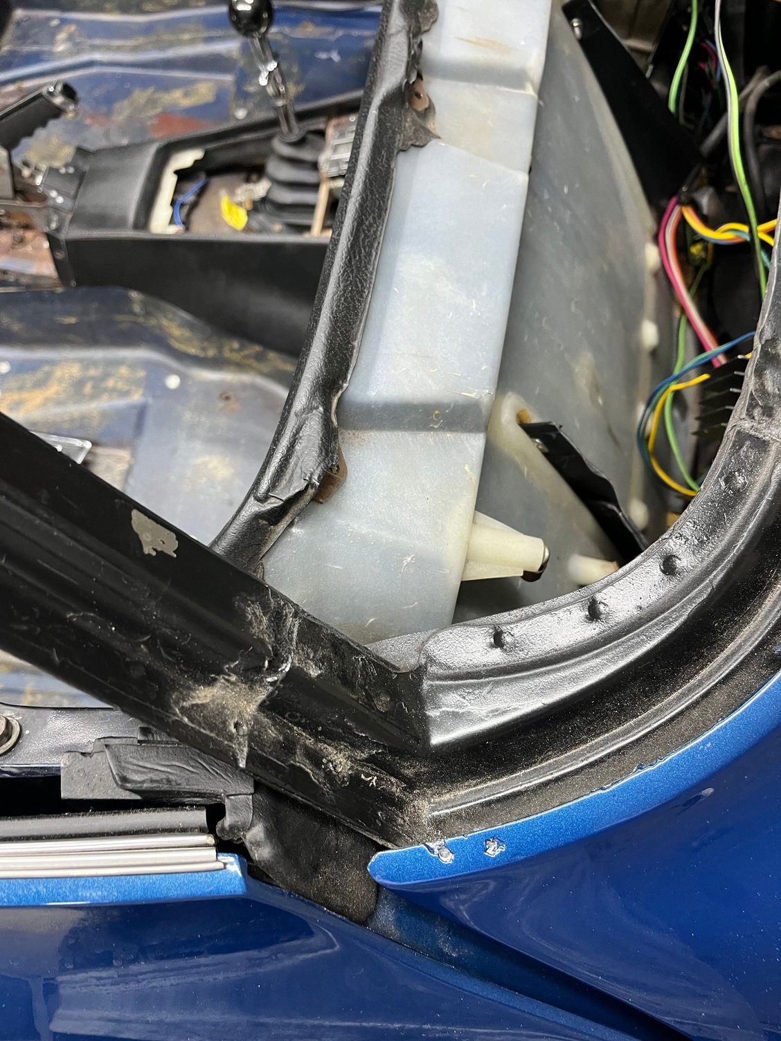

Thank you for the replies thus far I am this far on the car and yeah, it was a pain in the rear to get the old one out and get it this clean but here we are. The glass arrived yesterday and going to unwrap it over the weekend to make sure it’s good. I’ll keep you all posted and thanks for the great information.
To New windshield installation.

Looks really good! Scuff up the paint there where the adhesive will go with a scuff pad. If you had any thoughts about removing your dash (heater core??) put the glass install on the backburner and do that now with the interior and glass out. Otherwise, she looks good for fresh glass.
P.S. Is that foam in the upper windshield frame tray... a NON Moisture Absorbing foam? I'd be hesitant to put anything in there which would or could hold moisture.
Old Oct 24, 2024 | 09:58 AM
charliedents's Avatar
charliedents
Joined: Jan 2012
Posts: 156
Likes: 24
Thank you for the advice. I am the second owner of this car. It only has 17,000 miles and it was well kept before I got it. The dash has been out cleane,speakers repaired. Anything else that needed to be done. The heater core also done. The foam was just put in there for fitment of the upper stainless moldings. We use something different. Car is never going to see weather stays in the heated floor garage.
