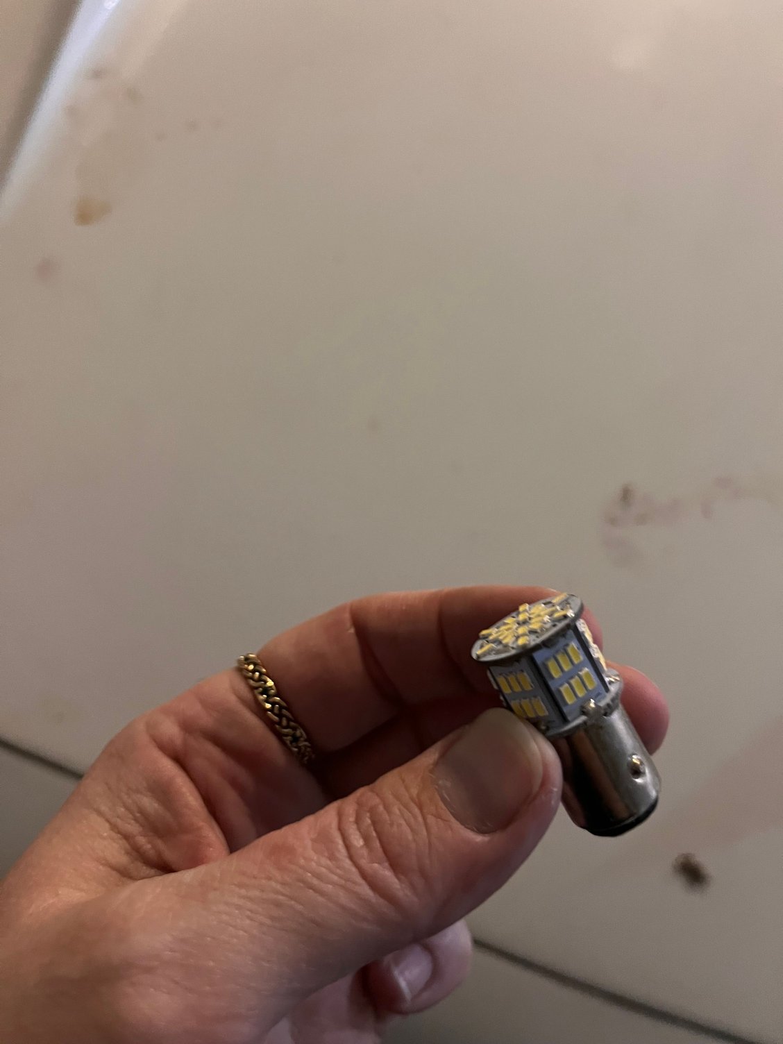

Hi - I had a rear tail light LED burn out, and am looking for a better replacement.
Picture attached. Can I do better? I think this is from SuperBright LEDS but I'm not sure. Flasher relay for LEDs already installed.
(This is for the Brake lights only. I'm thinking of buying RED LEDS to improve things but would like to hear other's experience.)
Overall just looking to improve safety. Will even install MORE brake lights if necessary.
Thanks for any help!

Having tried Superbright LEDs (which are very good), I changed to Philips which in my opinion are much better and noticeably brighter. The color output of your LEDs is meant to match your lenses.....red for red lenses, white for white lenses. White LEDs do not shine well through red lenses. These are what I use (red for brake and tail, white for back-up lights)........

These create a shadow out to the side from the white plastic post on either side of the LED. I used to run these but tossed them because of the issue.

Probably not what you're looking for but I buy the Regular Wagners like THESE. About a buck a piece. Each one lasts years, or has for me.
The LED bulbs I've used ended up costing me a LOT more over time so I quit using them. But they are brighter...which could be an important safety factor.

FWIW, the 80-82 lenses have the bulb come in straight, while the 79 and earlier lenses have the bulb mounted at an angle.
I don't know how easy it would be to change that in an earlier car, but the orientation can really affect the light pattern. There are also several threads on the Forum where folks have used LED arrays and completely replaced the 1157 and 1156 bulbs.
I just bought whatever bulbs were available, and didn't worry about it too much, but my 80 has noticeably better taillights than my 79, with similar LED bulbs.

FYI...use Chrome paint inside the light housings. It really brightens the lenses of original Marker & Tail lights.
