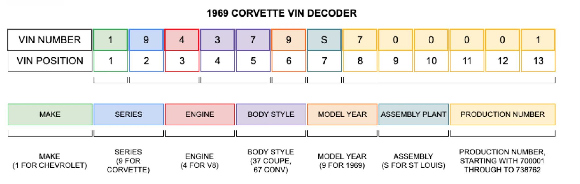

Here’s a VIN decoder for 1969’s if you’re curious.

The only thing you can tall about that particular vin posted by the OP is that the car is a coupe.
If the car does not come with the original build sheet or some other original GM documentation there is no way you can know all of the options the car came with. You can guess based on what you see but many cars have had things added and removed. Some have even been outright changed to be something they are not. So, be careful.
