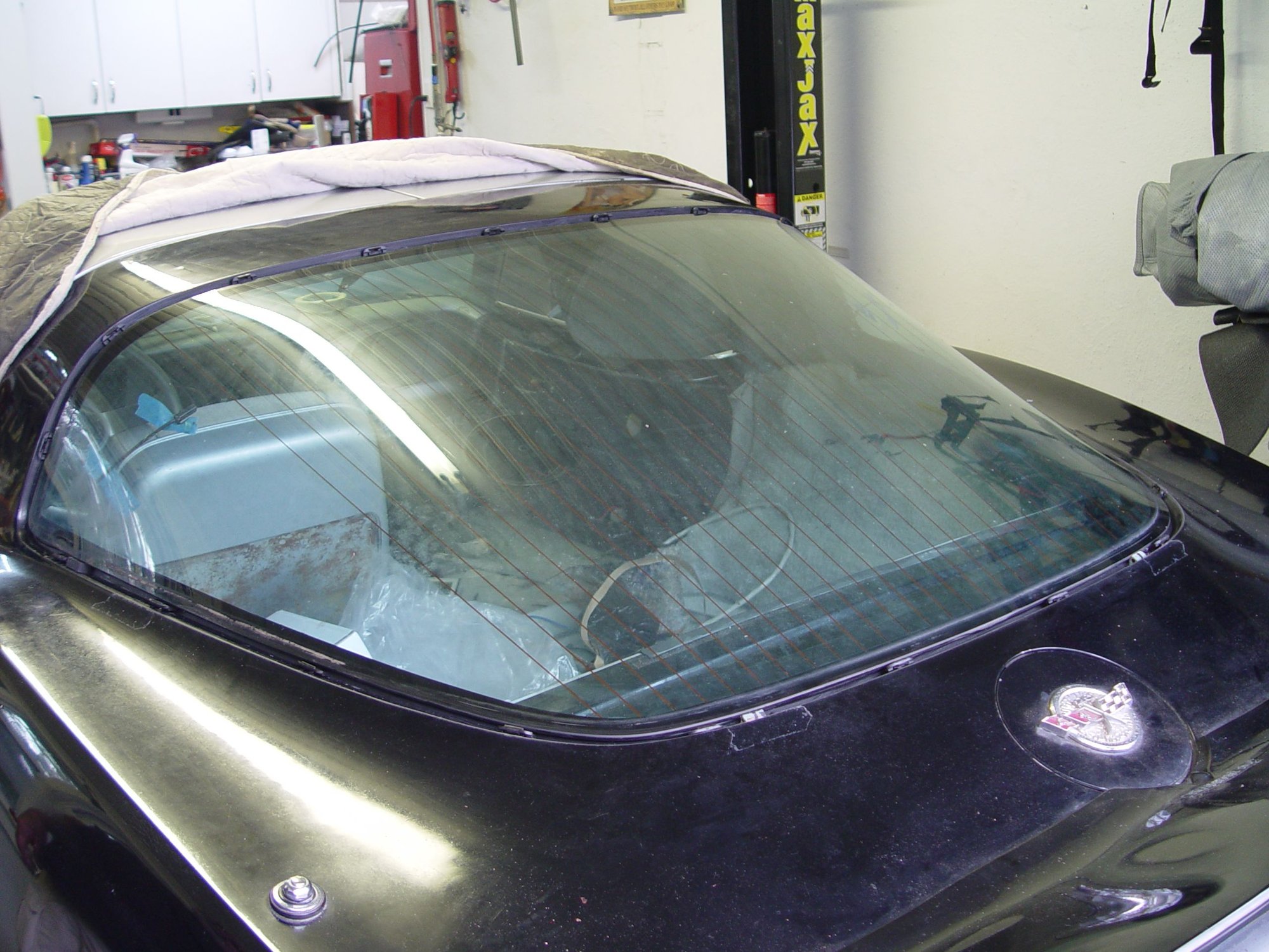

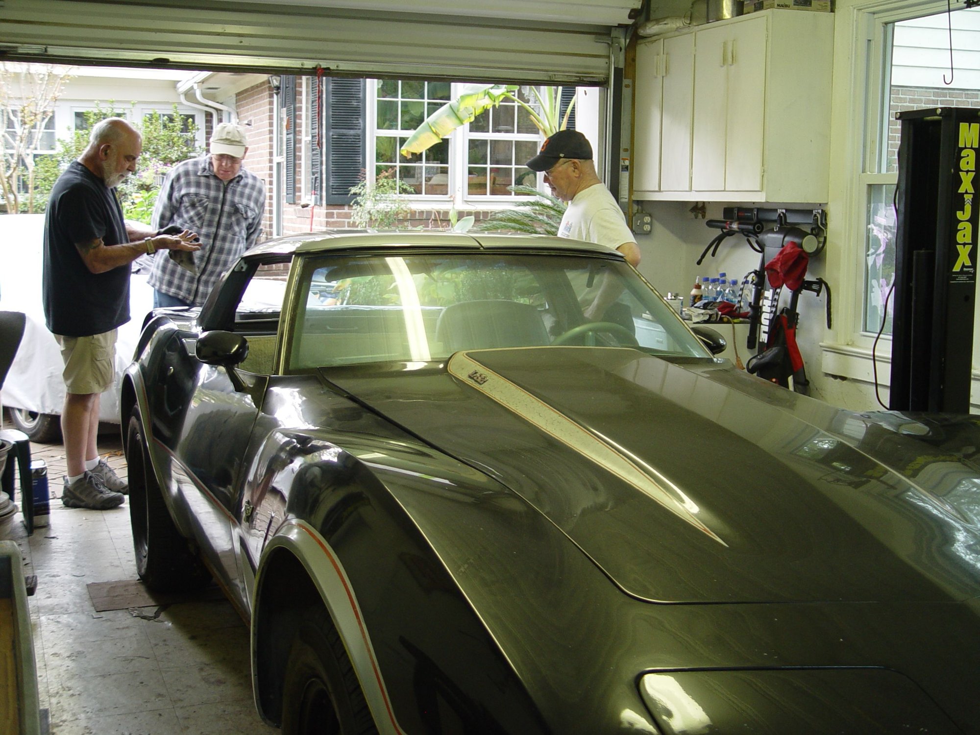

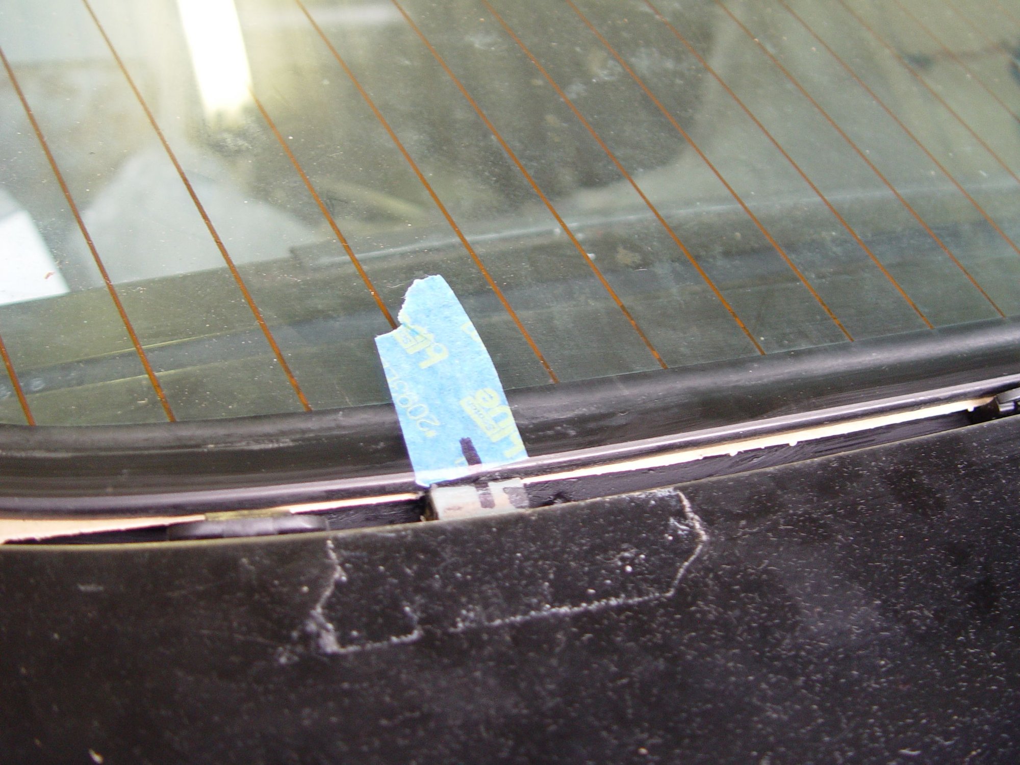

A team of forum members (kanvasman - Jim & Lou-Lou) installed a rear window in a Pace Car and this thread shares specific details that supplement some of the online videos that portray the process for members that find themselves in need of guidance. I began this process back in January of this year; that discussion and the preparation are in that thread, referenced here. Thought it best to start a new thread.
https://www.corvetteforum.com/forums...acement-2.html
Window Prep: Kanvasman had previously replaced a window and offered to assist. I took him up on his offer...to avoid his lessons learned. That's what we worked out and share here. The glass and body rear window valley had been cleaned thoroughly with 3M Adhesive Citrus remover. The Zip glass replacement kit was used and included primer, butyl tape and two placement blocks. See previous discussion thread; link above.

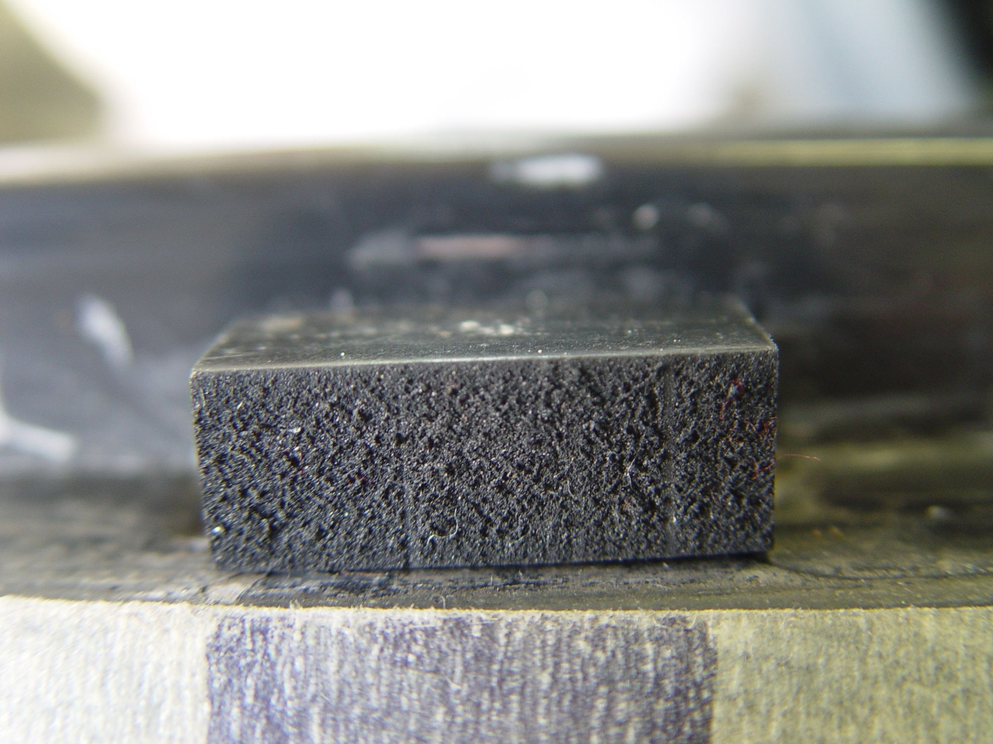

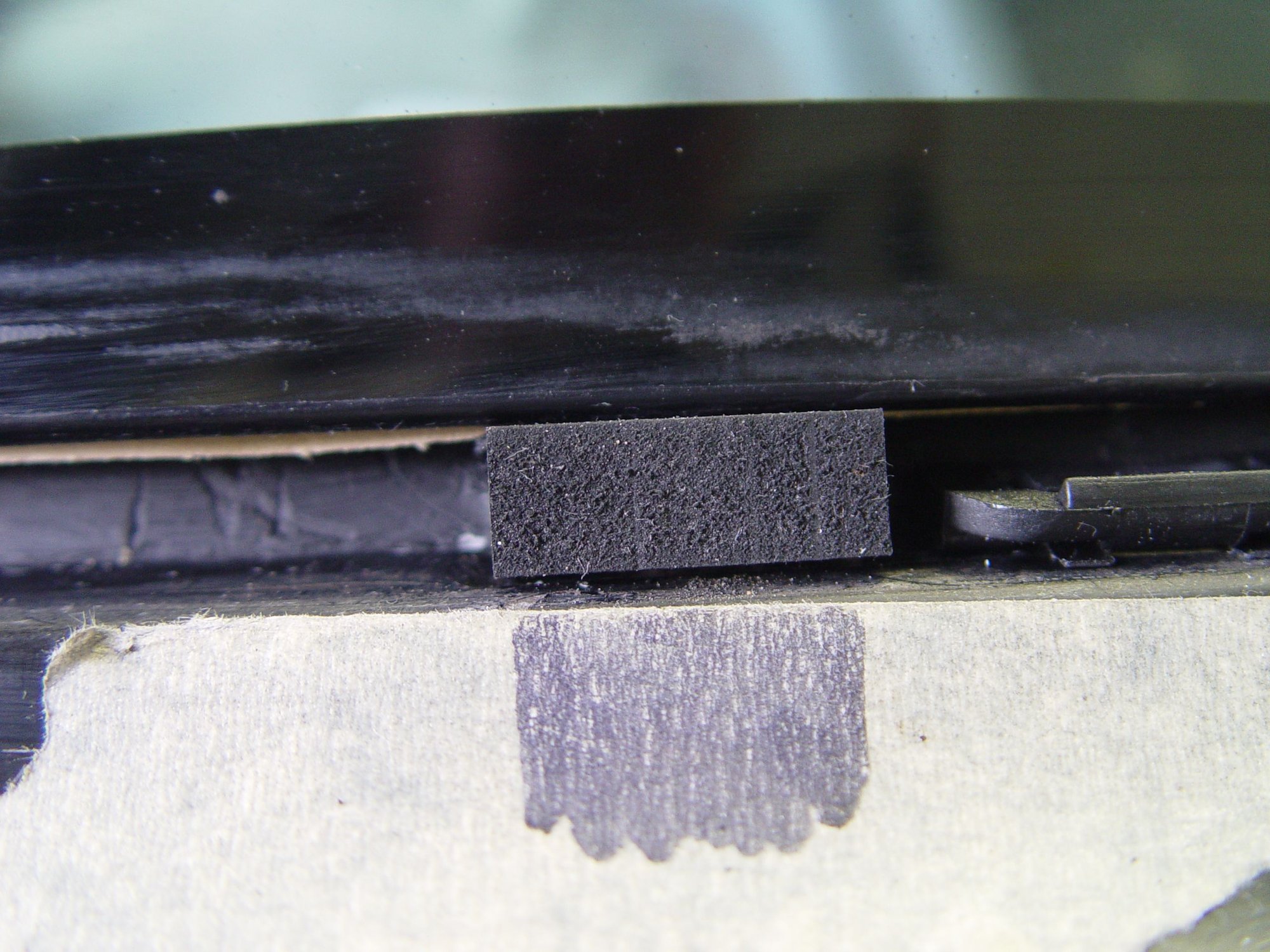

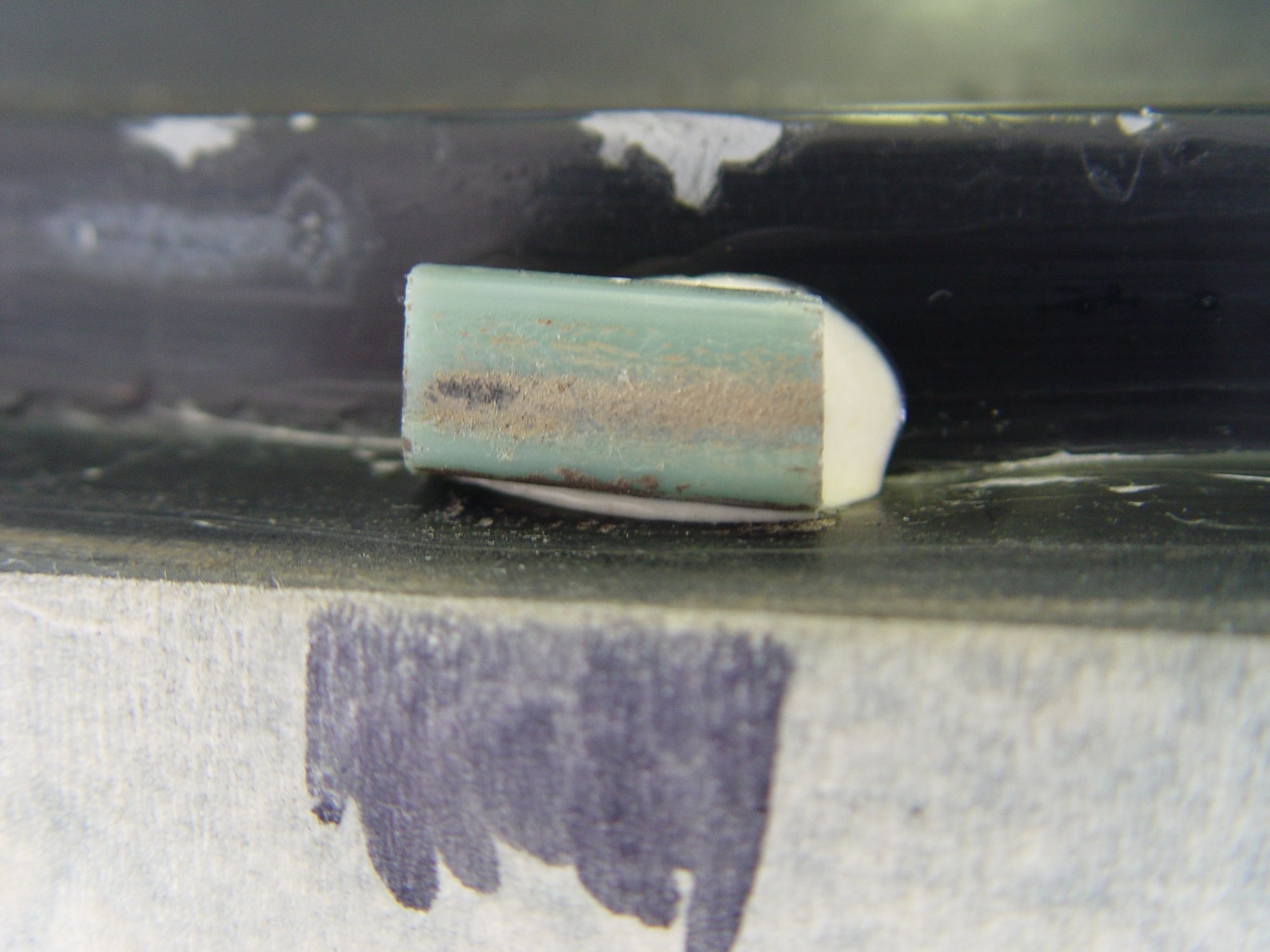

Dry-fit #1: With the rear window valley cleaned, the window was dry-fitted with the blocks to get a feel for the gap, top, bottom and sides. The blue blocks are the originals used by the factory; the glass butts up against these rear blocks. Blocks on the side are from Zip; the glass edge rests on top of the block on each side.

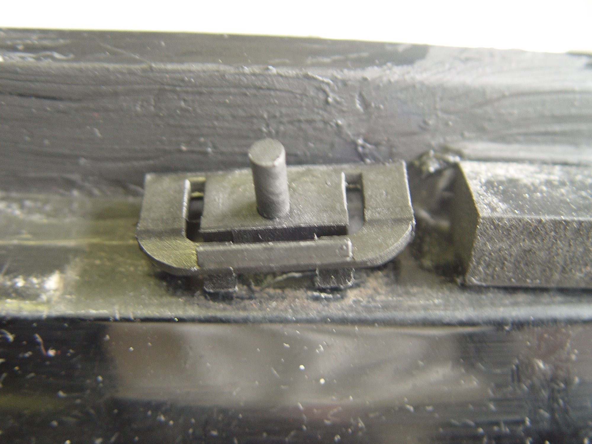

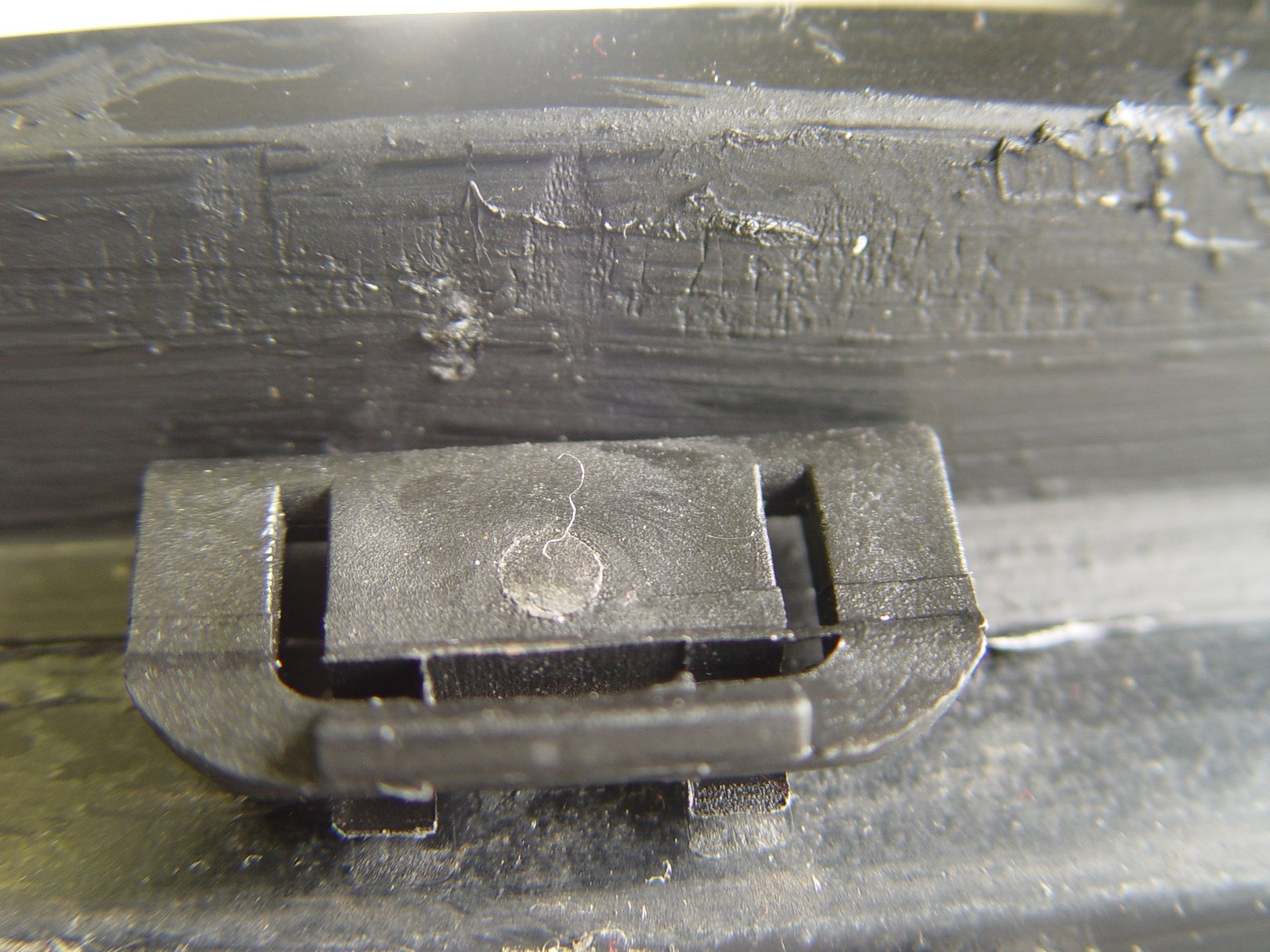

Trim Clips: The trim clips were installed. The pin faces outward and punched in with a punch and rubber mallet. The pin secures the other end that inserts into the clip hole. Note: this step not mentioned in most videos.

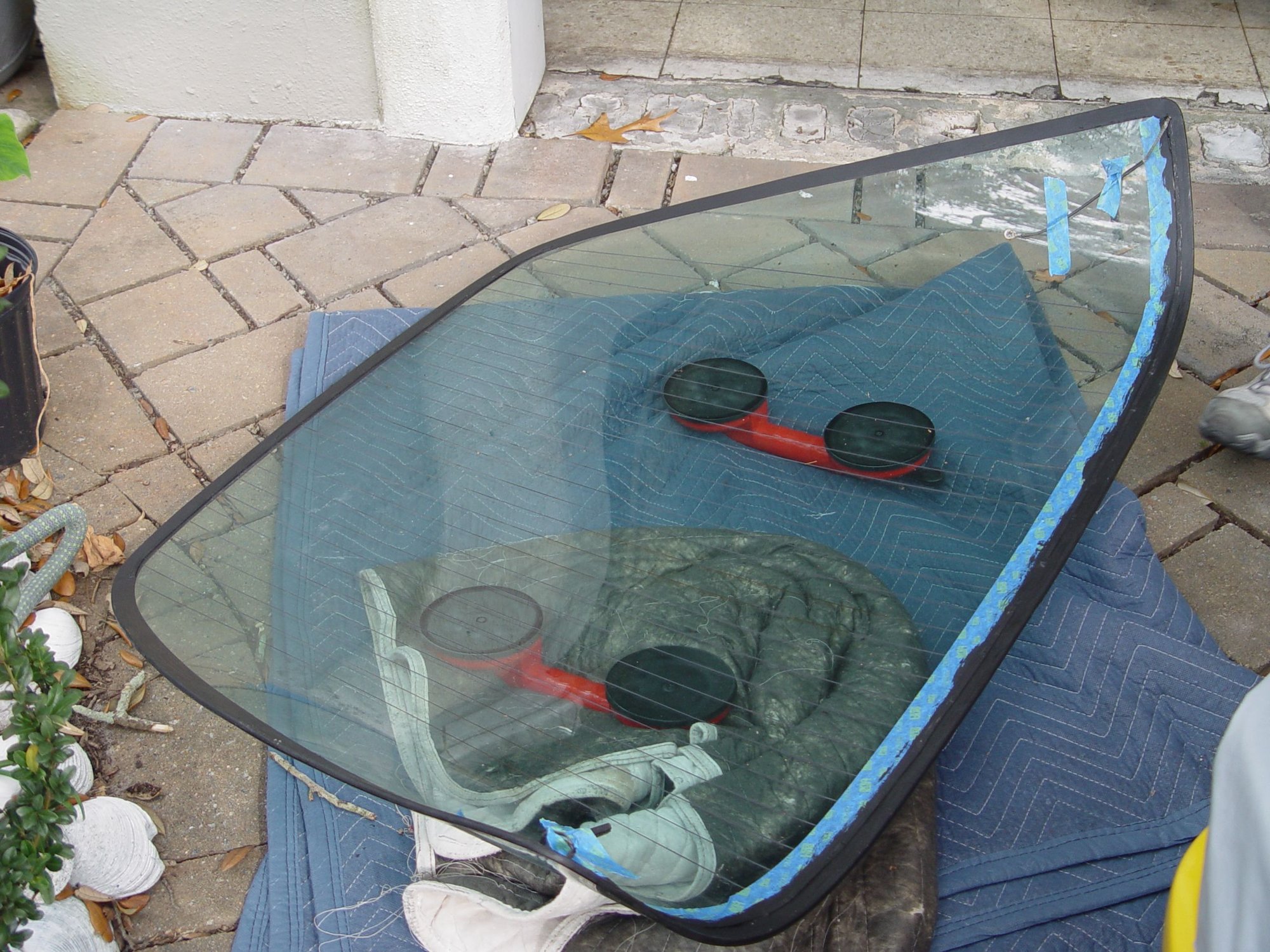

Primer & blocks: The inside of the glass was prepped with tape to avoid butyl primer dribbling onto the visible surface of the glass. Afterward, the primer was applied to the edge of the glass and to the body surface where the glass will eventually rest. An attempt was made to glue the rear blocks in place...as noted with the masking tape. The body valley has slight indentations to position and mount the blocks. Time was allowed for the primer to dry.

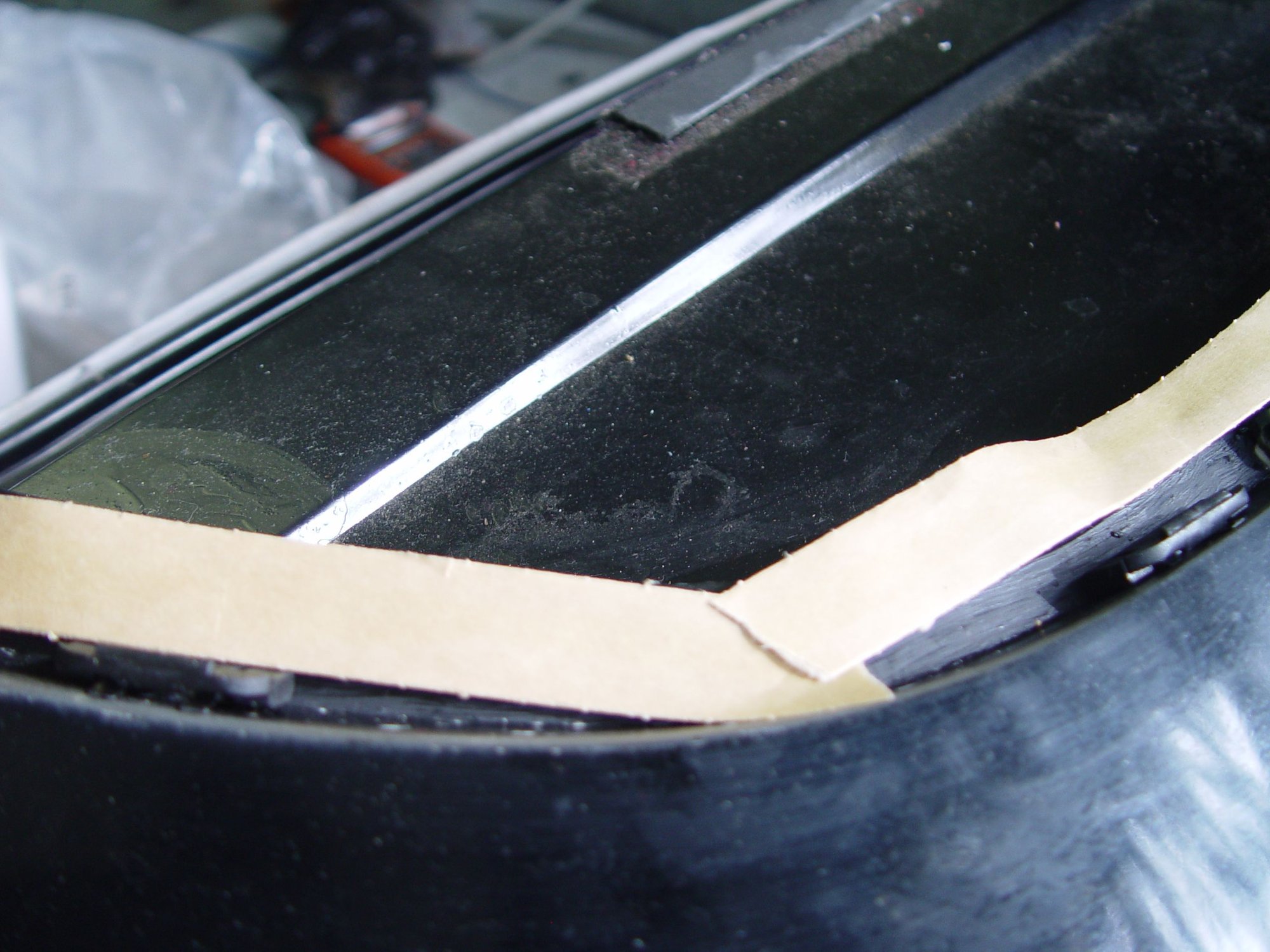

Butyl Tape Installation: The butyl tape was applied to the body surface edge where the primer had been applied; the paper was left in place. Ensure the butyl rides above each block; its best that the butyl is applied as close to the body edge as possible. The Zip butyl kit includes two separate pieces. The shorter we used for the top of the body and ended the tape a couple of inches from the bottom and before the valley begins its journey toward the rear of the vehicle. The longer butyl wrap was then overlapped and applied around the bottom and to the other side.

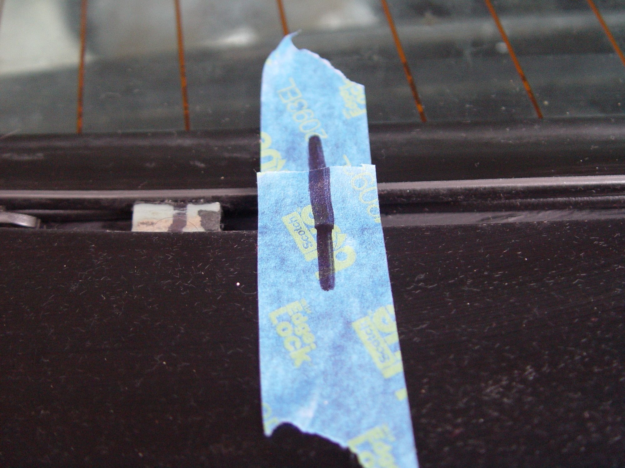

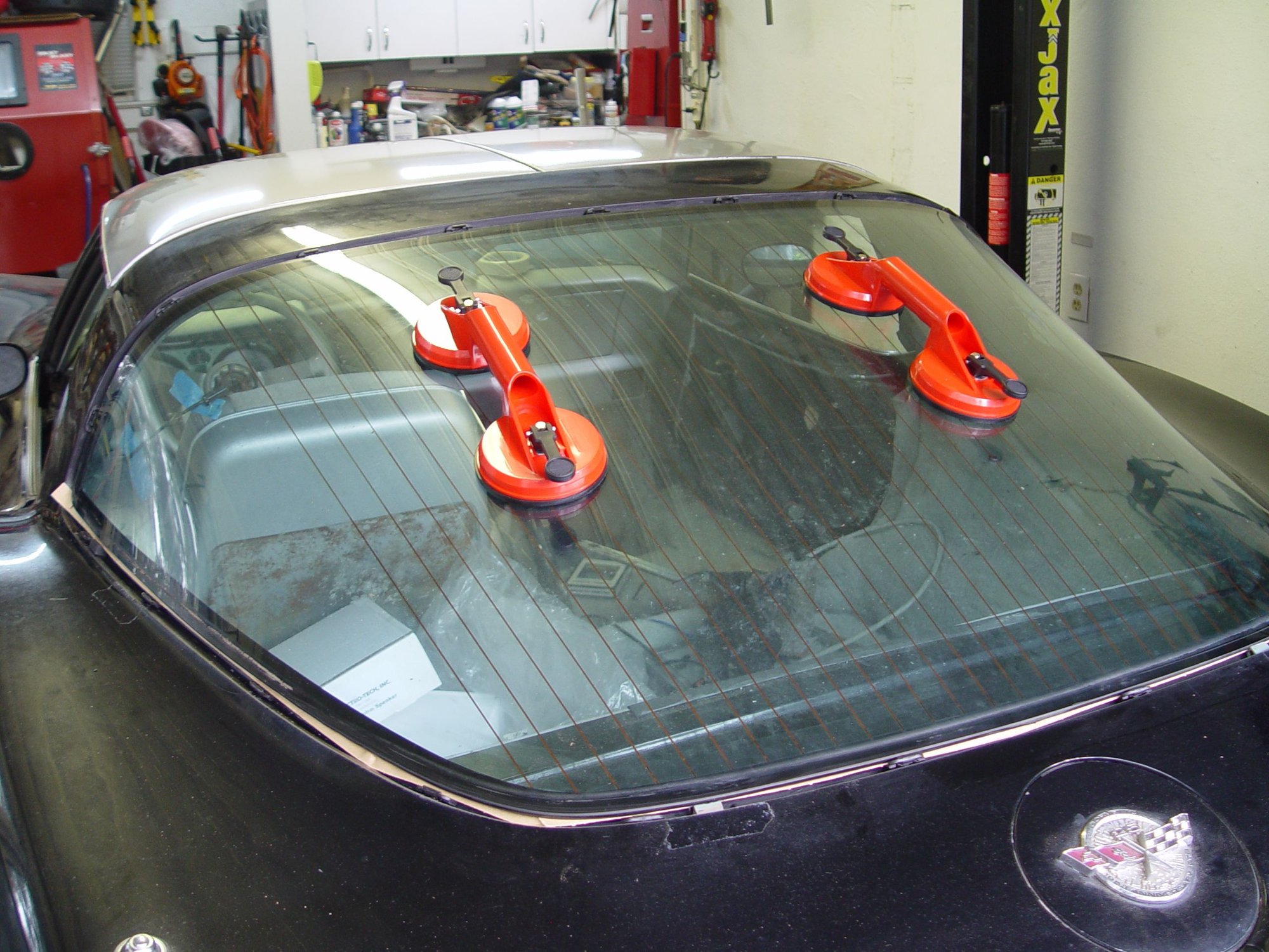

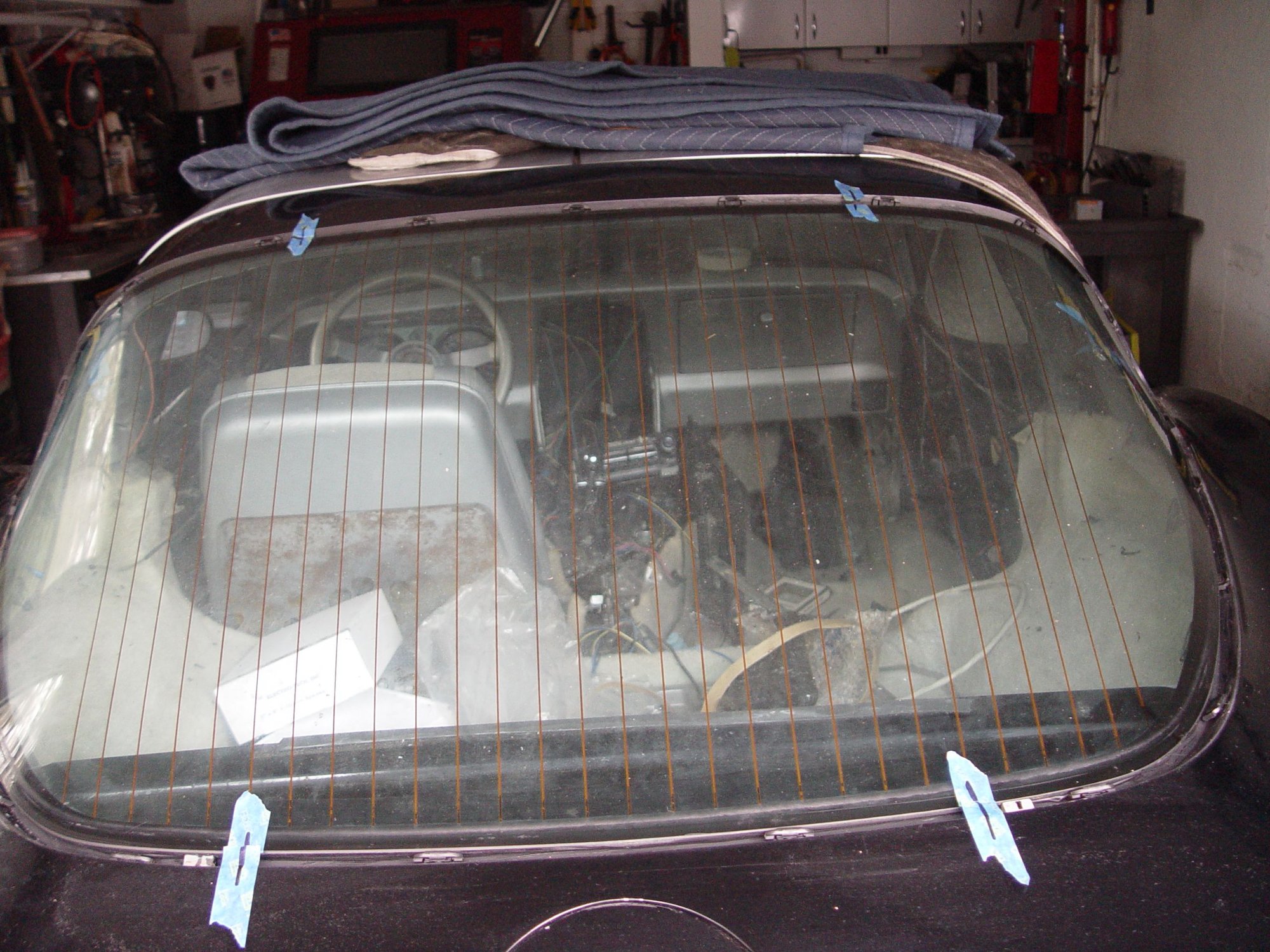

Glass Alignment to Body Valley Surround: With the butyl in place along with the protective paper, a dry-fit of the glass permitted us to check gaps and align glass to the body. Masking tape was used at top and bottom once we felt we had the gaps spaced evenly all around. A sharper was used to draw alignment marks on the top, both top and bottom.
Dry-Fit #2: We paused with the glass resting on the protective paper and confirming the alignment marks provided the necessary gaps. At this point, with some deliberation, we decided it was best in the final step, to align the rear of the glass with the body and set it down up against the blocks...before setting the front glass down onto the butyl. Note: once the glass sets against the butyl...its there permanently and allows no room for adjusting glass to reposition gaps...videos don't comment on this final step.
Window Installation - Final: With our method of final placment of the glass onto the butyl tape, we set the glass on the vehicle roof; the protective paper was removed and we took a deep breath before proceeding with the final application. Lou provided a critical third set of eyes and hands to ensure the rear alignment was set in place before Jim and I proceeded with resting the glass onto the butyl along the sides and top. If you have followed the steps above, at this point, the glass will rest onto the front blocks with the desired alignment resulting in gaps that are even all the way around.
Hope this is instructive for those 1978-82 owners who have to replace the rear window. Use this along with the YouTube videos to figure out how best to do the installation. We found the third set of eyes is helpful in the most critical step of placing the glass onto the butyl.

Lou-Lou is loup68 to clarify things, guys. So glad that we got this done for you, Tom. It was a slightly nerve wracking project to say the least. Once the glass hits that tape, game over! Lou.

If I knew that I was going to have my picture taken, I would have dressed better! Lou.
