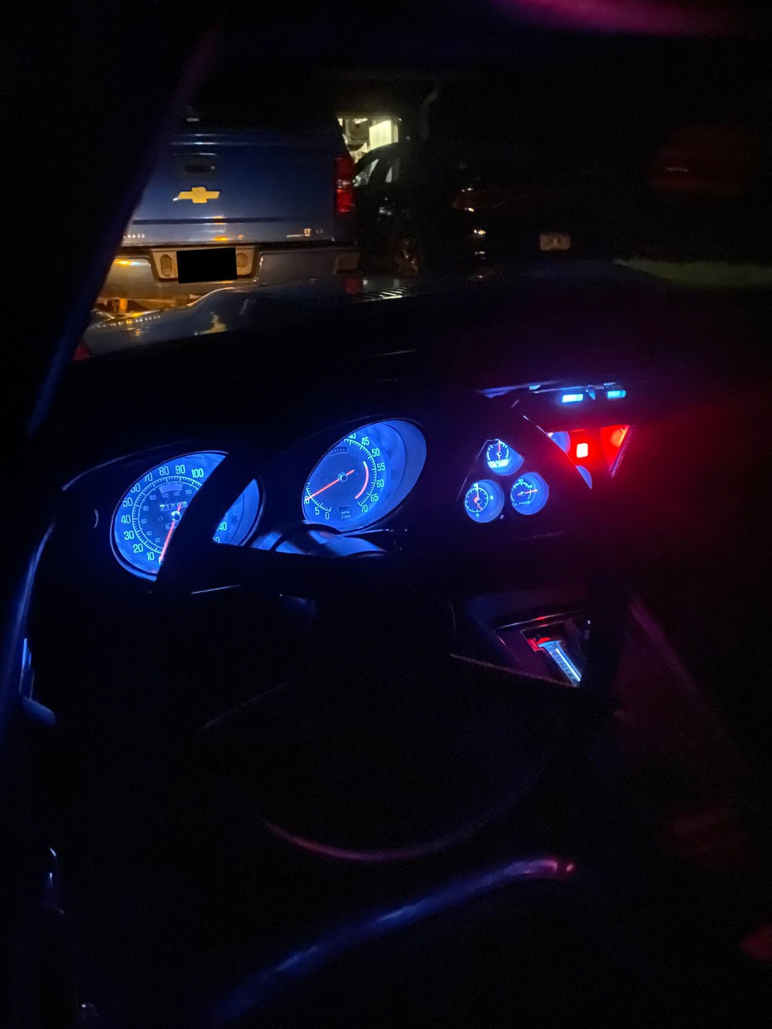

I changed mine over to some eBay generic white 194 bulbs about a year and a half ago. No, they’re not dimmable, but I never use them at anything but full bright anyways, which isn’t too harsh.
It’s up to you to decide if it’s an upgrade or not, but I prefer this vibrant blue over the yellow green of the incandescents.

That looks awesome!
Yes. Agreed. Much better than the factory bulbs.
