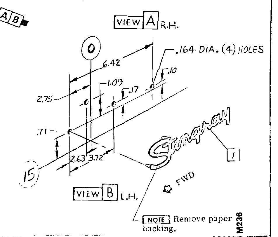

Here are the drill hole dimensions for the Stingray fender script. Maybe the '82 AIM has something similar for the Crossfire.

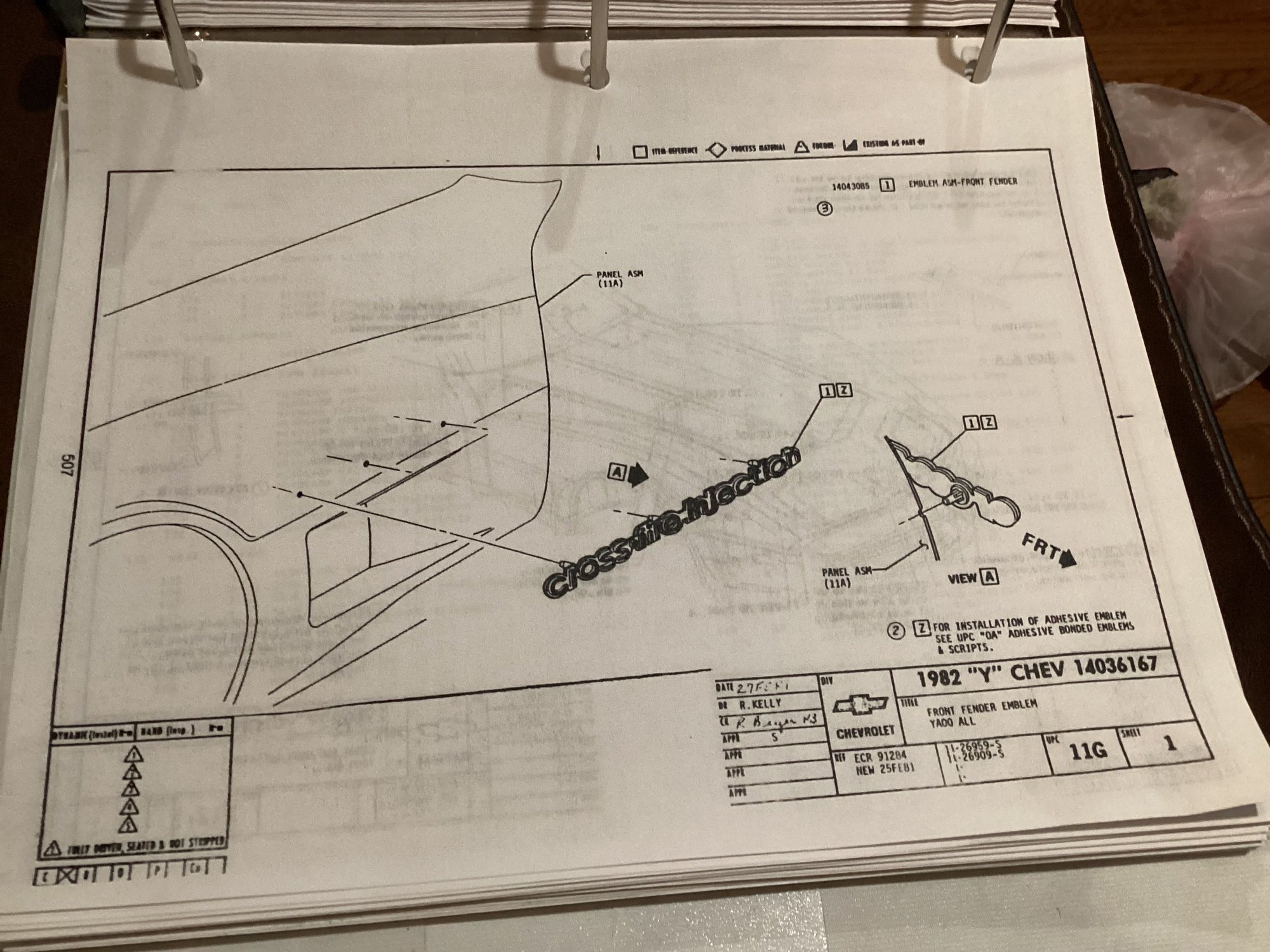

I “think” I remember my 74 having four prongs.? Back then I was 20 something, now 65 something, so thinking three prongs. And yes I need to check my AIM for the 82. Thank you, have a good night.

SixAddict's Avatar
SixAddict
Joined: Feb 2017
Posts: 3,291
Likes: 1,283
unfortunately my AIM for my 82 is not that detailed. Shame really.

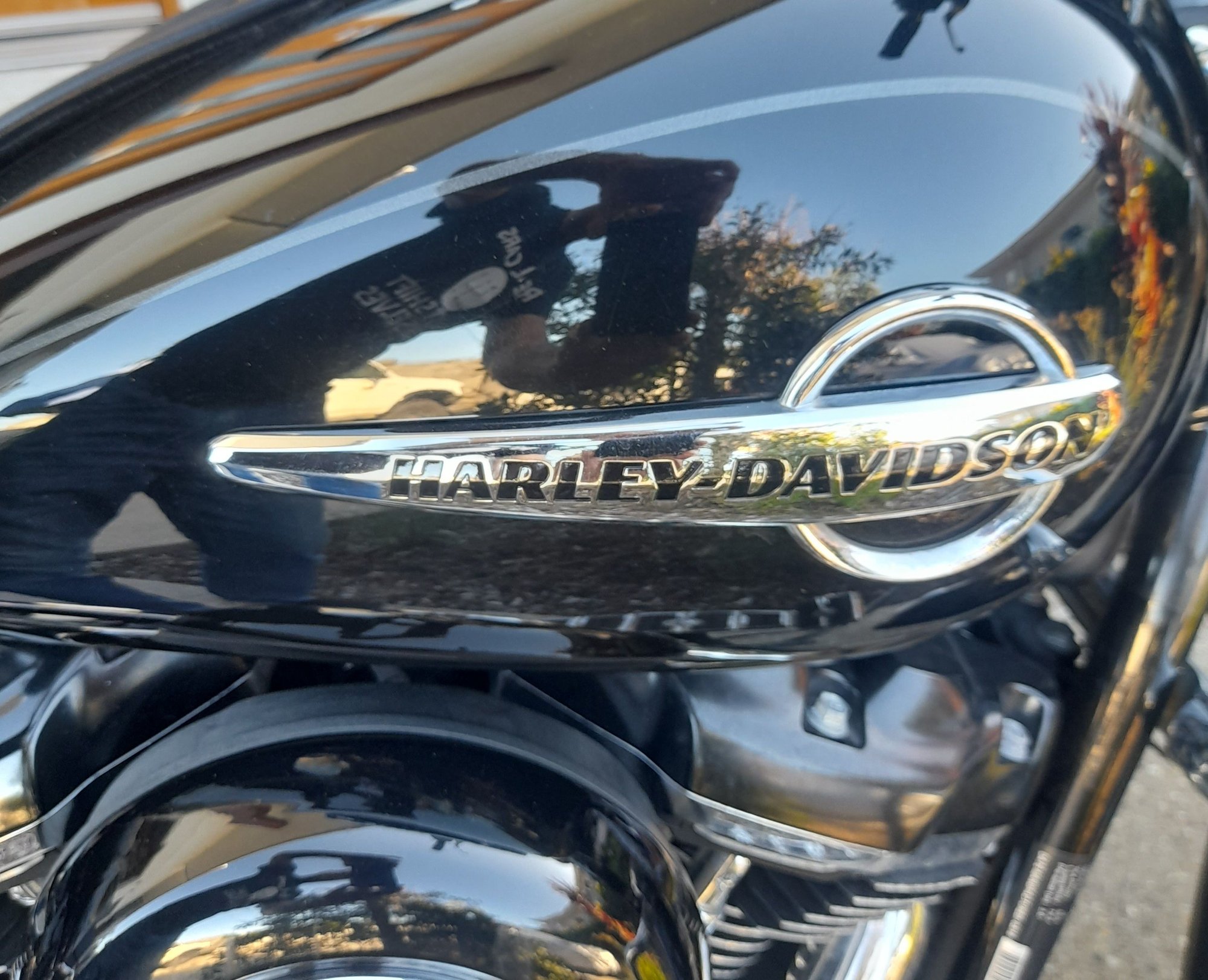

I've been running Stingray emblems on my 77 for many years. It's just the adhesive that holds em on.
And how do you think the emblems are held on on the side of a Harley gas tank? No holes or pins I assure you!
Old Dec 6, 2024 | 10:39 PM
SixAddict's Avatar
SixAddict
Joined: Feb 2017
Posts: 3,291
Likes: 1,283
And how do think the emblems are held on on the side of a Harley gas tank? No holes or pins I assure you!
Thank you sir. You are correct. Never thought about my Harleys gas tank emblems….

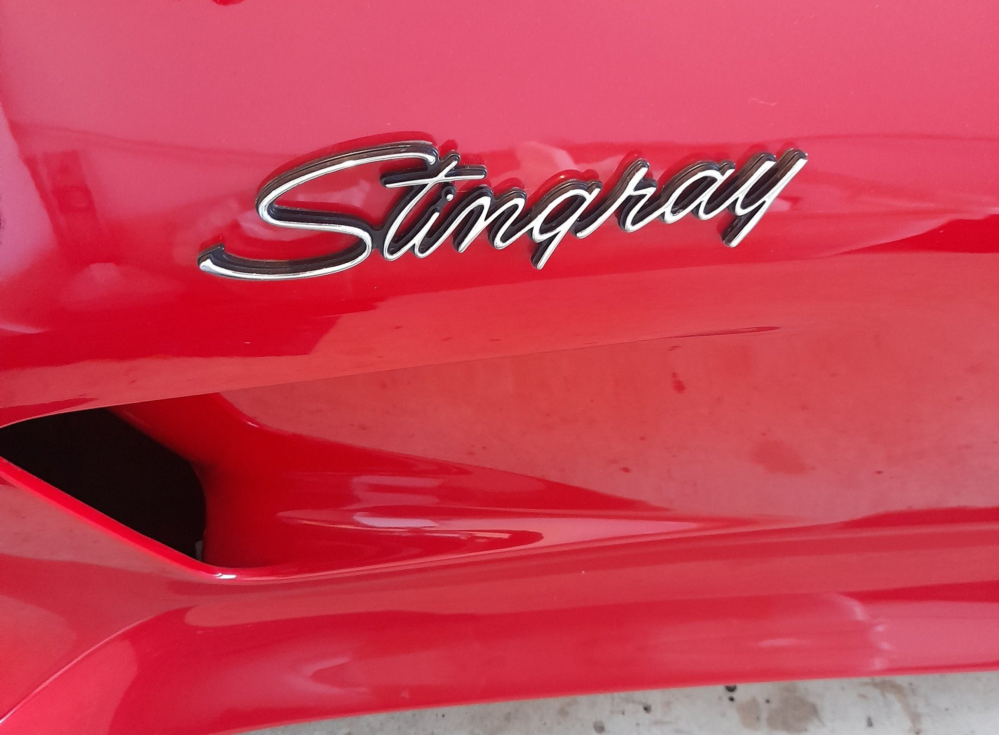

OK, some photos.
These were installed about a year ago as I had to have my front clip resprayed.
The above do have pins and yes the car was drilled to accept them.

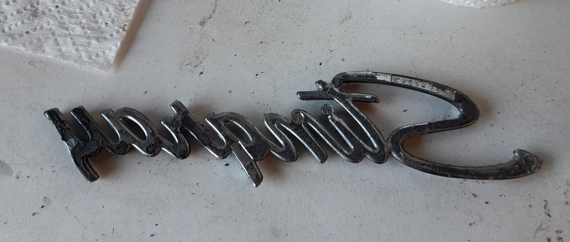

Below are the ones that came off. These were installed around 2001 when it was resprayed then.
Note that the pins had been snapped off and just the adhesive was used to retain them. They lasted over 20 years this way.
And below, just for fun. My Harley.
These are retained by adhesive only. And yes it's true not all Harley models have metal emblems. However, many do.
