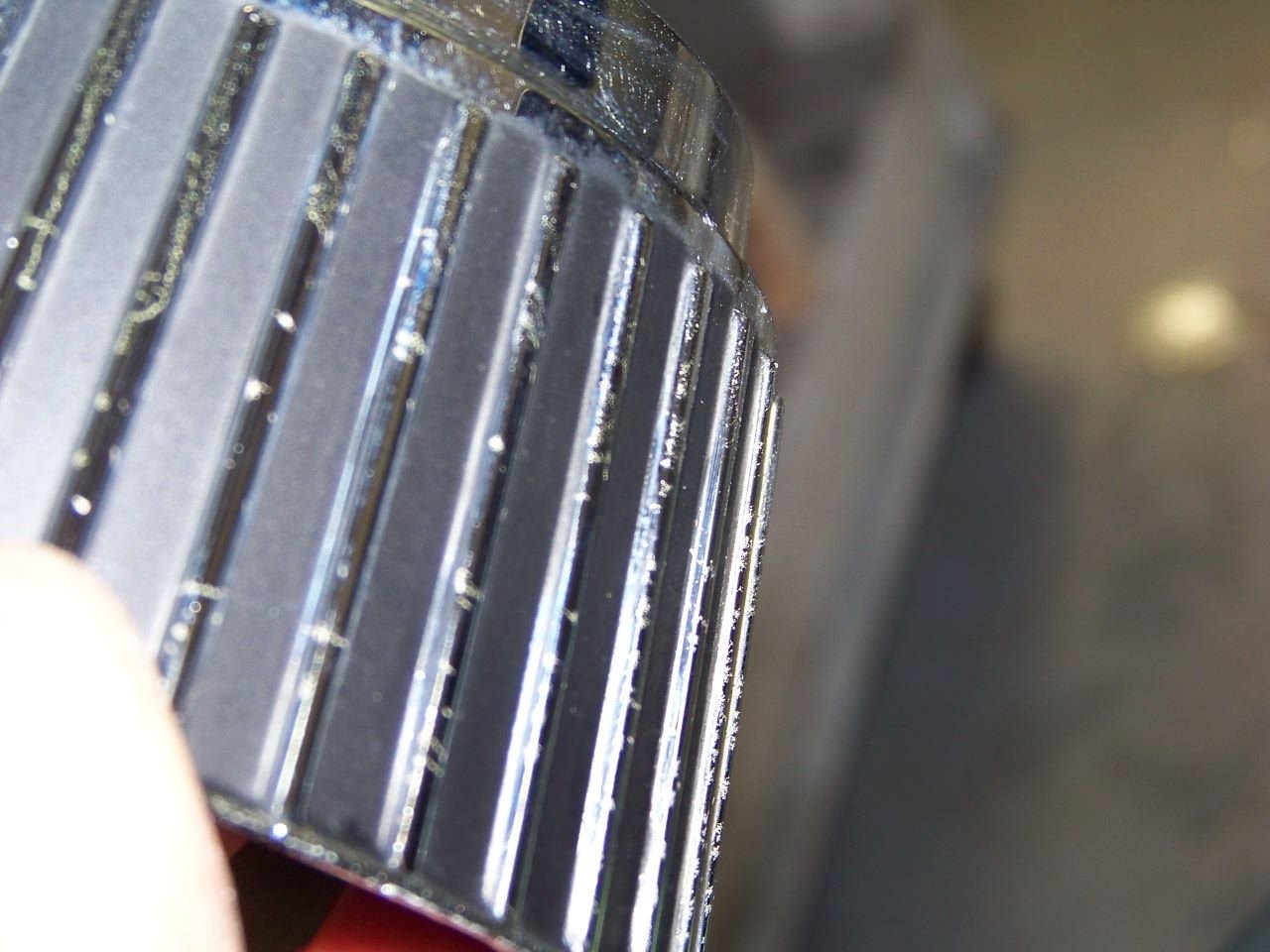

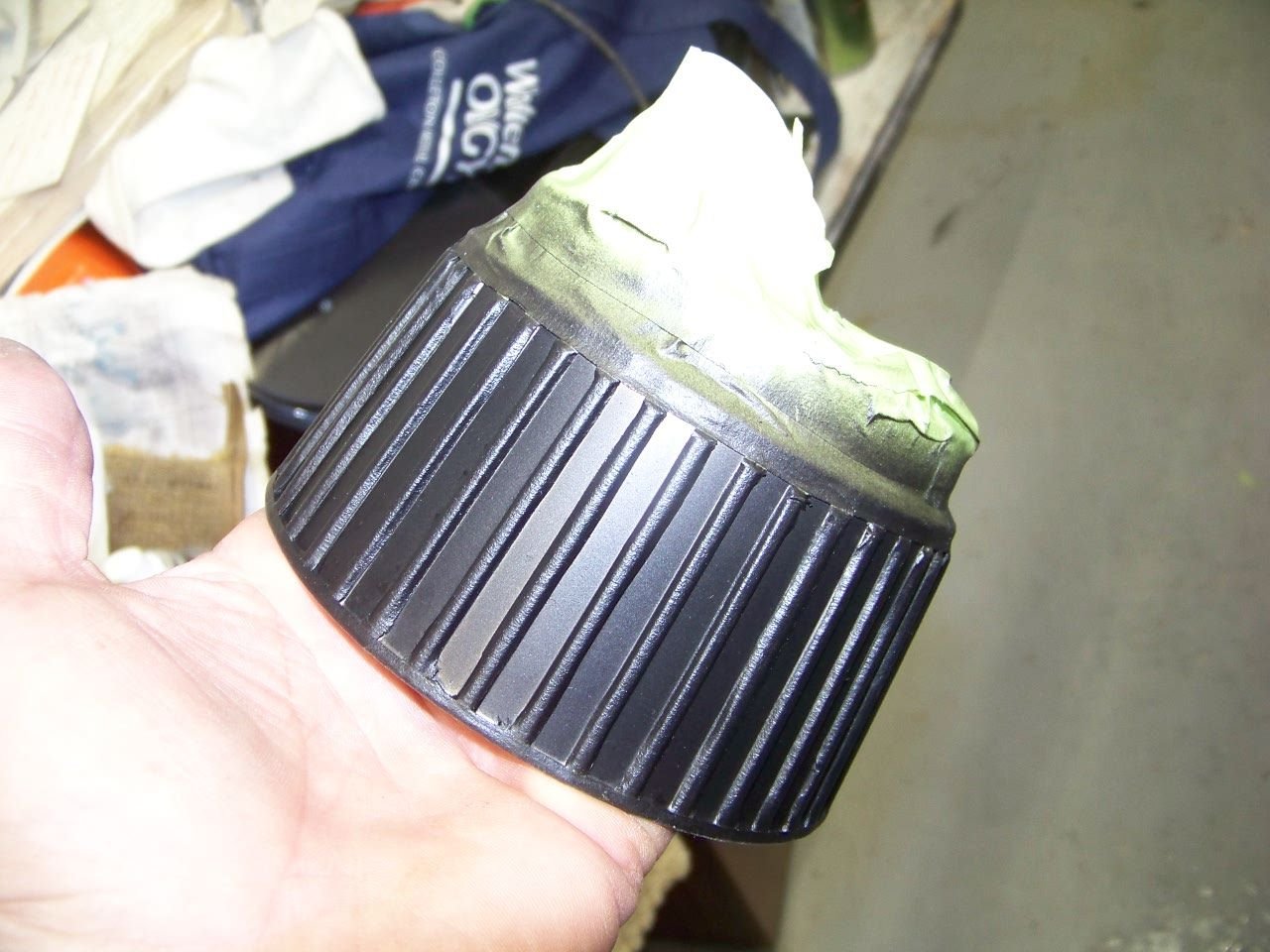

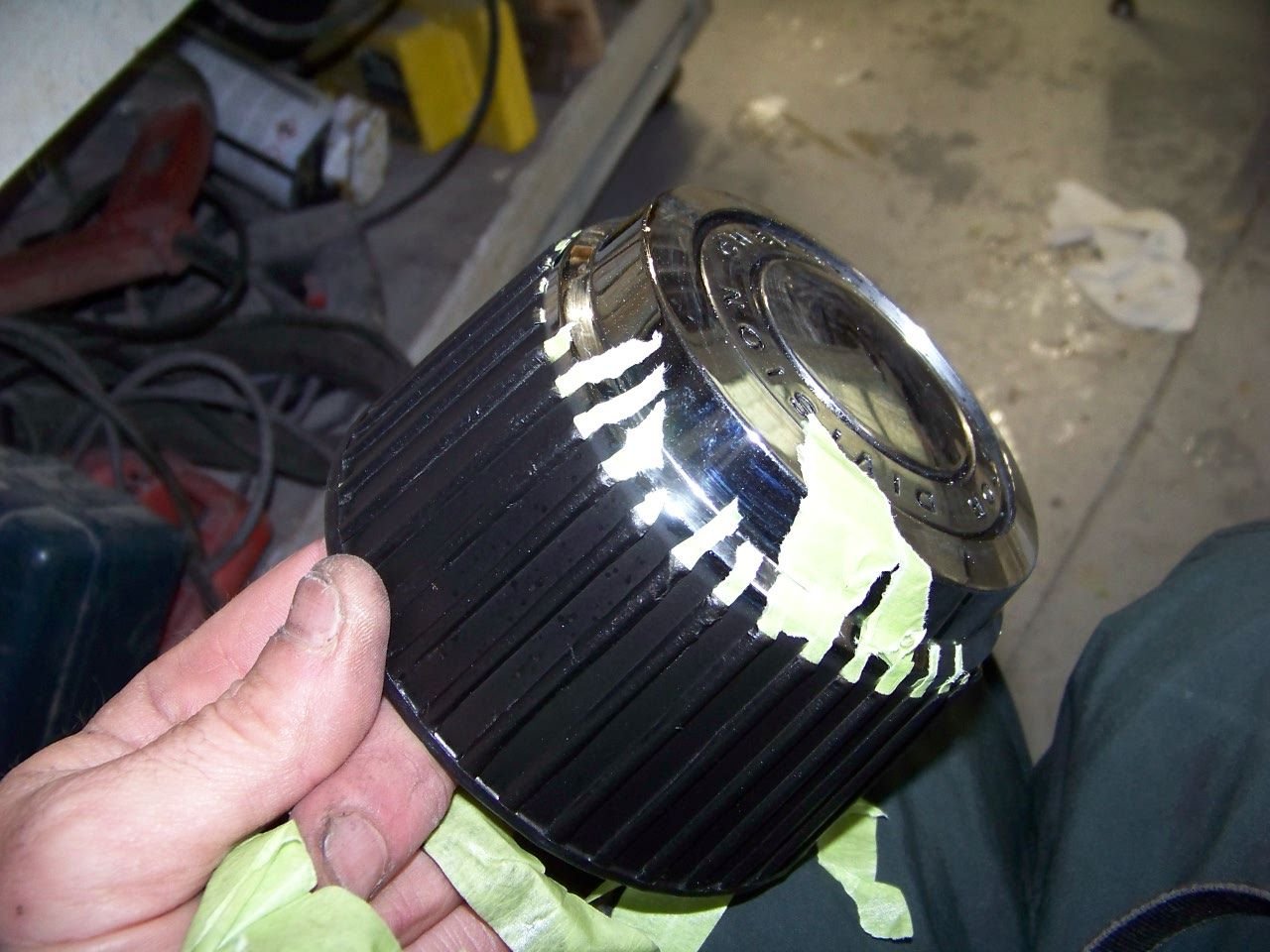

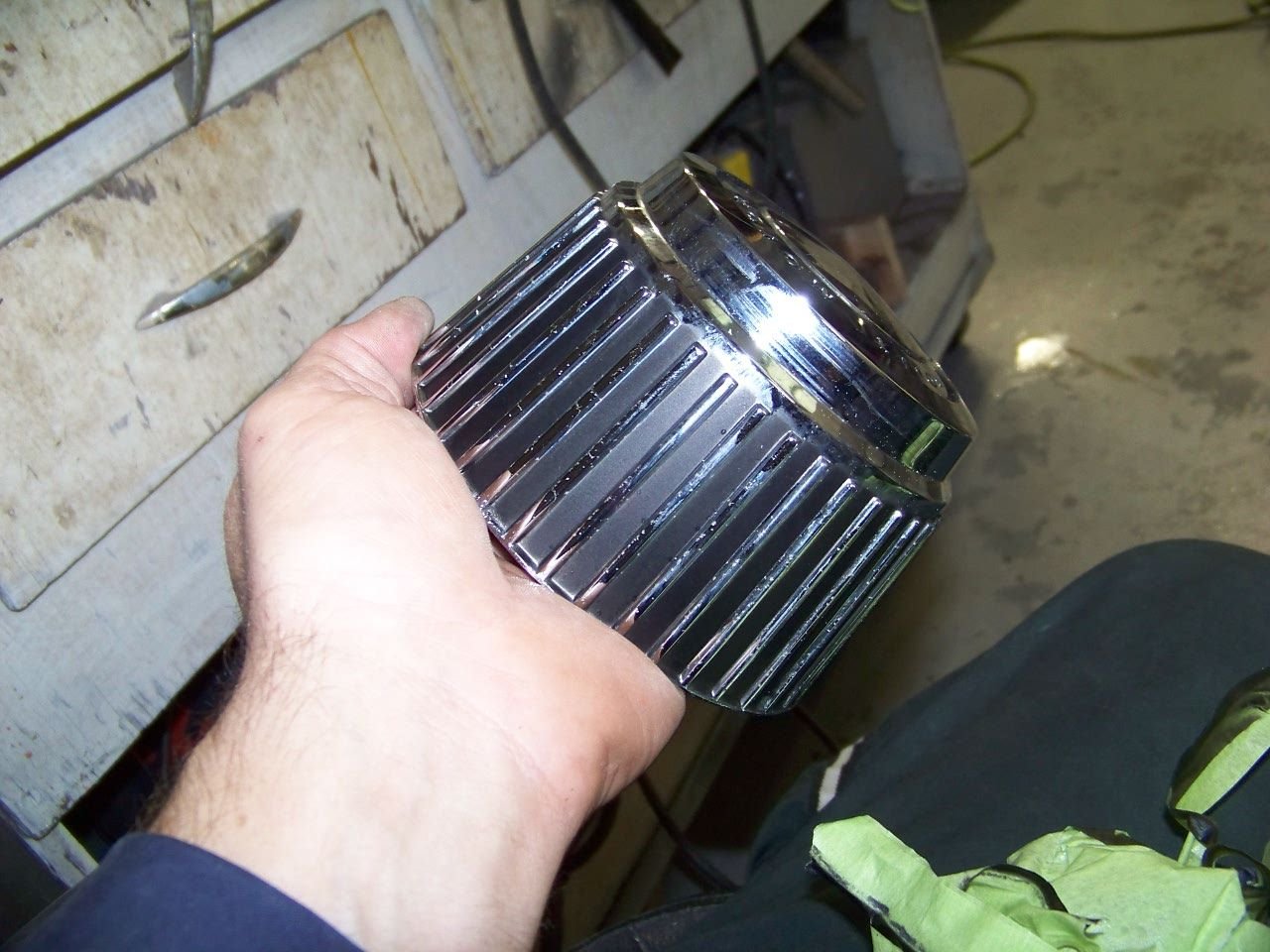

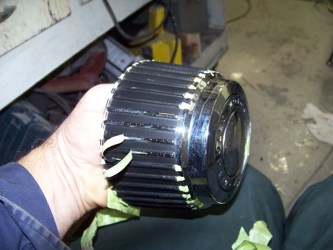

Here is how I have repainted caps to appear like the original production painted caps...

That’s how I did mine too^^^^^^^^^^
I used pinstriping tape I bought off Amazon

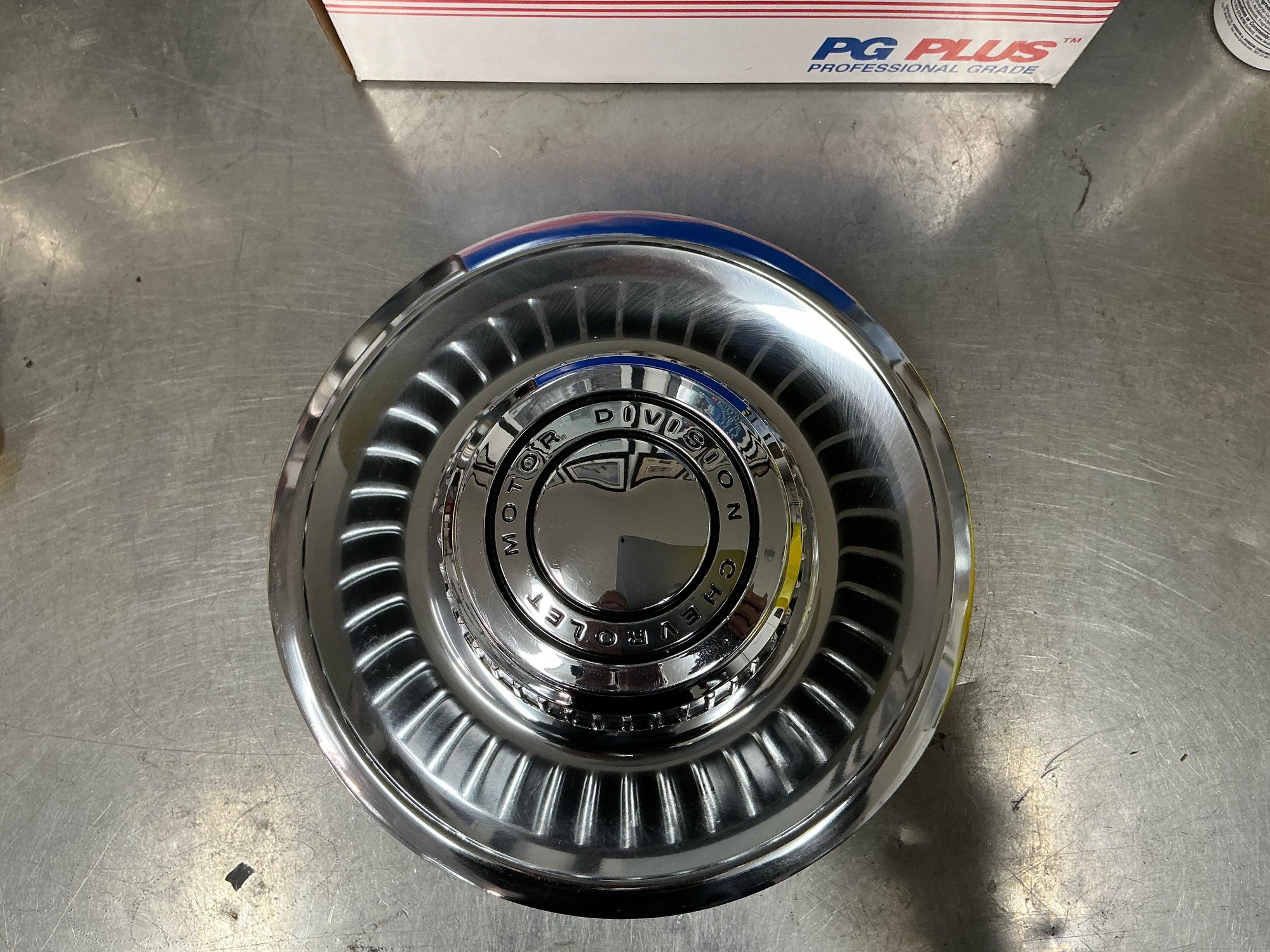

The "Chevrolet Motor Division," embossed on the caps, appears different on the repro caps I've purchased. The repro caps have a more bold font style and the embossed letters are not as crisp.
I think you need a specialty black primer style paint to adhere to the smooth chrome surface. I've seen it advertised, I've never bought a can. The black paint GM paints over chrome can be difficult to remove....I know that. I tried to remove all of the black primer paint from my 70 front quarter panel egg crate louvers and it was difficult. I removed the color paint the car was painted with, only to expose the black primer underneath. Since it was so tough to remove, on second thought I should have left it since I will need to reapply it.

I sprayed some John Deere Blitz Black paint into the cap and used a flat artist's brush to paint the flat areas on the 'snout'. Then use some lacquer thinner of a clean piece of cloth to wipe off any over-dos on the raised areas. You can either use a fine brush to put paint in the letters and wipe excess of with cleaner, or you can spray the lettered area and quickly wipe OVER the surface with cloth/lacquer thinner to leave blackened letters. Looks like new.
P.S. You need a good polisher wheel and compound to polish up old caps. Then clean them well with detergent and a toothbrush to get rid of all compound before doing the black-work.
