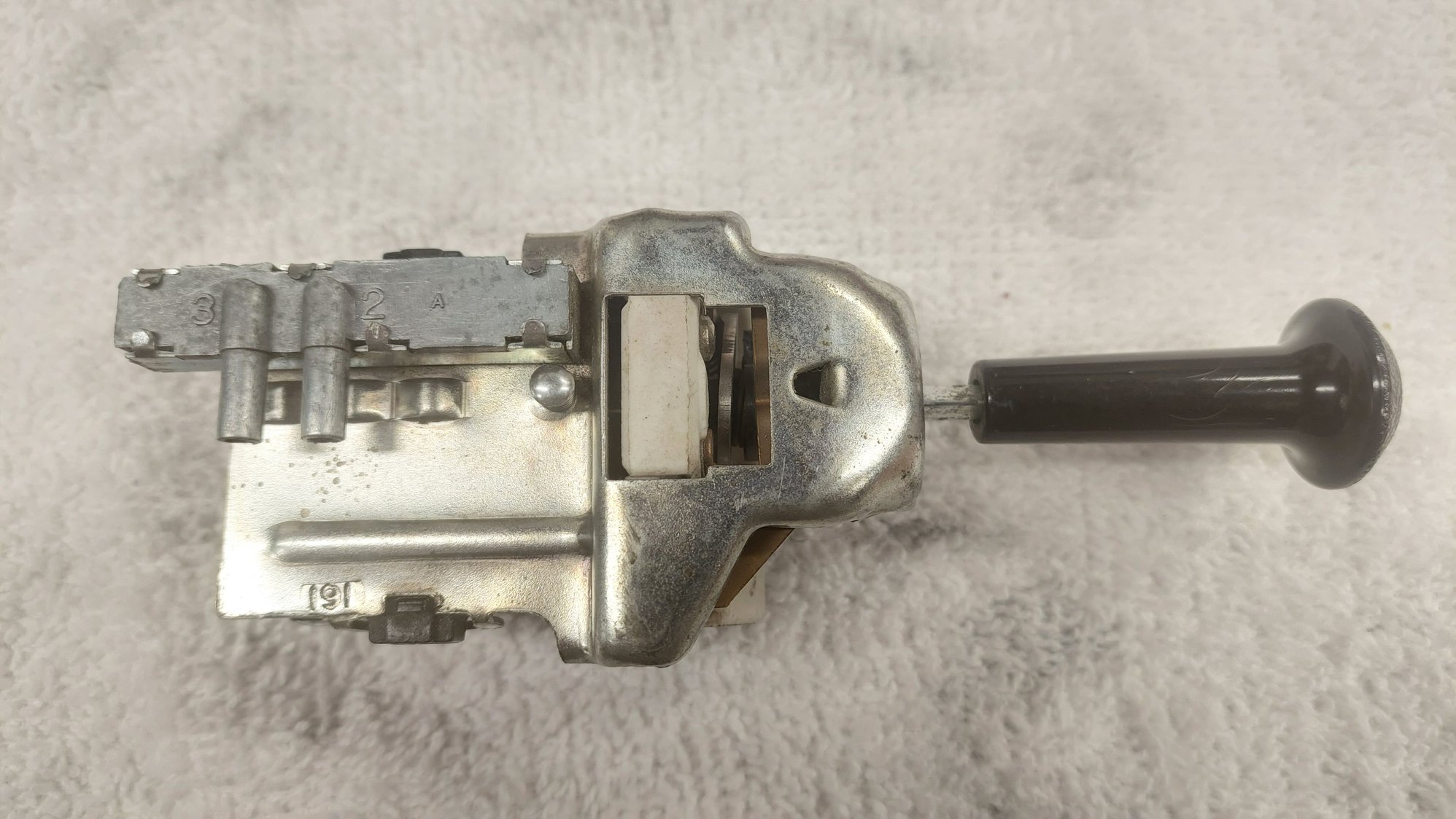

Do a search on e-bay for part number 1995191.
You can find used ones for less then a new reproduction China made pos....
I paid $18.00 for the switch, nut, bezel & pull **** for my 77.
Just make sure you see the 191 number on the switch metal body.
