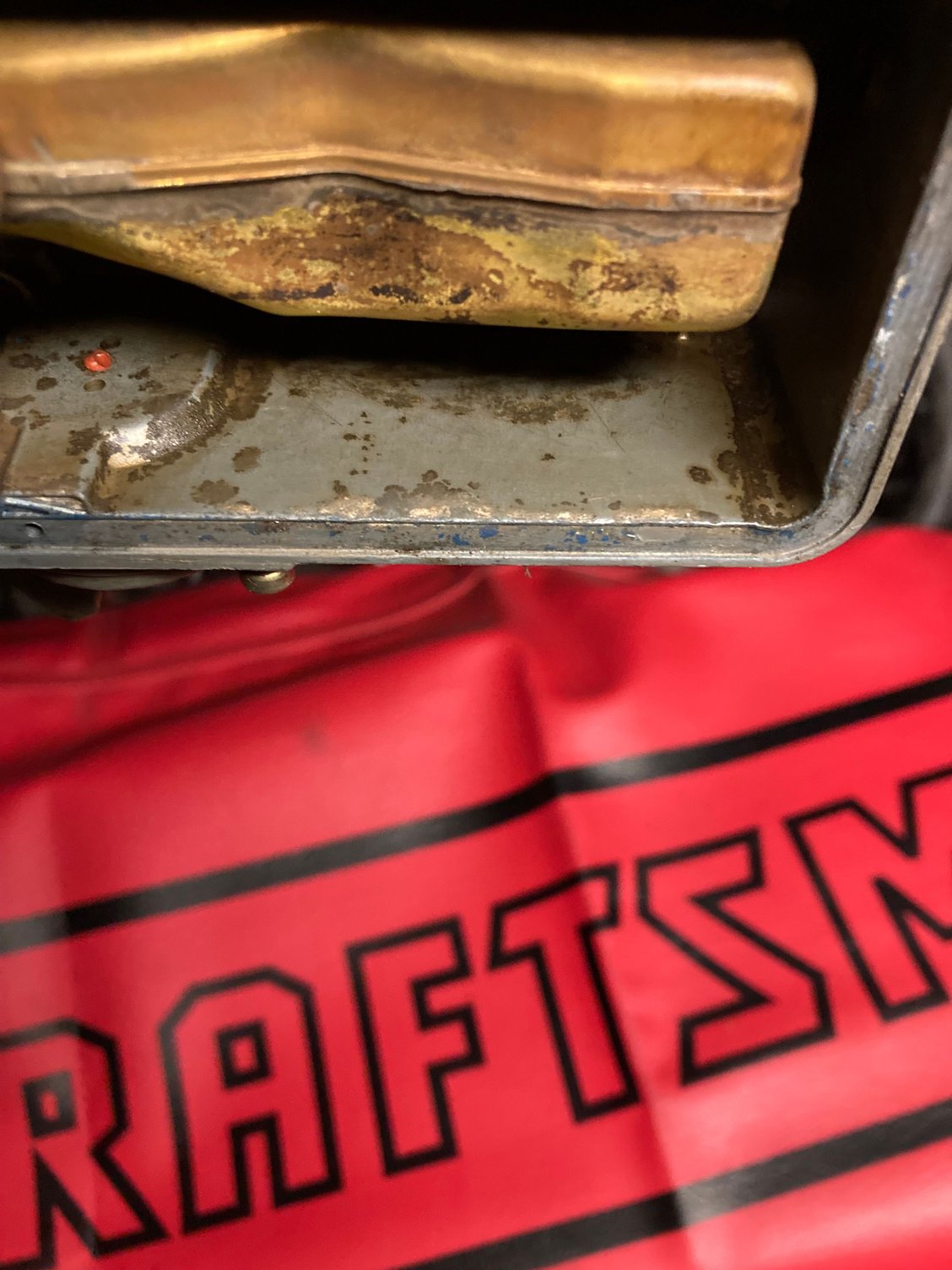

Car started to sputter the other day at full acceleration. After checking the obvious. Wires, vacuum and filling up with fresh fuel. Still there. Hit and miss. Checked the tank and filters. Still couldn’t figure it out. Took the carburetor off and found this. There is pitting in the bottom of the bowls. Some big enough to feel with a fingernail. Looks as though the metal is being eaten by the gas, or whatever additives are in it. First time I am seeing this. Is there anything I can do to stop the pitting and corrosion, or do I need to replace the carburetor.? Thanks.

What percentage ethanol is in the gasoline you are using?

91 octane 10% ethanol. best i can find. My concern is, that now that the coating is gone in those spots the metal will continue to corrode.

Hi Gold Dragon, welcome to the fun residuals of corn gas in our old equipment. When I had the Holly carbs rebuilt on our tri-power, I had to have some parts replaced due to pitting from corn gas. The 'shelf life' of corn gas is much shorter than pure gasoline, it attracts moisture, is tough on rubber lines, etc. I would recommend:
  • Checking your gas tank to ensure their is no bad corrosion there. Include checking the pickup sock and change it if needed.
  • Replace the fuel filter.
  • You may or may not need to have your carb cleaned up/rebuilt. If so and it's a Qjet, my money is on Lars.
  • Switch to non-corn gas. I run a blend of 110 leaded/no corn with 92 unleaded/no corn in our '68 L71. It likes it.
  • Check out this site to help you find pure gas: https://www.pure-gas.org/
It'll be okay, but it's just one of those things that our older cars don't like. I also run non-corn gas in our small equipment. Best, Paul

That pitting of the brass float is from storage. It's not from actually running fresh Ethanol daily but rather from sitting for weeks or months.
Ethanol attracts moisture. And that is the root of the cause. Estimated shelf life is around 60 days before things go sour.
There is no need to use expensive Ethanol Free on a daily basis. Save your money. However, that gas is recommended as the last full tank of the season, before storage.
I would just buy a new float, clean out the fuel bowl, maybe swap-out the needle & seat.
My carb sits for 6 months. But I add Lucas Anti Ethanol Safeguard to the tank in the fall. No issues.
Look on Ebay for a new float matching your carb model number. Summit Racing sells carb parts on Ebay under an undisclosed name.

My guess is that you bought gas at a 'questionable' gas station. Some of these outfits put regular fuel in all of their tanks...they just charge more for the mid and high octane pumps. The computers on modern cars will allow them to run OK if the fuel is a lower grade. Pre-computer cars....not so much. It could also be that a gypo fuel supplier put low grade gas in the hi-test tank at the station or that someone made an honest mistake. Call the station where you filled up last and ask them if there have been other complaints like yours.
You can put octane boosters in your fuel to see if that fixes the problem you are now having.

A polymer Nitro-fil float will prevent the ethanol from damaging [non-ferrous metal] brass float in your carb. The worst thing about ethanol in fuel is that it can separate when stored for long periods and do some real damage. If vehicle is run frequently, ethanol is not as much of a problem...but it still presents issues (ie, lower boiling point).
