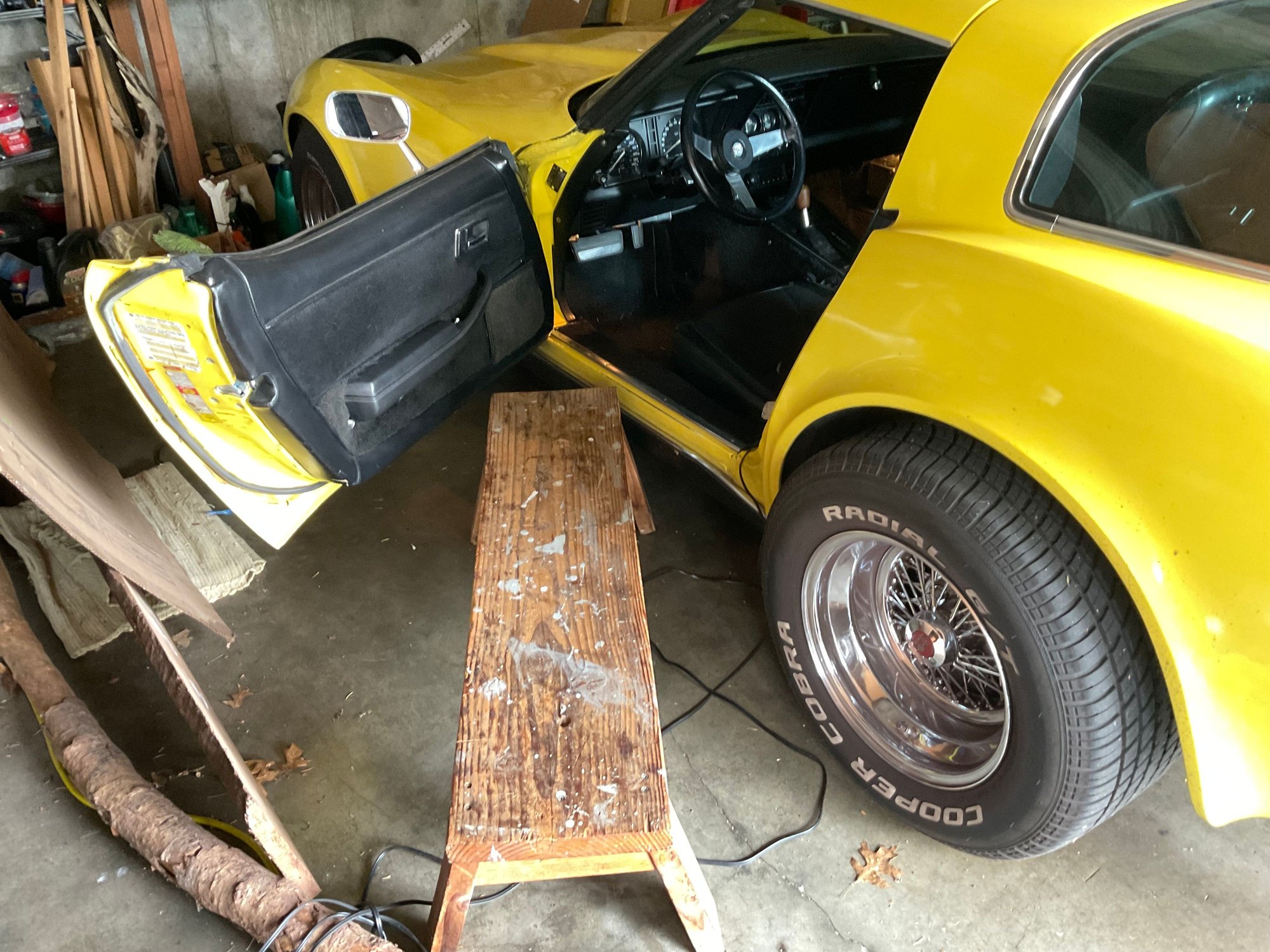

To work under the dash, I place a bench on the outside, level with the door sill.
THIS IS AN OUTSTANDING IDEA! Wish I had done this back when..............
