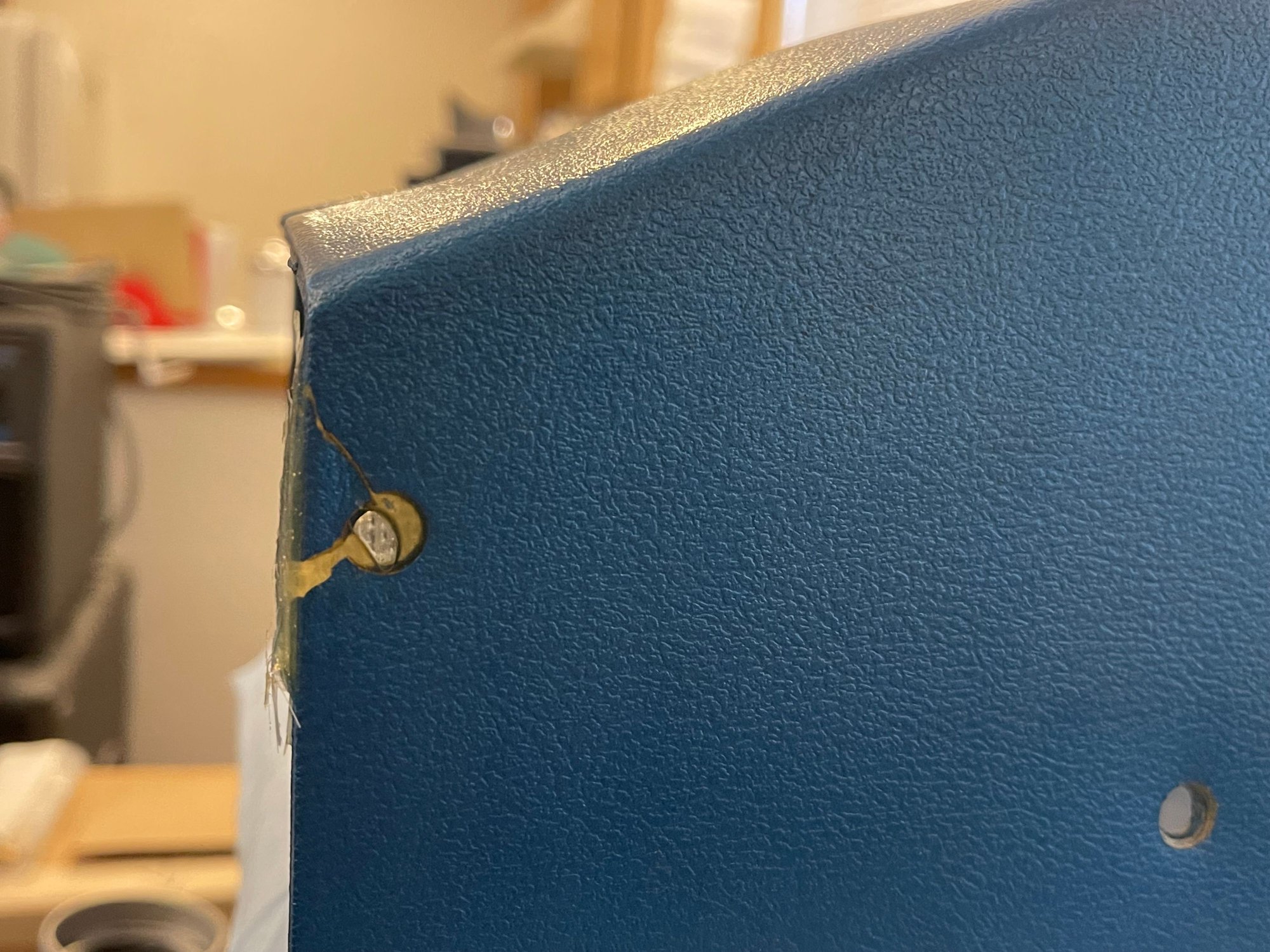

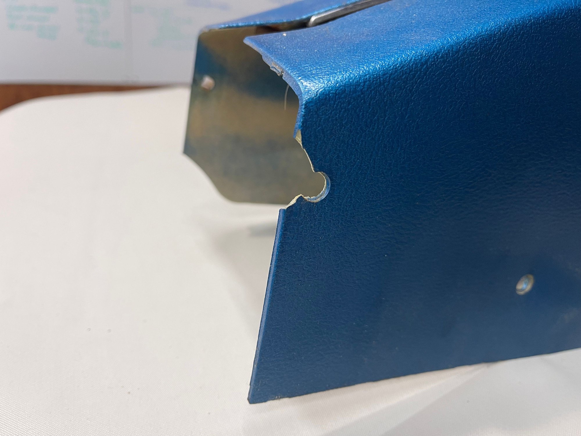

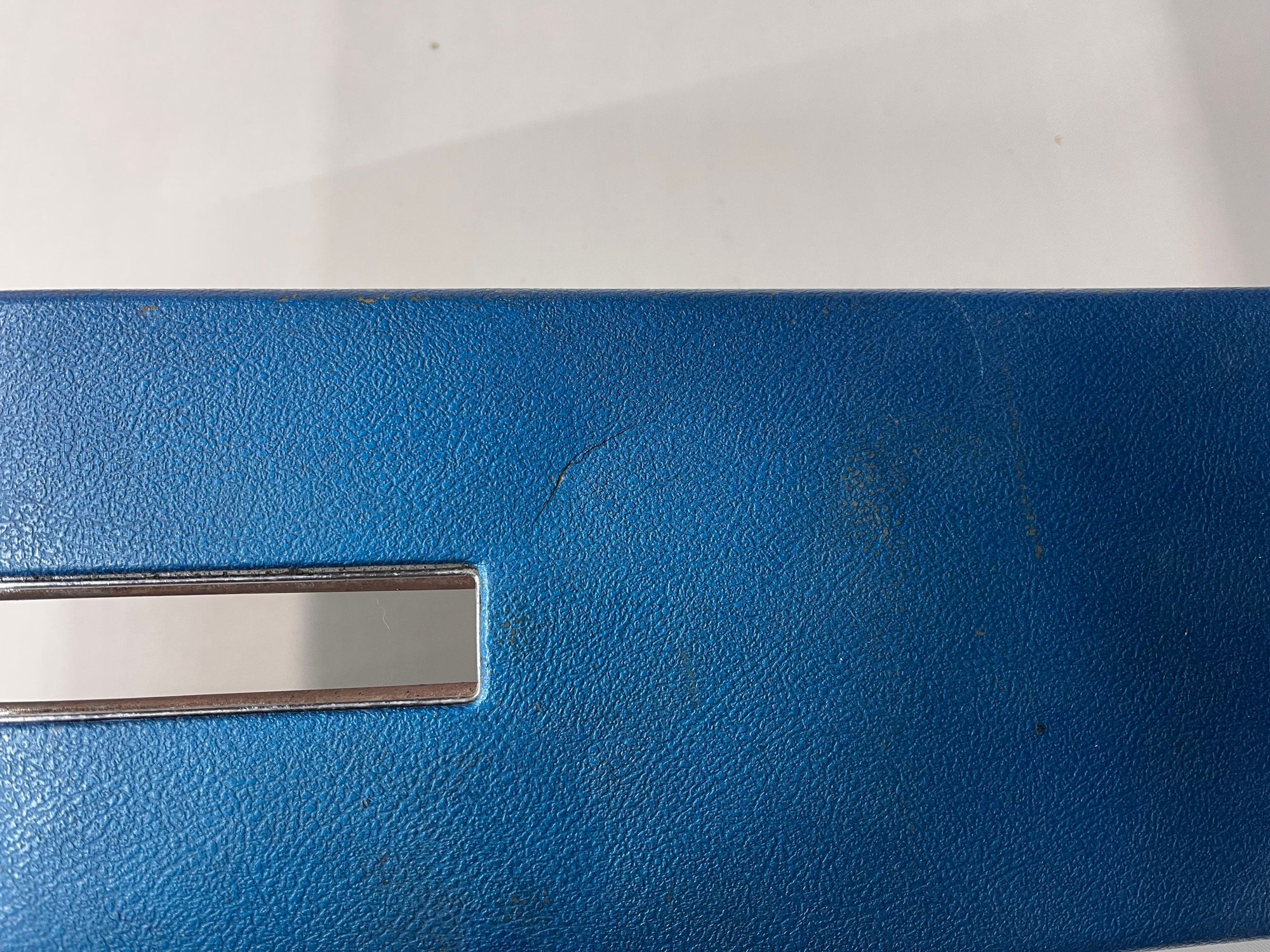

Hi all,
Any repair tips for the parking brake console [non-power window].
I just got mine out, there’s a chunk out of the driver’s front screw-hole, and a ‘used as armrest crack / depression’ on the passenger’s side.
…although Dad & I are both over 6’, so maybe the whole console is driver’s side? 🤣
It doesn’t seem plastic, nor fiberglass…
Or is it?
I'd rather fix it than get a replacement, so any suggestions / tips / advice are welcome.

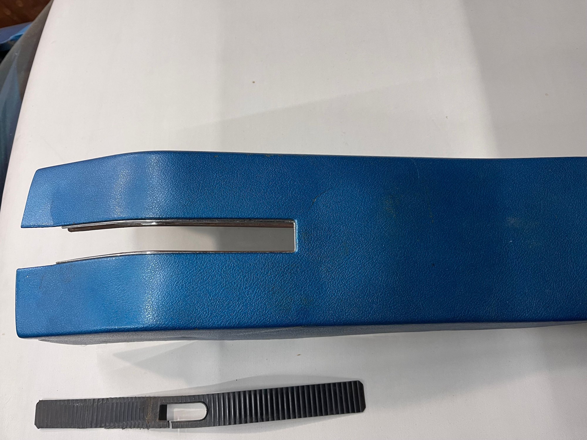

…and I’m 95% sure the slider shouldn’t have that ‘break’ in it. I’m working on a replacement.

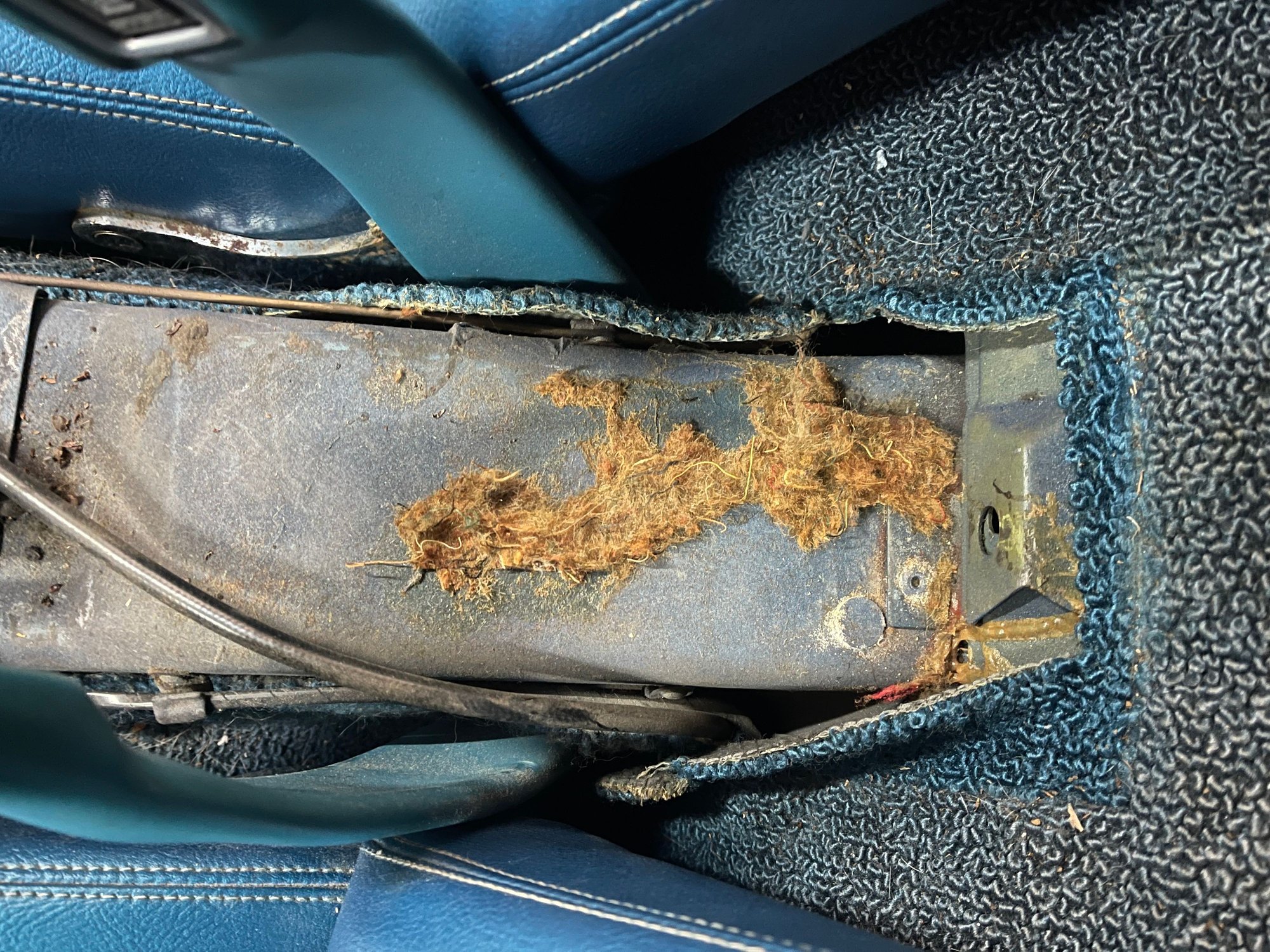

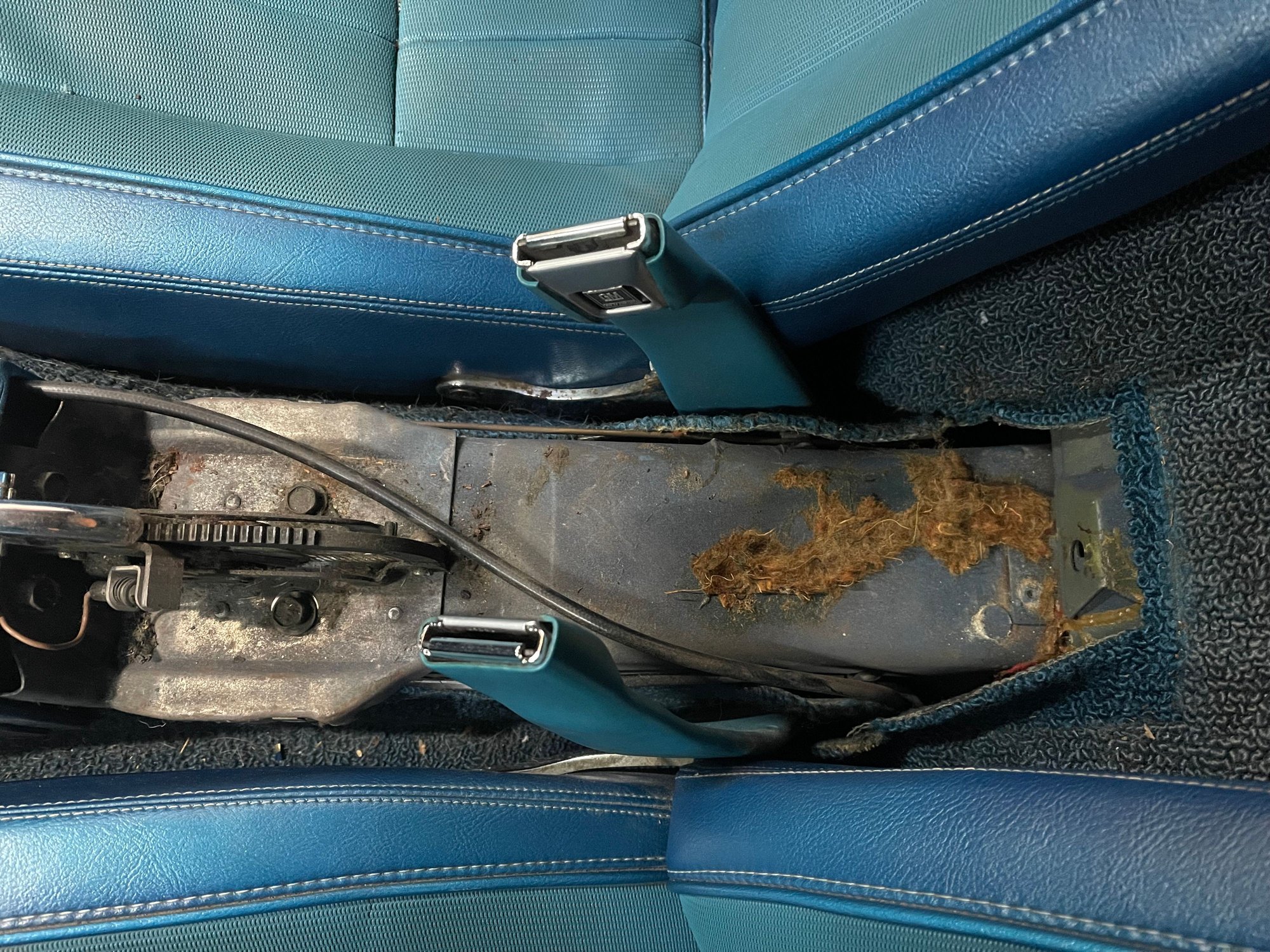

What about insulation under the console?
Suggestions?
The old batting had rodent traces in it - removed and disposed of.

I’m pretty sure the center console is plastic. If you have the missing piece you could possibly plastic weld it back together.

That “break” in the slider is supposed to be there. It’s how you get it around the parking brake handle.
I wouldn’t be too concerned about the insulation on that spot specifically, but having some further forward on the center console directly over the transmission can greatly help reduce interior heat.

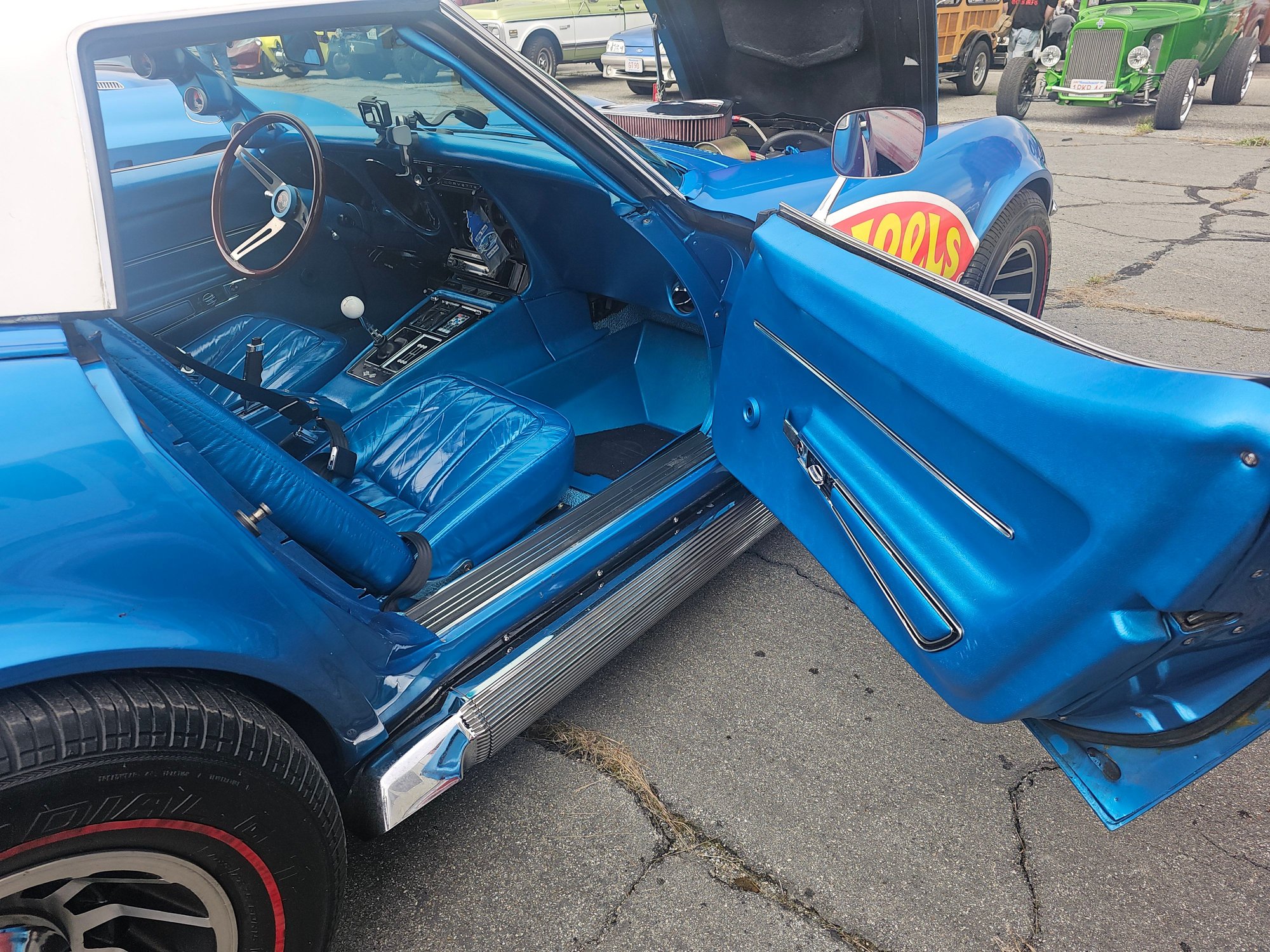

Rescue Rogers's Avatar
Rescue Rogers
Is my vette stock?? HAHA
Joined: Oct 2015
Posts: 20,153
Likes: 9,283
2016 C3 of Year Finalist

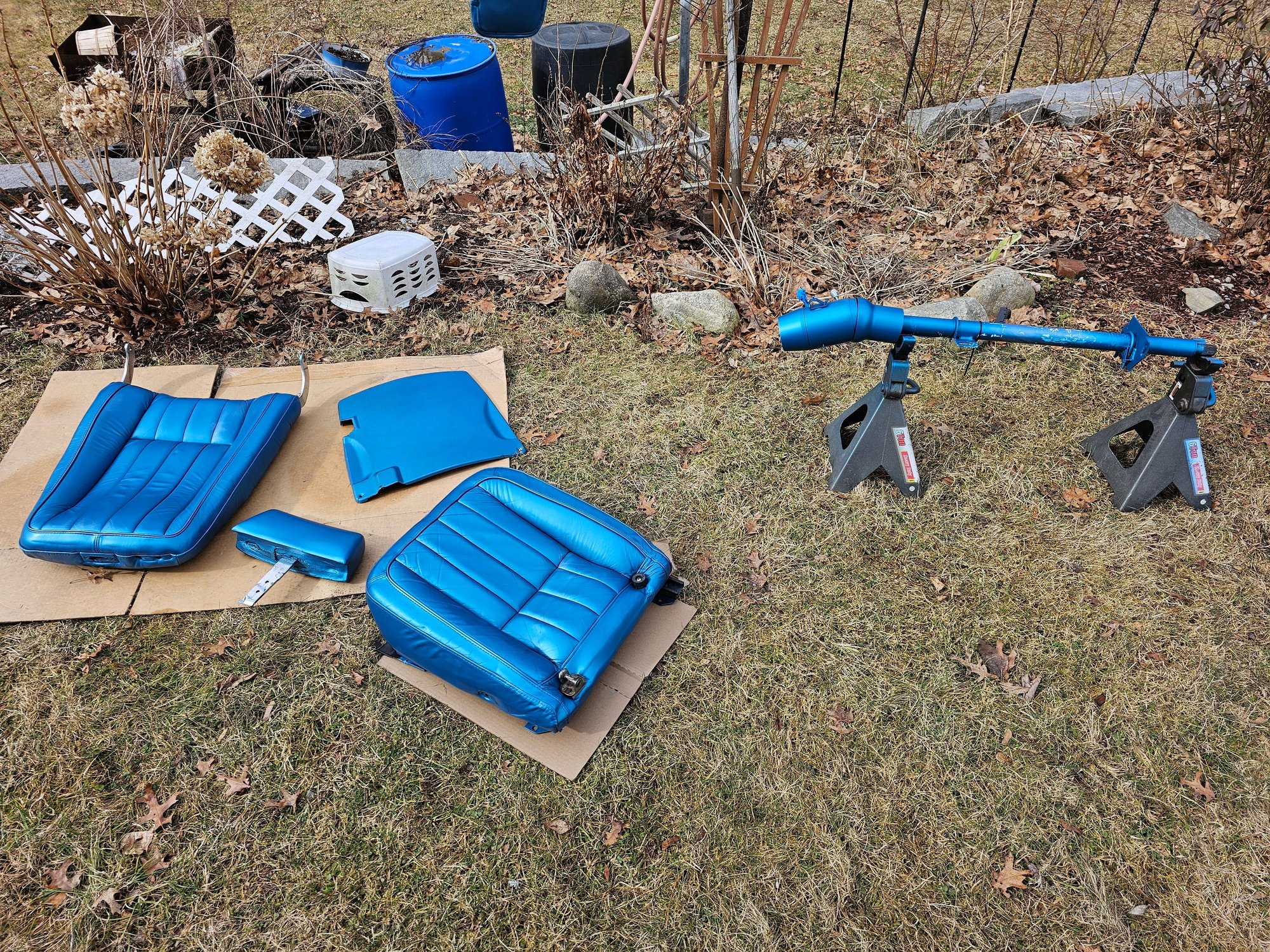

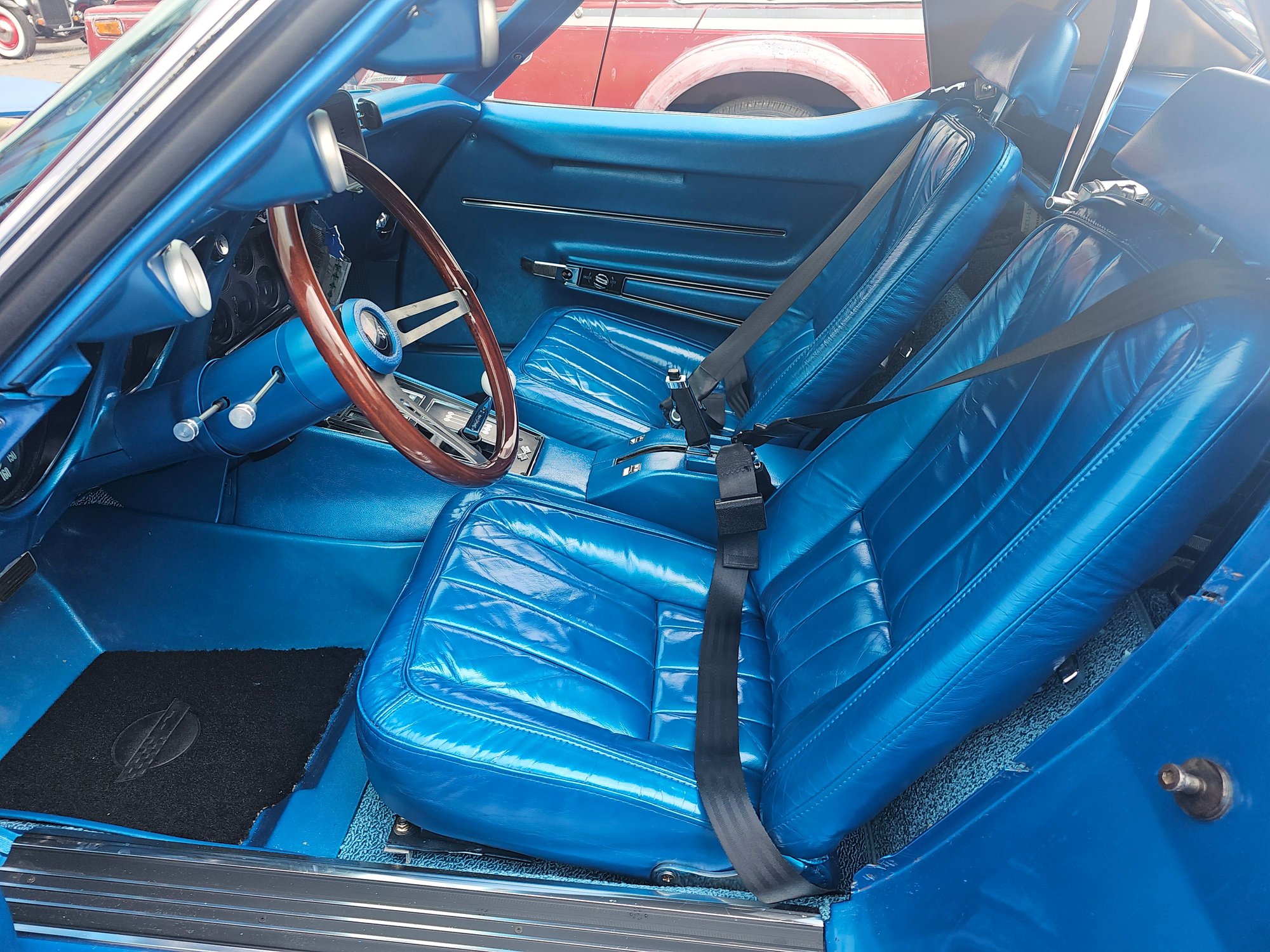

The Corvette America dye for Bright Blue will not perfectly match an original 68 Bright Blue interior. TH original was lighter and had more green in the hue. But if your interior has newer components like that center console or carpeting and such it will match because they have consolidated the colors. It is a very sturdy dye and if the part being painted is cleaned and prepped it will adhere very well. I redyed my entire interior and am very happy with result. It stuck very well to my leather seats as well. It will flake on the seats down deep inn the creases because of the depth and the in ability to get that area pefrectly prepped and covered perfectly. But still its very nice.

I had a feeling there was supposed to be a ‘break’ to get the slider around the handle - 90% sure I read that somewhere, but recently read about new ones not fitting. Sounded like they were all 1-piece, and getting ‘broken’ during install. I’ll clean mine, reuse it, and prep / lube a lil so it slides nicely. [Lots of reading on how that slider can bind if the parts are assembled incorrectly, or new parts have burrs.]

That’s a lot of blue in there, Rescue Roger’s - looks great! I’ll keep in mind that my console may “POP” like yours if I recondition it before any other panels. [Cameras only do so much to express colors - found that out on my post about VHT Chevy Orange engine parts. They ‘seem’ to have a red-tint in pics; look much more Orange in person.]
Speaking of which, that corner chipped apart into tiny pieces before I got the screw out. I’ll look into plastic panel repair kits and get a plan together.

You can patch the broken part with some stick-type (kneed it thoroughly) epoxy. You can also use the same stuff to back up the cracked area in the top of the center console. Sand and clean areas that will see epoxy so that it will stick. Form it as close to the final shape as possible. If you can find something with similar grain pattern, you can press it into the epoxy surface before it fully sets up (after about 2-3 minutes with the 5-minute stuff). Or you can use a sharp pointed tool to etch graining into the surface since it will be in an area that isn't easily visible. Use a soft brush to wipe off any 'cuttings' and smooth the final surface a bit.

Oh! And since I’m in there, I’ll look into some heat/noise insulation to replace the old batting, seal up the trans tunnel and make the ride a lil ‘cooler’. [“No pun intended”? NO!!! Be a man, INTEND ALL YOUR PUNS!!! 🤣]

For heat protection in the tunnel area, you NEED to install the foam collar above the transmission (or something of similar material) to prevent engine heat from entering the trans tunnel. Also make sure the upper heat shielding is in place in the roof of the tunnel...or put other type of heat blanket in there. The condition of the rubber boot is also important (manual or auto). If it is cracked or torn, LOTS of heat will enter the cabin area. If you install heat barrier with aluminum foil facing, put the facing DOWN to reflect the infra-red heat. Otherwise, the blanket itself will get hot and pass heat inside.

IIRC, I’ve head the stories about cabin heat and the trans tunnel insulation & collar seal go hand-in-hand.
I’ve got a tablet with a scope/camera app, so I’ll snake it down there and see what the last 56yrs have done to those components.
As far as ‘interior heat seals’ I’ll keep looking. But the parts recommended will be first on my list …for this part of the project - there are other parts that top other lists 🤣

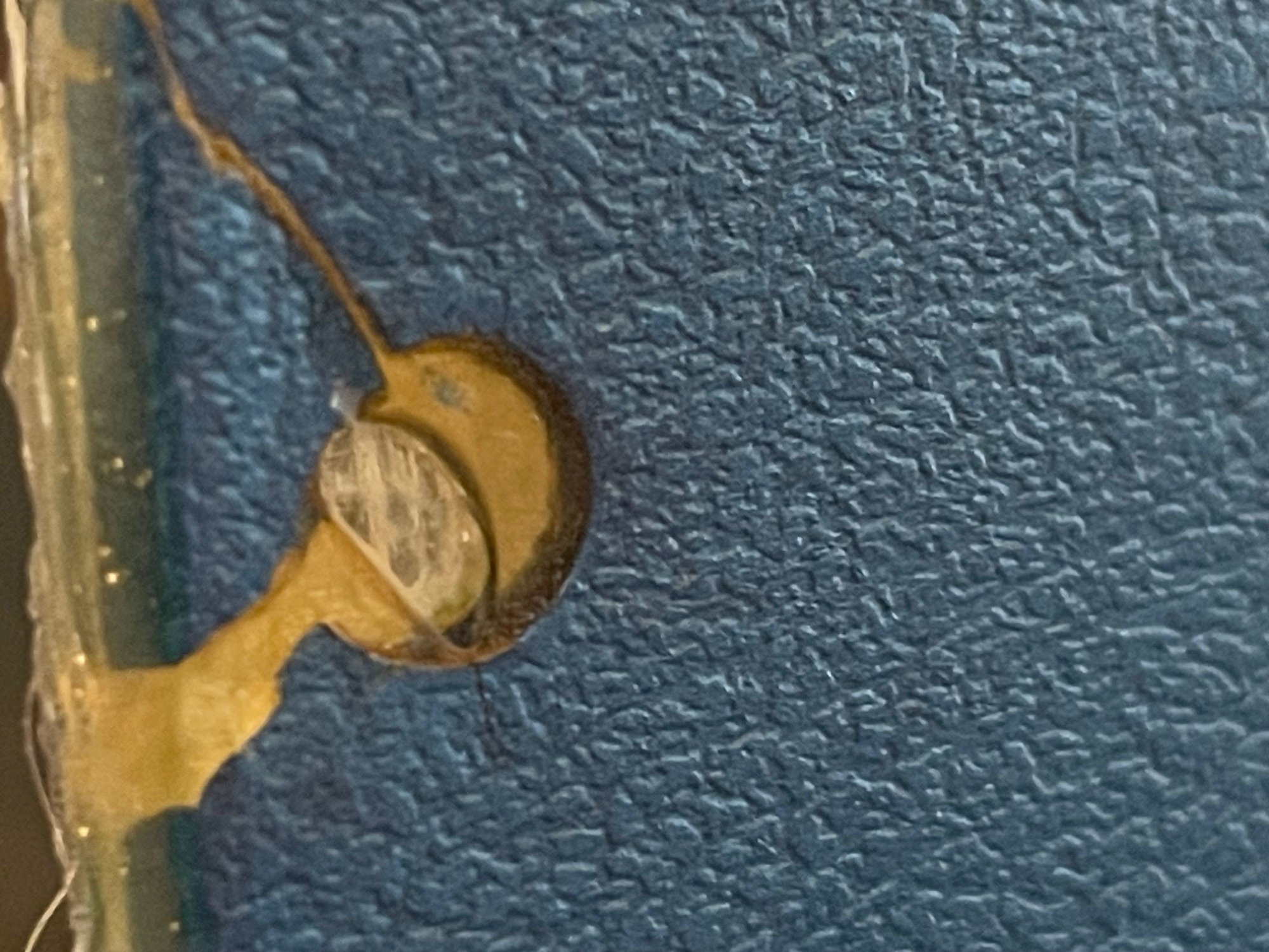

Speaking of repairing the console…
I’ve had pretty good luck with tape and fiberglass. So I thought I’d go that direction with this repair.
Maybe it's good enough…?
Painters tape on the outside, got the tiny broken piece lined up as best as possible [felt like 10-20 tries], and figured the resin would fill in the seams/gaps, as well as make up for the even-tinier piece that was missing.
I cut 3 square pieces at about 1”-1.5” per side, mixed up the resin, and probably threw away more resin than I used.
Folded the tape over the edge, making a 90° to act as a ‘wall’ to keep the resin in, and…
Not perfect, but better

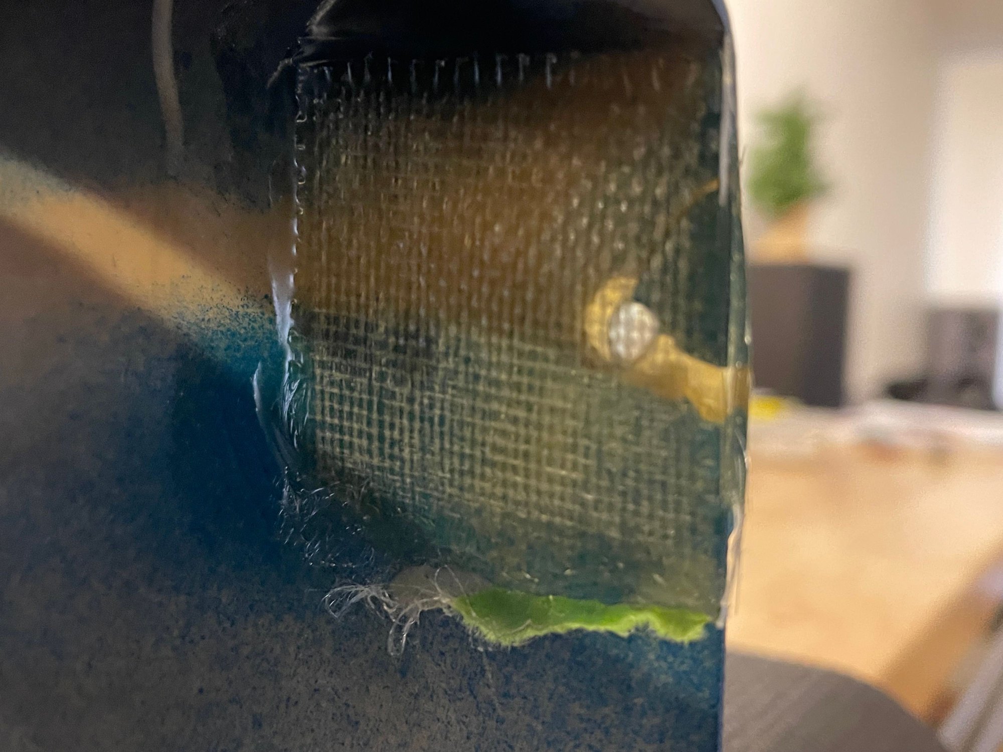

Inside, with the tape that got stuck under the resin

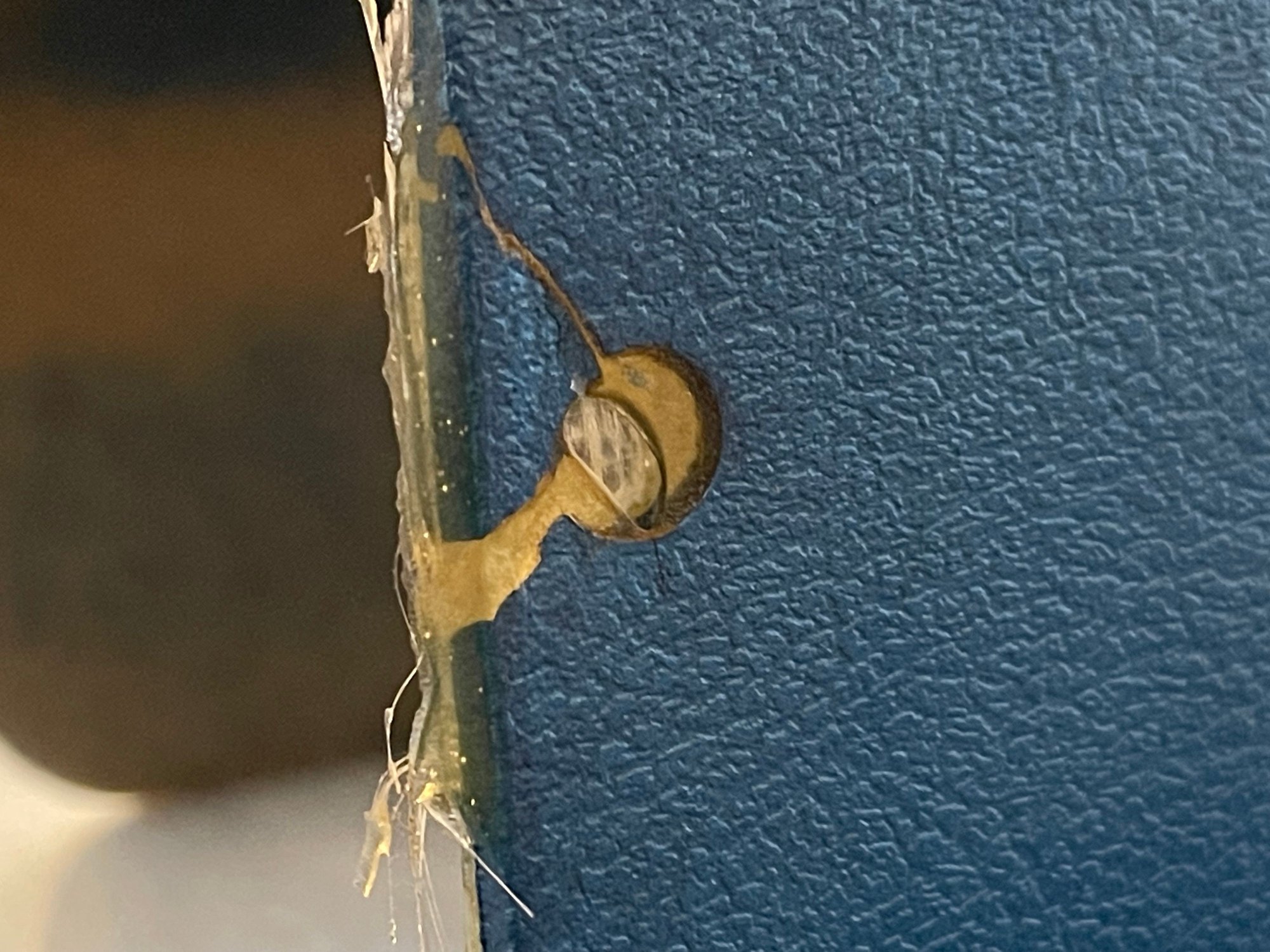

Close-up.
Close-up -> looks like maybe a drop of resin in the hole might help?!?
Just need to do a lil sanding on those stray fibers, wait til the Eastwood Bright Blue paint shows up, and touch up the newly filled spot.
Plus, carefully drill through it. AND NOT overtighten that screw.
I'd be proud if I could reproduce the texture, but that might be beyond my scope of repair.
