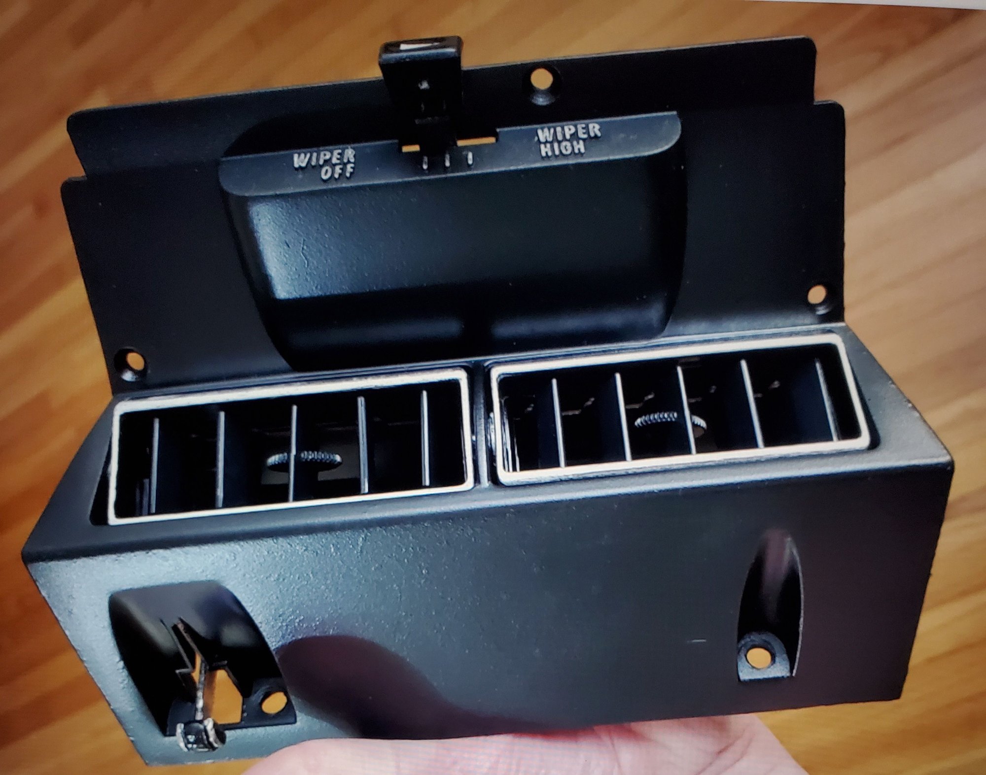

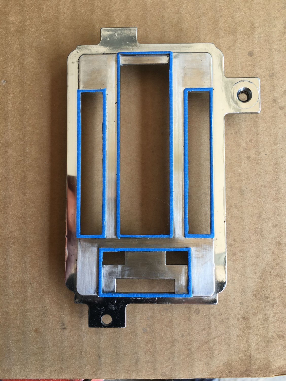

Originally Posted by Jeff2761
Very impressive. How do you handle the chrome letters and borders? I may attempt the center shift console.
With lots of time and patience!
After 53 years
After 53 years
1 hour to tape, 2 minutes to spray
Just like it came off the line in St. Louis
