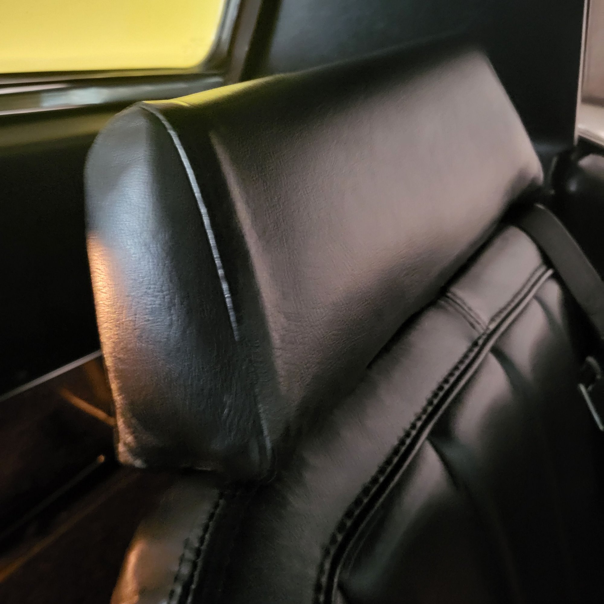

Anybody have any advise for installing leather headrest covers on a 69? Did one seat last night, I think I need to steam it to get rid of the wrinkles.

Can you post a photo of the headrest and what it looks like now?

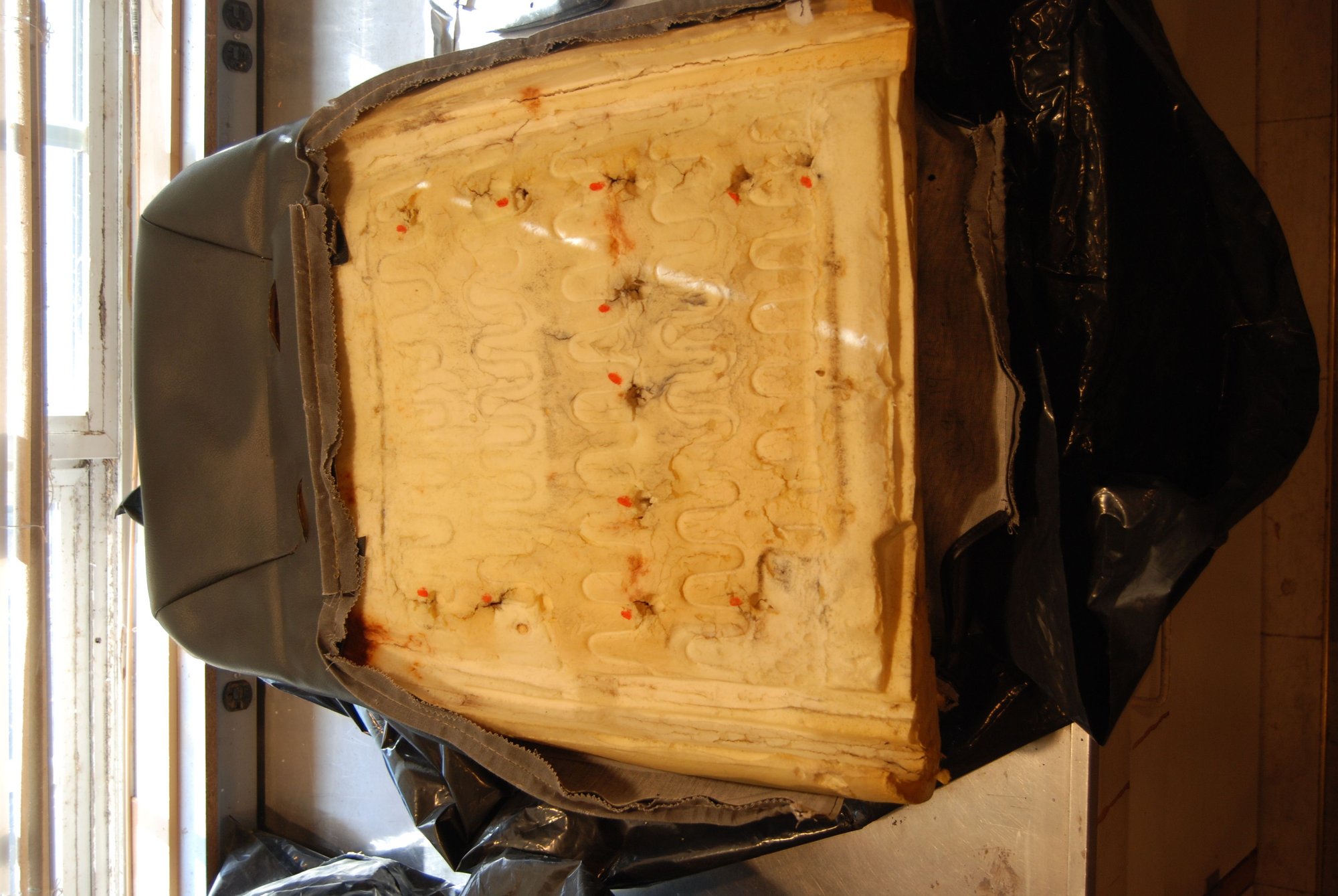

Not the headrest but I seem to remember pulling the stays in the seat back tight against the springs. It's been a long time so maybe I am wrong but that's what I remember.
Found a picture
i have a pic of the original.

I have done several sets of seats for 69’s but not leather and never had the wrinkle problem, especially when using new foam as I see you have. Leather might be another animal altogether so my advice might be crap.
The only thing I’m seeing but I don’t think it’s the problem is on the upper cover. The picture you show doesn’t show hog rings attached to the center horizontal corrugated wire. The extra pressure from that wire might give a little more tension? Or maybe not. Also I see you didn’t cut the slits to hook on the back seat panel. That might be tricky to do with the cover completely attached.
Otherwise they look good even with the wrinkles.

The leather covers appear to be installed correctly. Apparently, they need to be steamed to get the wrinkles out (per some YouTube videos I conjured up).
