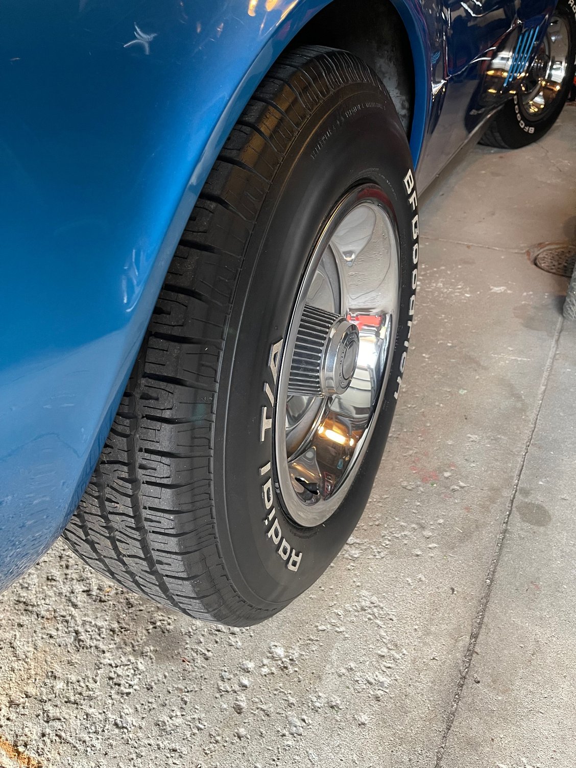

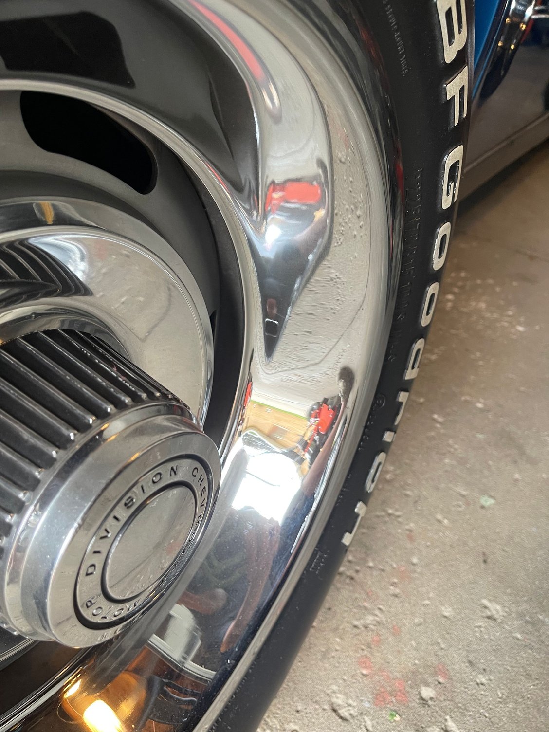

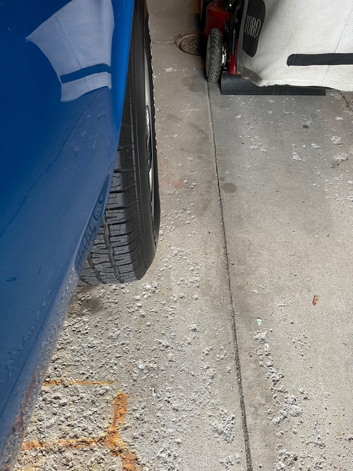

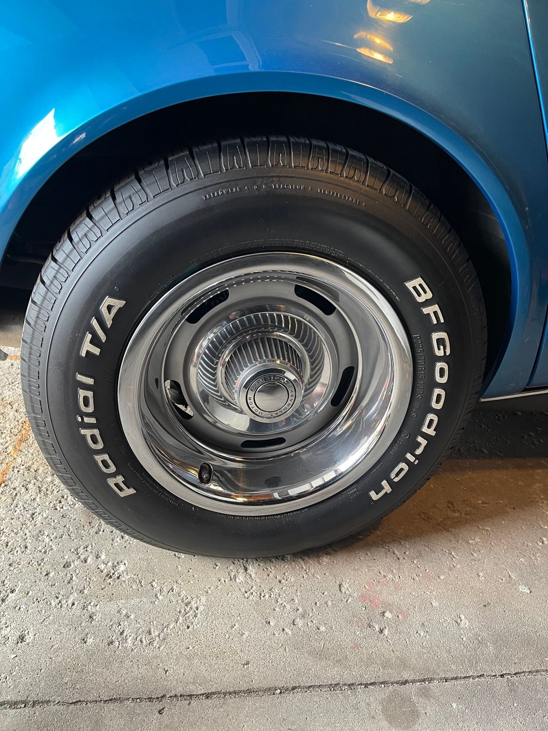

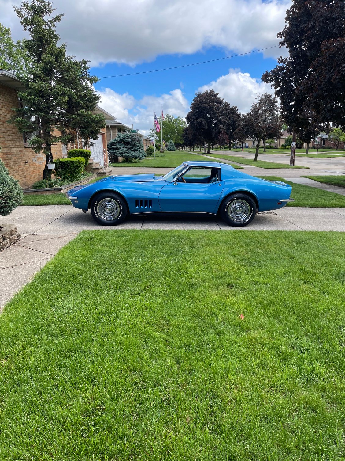

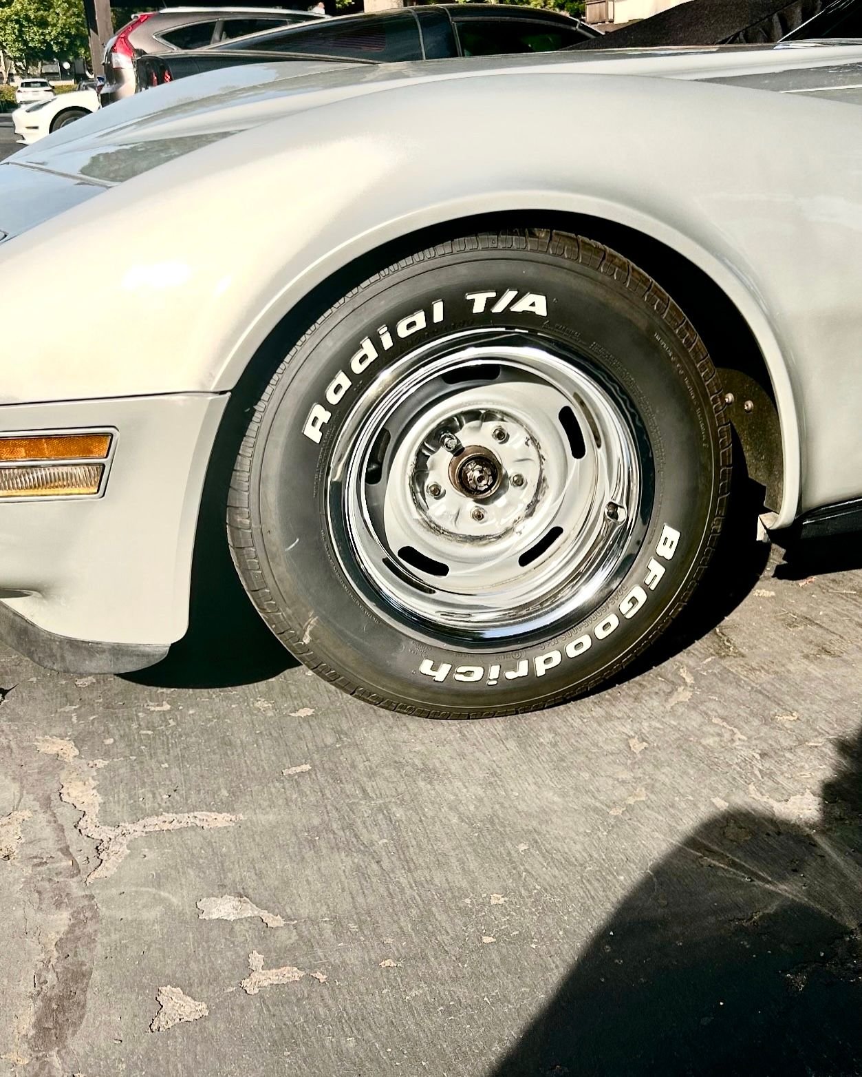

They very well could be 15x8 here are some pics I took before work.

Look like 8" rims, to me.
That is what i am thinking as well, I recall on the 8" the was approximately a 1" gap that they did not sit flush with the surface. I agree with you the look like 8's

Originally Posted by Jojo33
WOW Beautiful Corvette!! Love the burgundy color.
This is mine
love your car I have the exact car.
