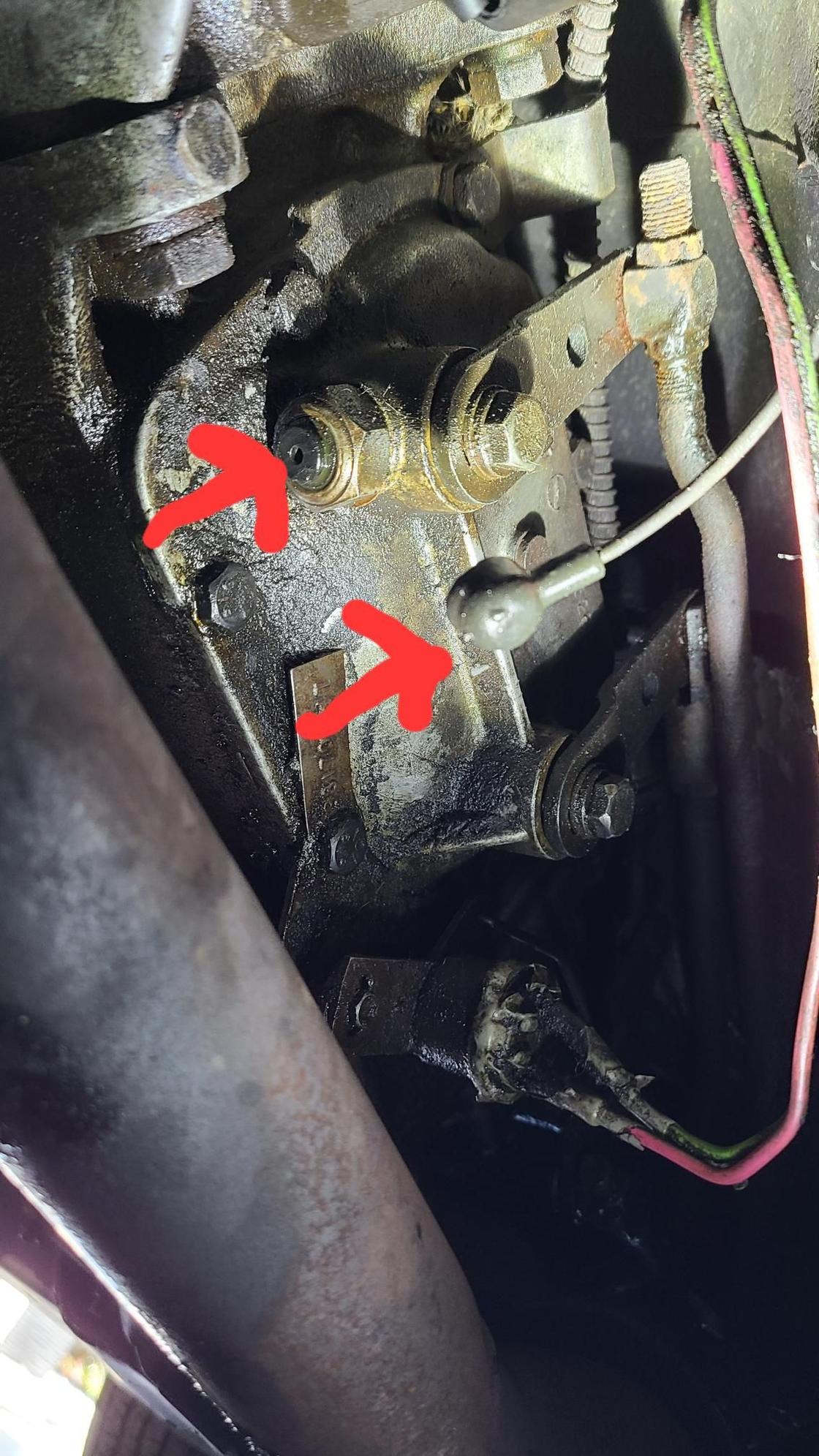

1971 Chevy Corvette. Four speed manual. 350 engine.
Can anyone tell me what this electrical connector that broke off of it's sensor(?) does? It's on the driver's side of the manual gearbox near the shift linkages. It's not the backup light switch. That is visible at the bottom side of the image. I tried shoving the electrical connector back on to the sensor(?) but I think it's broke. What does it do? Any link to buy a new one? Thanks.

70-71 Manual TCS Transmission Switch (Pin Terminal)

I would remove the entire Transmission Controlled Spark system. Won't hurt a thing. Actually, it will probably run better without it.
