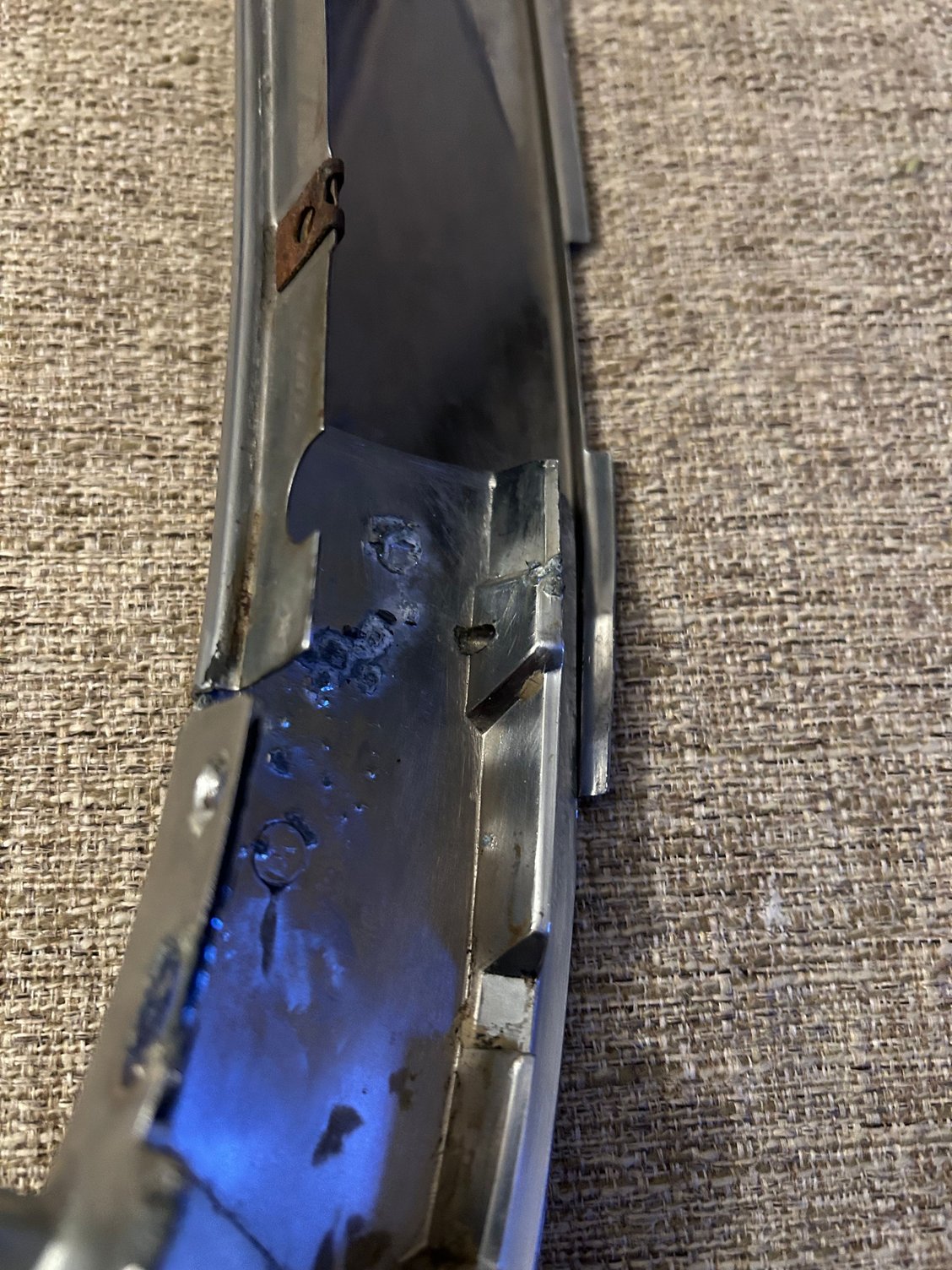

What is the part number cast into the underside of those, because they look like 69-76's to me? The 68 header corners I'm familiar with have the pin receiver as a separate casting from the header molding itself, like a 63-67.

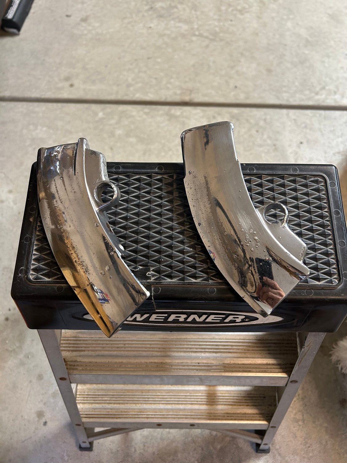

Interesting. Numbers are:
3935503 LH
3935604 RH
I didn't even notice until looking closer but there is a very slight difference where this goes under stainless. 3935604 RH has straight edges and 3935503 LH has a slight contour of fore and aft edges.

Let's start with I think the left hand is 3935603, not 503.
I think you'll be okay with the 69-76 moldings.
Bare with me because this may get a little confusing. I looked at my September 1970 Corvette Parts Book, a December 1980 Corvette Parts Book, and my work laptop. Both the of the Parts Books list a first and second design header corner molding for 1968. The "first design" is the two piece one with the separate receiver for the top pins, listed as "3915667" left and "3915668" right hand. Both Parts Books list the 68 "second design" corner moldings as "3966601" left hand and "3966602" right hand. The 1980 book also notes this molding as "W/ATTACH BSHG" which I assume means it has the attached receiver that takes the pin bushing, instead of a separate receiver like the first design. The 70 book also lists "601" and "602" for 69-71, and the 80 book lists them as 69-76. I don't have a 68 Assembly Manual at the house, but the 69 AIM shows the "601" and "602" as the corners installed in 69. Finally I have a note in my parts section of my laptop showing the 69-76 corners as a "replacement for 68 2nd design".
This is just a guess, but it appears to me the "3935603" and "3935604" corners you have are the "true" second design 68 parts, and that sometime between the end of 68 and when my 70 Parts Book was printed, they were replaced in the parts system by the 1969 corners, "3966601" and "3966602". There may be a very slight difference between the 68 corners you have and the 69 up corners, but it's probably insignificant enough that GM determined the 69's were an acceptable service replacement for the second design 68's. I think you'll be okay with the center header molding too, because normally the Parts Book will have a note if a modification has to be made to use a substituted part.
I'd hold onto the moldings you have. The 68 first design two piece corners are pretty sought after and your's may be of some interest to another 68 owner too, depending on if there's a visual difference to them compared to the 69's.

Going thru this same issue with a 69 coupe, an early Sept 68 build.
I think the following:
Your photos of your corner moldings match the 68 AIM numbers 3935603-4 with no slot on the inboard side to install a sheet metal nut.
Your matching ss top trim should not have a hole in the end if a real 68 pc.
69 and up corner moldings are 3966601-2 per my 69 and 72 AIM and I think this is constant until 76?
These 69 and up corner moldings have a slot and you install a sheet metal nut there and that slot matches a dimpled hole in the ss top trim. This ss top trim would be a "T" shape for a coupe and I have both top trims for a 68 and 69+ coupes, sure enough the ss top trim has a dimpled hole for the 69 and no hole for the 68.
The 2 pc 68 corner molding with 2 pc's is very hard find. I think the 2 pc was for 68 verts, maybe?
Agree with above, you can buy 69+ corner moldings all over pretty reasonable. The real 68 pc in your photos 3935603-4 I could not find a reproduction.
So, I think the 69+ pc will fit in the place of the 68 pc 3935603 -4 BUT you need the matching ss trim top pc with the hole to fasten the screw to the sheet metal nut in the slot. OR maybe not maybe you just fasten the top ss trim as the 68 design and the slot on the 69+ molding is hidden. I will find out in a couple of week, as I have the same issue. Hope this helps...maybe

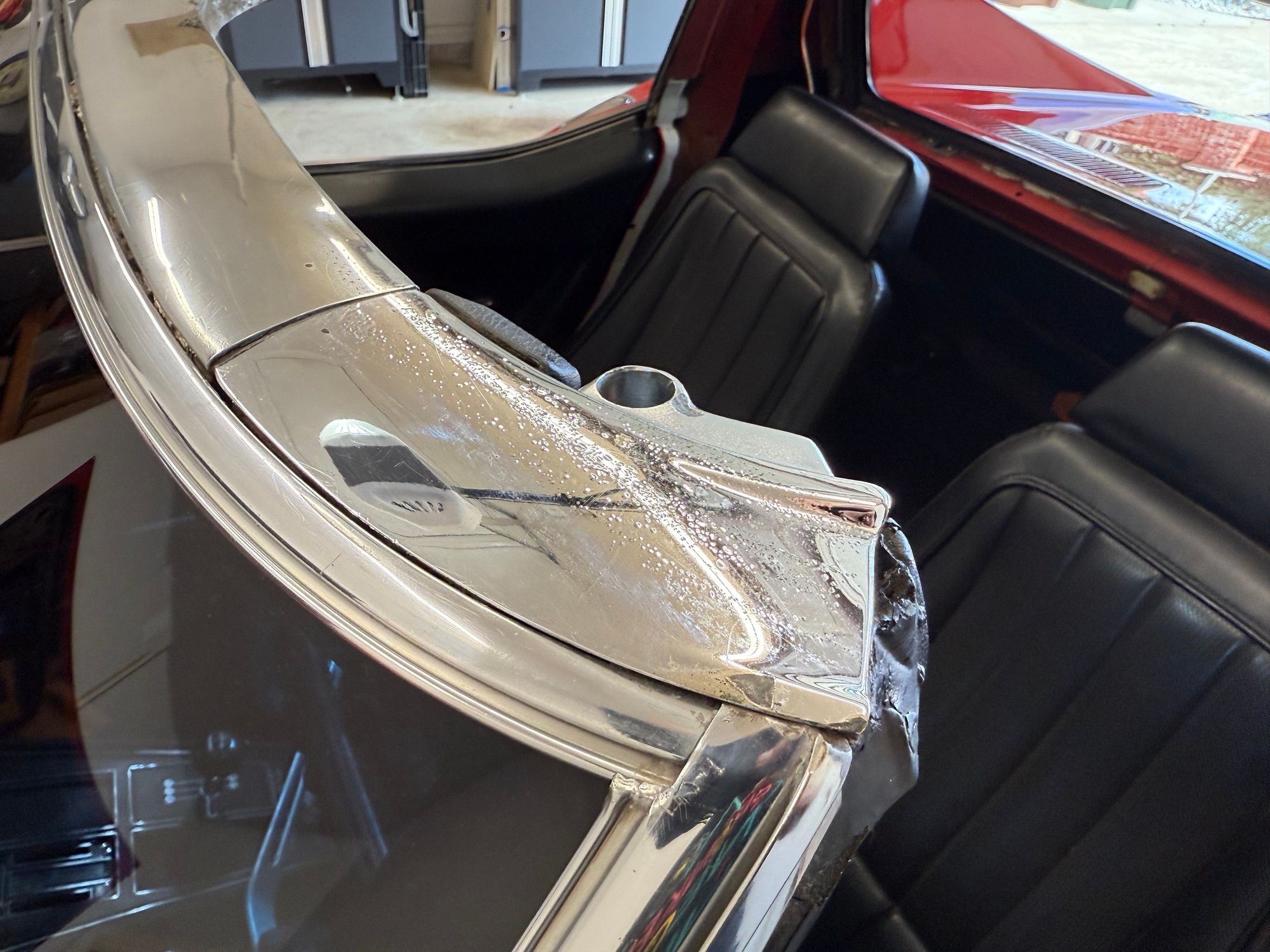

I replaced these corner pieces on my 70, reproductions. After two years, car kept in a garage, I’m seeing pitting already. Could be poor plating? You may do better having the originals restored and plated by a reputable plater.
Ive thought about buying reproductions, having them stripped and replated, see if they stand up better. I can’t speak on a 68 but the later years require removing the windshield to get at the screws. May be worth spending a bit more up front?
Same pitting showing up on reproduction exhaust bezels and license plate frame. Reproduction parts are quite disappointing.

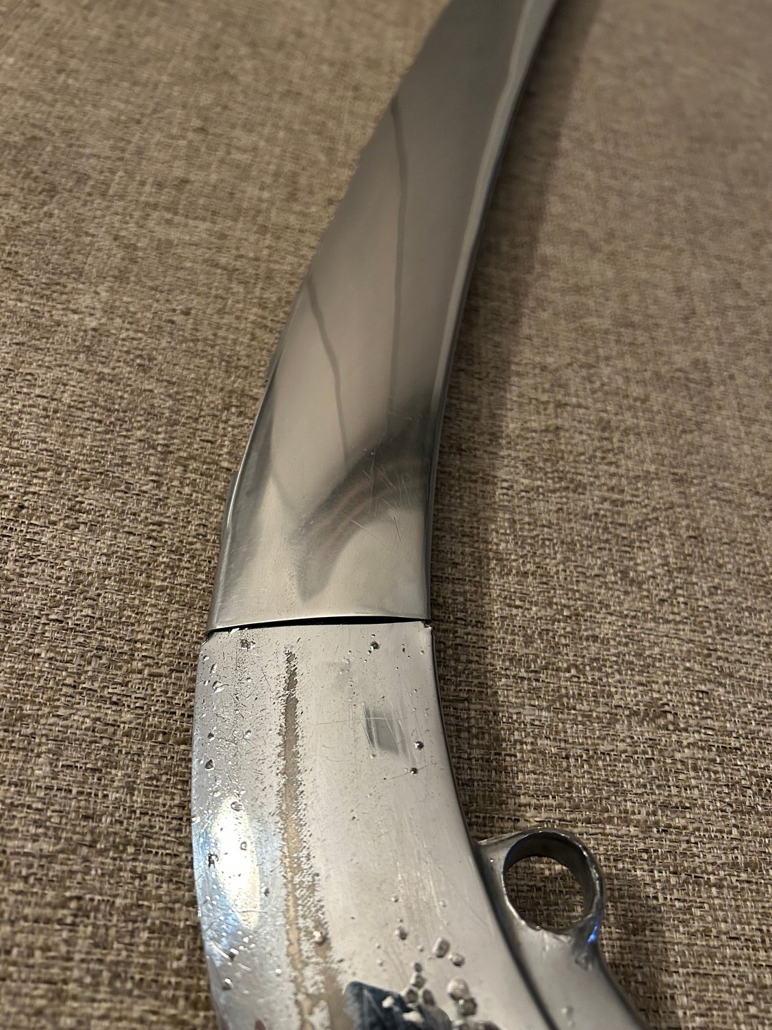

Hi Rob. I have a 68 coupe (March build) and your pieces look just like mine. You probably have the later 68 design. Attached is a pic.
Im in Texas, and considering getting mine plated… can you share the place you had talked with? Thanks for your help!
