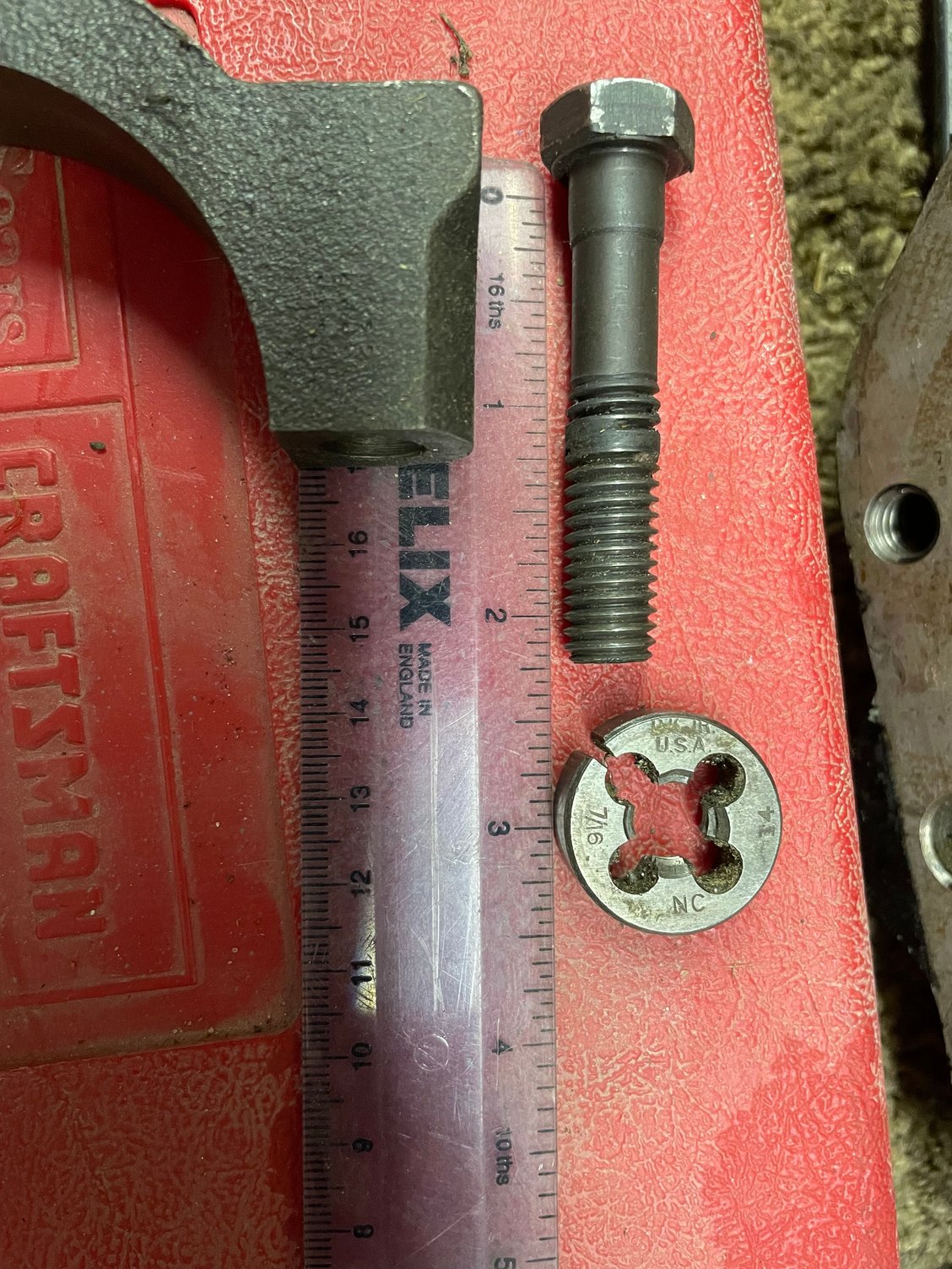

I cannot find the answer to what must be the closest guarded secret on the internet. What is the size and under head length of the 4 bolts that hold the differential carrier in place? Also, does anyone sell replacement girdles that hold the carrier in place? I'm trying to gather parts for a rebuild before I take everything apart. Thanks.

7/16 x 14 x 1 1/4

I need the length of the bolts that hold the differential carrier (Posi traction unit) inside the cover. They are approximately 7/16 x 2 1/4" from what i can tell by looking at pictures. Thanks

They are 7/16 - 14 x 2 1/4. This is from a 65 I am working on.

The bolts are the size mentioned- 7/16-14 x 2.250" However, every cap should be checked for correct fitment. MOST times, if original, they're good as long as they are kept on the same side. Sometimes they are not correct, other times conmen or people who should not work on these mix and match things, including bearing caps.
There is no secret to the bolt size unless you are rebuilding a diff that didn't have caps to start with and then you have to fit caps. Caps from one diff to another can be off 010-015".
