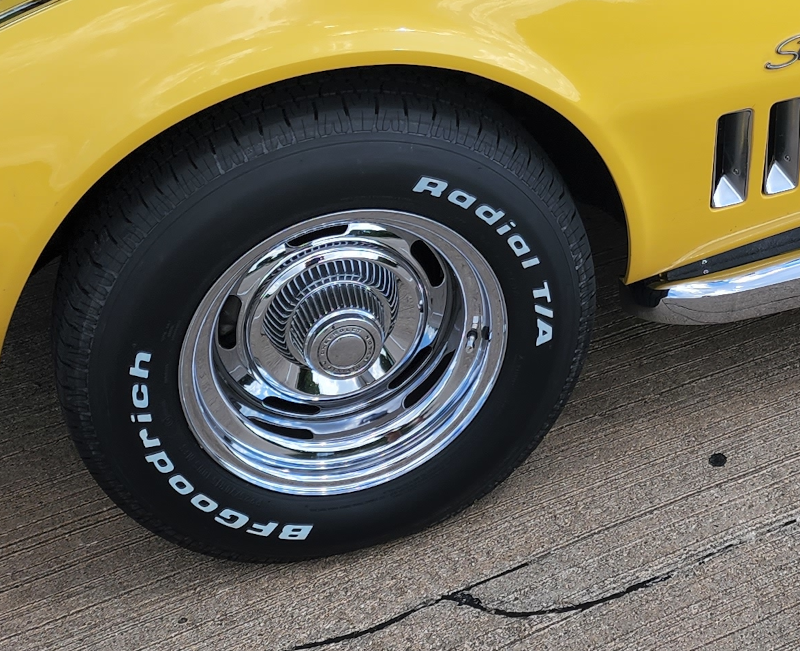

I'm not about 100% originality so I went with chrome rally wheels to do away with the trim rings. Don't have to worry about trim ring wobble or falling off, they look great and are simple to clean. Just an option....
That looks great.
