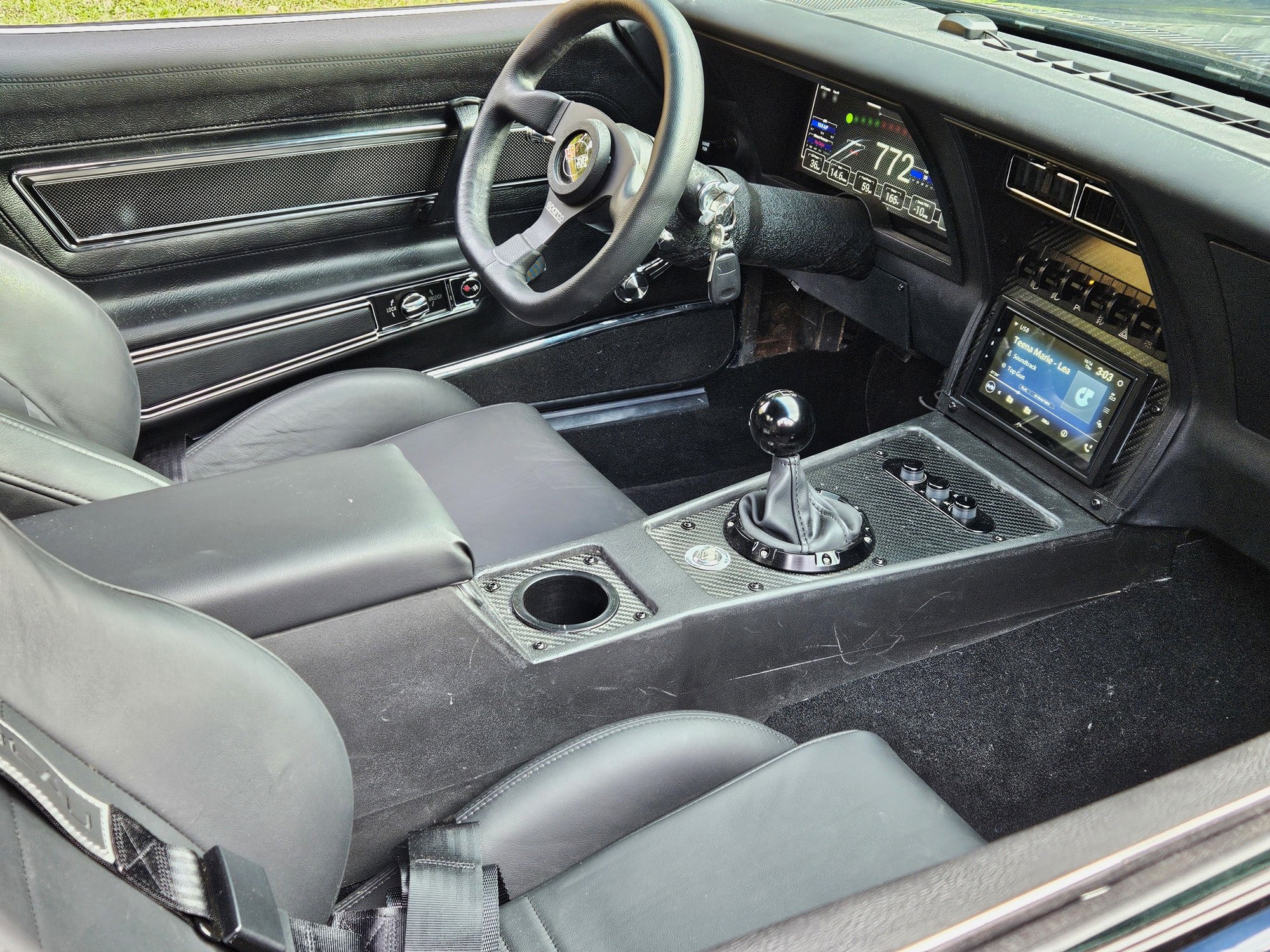

Finalized the last few details on the interior and center console. Use a laser engraver to make some custom plaques and labels. I call this project complete!!
Such an awesome build, the interior is perfect! Is that switch in the center console how you activate the parking brake?
Thanks! The switch activates the Wilwood electric parking calipers. Took some fabrication to make brackets to adapt to the rear swing arms. They work fantastic and eliminates all the original cable operated nonsense.
