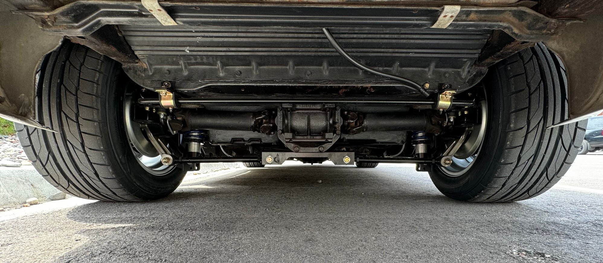

Originally Posted by BKbroiler
These are BFG 275/60/15 drag radials. Stock trailing arms with parking brake cable bracket relocated.
^Like the above I’ve heard of people fitting 275/60r15s on the stock wheel, but you can see how much it’s ballooning out from the wheel itself. Personally, I would stick with the 255s all around for the sake of being able to rotate them, but if you want wider tires on the rear I would consider wider wheels. I have 275/50r17s on 9” wheels and 255/50r17s on 8” wheels in the front.
