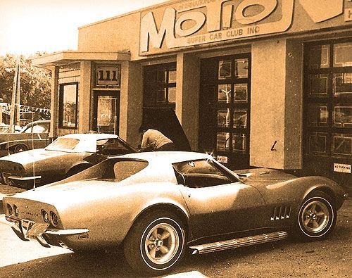

Motion Performance did it so apparently it can be done. These are obviously big block cars, but I’m certain a good welder can make the pipes work with a small block.
If so, what mods do i need to do?
On that note, you’re on your own my friend!

I noticed that the second and third examples you posted each have the GTO type gauge housing on their hood.
Interesting!
Since the mid-year side-exhaust covers seem to be completely below the rocker trim panel does that make them quite close to the ground?
Regards....
