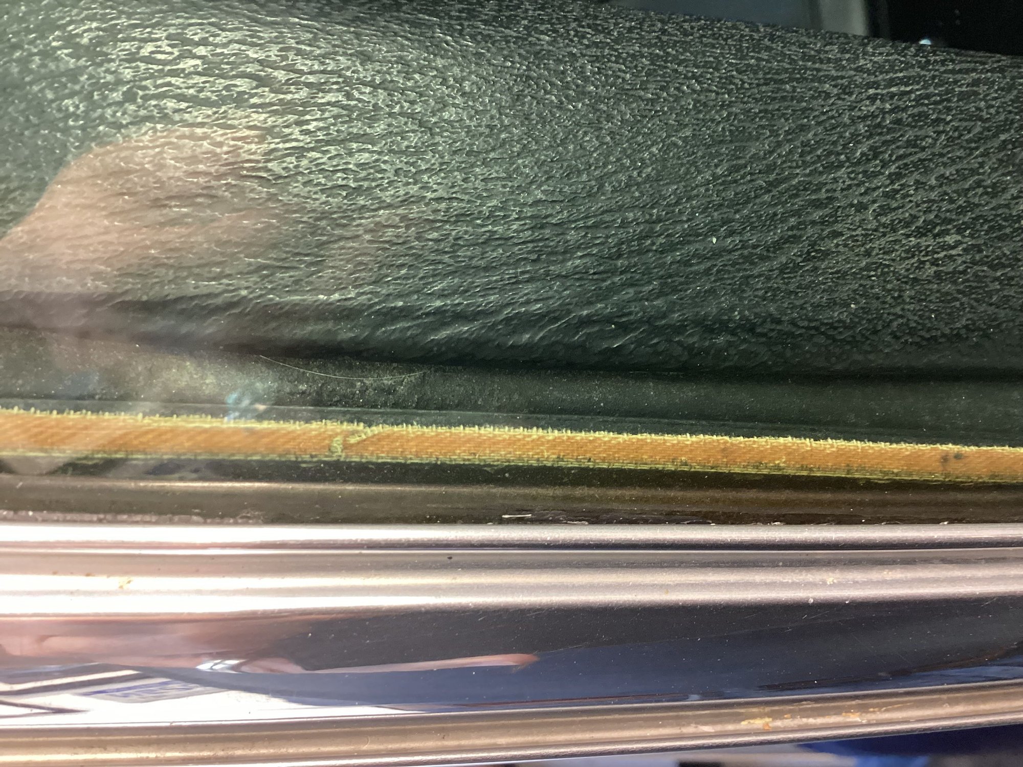

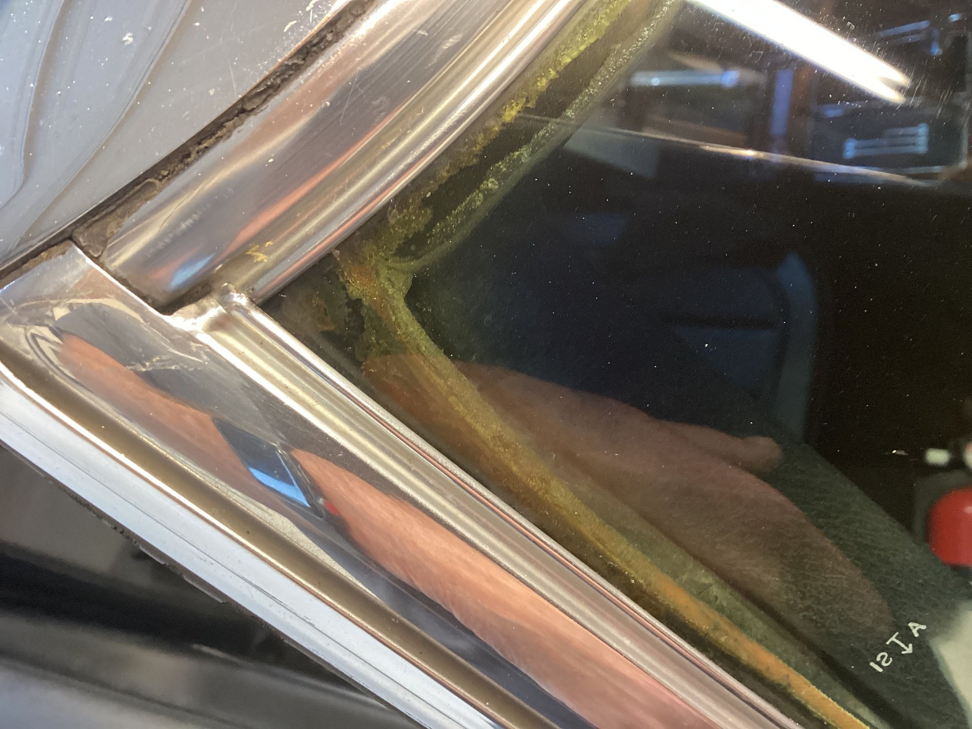

Hi Stan, my original 73 windshield is in place along with the surrounding trim and some of the damming material is visible through the glass in several places. It’s amber in color. Would pics of this be helpful to you or are you looking for pics of the materials after being disassembled?

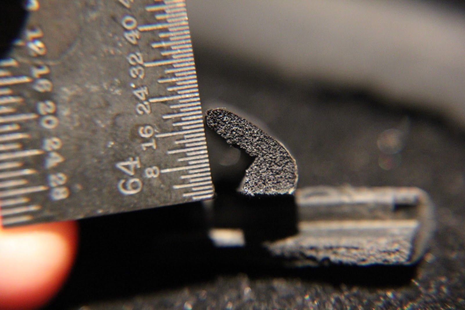

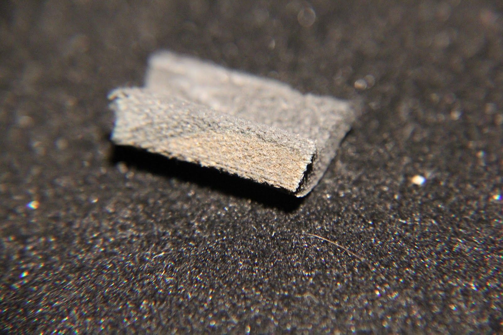

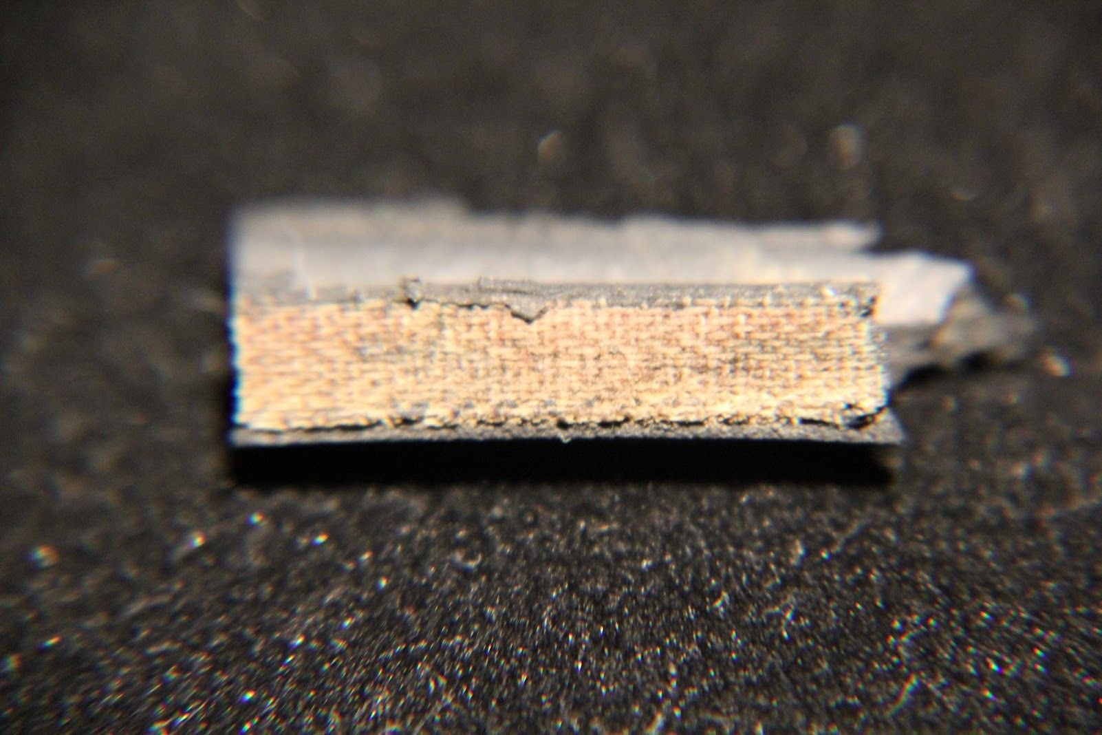

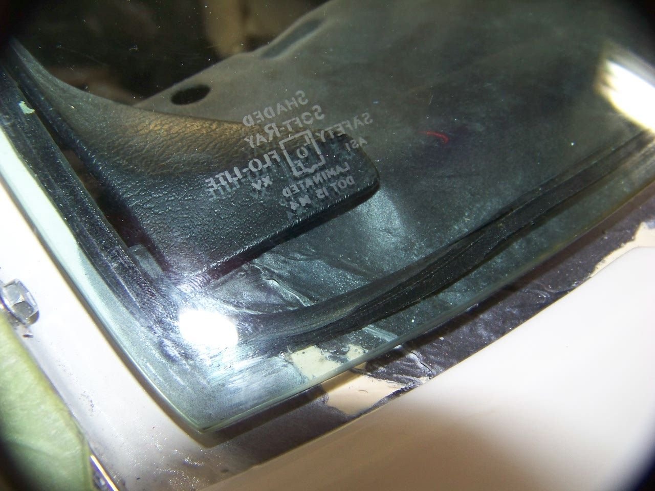

Here you go this was removed from an original glass by me.

Thanks James, that’s perfect.
Looks like the dam has an interesting shape (I believe that one of Alan’s diagrams showed this shape as well)… The cloth covering appears to be on the curved, outer section of the dam. Not sure that any of the dams currently sold come in anything but a rectangular shape, but I think that I can make that work.
Appreciate the detailed photos!

I felt that the 'material' used for the adhesive strip was like a piece of cotton from a bedsheet.
The strip needed to be so narrow and thin I couldn't handle it and gave up.
James' detail photo shows a strip to be more like 'linen' which might be a bit easier to work with.

The "linen" is on the flat not curved side... I made my dams by splitting some latex covered foam weatherstripping purchased at Lowes or Home Depot.
The curve is from being installed in the car and "rolling" over.
Another installed photo across the top of the front glass.
From what I have seen -removing originals the linen material was black originally but sunbleached from exposure.
One of the photos I posted shows the black color on the linen.
I have a bag of the original material around here somewhere.
Here is another photo of prefitting the glass with the dam in place. JohhZ stated that the dam was on a roll the "linen" backing kept it form being stretched thin.

Old Nov 6, 2025 | 07:43 PM
210ken's Avatar
210ken
Joined: Aug 2010
Posts: 651
Likes: 452
From: Napa, CA

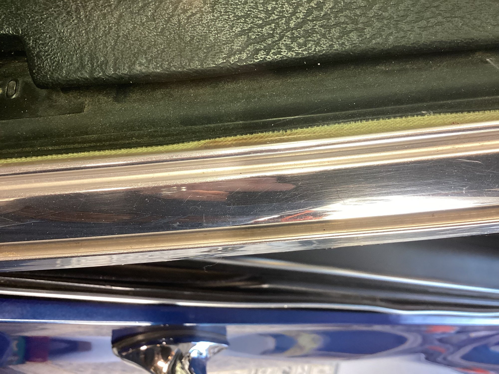

Driver side A pillar
Pass side upper corner
Pass side A pillar
Pass side A pillar

Perfect sir!
Thank you for posting the photos!

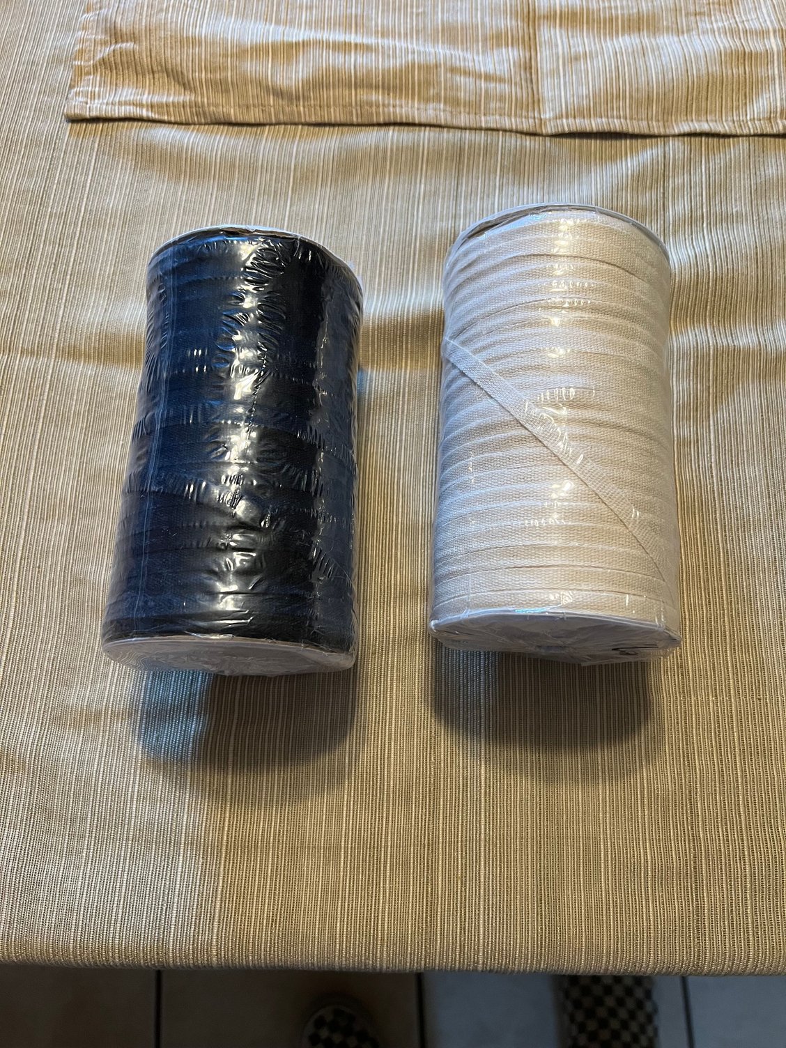

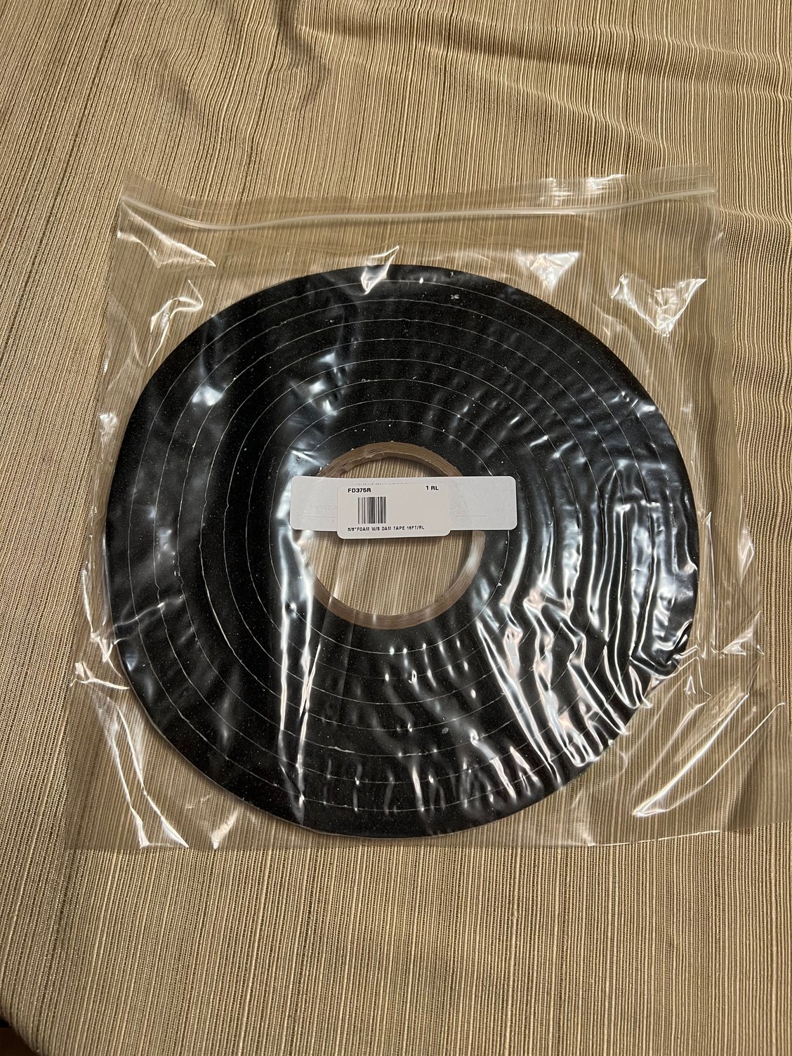

This is what I picked up to use as the linen material for the dam. As noted, I intend to use the black material based on James’ (firstgenaddict) observations. This material is (nominally) 1/4” wide.
I also purchased several windshield dams, 3/8” x 1/4”. These have two sided adhesive… I’ll attach the linen on one side and attach the other side to the windshield frame.
That’s the plan anyway.

Old Nov 10, 2025 | 09:14 PM
Alan 71's Avatar
Alan 71
Joined: Sep 2006
Posts: 31,279
Likes: 4,372
From: Westminster Maryland
Hello Stan,
Those rolls of material are a nice find on your part.
Was it much of a search?
Might the linen strip cause the foam strip to 'kink' up at the corners?
Regards,
