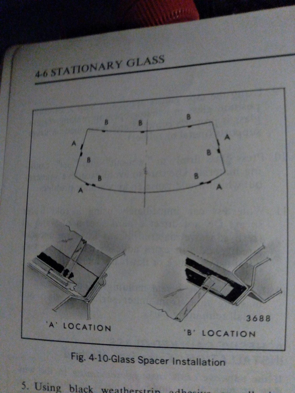

Here are the pages from the FISHER BODY MANUAL.

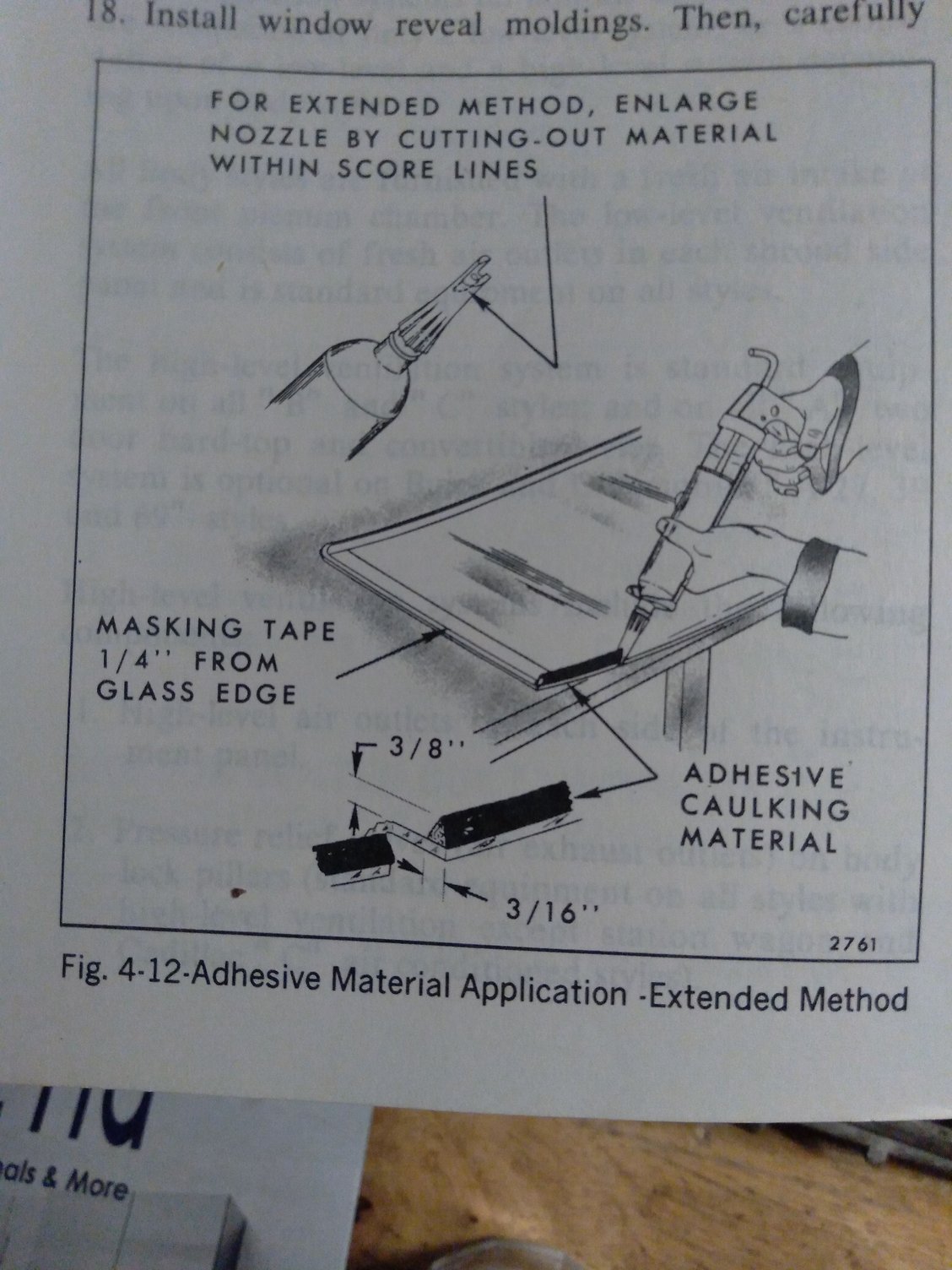

Old Nov 12, 2025 | 08:09 PM
firstgenaddict's Avatar
firstgenaddict
Joined: Sep 2018
Posts: 1,002
Likes: 410
Where it says masking tape 1/4" from edge of glass is where I put the dam.
