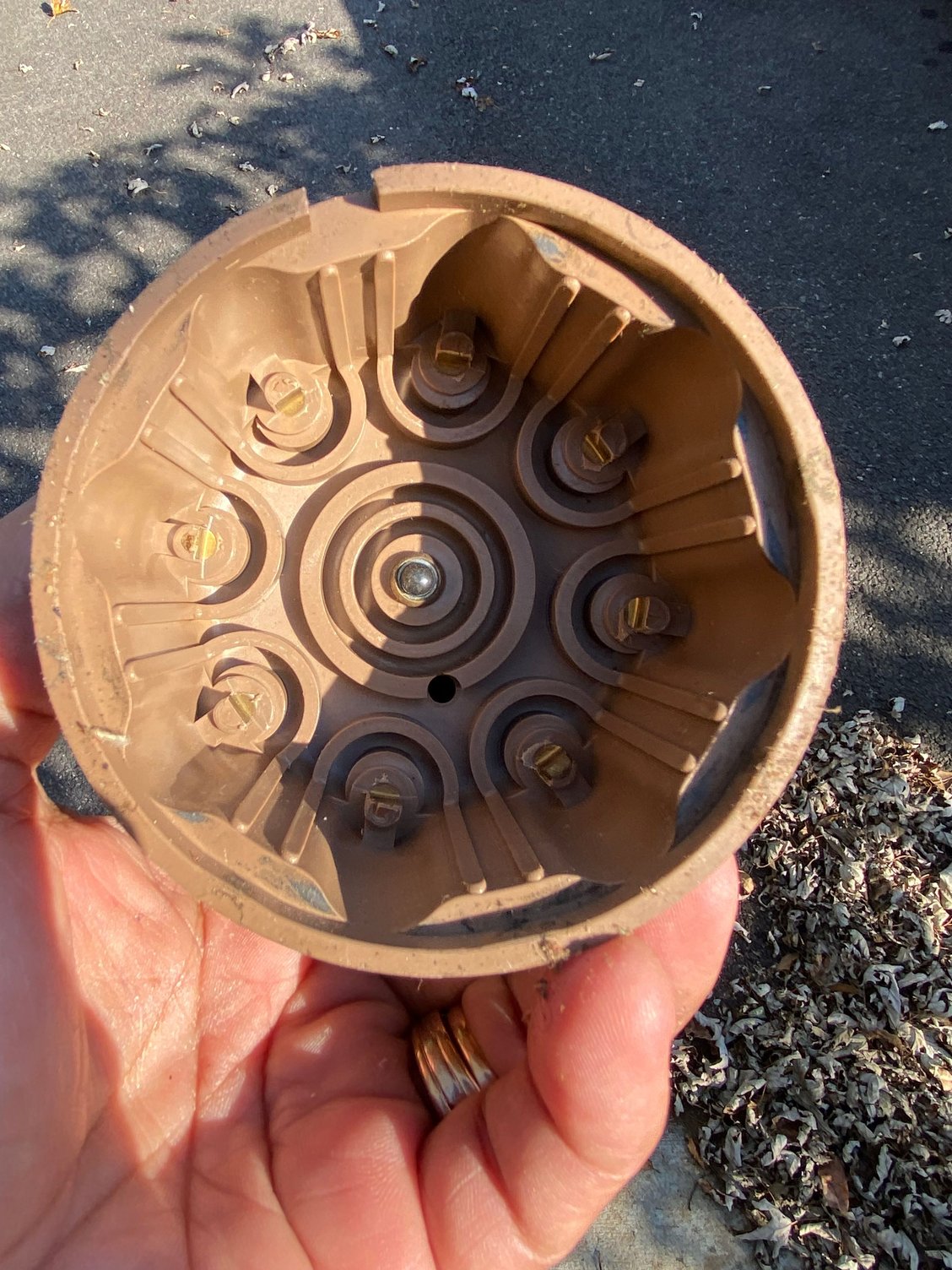

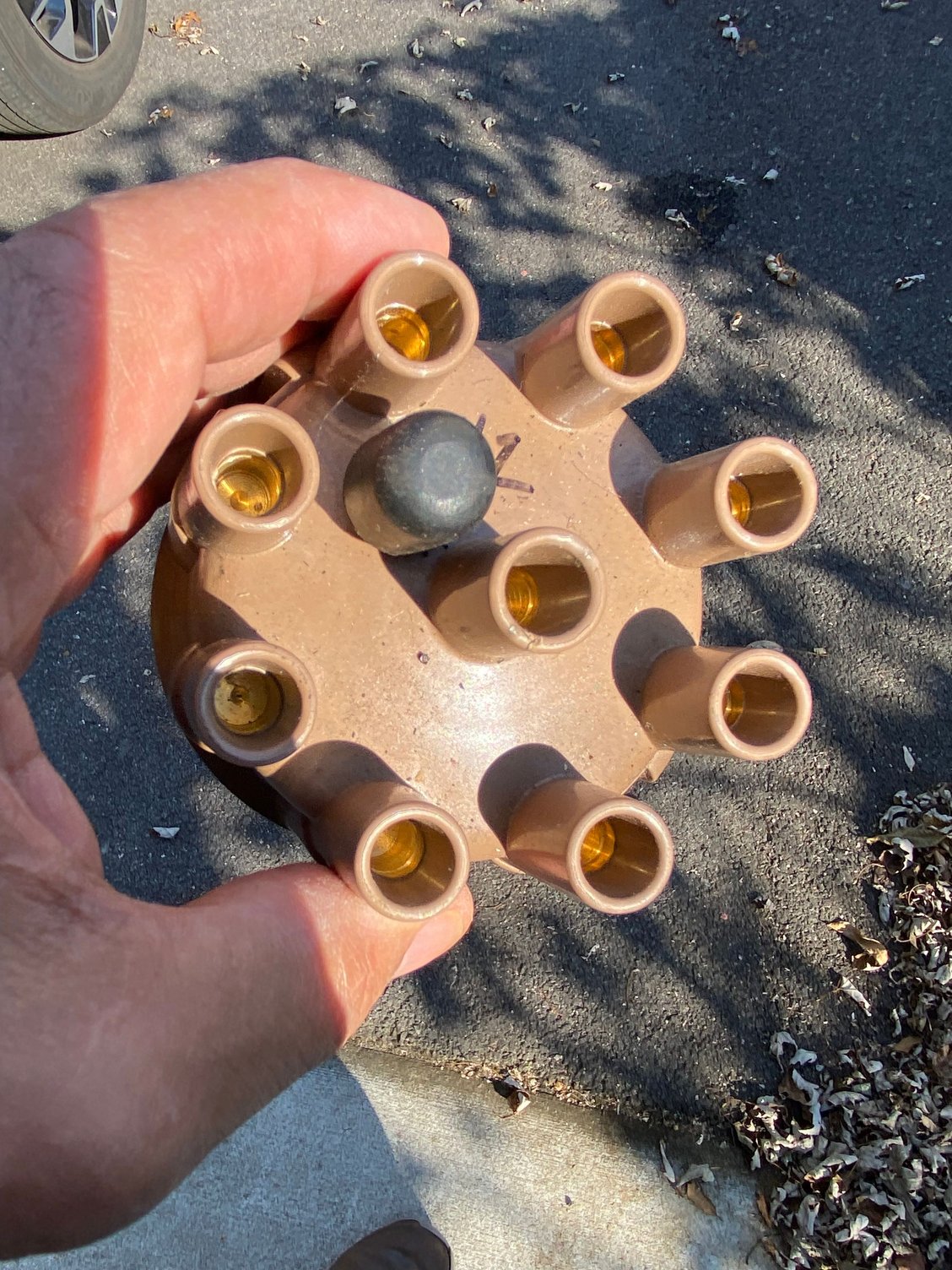

Venting cap & base of dist is very helpful to good performance & reliability. The shower of sparks within dist ionizes the humid air; creating a corrosive environment which becomes more prone to crossfire-misfire.
Marine-grade caps often have a vent like shown in pic in P#2. The dist in final sbc gen 1 iteration (L31 & L30) have dist with small vertical hole in base (for ventilation) but they become clogged and then dist goes to hell.
Ventilate it and keep it free-flowing and that's half the battle. FWIW, Gen II (LT1 & LT4) sbc had lotsa dist problems; many were solved by venting and even had a tube attached to intake that pulled a vacuum thru dist body.
