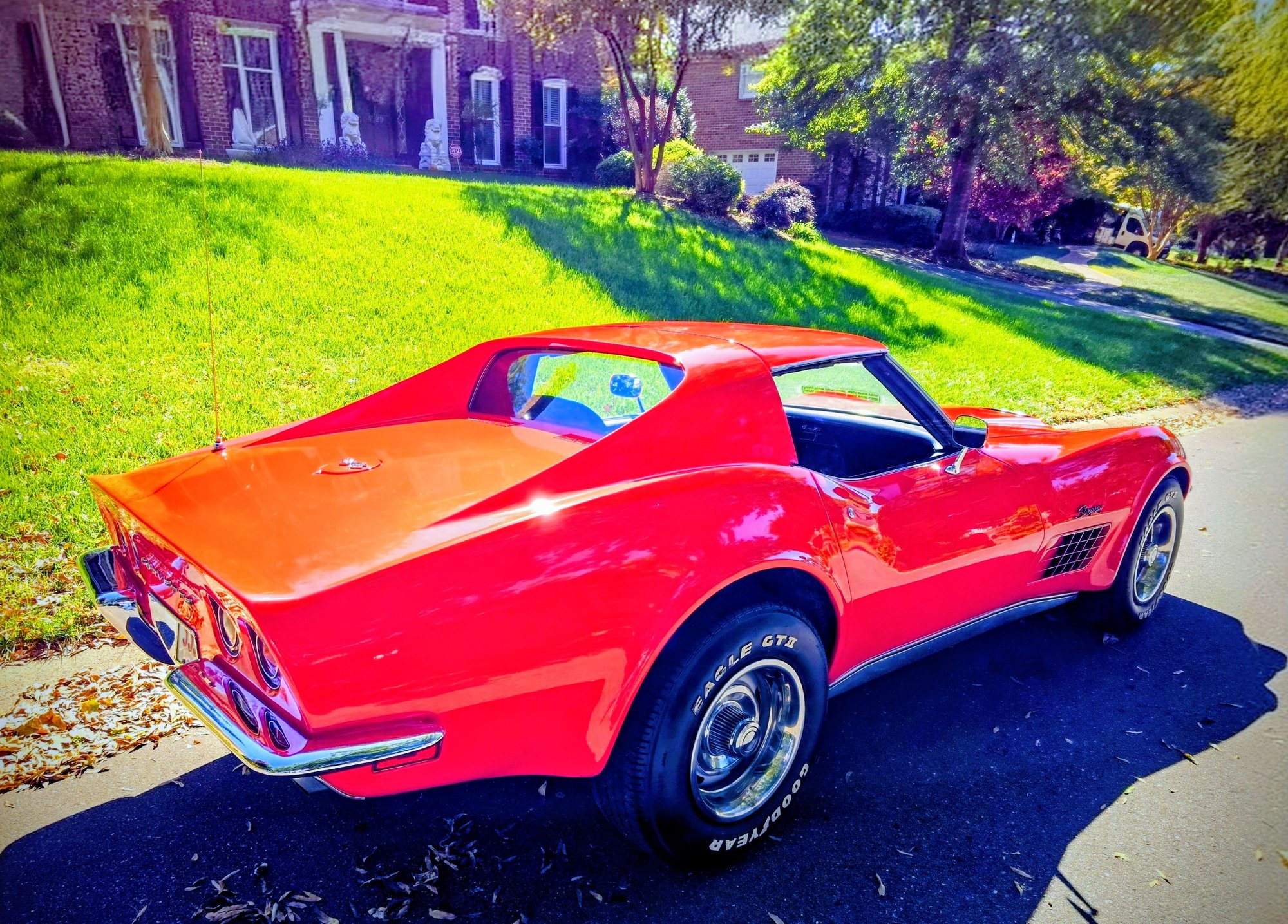

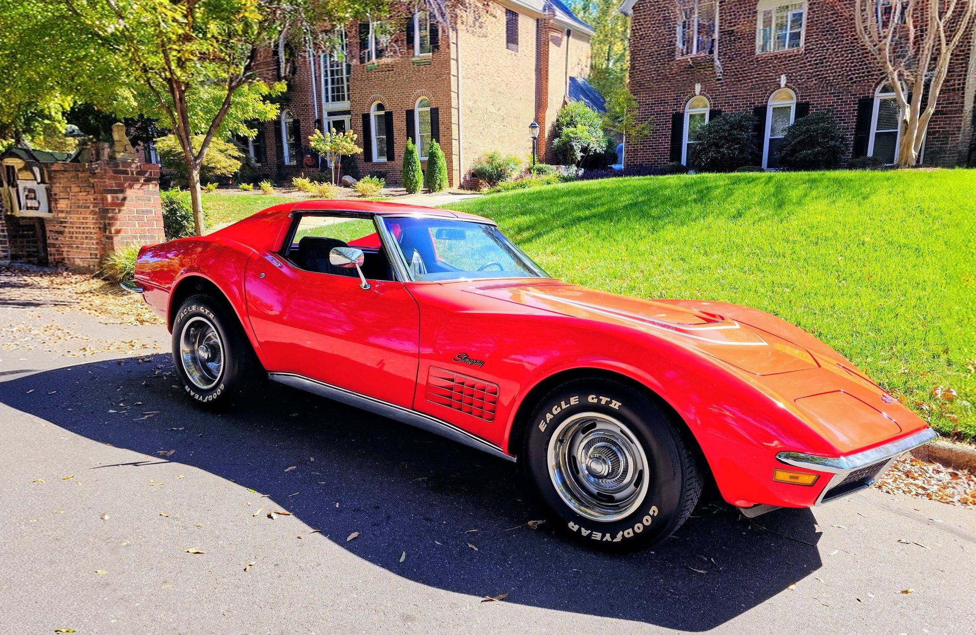

I recently now have a 1970 coupe (added to my 1999 coupe). Was my father's and he can no longer operate the clutch. Originally a 350/350 4-Speed with AC... that has been completely remade quite well (not perfectly though) into an LT-1 clone. To me that is OK, I can drive and enjoy a beautiful and amazing running machine without worrying about keeping it perfect. In the era of resto-mods, think of it a resto-mod using period only parts.

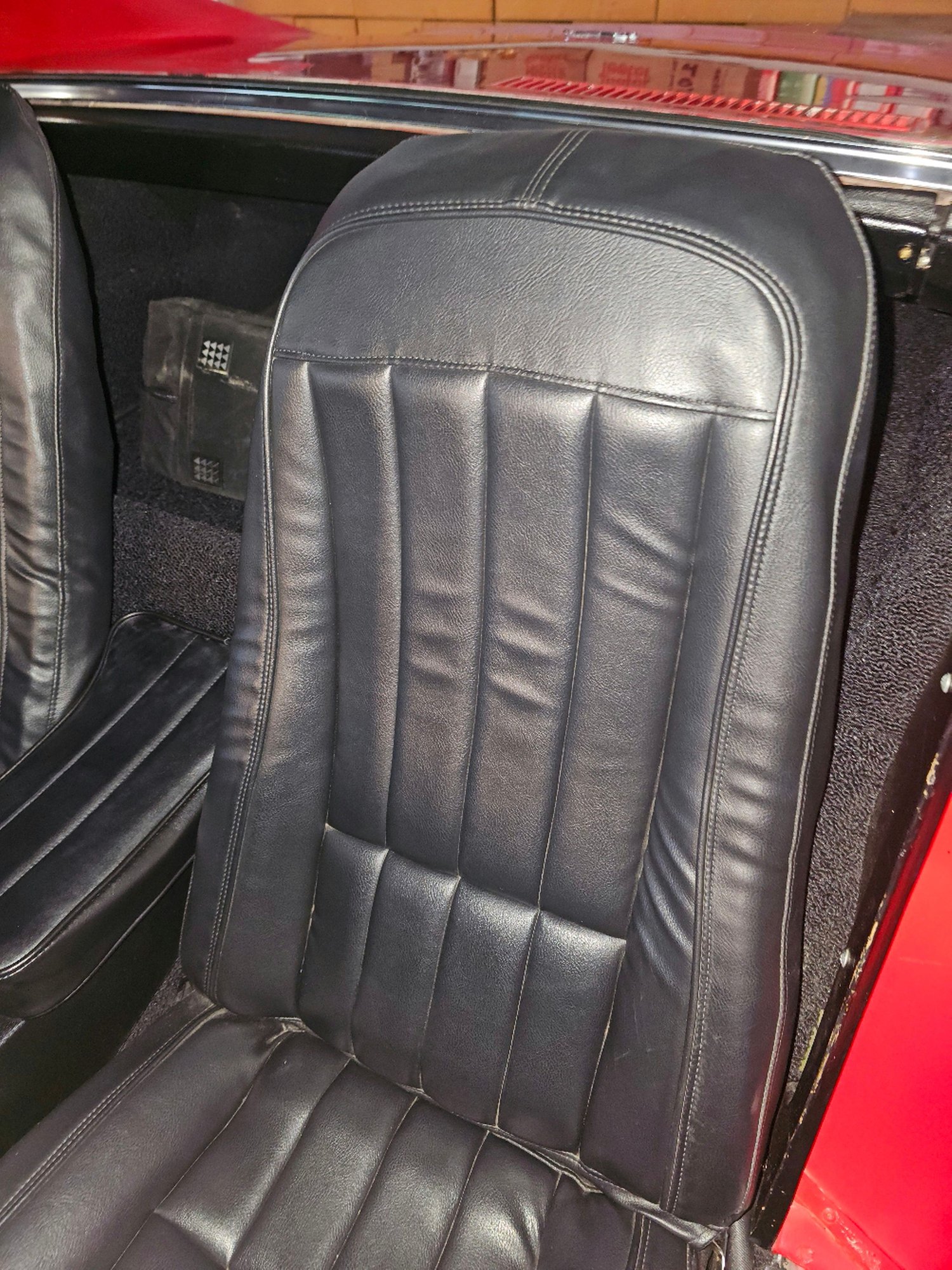

One, are the seat covers.... seems like a cover was used without the shoulder harness pass through. There are no shoulder harnesses in the car. Was this at all a Chevrolet configuration or simply a selection of the previous modifier?

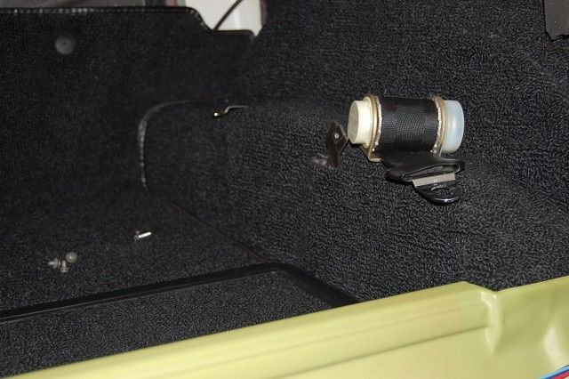

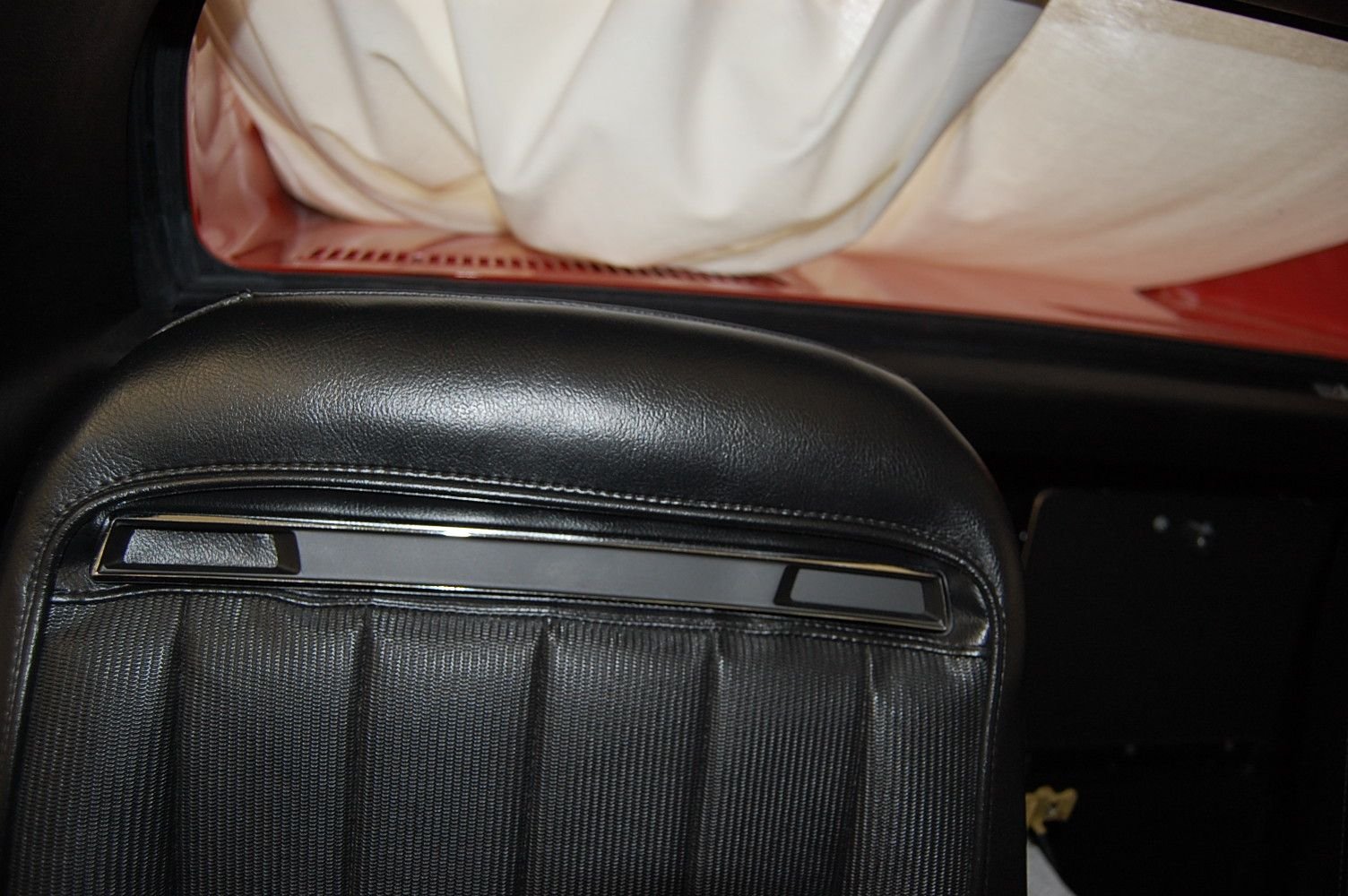

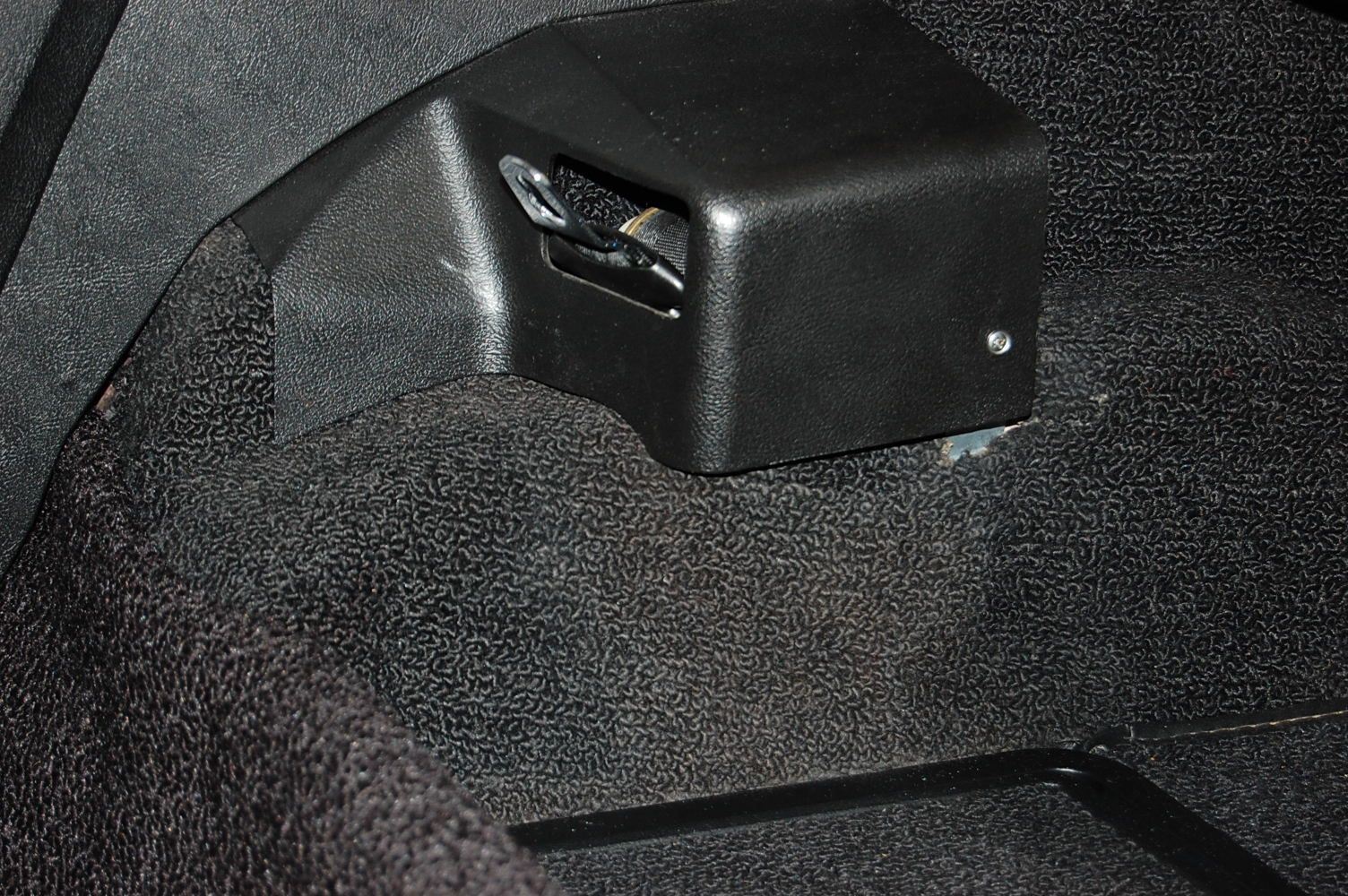

Here are photos of the shoulder belt retractor, the plastic cover for the retractor, and the trim on the top of the seat that the belt passes through.

The vinyl is not yet cut for the belt to pass through.
Seat vinyl not yet cut.

All C3 coupes had shoulder belts as standard equipment starting in '68 -- they were optional on convertibles (that makes sense, right?) until they were discontinued for '76. It looks like the last person to recover the seats did not install the pass-through trim. The front trim piece will tighten the upper part of the cover, but in order to install them, you'll need to access the frame from the back.

On the seat covers, I have thought the same as you about just the missing trim. But I was unsure about the seam in the headrest area. "Correct" cars have no seam in the center of the headrest area; mine has a vertical seam. Is this just a nuance of the cover used or could there be different seat backs in the car? I don't want to go cutting covers if the frames are incorrect.

I believe the 'levers' that you're seeing are the mounting tabs for the shoulder harness covers. I've circled the driver's side in the photo below. In my photo the bracket appears to be in-line with the back edge of the storage compartment openings, similar to where it appears in your photo. I'm guessing here, but perhaps someone put some sort of black plastic piece on it to make it look less ugly. And if I recall correctly, the bracket, attached with a rivet, would pivot back and forth in a small, short arc, seeming like it may be a lever.

Thank you. Everyone seems to agree the levers ar part of the shoulder harness trim mount.

The center seam is right for '70+ and your center vertical panels match '70-'71.
