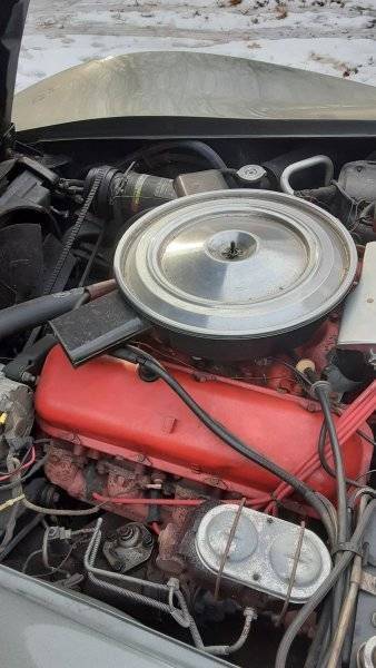

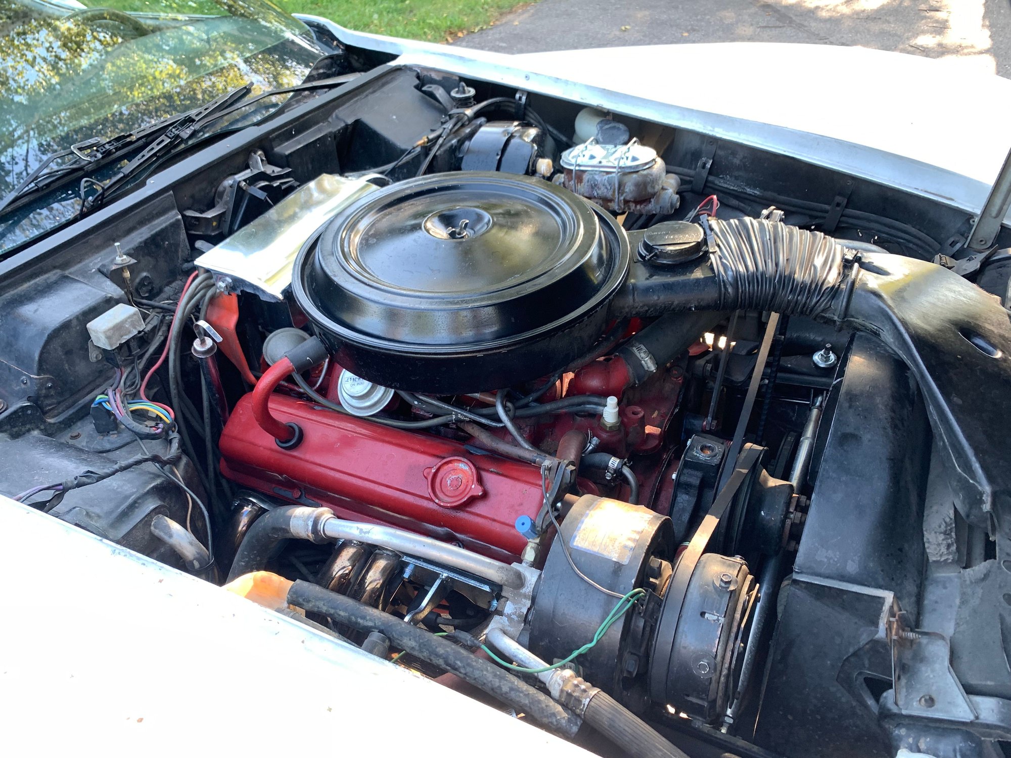

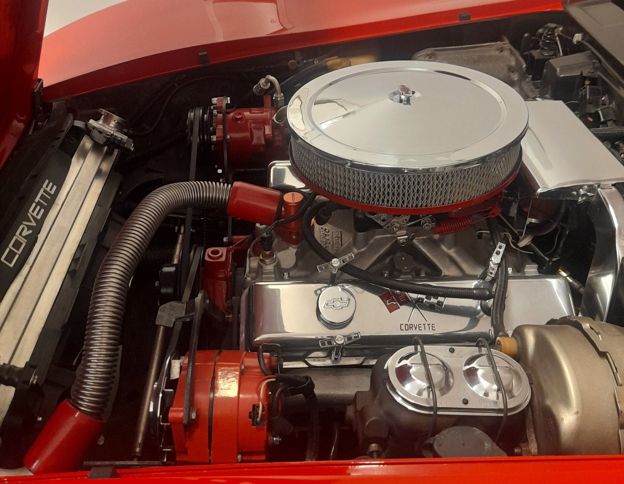

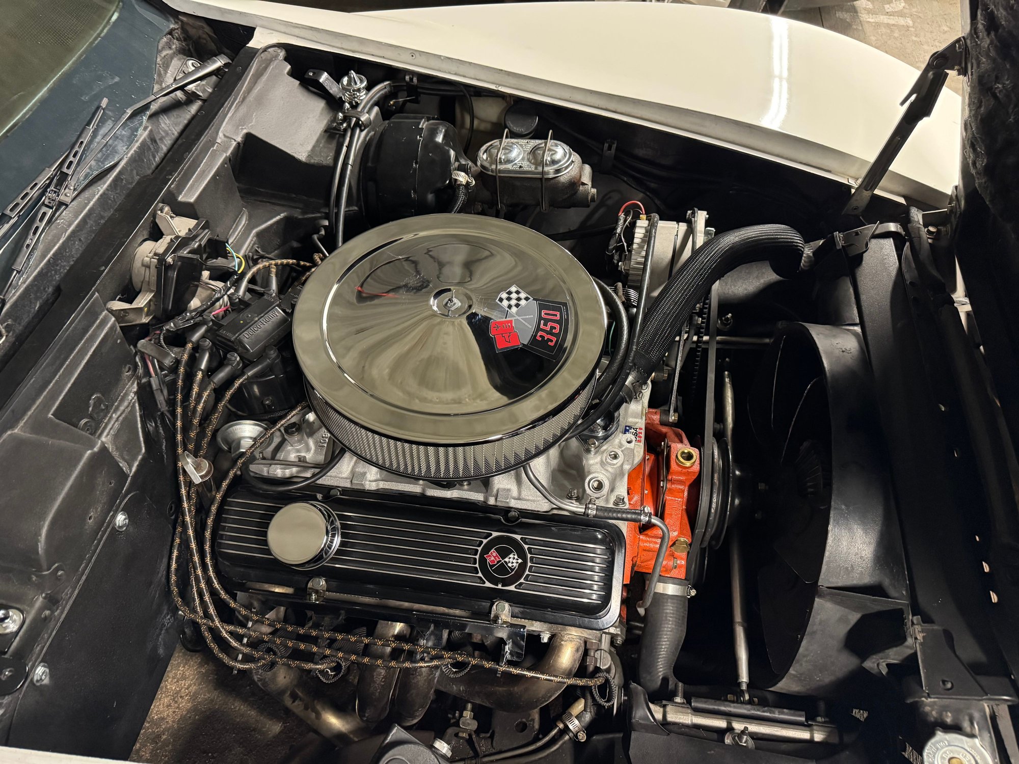

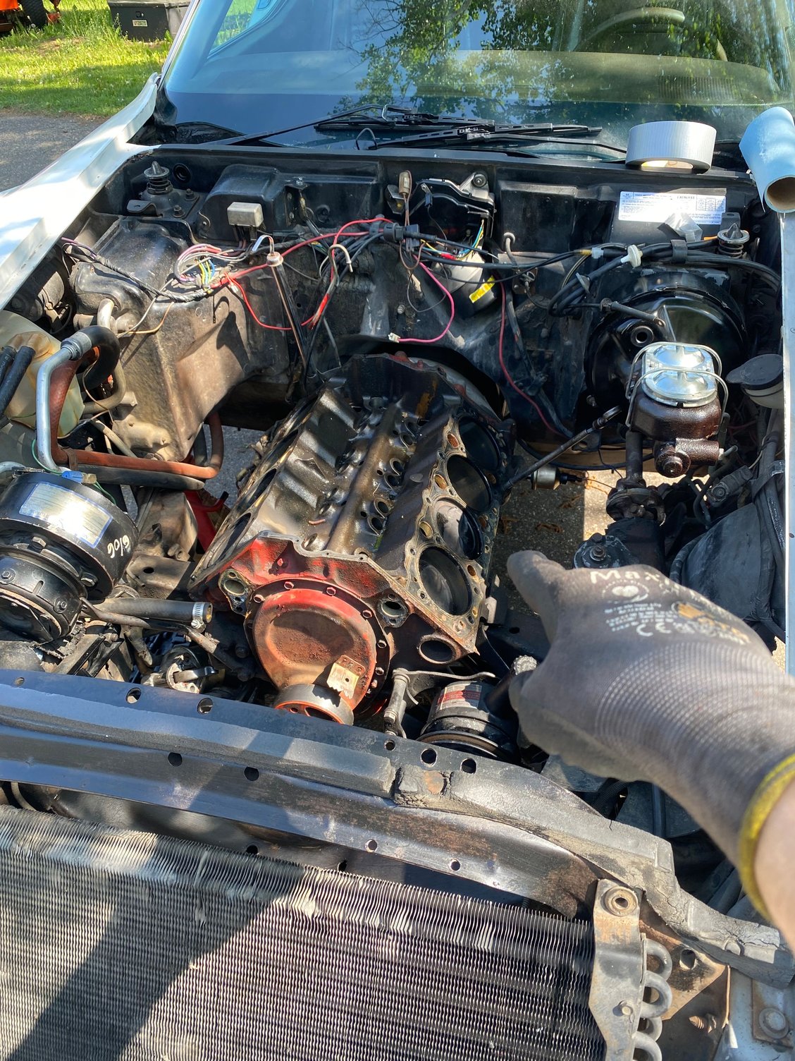

My car is an L48, and I’ve gone down the path of the heads, cam, and intake swap, but if I were to do it again I would definitely spring for the L82. Not only does it have the 4 bolt mains, it has a forged rotating assembly and higher compression pistons. Meaning that any modifications you make to the top end will make it better than a modified L48, and even the high horsepower hydraulic lifter small blocks in the earlier C3s!
Before, during, and after my engine modifications.

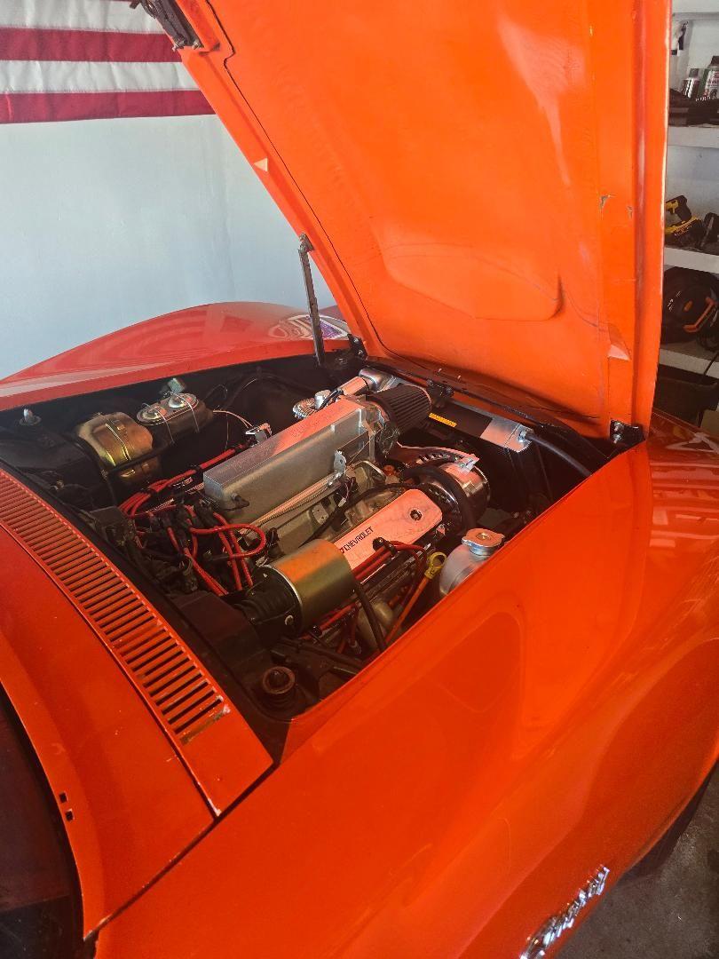

For me I am a resto mod guy so I am all about EFI , I feel it just makes the cars so much driver friendly and I like the look. But that's just me and I hope you find what you're looking for
