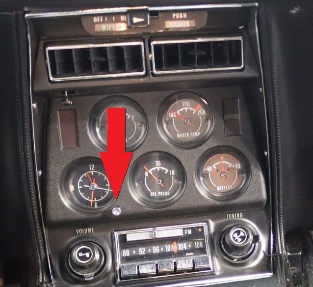

this is one stubborn **** to remove. Any tips on how to remove the clock adj **** is appreciated.
Is it threaded or pressed on? I dont see a set screw.

There should be a screw that you can back out and pull the **** off. Use a magnetized screwdriver like for glasses.

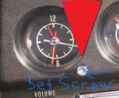

The set screw is right in the middle.

thank you. my eyeballs missed that

Hello,
The screw is very tiny.
It uses a TINY flat head screw driver.
There are 3 parts:
The screw
The knurled ****
The tiny black sleeve that's held in the hole in the bezel.
