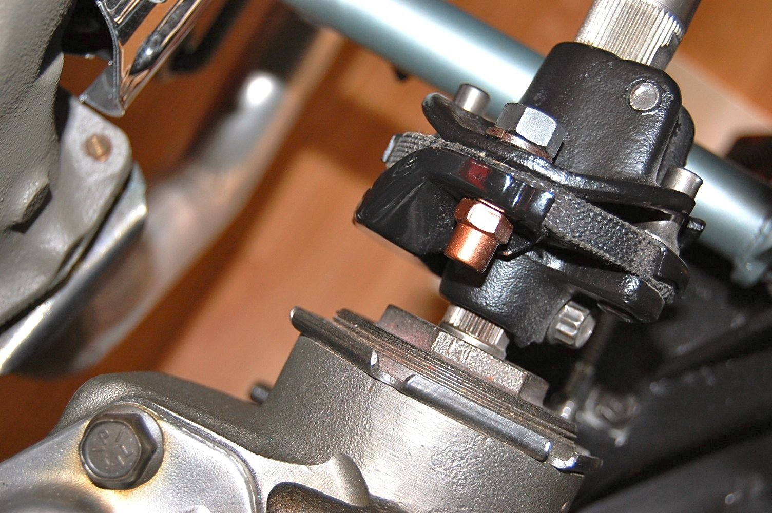

My intention is to have my OE rag joint rebuilt and would like to know if I will need to have the Vette aligned???

I don't think the installing the rebuilt coupler can affect the front alignment.
You DO have to make sure the steering wheel is in the center position when the coupler bolts are tightened .
