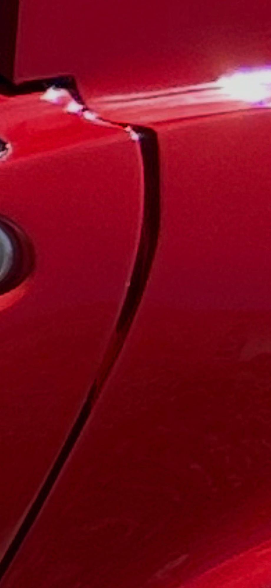

I have a '68 and the top of the driver side door has a gap that I can fit my finger in to. I originally thought that it was misaligned but I went and realigned it. I also replaced the brass insets at the hinges thinking it may have been those. The passenger side fits fine. I started to think that maybe somewhere in the last 60 years someone may have swapped out a door from a different car. Would a door from a later car fit the same on a '68 or could that ne the issue?

A later door wouldn't have the '68 button. My gap is on the right side. Everything is original & I bought it new. The door has always shut just fine...

Ok, good to know, that looks very similar to mine.

I must be the only one wondering what the light colored area is at the top of the door --- or else I'm the only dense one who doesn't understand what I'm looking at. Is the fiberglass frayed or something? Protective tape while adjusting?
Post a photo from the side showing the entire door and window in the opening.

I think that it is light glare when the photo was taken. Lou.
