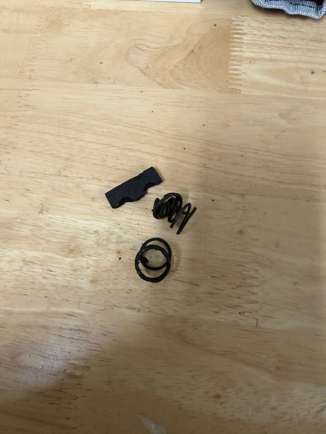

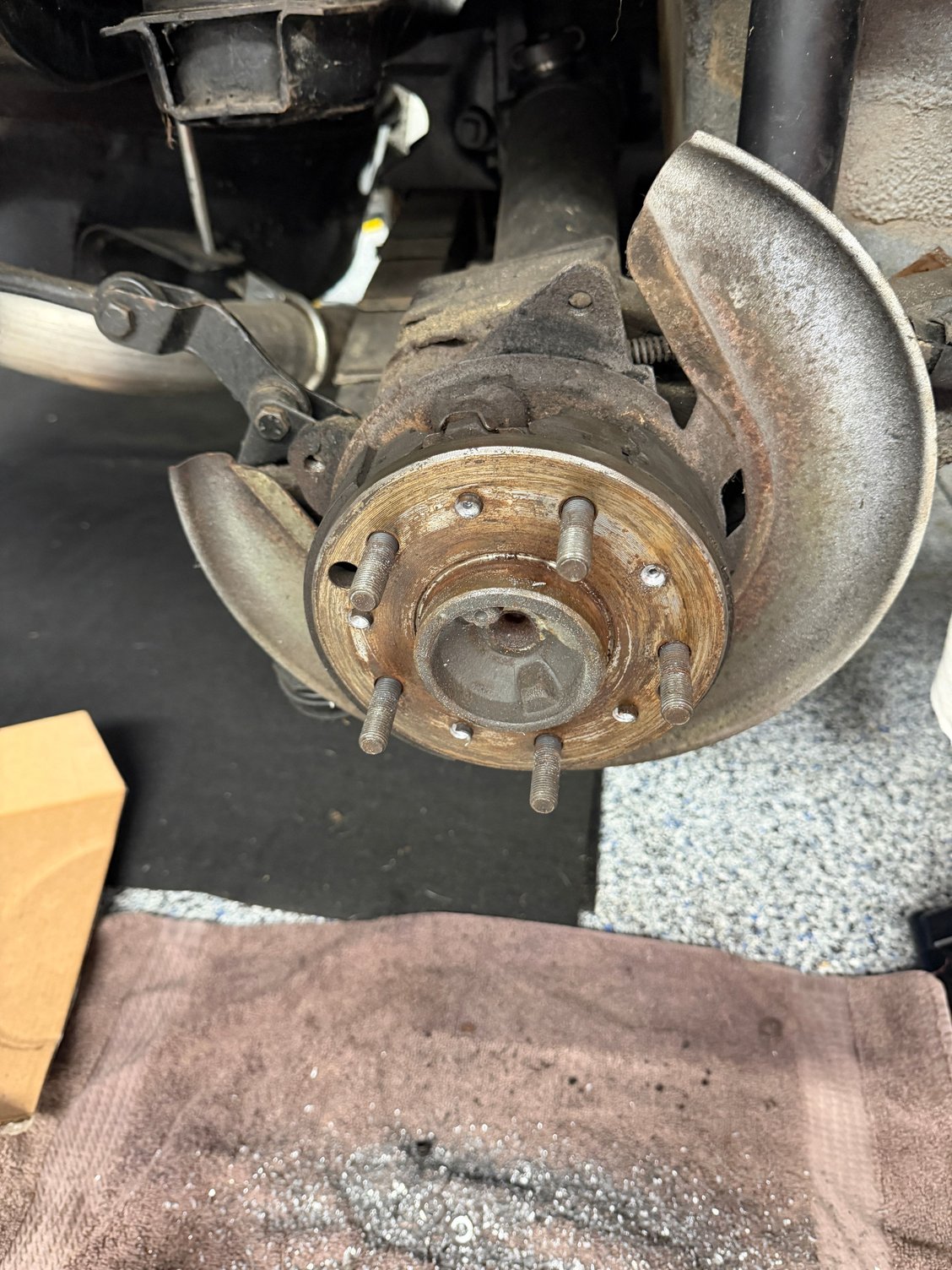

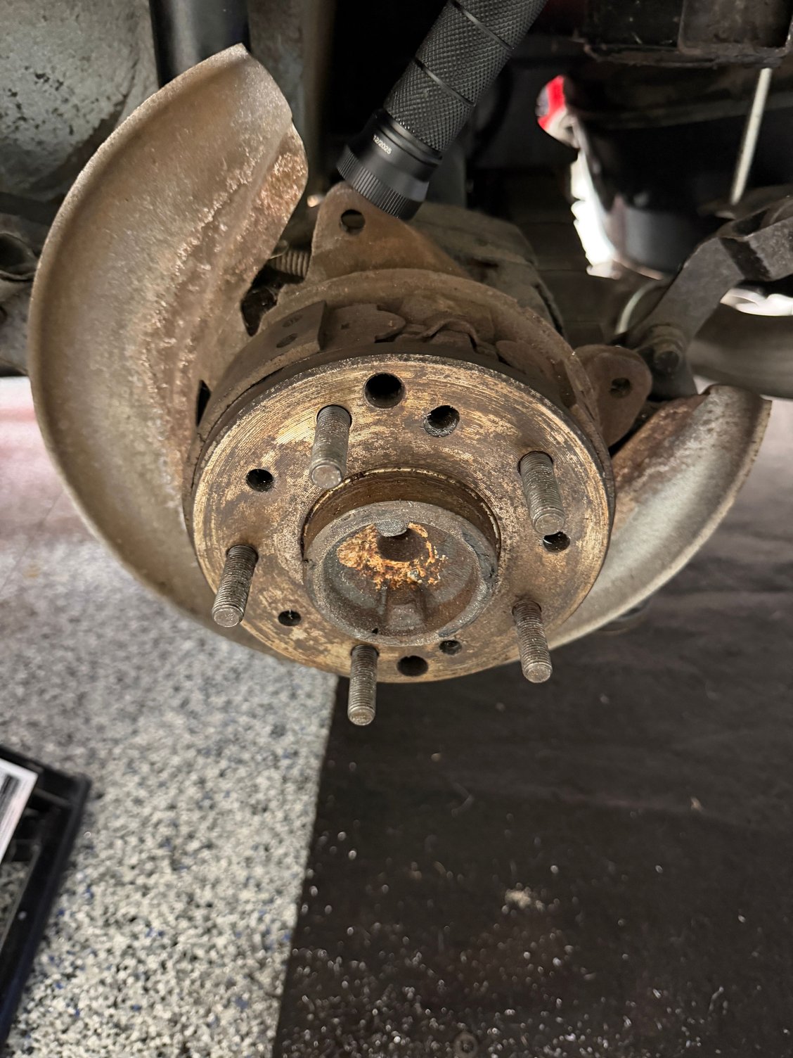

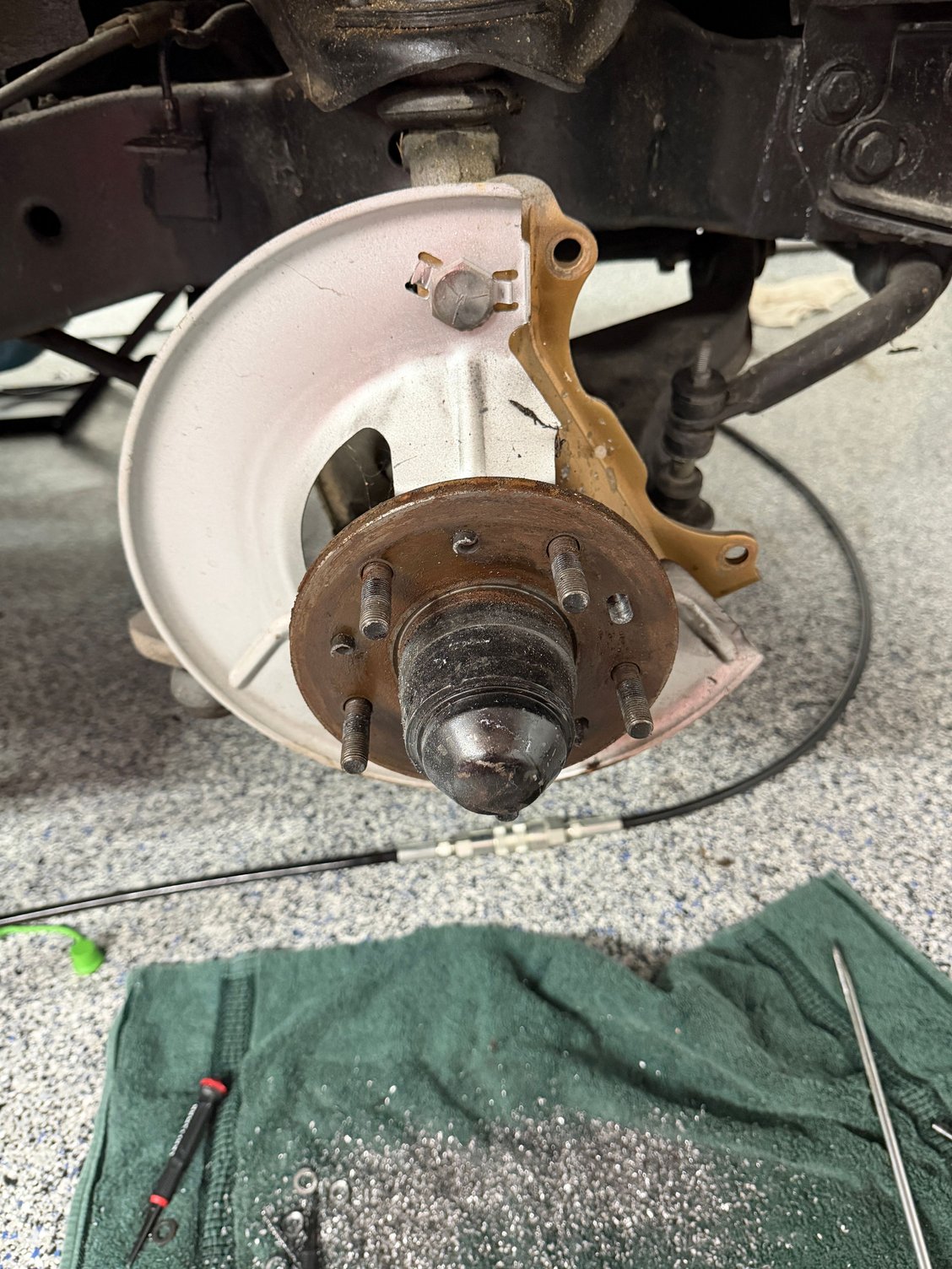

Finally, got three rotors off (will finish the last one tomorrow evening). The difference was using an 11/32 bit. Guess I should rebuild the parking brake as it looks like one of the springs broke and fell out. Shown below. Also, looks like the front right dust shield was replaced as it looks too clean. But then again, I have been wrong about my assumptions on this car.
Doesn't look like it should be loose.
Shield too clean.
Shield too clean.
Right Rear
Right Rear
Left Rear
Left Rear
