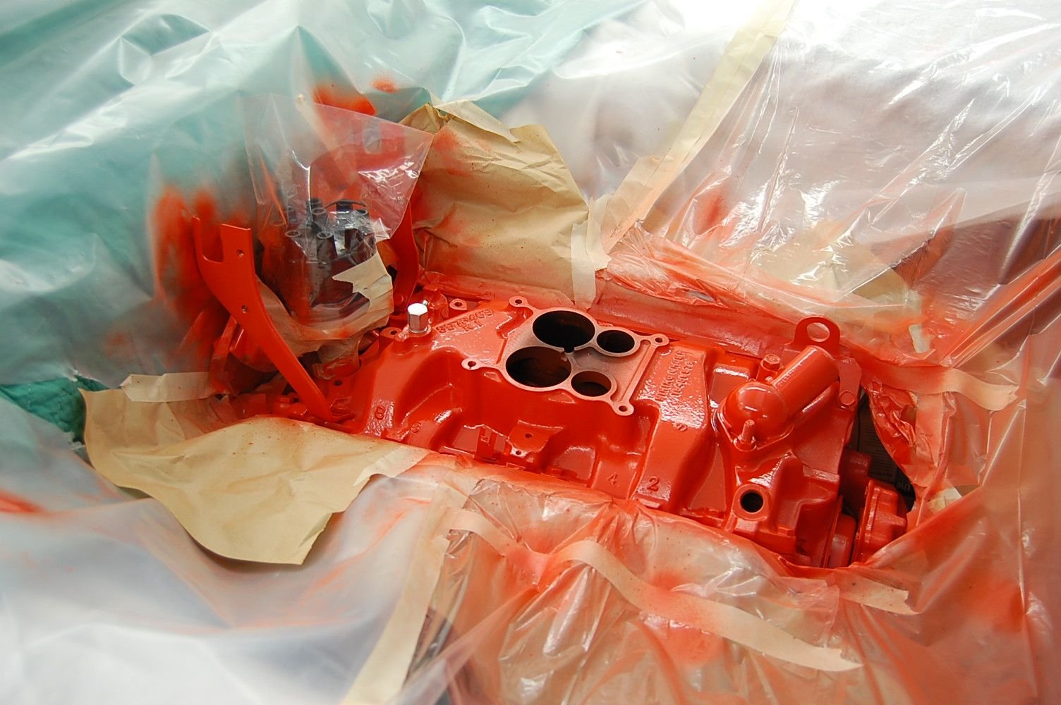

Hello,
Using a combo of spray and brush.
Regards.....

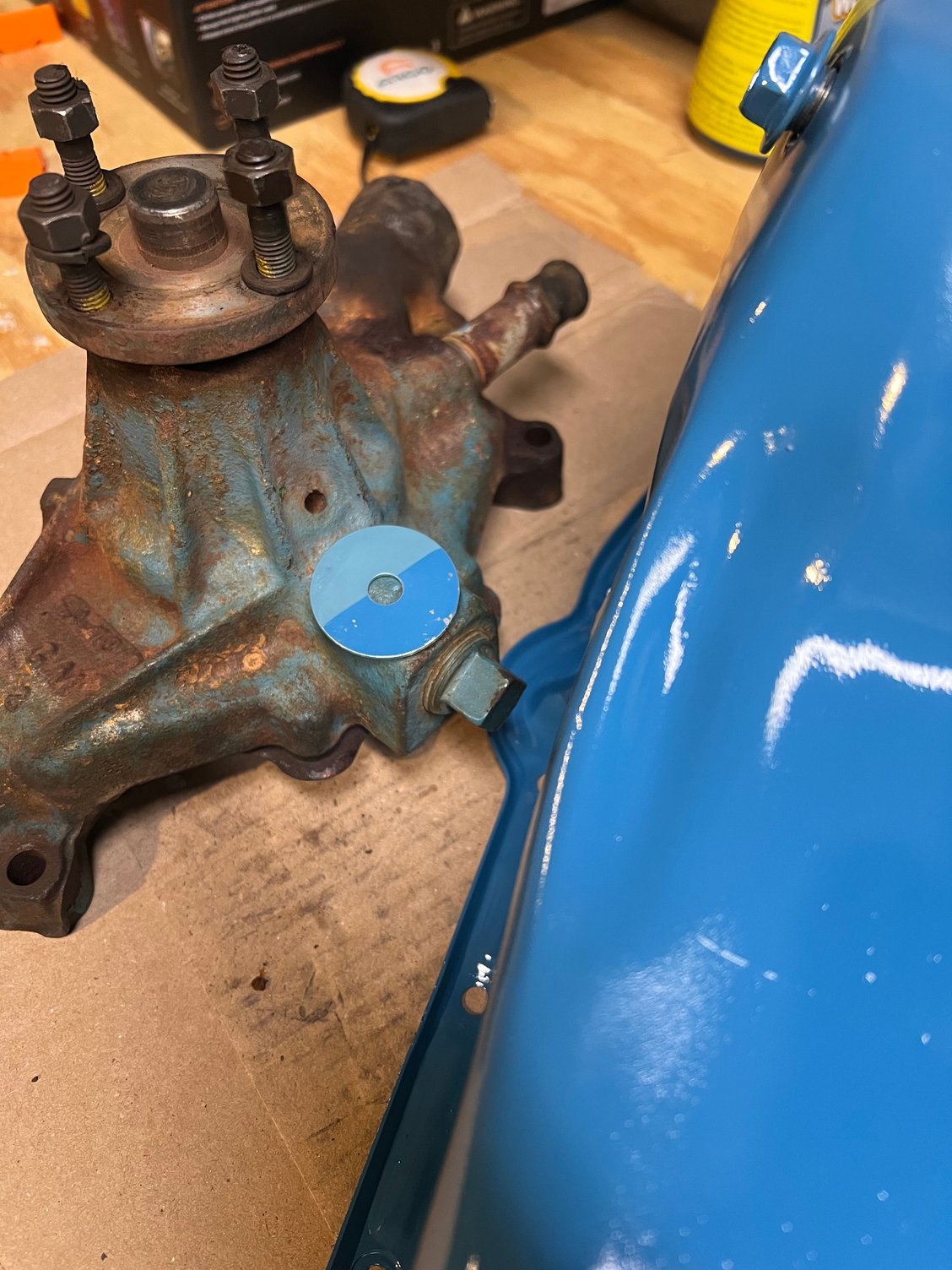

So this has been a curious situation. I think I've come to the conclusion that my oil pan was painted a different shade of blue than the engine and other components. When I got my spray can of Duplicolor General Motors Blue 1608, I did a test and it matched perfectly to the oil pan which I had by itself in my basement at the time. I just assumed that the oil pan blue was the same as the blue on everything else in my '78. When I got the pint of KBS 60339 GM Corporate Blue, it was more of a gray but matched the engine and everything else. Strange. This car is a 28,000 mile survivor that's been virtually untouched over the years, so I'm 99.999% sure that the oil pan was original to the car.
The left side of the washer shows the KBS GM Corporate Blue 60339 and right is the Duplicolor 1608 General Motors Blue.

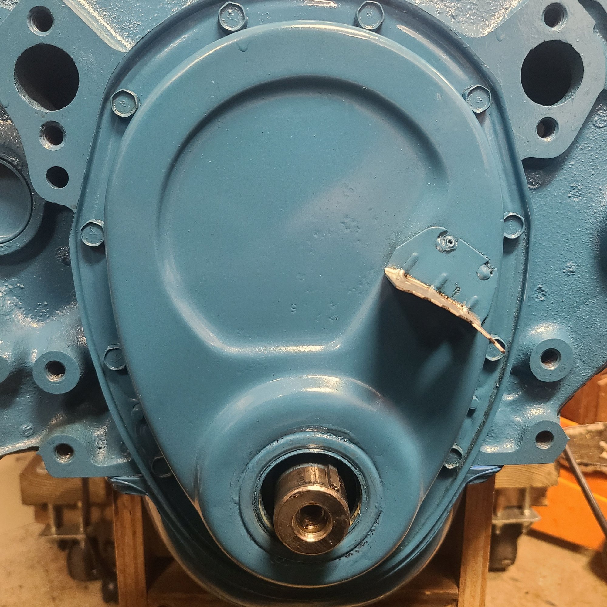

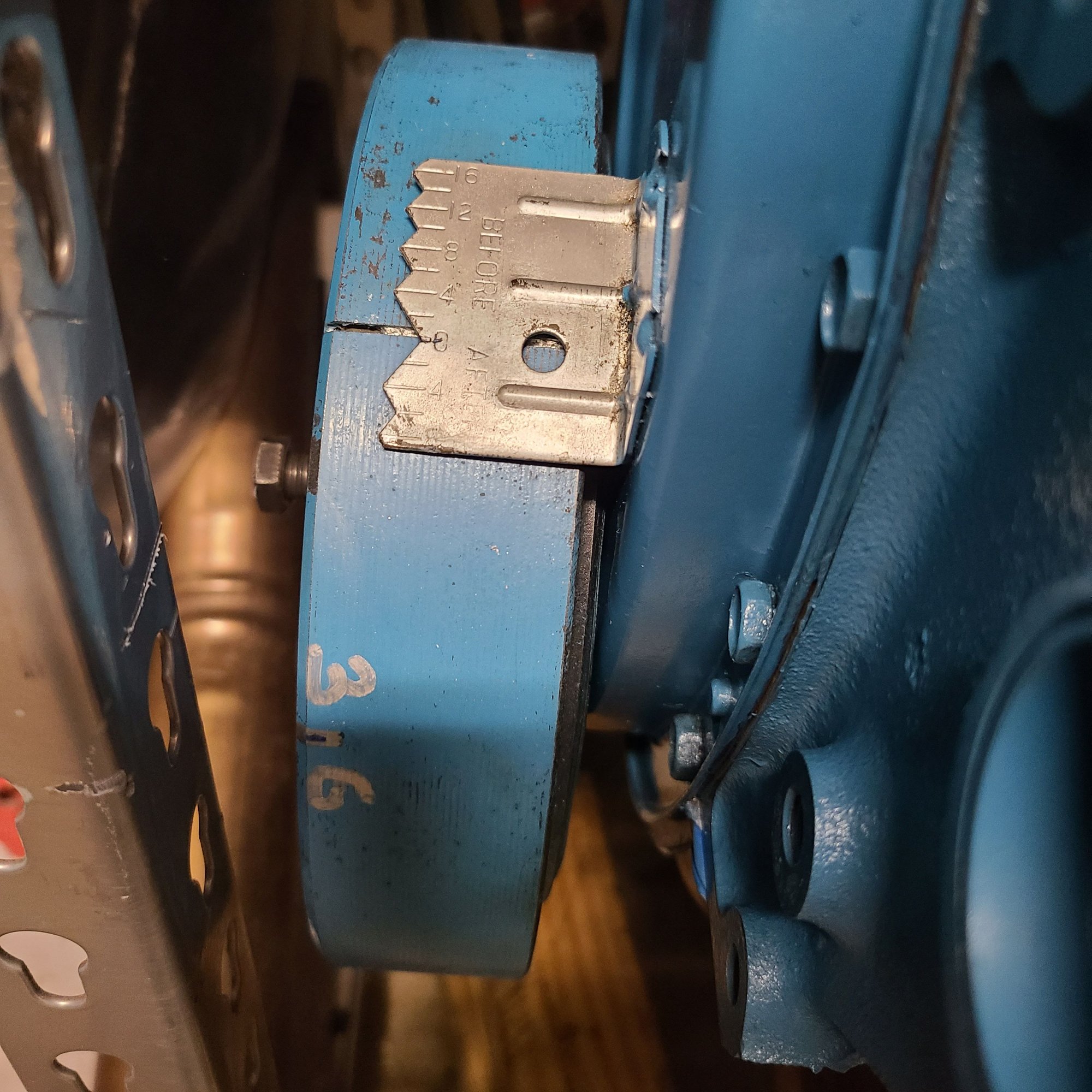

On my screen, the lighter blue looks right to me. JMO.
The darker blue looks too saturated to me. YRMV

Agree 100%

Is this your engine? What brand did you use? I’d love to find that blue in a spray can.

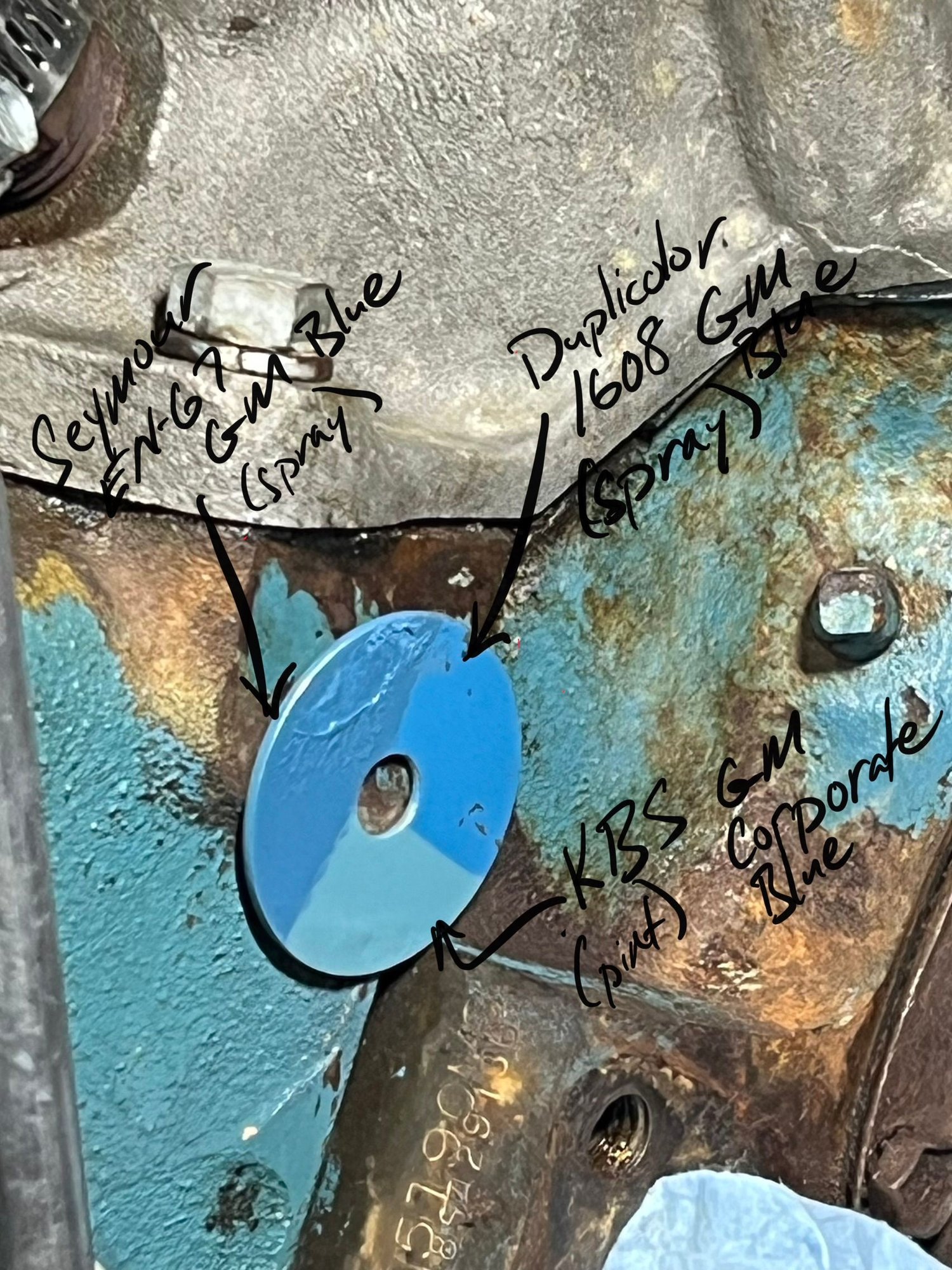

Things are getting a bit silly now.
I ordered up a spray can of the Seymour GM Blue (en-67) hoping it would match the KBS, but it did not. I called KBS today and they said they do not make GM Corporate Blue 60339 in a spray can. Maybe the Duplicolor 1609 Chevrolet Blue is what I want, but I suspect that is the blue from the ‘50s (the blue flame C1 engine).

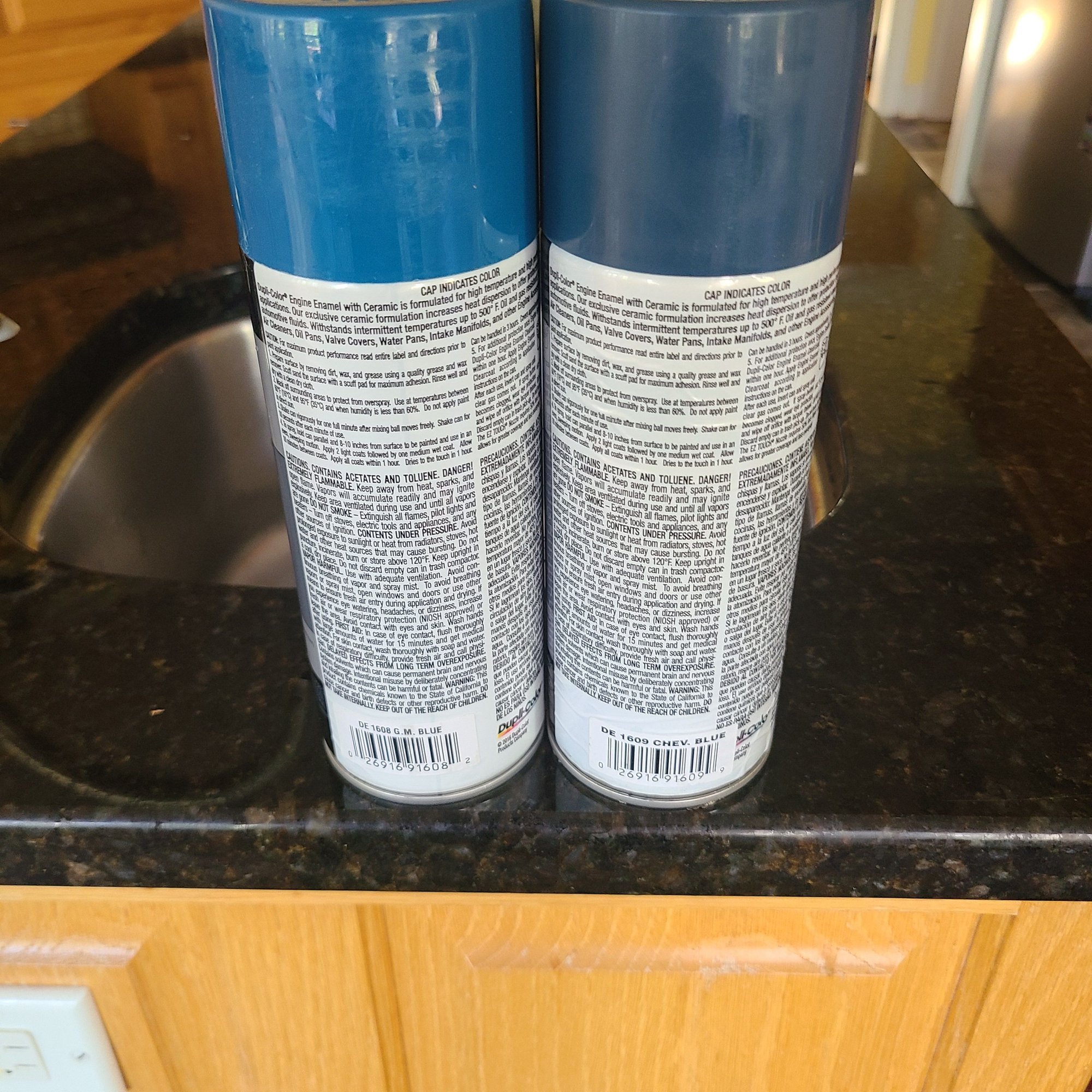

The Duplicilor
The Duplicilor "Corporate Blue" DE1608 for C3's from the late '70's can on the left is what I used. The "Chevy Blue" DE1609 on the right was not good. Its an older color that was way off. Blue Flame is what comes to mind for me as well.

Thanks! That helps a lot. I won’t bother with trying 1609. If you used 1608 on your engine in the photos, then I wonder if they changed formulations or something. The 1608 I used just doesn’t look right. The KBS is a near exact match.
