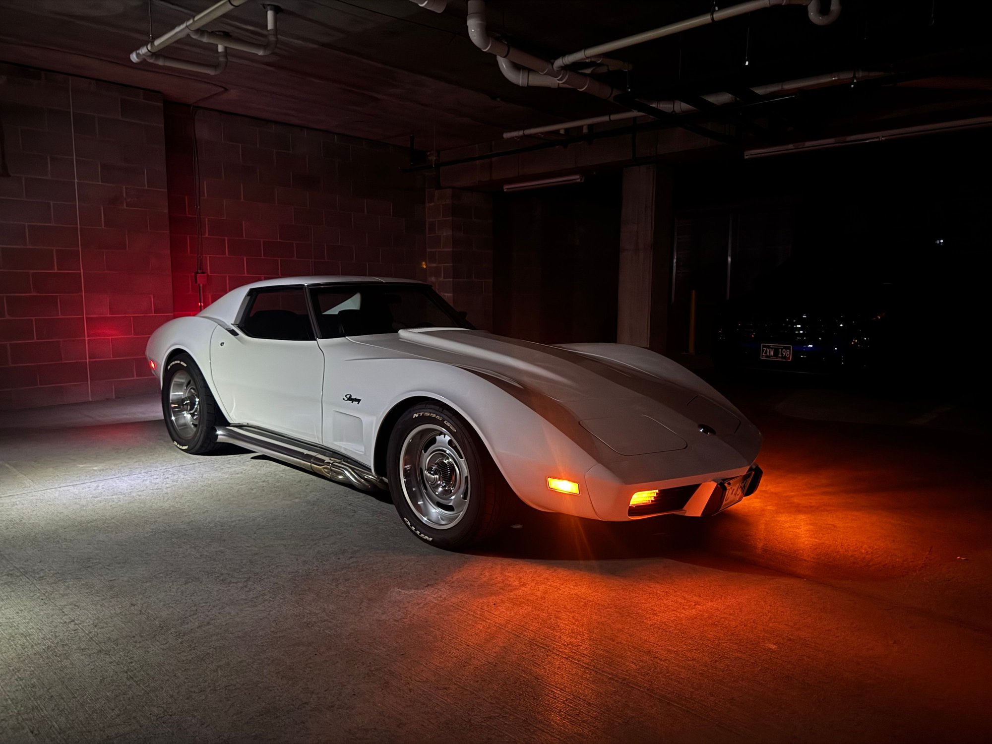

I spent about 2k on my Doug’s SS side pipes and headers. Expensive yes, but will never rust. I would do a lot of research into the baffles/mufflers you want to put in them, as some can be very restrictive.

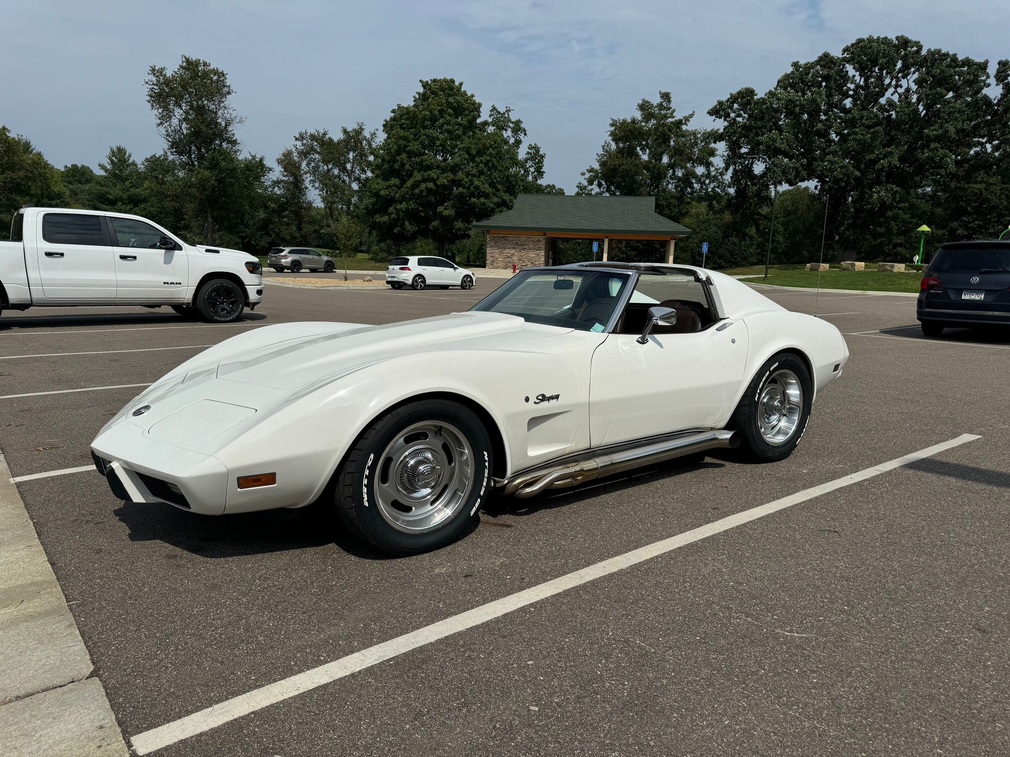

Beautiful! Are those stock wheels, they look bigger. Or is it the lowered suspension?
Old Apr 14, 2026 | 08:01 PM
Piersonpie's Avatar
Piersonpie
Joined: Apr 2021
Posts: 2,711
Likes: 2,160
From: Minnesota
Bit of both

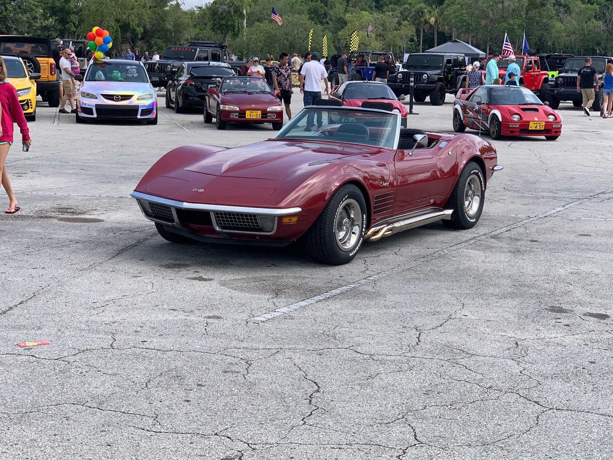

Definitely spend the extra money to get stainless side pipes. Coated and painted will always end up rusting. My stainless Hookers have been on the car now for over 15 years.
