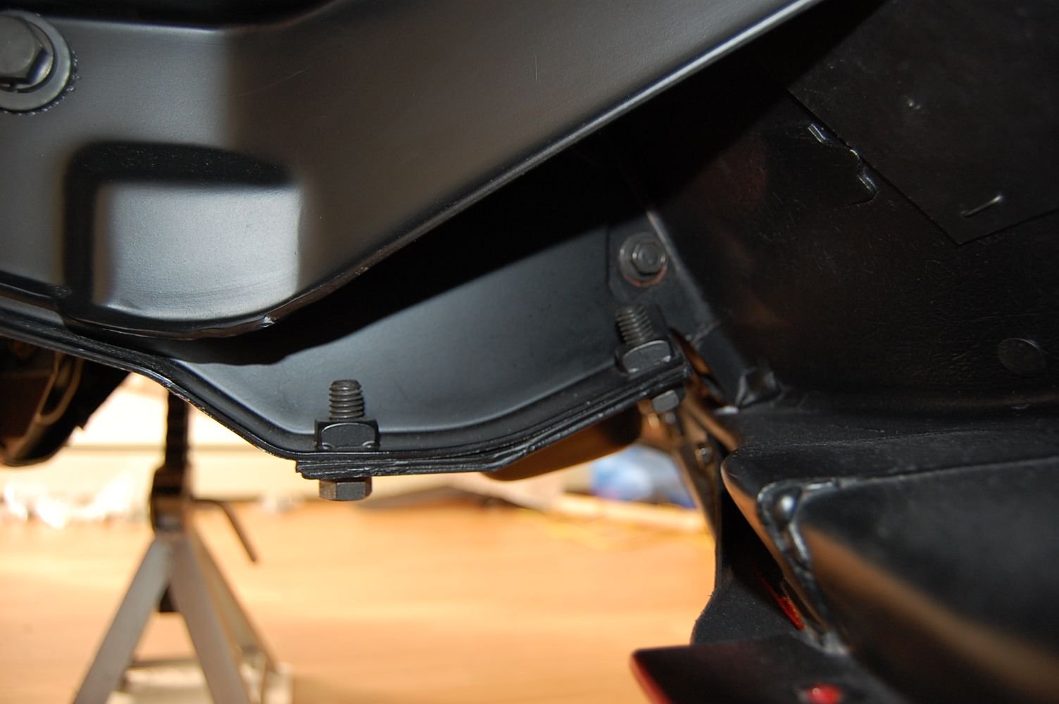

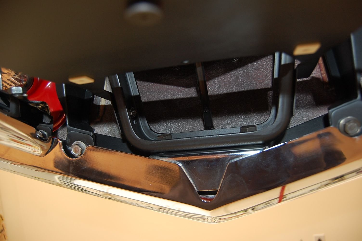

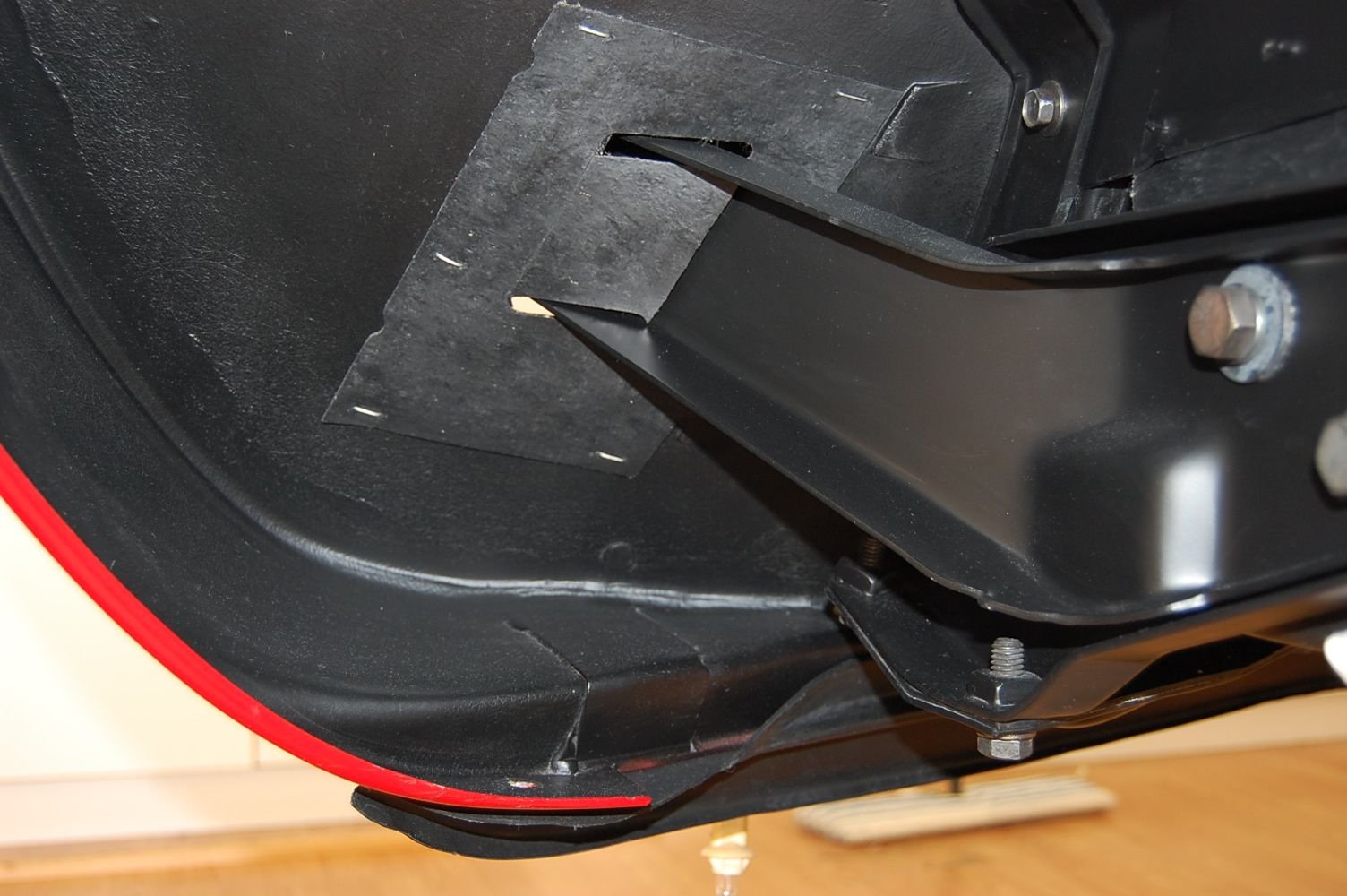

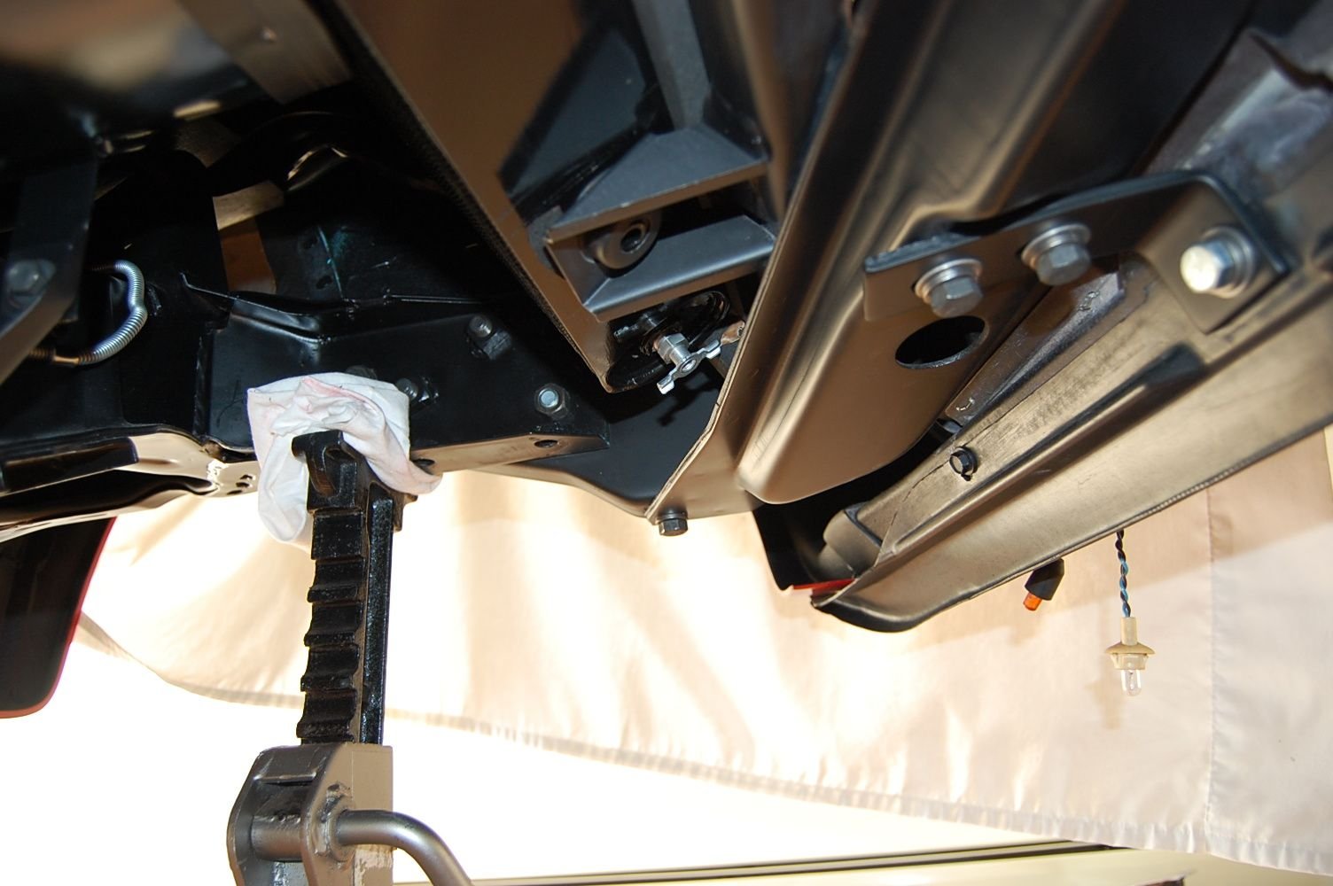

Here are some photos. Might help?
71 car.
Drivers-side.
