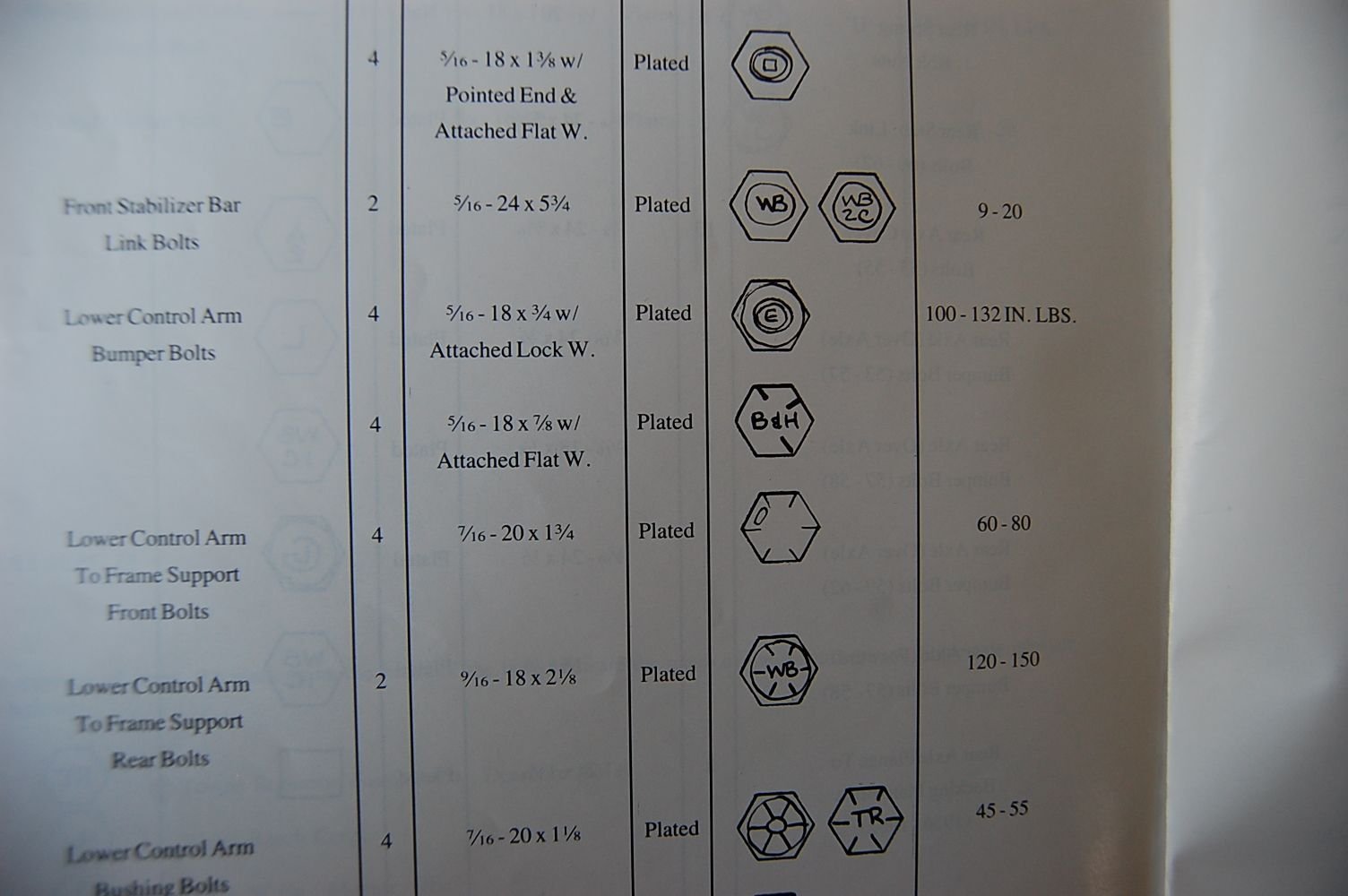

This is a fastener resource for 68-72 cars.
It will be of some help for your later car.
Regards....

The now defunct Paragon Corvette used to do a fantastic wall chart showing most major Corvette fasteners, with photos of each head mark, the size(s) and application(s). These are invaluable if you can find one. Paragon's catalogs also had the fastener chart spread over a few pages in the back of the catalogs. One of their old catalogs might be easier to find than an old wall chart.

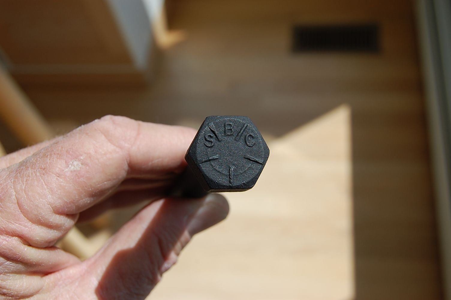

Here's an example.....
Note the tapered shank. The part of the bolt that passes through the rubber busing is unthreaded to protect the bushing.
Note short threaded portion.
Note grading slashes and finish.
There is no adjustment in this bolt. The slotted nut can be torqued tight so the cotter pin can be installed. This insured consistent / constant ride heights for the rear suspension.
