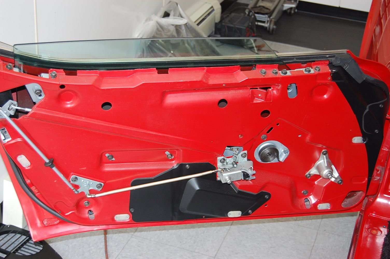

Can I assume these rods should not be bent like this?
While I was in there, I removed the latch mechanism to clean the crud off of them and lubricate them.

The rods are typically straight.
Regards......

I have never seen one bent like that and I just had mine apart

I just ordered replacements for mine. Should be straight. I thought about placing a small section of metal tubing over the rod where the threads screw in, just to add some support. If the long rod is at an angle to the door latch connection, the threaded rod will tend to bend. Try to get the long rod out away from the inside of the door, so it’s in line with the latch. Good luck!

Mine is definitely bent.

Order some of the funny looking rod clips, they will break or walk away. There may be other parts that you need once the new rods are installed. Look in some of the Corvette Vendors Catalogs for detailed illustrations of all the various door latch/lock parts.
