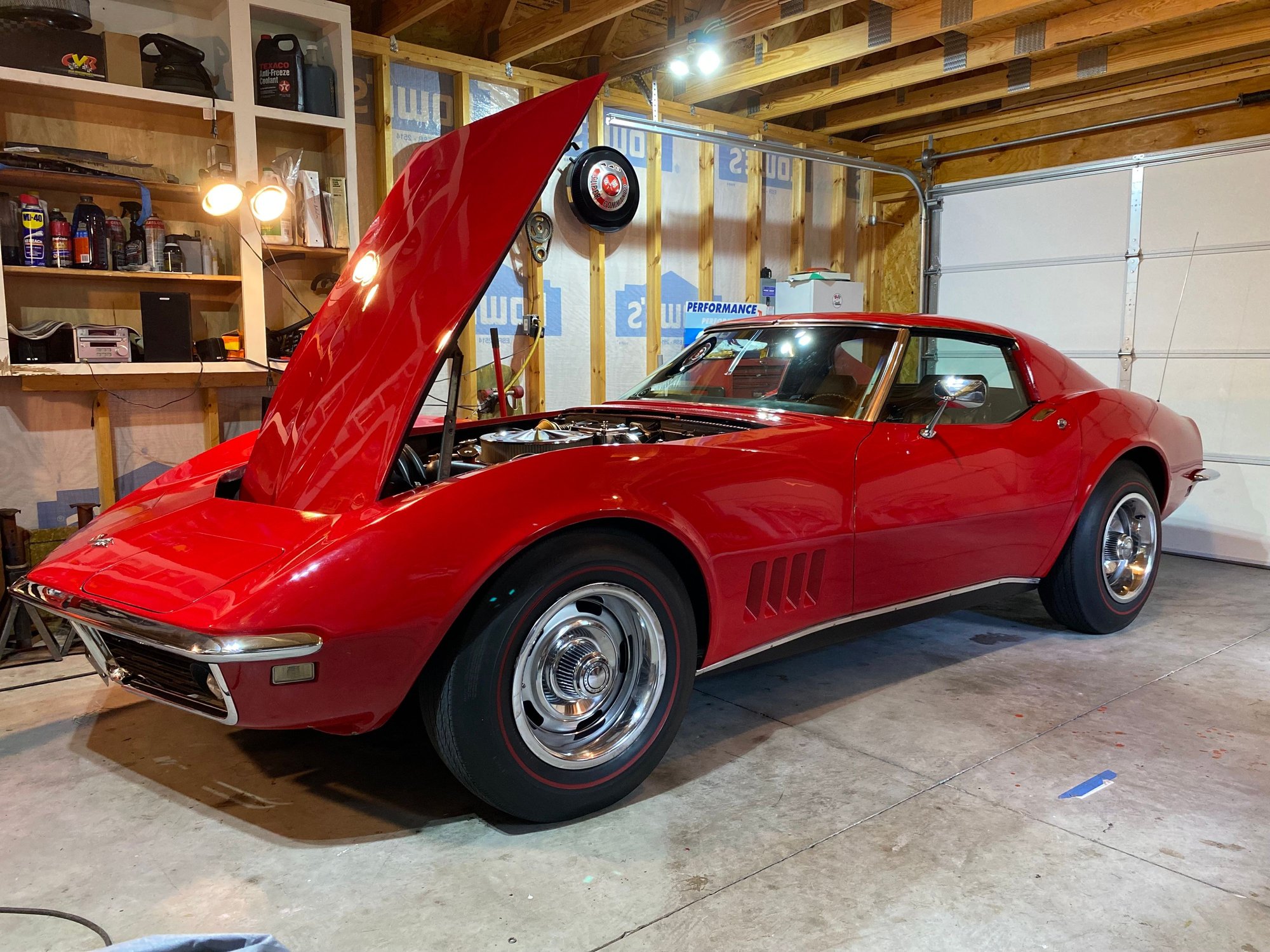

Pros/Cons converting to 8” vs 7” wheels? Going to keep stock trim rings and caps. Using 245/60r15 tires.

7” on the front 8” on the rear.

Chagjr ....Nice looking 68!!!!
