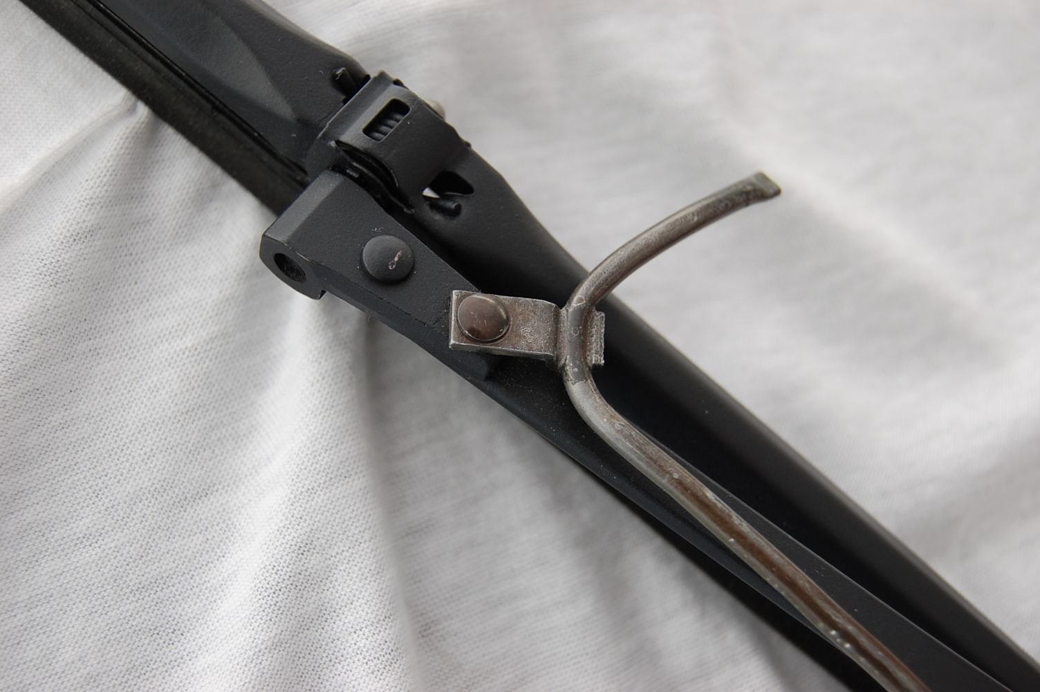

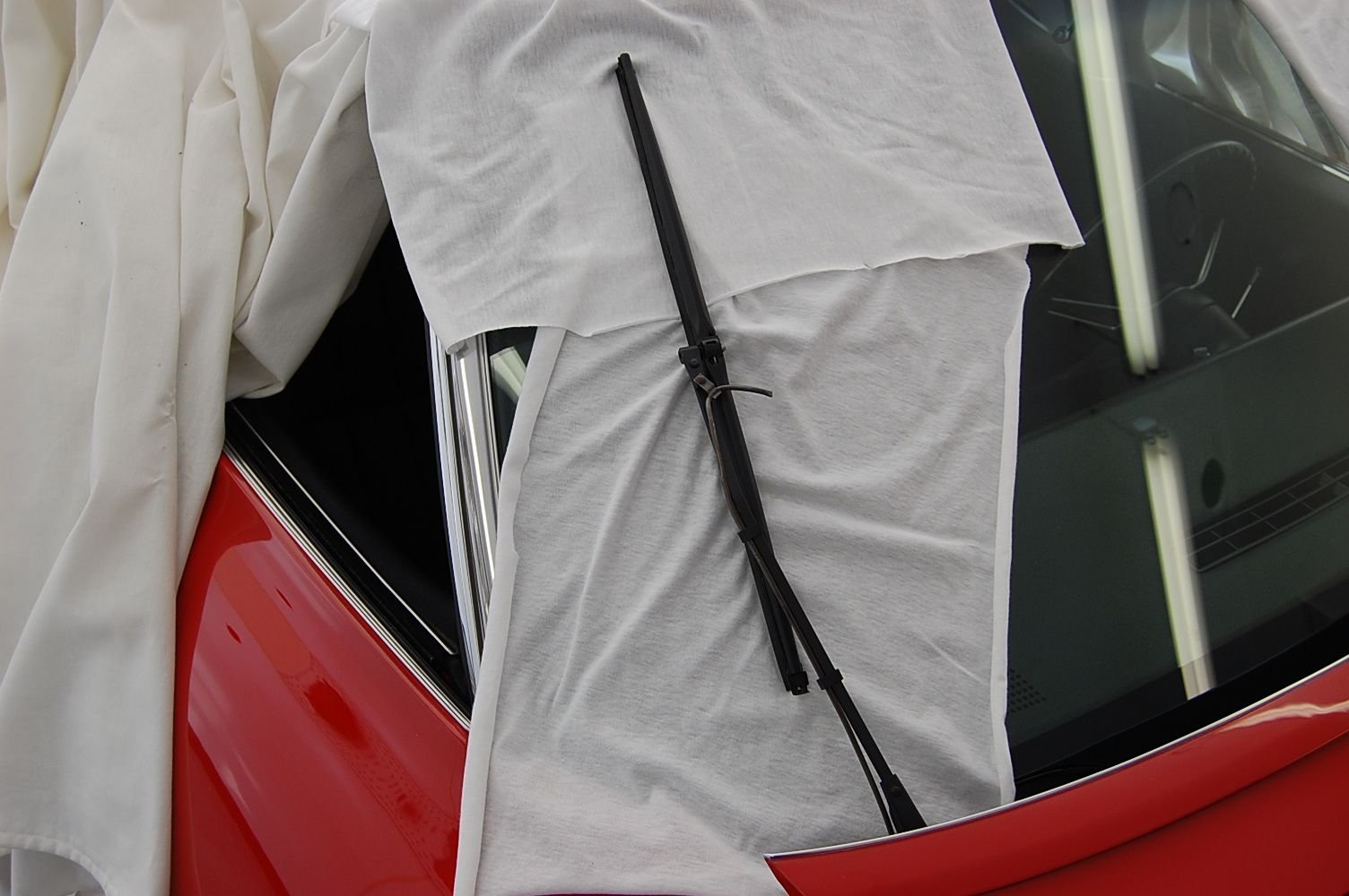

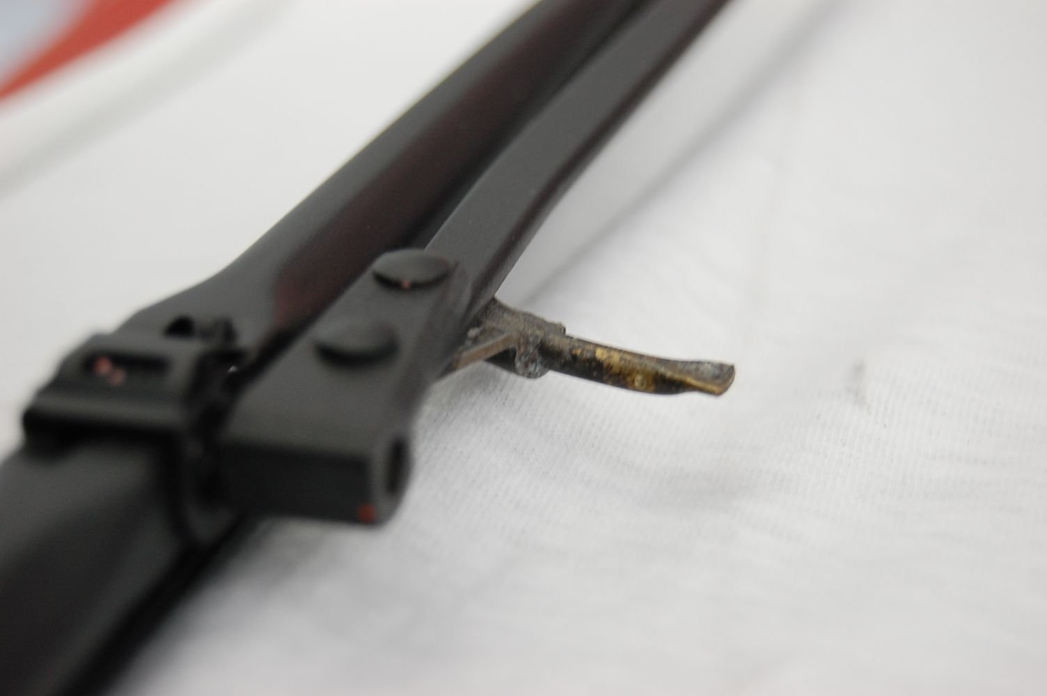

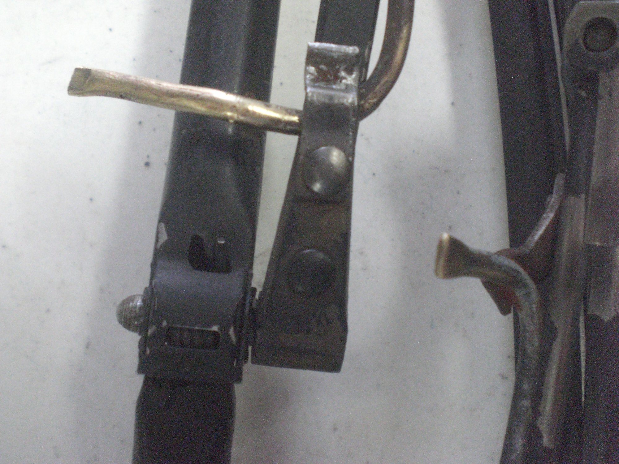

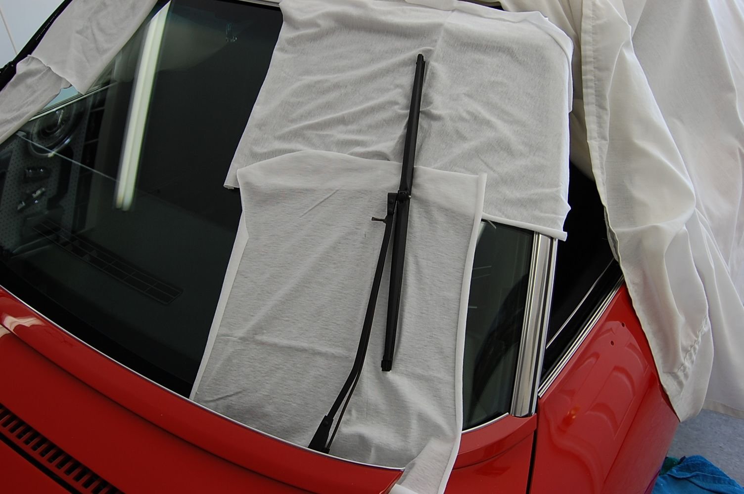

Here are a few photos of 71 'tubes'.
Hopefully they'll help you determine just what you have at this point.
Regards.....

The Paragon drawing appears to show the nozzle tube not soldered to the "cup" on the arm. Both of my tubes are soldered to the wiper arm. The NCRS guide for 68-69 shows them soldered.
I don't know why GM would make a piece and then not solder it together, but they have done other things that make me scratch my head.

Thanks guys that's exactly what I need to know and see. It seems that my tubes are routed normally except that the solder on the right side must have broken loose. The tube was then removed from the hold down tab's cup and then the hold down tab was rotated so that it passes over the tube and holds it in position without being soldered. After reconditioning the arms I'll solder the tube back in the correct position.
Now I just need to track down and order the various missing little plastic clips!

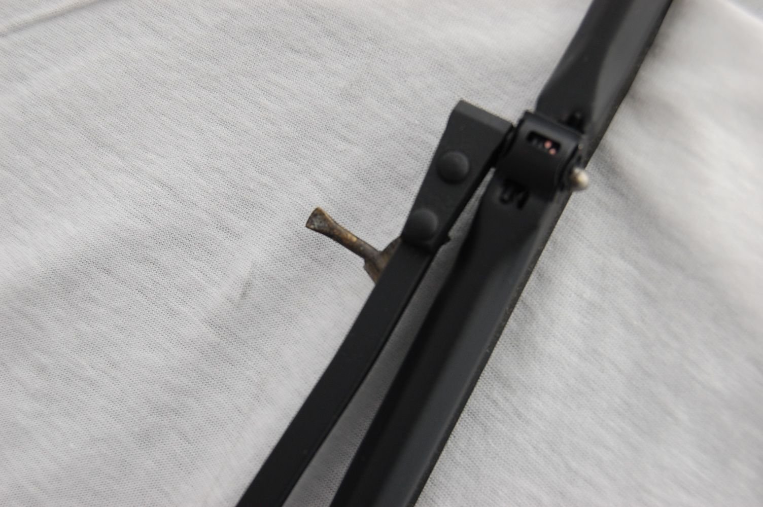

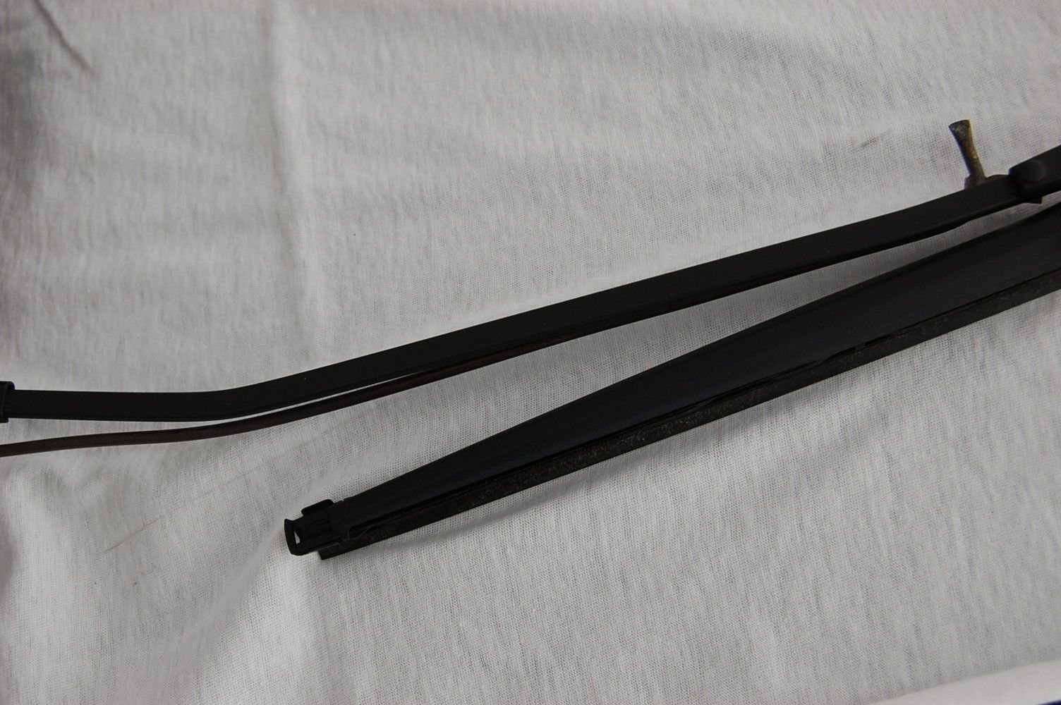

I repaired a set of arms and tubes for someone and both showed a solder connection although one side had broken loose.
Regards....

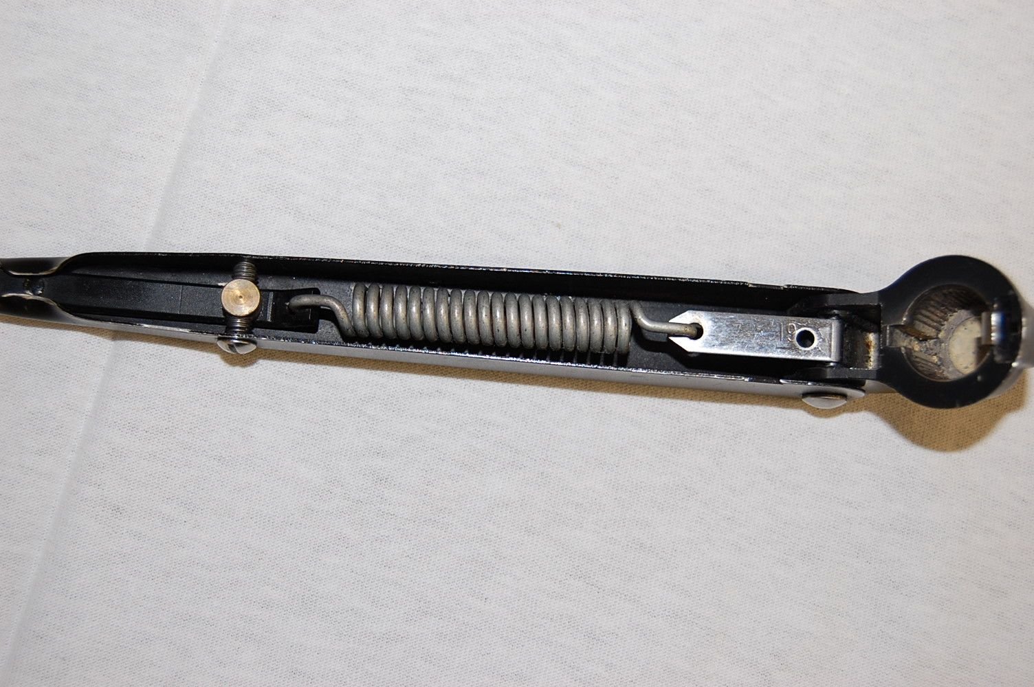

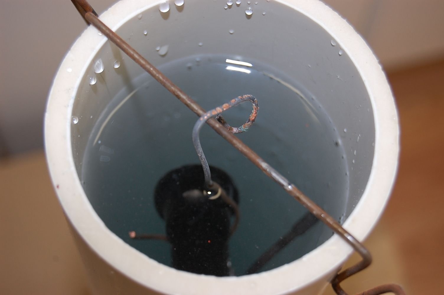

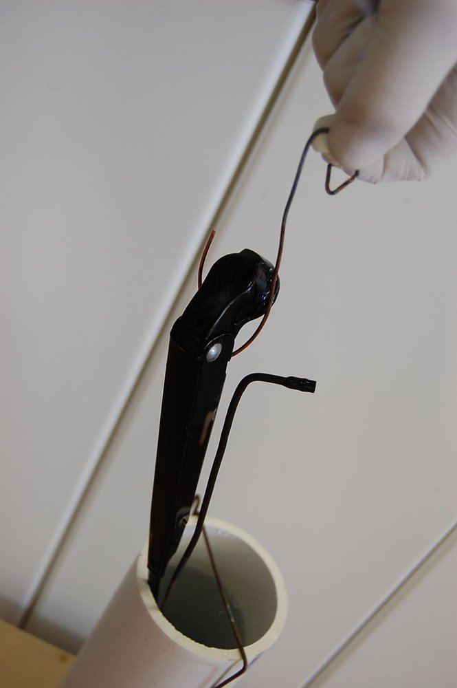

Trying to duplicate the thin black coating on the arms with black oxide.
Have to remove the coating from the tubes and other parts of the arms that weren't black
