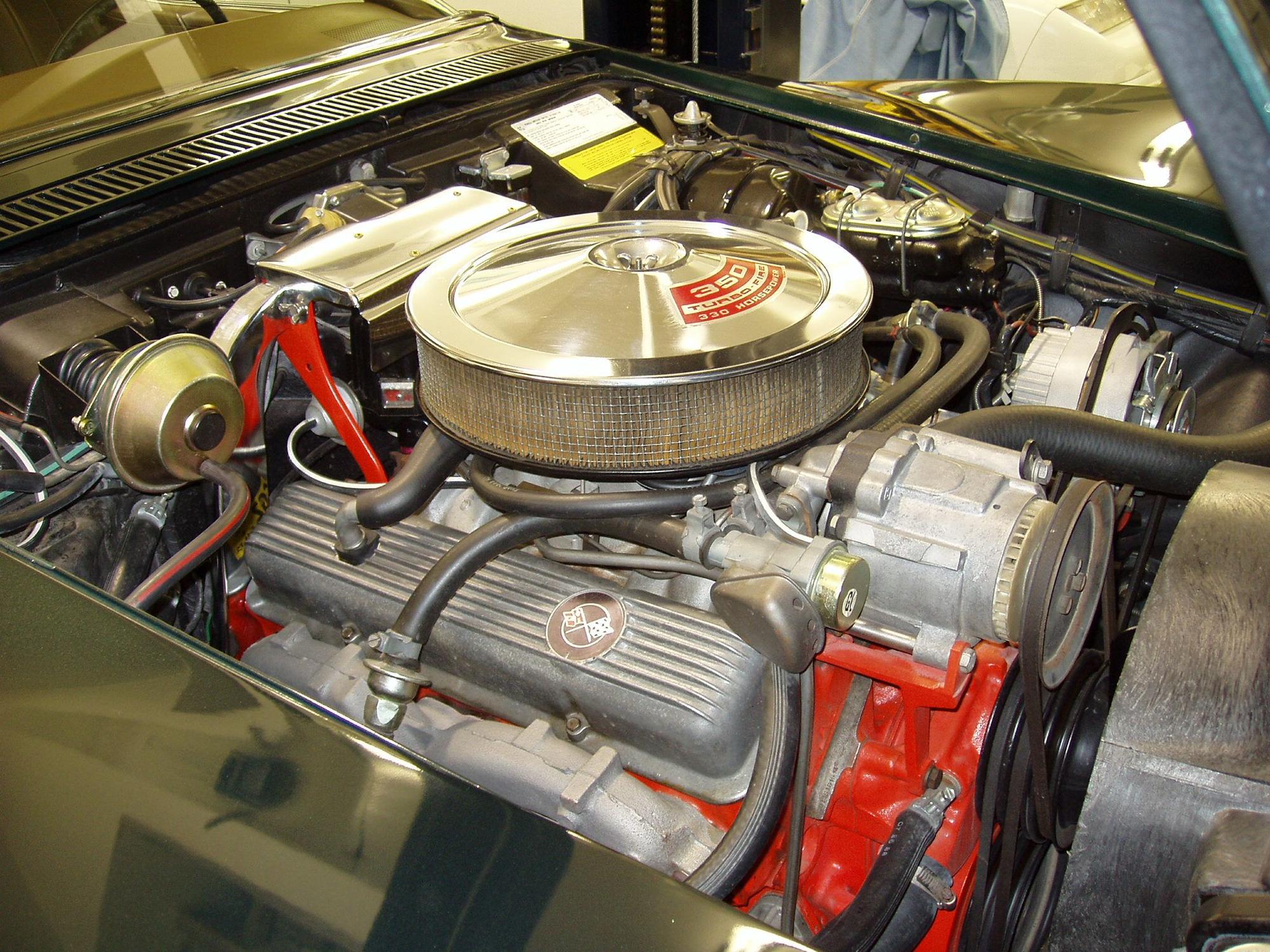

A 1971 LT-1 with the AIR system and PCV systems in place.
