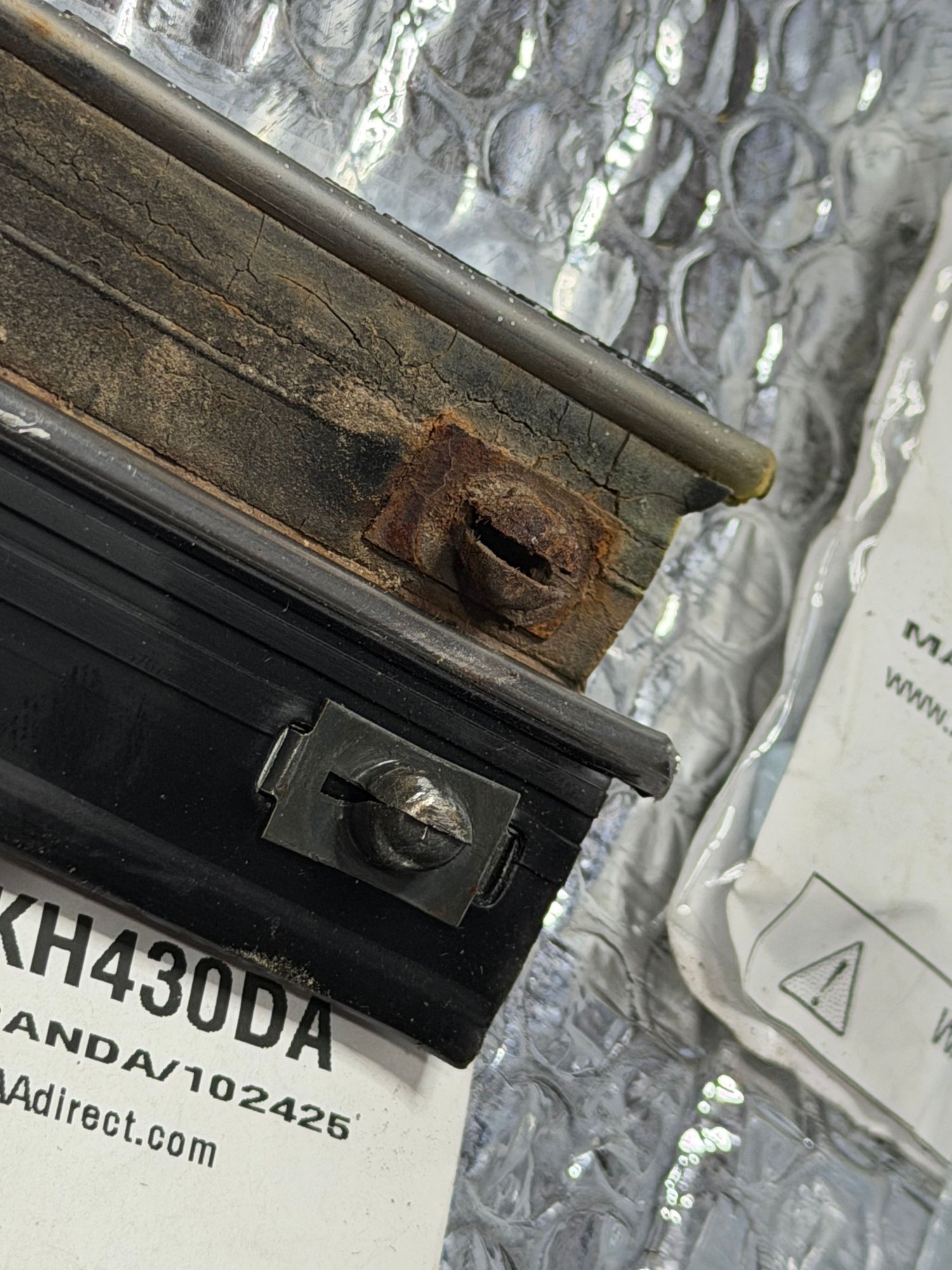

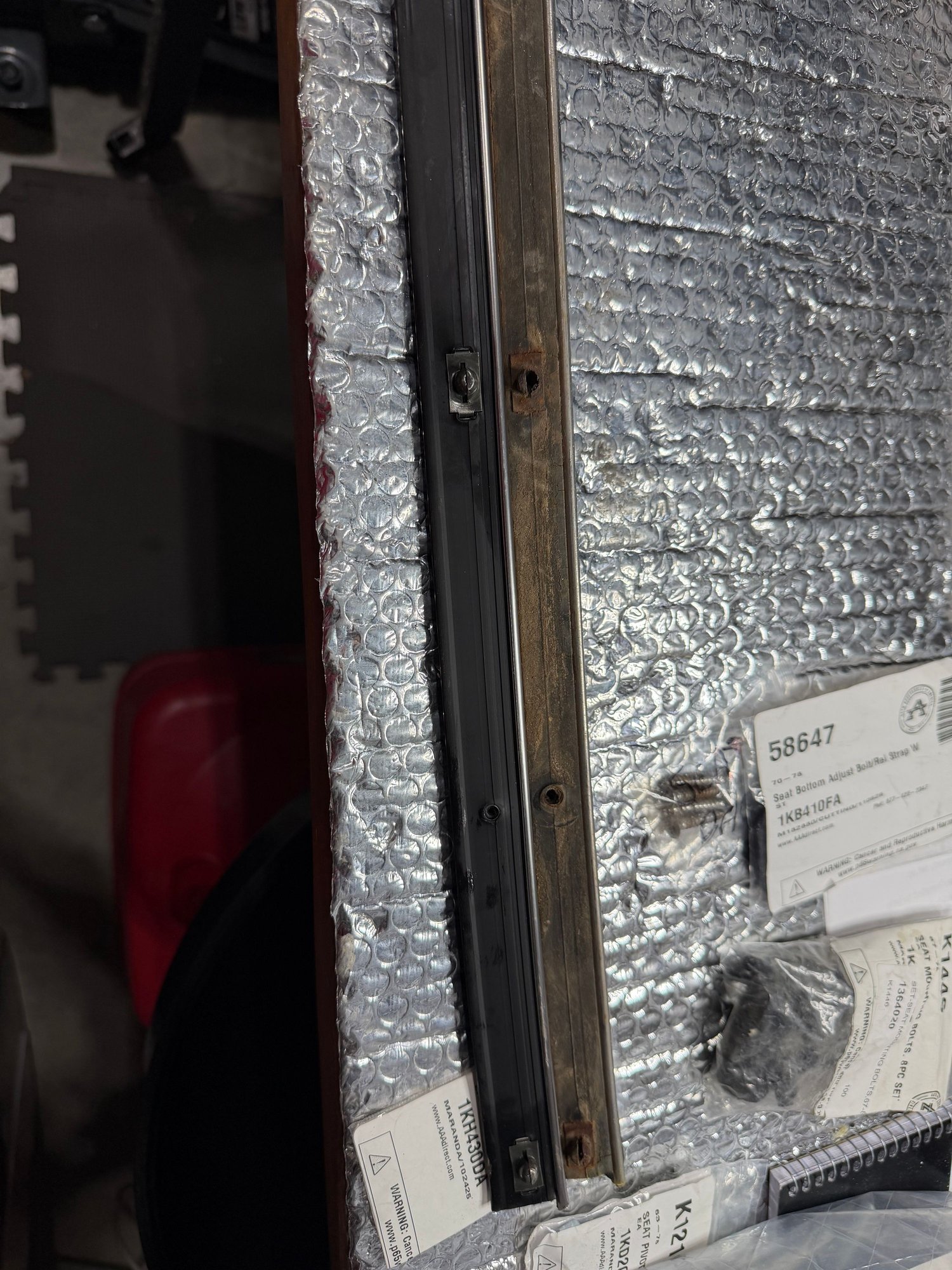

Here's a picture of the old vs new seal part. Spacing seems to be the same, and the basic shape and size of the clips seem very similar, perhaps slightly larger on the new one depending on which one you look at.

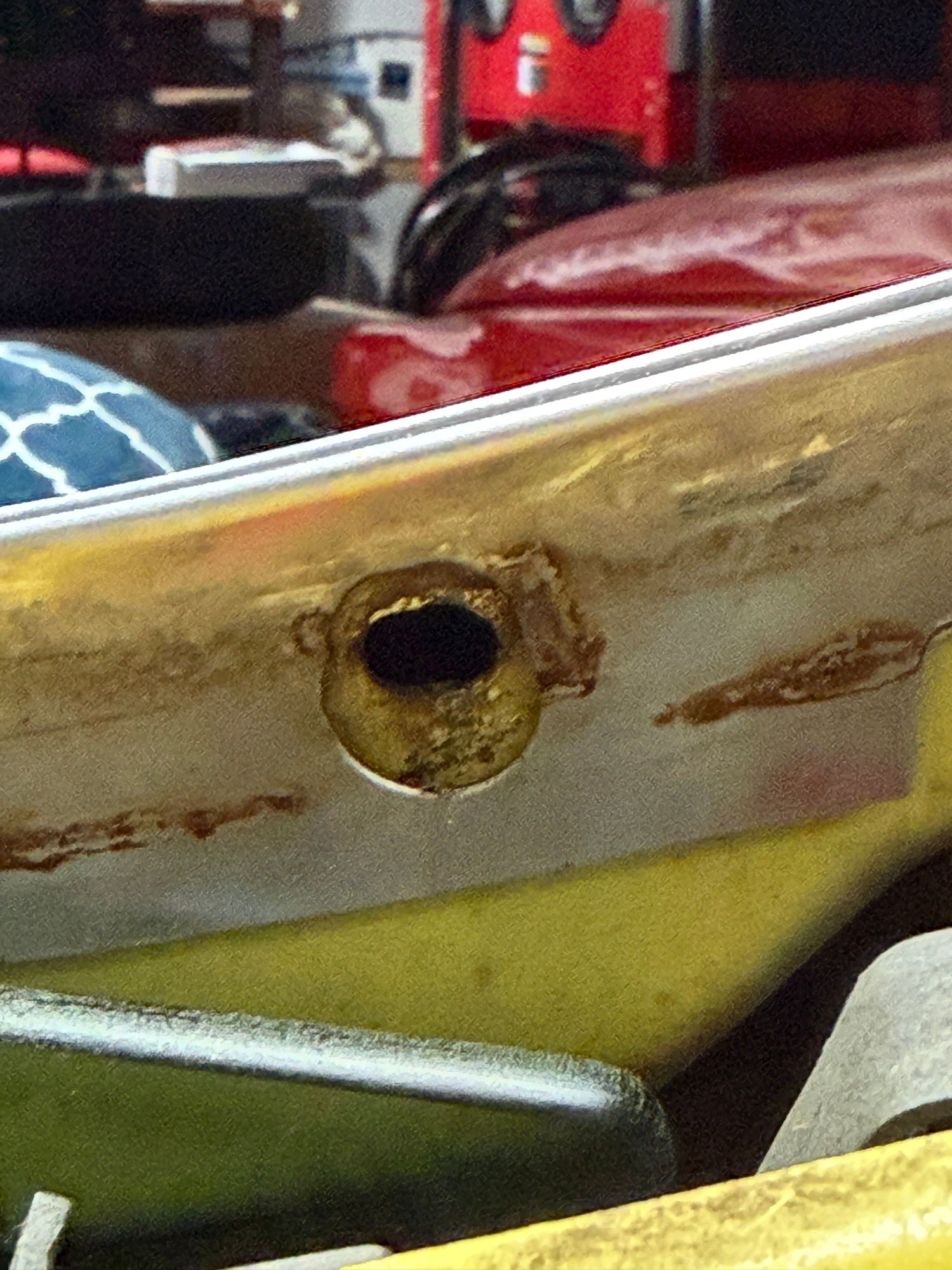

View of the hole in the door... all are similar and clear of obstruction.
Basic shape is similar, although the old is somewhat more oblong it seems.
old vs new showing spacing is similar. Also, depth of clip seems similar.

Clean all the rust out of the holes in the door.
The reproduction seals have inferior quality steel pegs compared to the originals. Yours have already been crushed/ compressed and wont spring back as is. You will have to spread them apart so that they grab inside the hole.
If all else fails, you can screw or glue them to the door.
