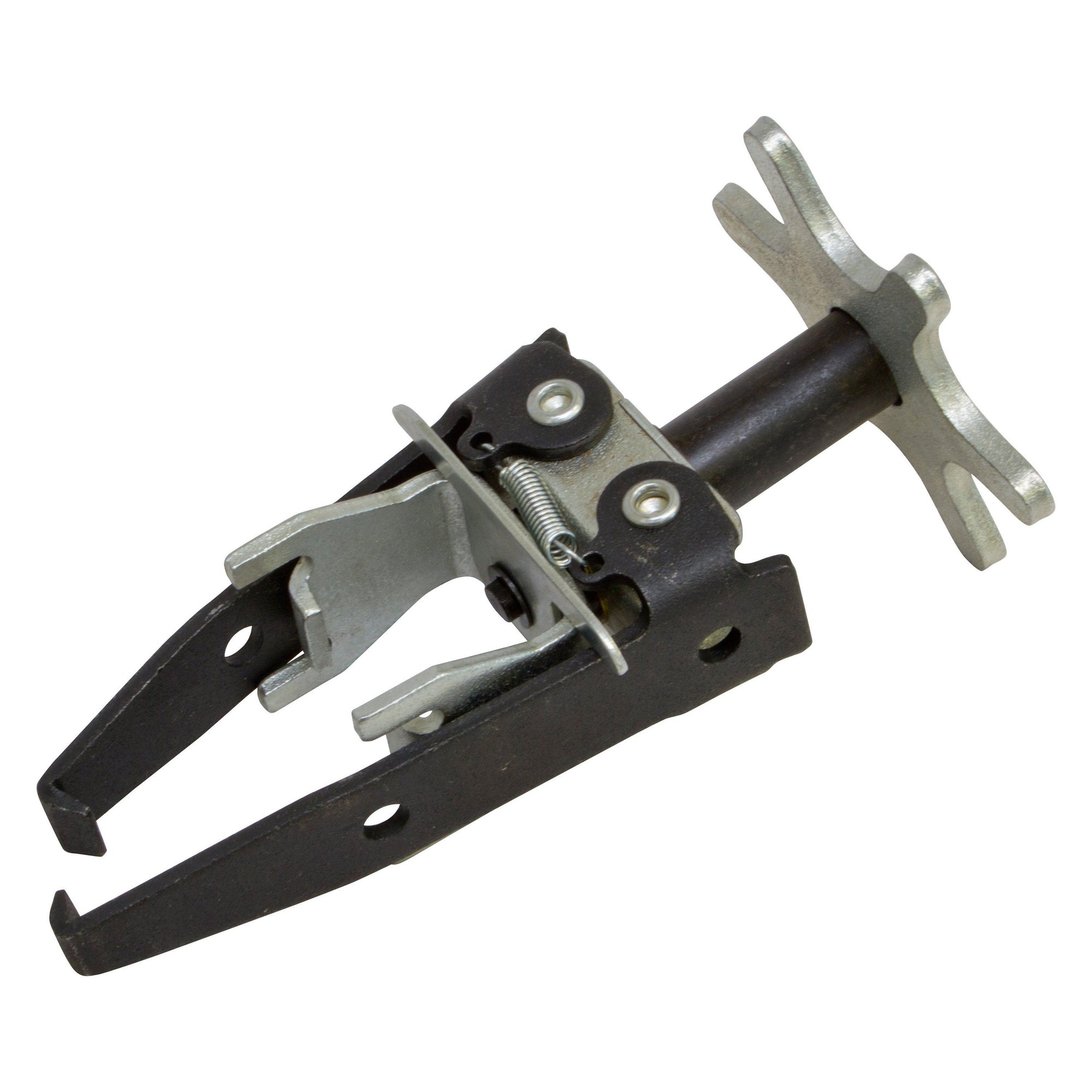

The small rubber o-rings were used by the factory to seal the stem to the metal umbrella. The rubber falls apart after the years and allows the oil to drain down the stem and leak past the (now worn) intake valve guides. They make an aftermarket larger rubber umbrella seal that rides on the valve stem under the retainer. They will work for a while. If I wanted the cheap band aid fix for oil burning I would add the aftermarket rubber unbrellas and also replace the factory o-ring at the top of the stem. The rope in the spark plug hole trick is what I use. The screw top valve spring compressor works great for stock valvetrains.

Thanks for all the feedback, appreciated. Last time I did valve guide seals was in the early '80s on a camero. I still have the tool Stingr69 posted. Now I need to remember how I did it. I think I'll pull the valve covers and check the stems for play. If I remember correctly there shouldn't be any. If there is I'll replace the heads and then no more issues.I'd much rather drive my car than work on it!
