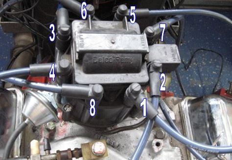

Your distributor is installed at least one tooth off. A correctly installed HEI looks like this:
The C3 Vette was never designed to accommodate a tach drive HEI, so if you decide to do that silly mod, you will have problems with tach drive cable angle. Put the stock distributor back in the car and set it up right with the Service Bulletin distributor orientation.
Long story for how I ended up with HEI, but at this point, I would rather not put the time into putting the original distributor, coil, buy/replace new wires and remove/re-gap plugs. I feel like the solution is simple to get the HEI right, aside from possibly the tach, which might require a 90 degree adapter, which is simple to install.
When the cap is off, the distributor is pointing directly at the #1 plug. With the cap on and the car running (pretty good), it pointing closer to 3 or 5. So I'm assuming I need to rotate the distributor clockwise one tooth, correct?

Take all of the wires off and move them all one position counterclockwise........then turn the distributor clockwise to get it in a better position. Simple.
No bulletin needed. Make sure you reset the timing per Lars papers.....
Jebby
Jebby
Fantastic! Sounds like the simple fix I'm looking for.

I run mine in this position, just enough room to get the timing where I want it (34 deg max advance with alloy heads and the fuel available here)
HEI dist on '70 SBC
and nice run for tach cable. I have read that the 90 deg adaptor for the tach cable puts too much load on the drive gear in the distributor.
