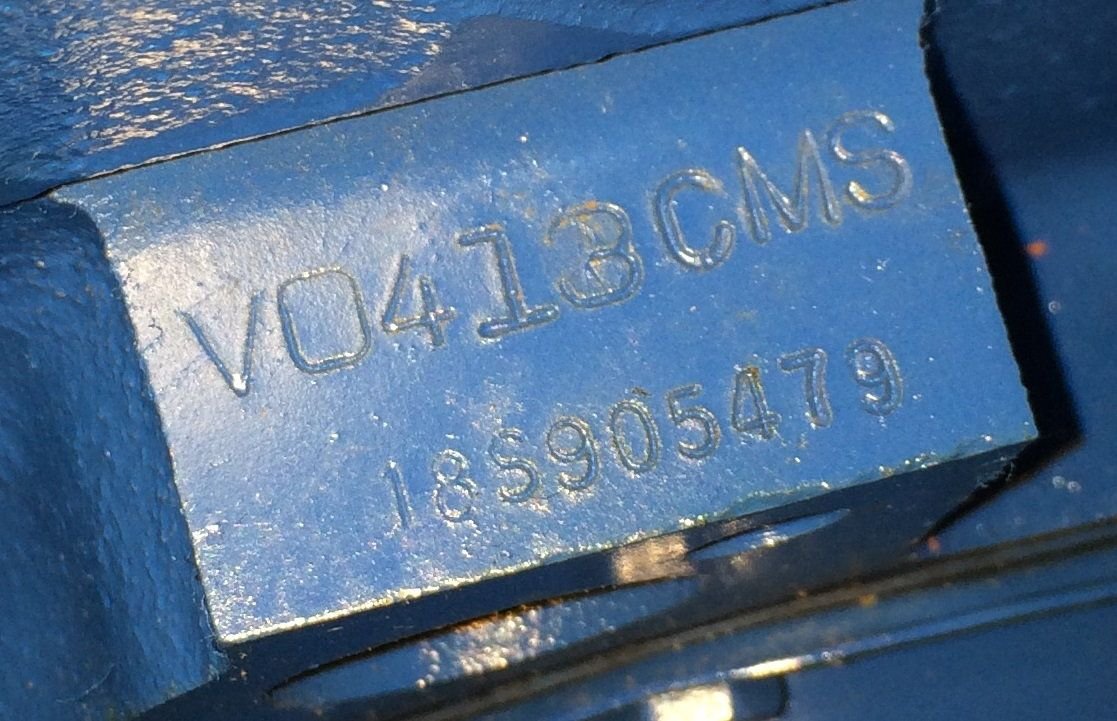

Can you post a pic of the engine stamp pad ?
Old Dec 1, 2022 | 03:26 PM
Timmerduder's Avatar
Timmerduder
Joined: Aug 2022
Posts: 16
Likes: 14
From: Oregon
Old Dec 1, 2022 | 07:33 PM
BKarol's Avatar
BKarol
Joined: Sep 2004
Posts: 3,225
Likes: 667
From: Northeast
Thanks, that looks like the shape of a 78 or later stamp pad. For those years the block was painted blue. No help with those numbers however.

I would conclude its a service replacement engine. Compared to bkarol's stamp pad, there is no evidence of an assigned power team function (emission-type stuff) or assembly date code. you can see the stamp is in the middle of the pad, so its assembler must not have been concerned about date codes or emission/power functionality.
Having said all that, the V0499800 typically would be interpreted that assembly was the Flint engine plant (V); 04, month of assembly or April; 99 day of the month and the 800 engine suffix code quite atypical! All of which leads us to conclude its a service replacement engine with no assigned function.
